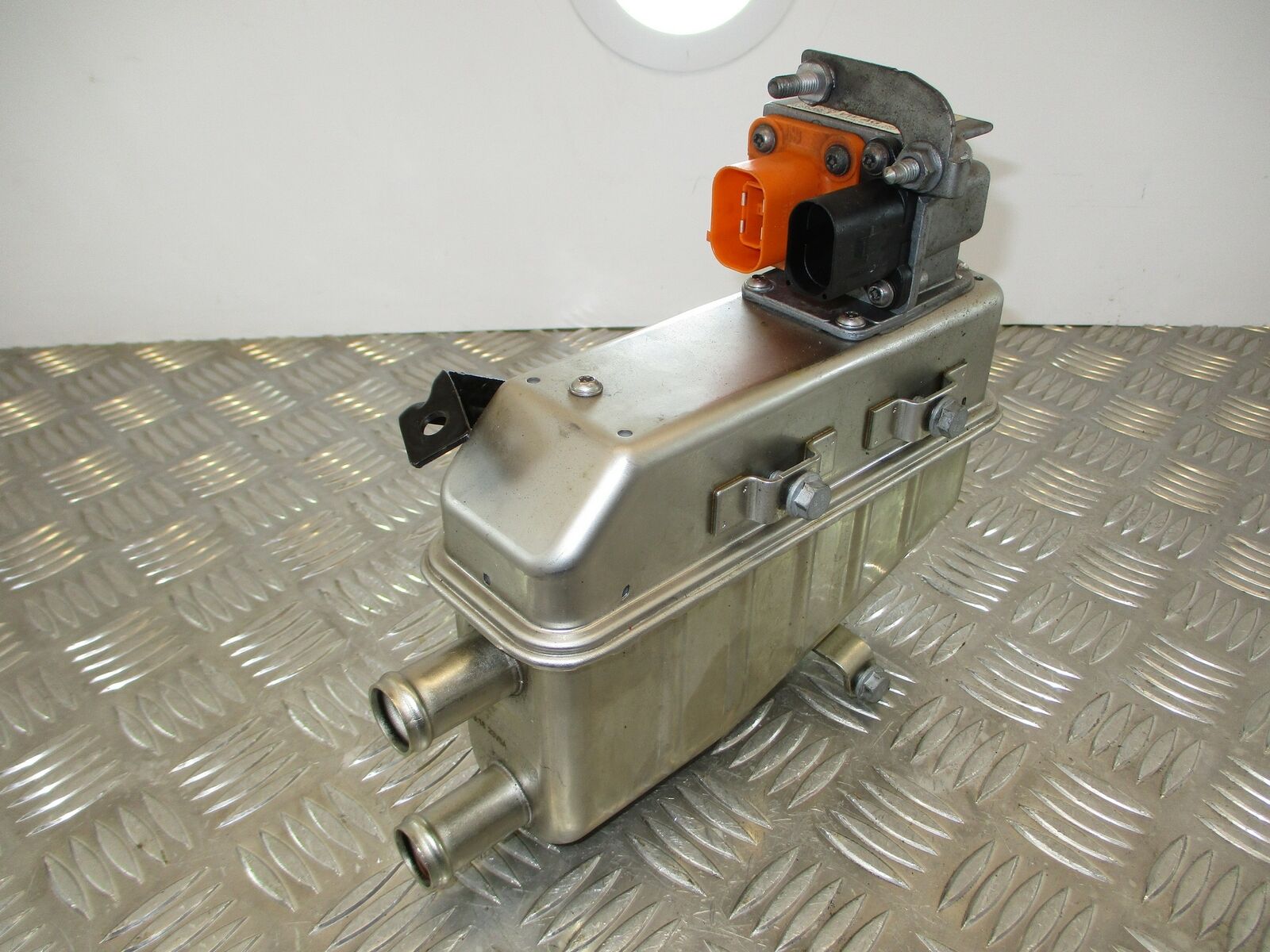

I found the correct cable for HV is 3Q0971475 or 5Q0971475. The point is to use the side with a single indent, the other side i intend to cut and fit solar connectors.
LV connector looks like it is Webasto 1J0973714 8P type? Anyone has more data?

The Eberspächer heater is installed in my e-Golf. The LV plug is 8 pin. Pin 1 = Red/White, Pin 2 = Brown, Pin 4 = Violet/Yellow, Pin 5 = Green/Violet, Pin 7 = Black/Green. The rest is unoccupied.
The connector appears to be the same as the DBK, but the pinout is definitely different.

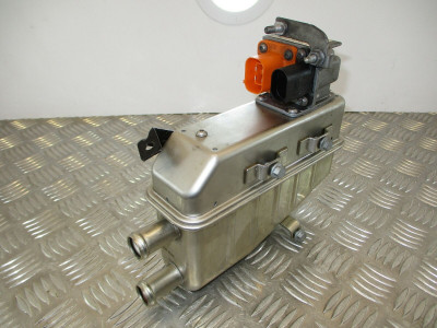

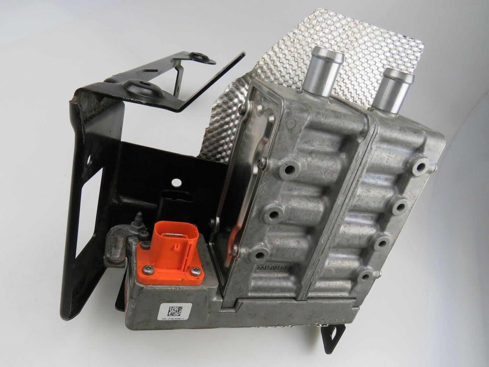

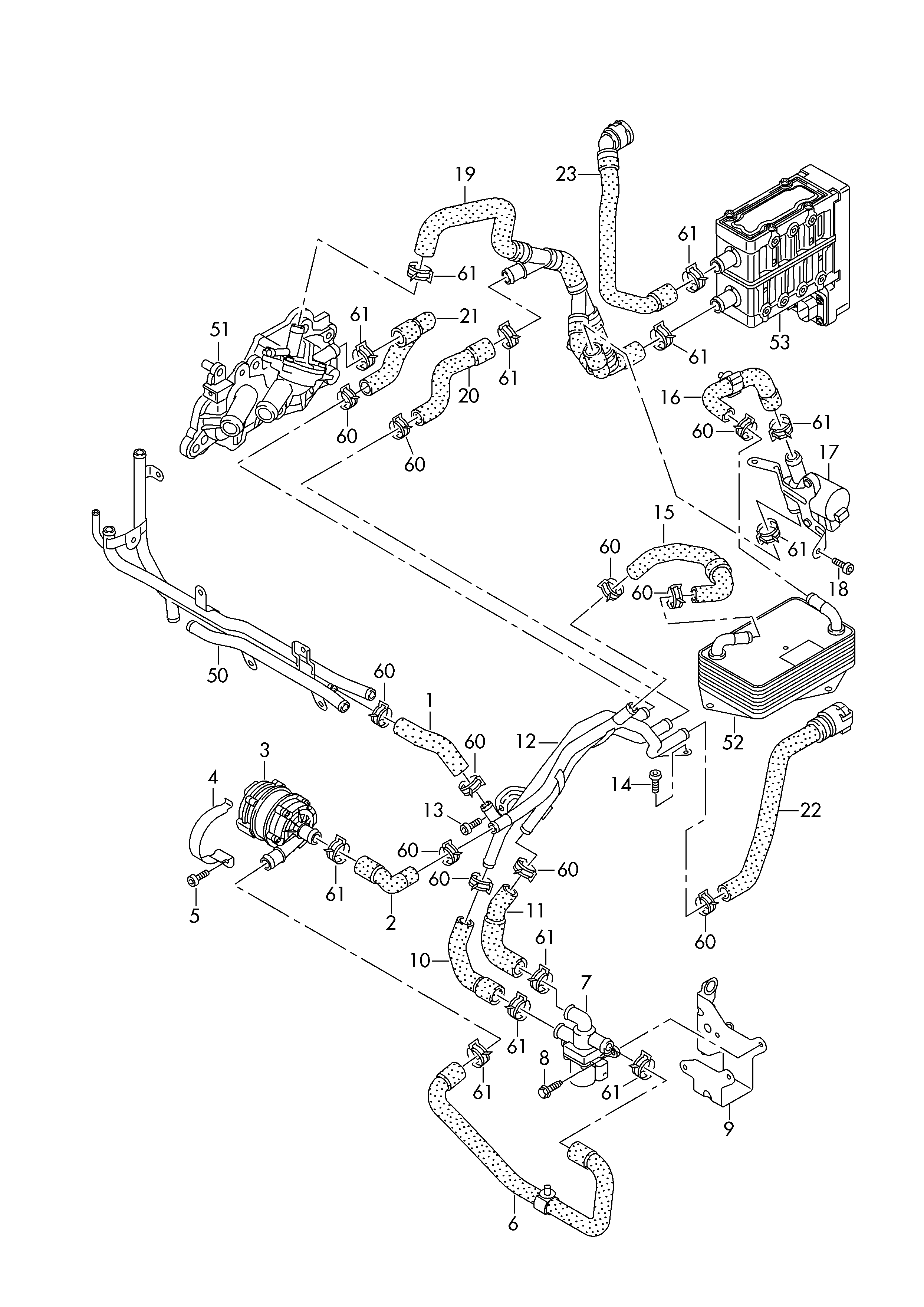

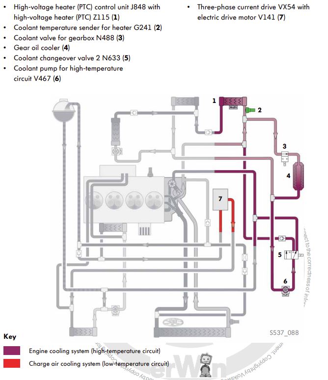

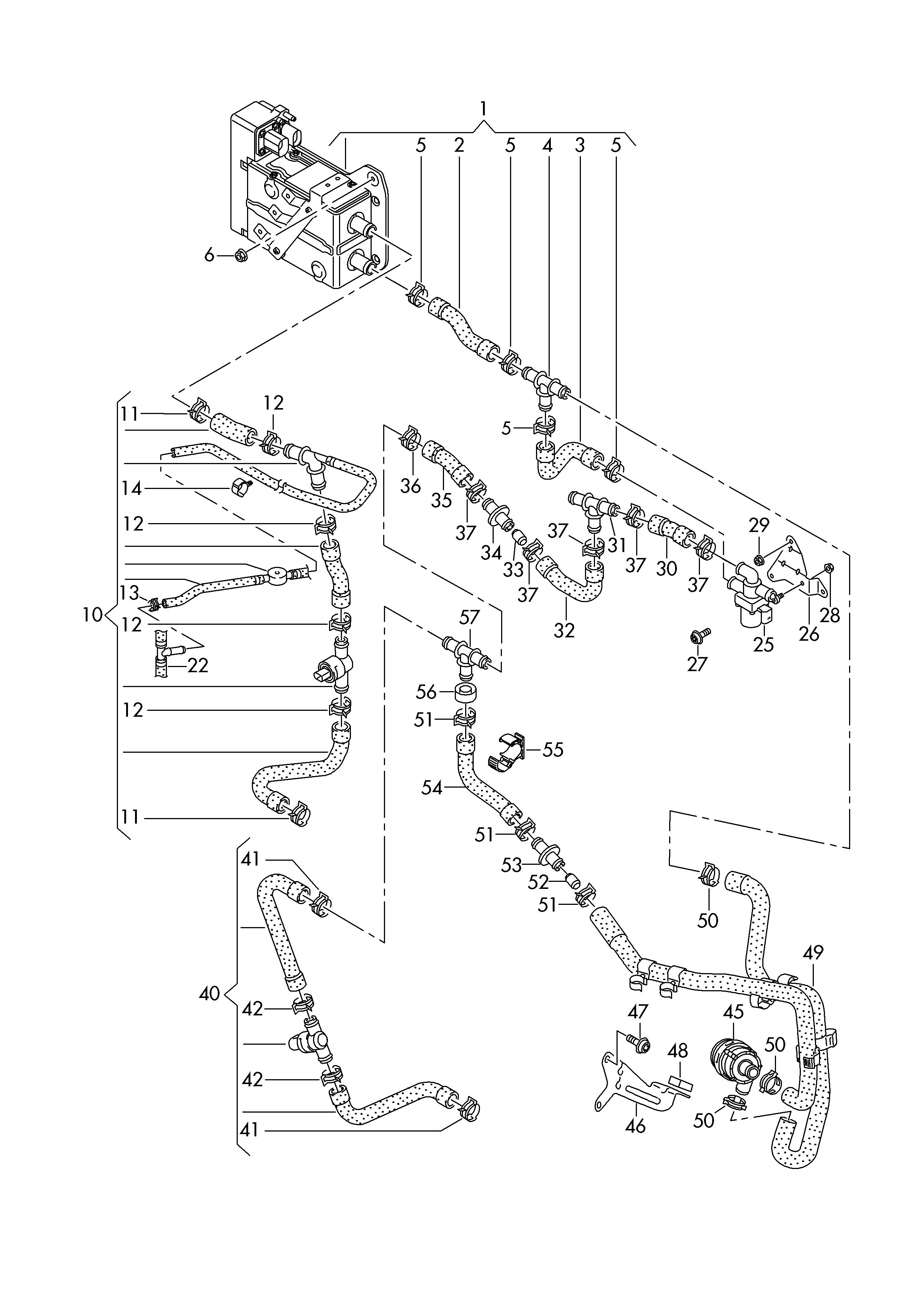

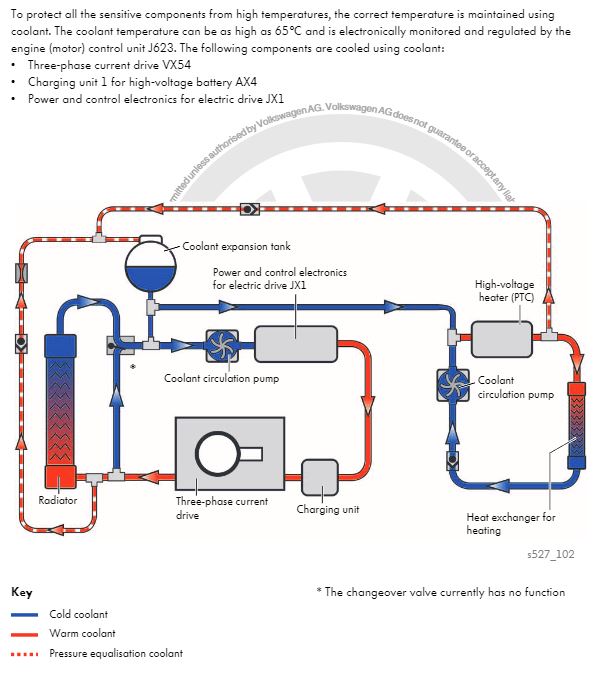

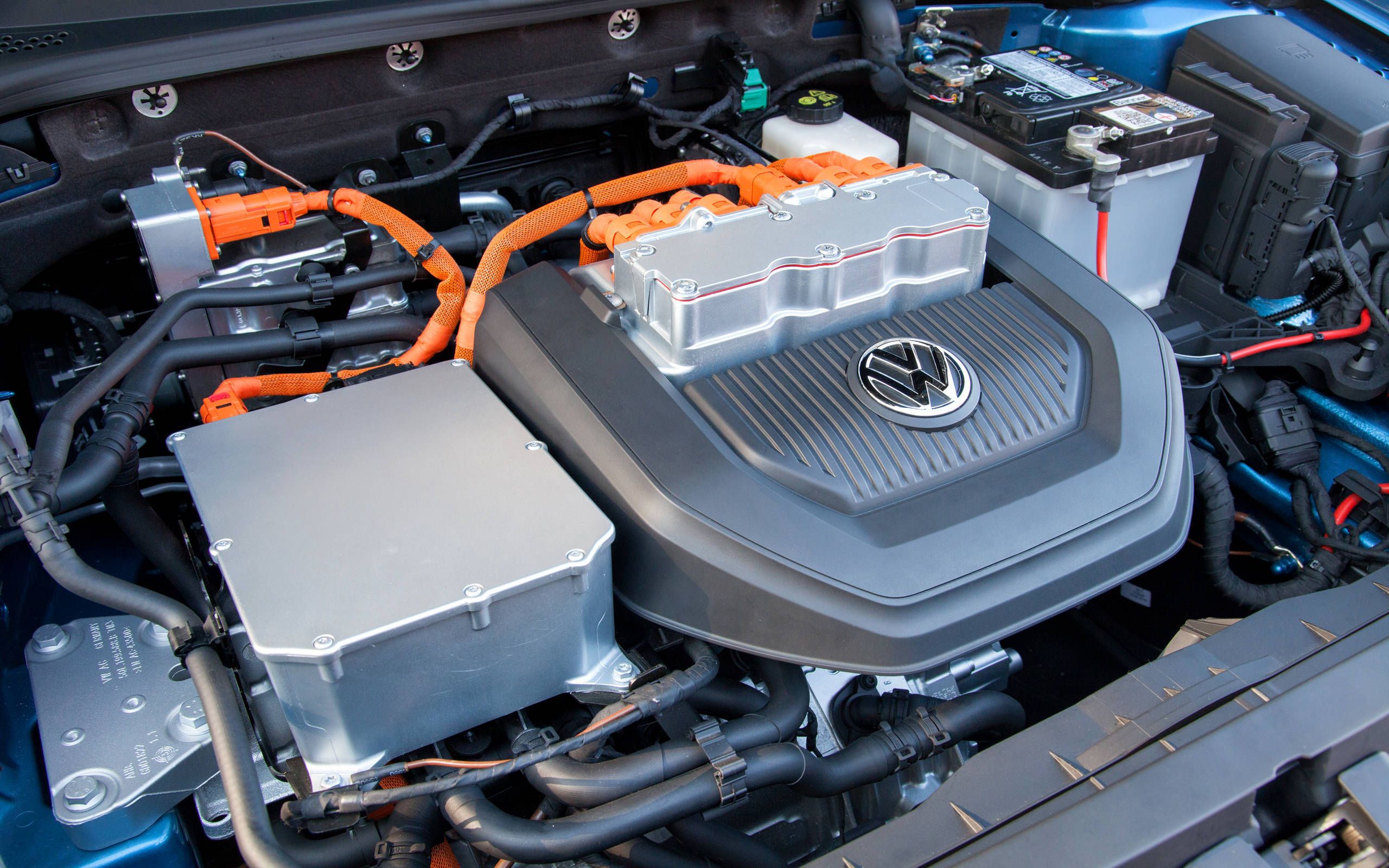

Hi, looks like the coolant to heater is the lower pipe and heater to heater matrix is normally the top, depending on which way you heater is mounted. this is the diagrams from a e-golf and golf gte
E-Golf Golf GTE
E-Golf Golf GTE

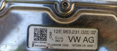

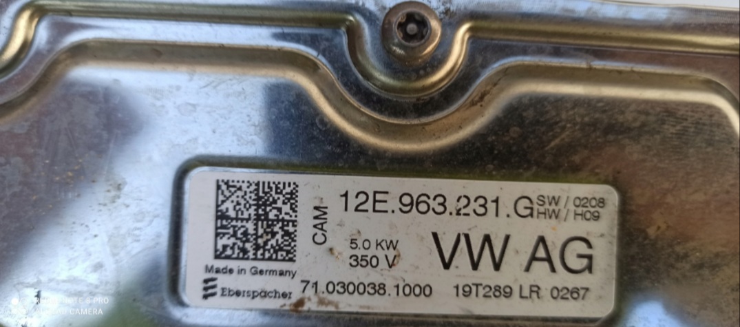

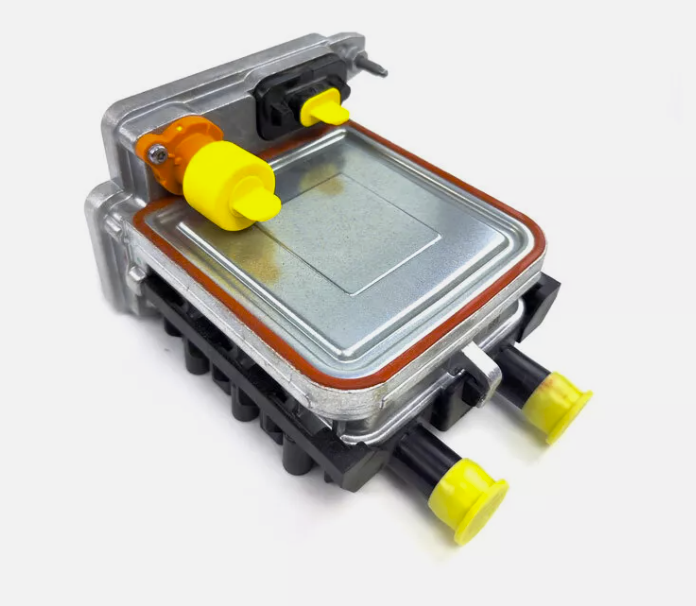

Is anybody familiar with the vw e-caddy ptc coolant heater - 71.0301.37.0200?
Looking for the info on how to control and orientation of install. Thanks in advance.
- Posts: 1
- Joined: Mon Jan 20, 2025 12:31 pm
Re: VW electric coolant heater
I got my hands on the same heater model for cheap as well - cheap enough for the risk of not being able to successfully reverse engineer the communication. Worst case I will open the electronics and see what I can find in there. So far I am pretty confident that it is an Eberspächer Titronic CHHV 50 G3 or 50 G3T, communication is via LIN 2.1 protocol from what I can find:alexbeatle wrote: ↑Sat Sep 28, 2024 5:10 pm Is anybody familiar with the vw e-caddy ptc coolant heater - 71.0301.37.0200?
https://www.eberspaecher-emv.com/filead ... eet_DE.pdf
https://www.eberspaecher-climate.com/fi ... 8_2022.pdf
But maybe this should be split into a new topic?

5kw is considered too high for the battery heating?simonkuehling wrote: ↑Wed Jan 22, 2025 10:46 am I got my hands on the same heater model for cheap as well - cheap enough for the risk of not being able to successfully reverse engineer the communication. Worst case I will open the electronics and see what I can find in there. So far I am pretty confident that it is an Eberspächer Titronic CHHV 50 G3 or 50 G3T, communication is via LIN 2.1 protocol from what I can find:
