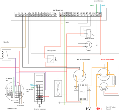

Re: Zombiverter not switching to charge mode with Leaf PDM
The fact you say your inverter run without 12V ignition being applied is suspicious, along with the power draws.
Please post pictures of your setup as asked before. As we can see things you might not even think of.

@tom91, I can't thank you enough for your patience this past week or so as I have been pulling my hair out regarding the PDM charger operation with the drive and DC-DC working faultlessly.
Pictures would be of no help with this issue as all the wiring is loomed.
I have checked the wiring extensively right to the pins on the PDM and inverter plugs. When I test with the 12v disconnected from the ignition relay, the inverter definitely still runs fwd and rev after keying the ignition.
I even checked for back feeds on the wires when disconnected from the relay.
Will take some time out for a ground up re-think and even try connecting the CAN and battery 12v directly with plugs out to the PDM and inverter to see if it still runs without PDM pin 16 and Inverter 42 powered.
Will also try disconnecting the Zombie board in case the CAN messages are keeping the PDM and inverter awake. Sounds daft but possible I guess.
My guess is that the PDM won't allow charge unless pin 16 is false. The high currents noted on the inverter and PDM would indicate that neither are asleep.
The wiring is exactly as below.
