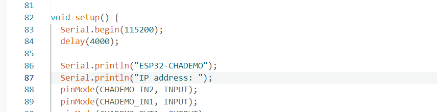

Bigpie wrote: Thu Sep 12, 2024 5:56 am If you connect to the ESP32 wifi network and the ip address will be 192.168.4.1
Ok back to this. I think I found the problem. Is default IP for ESP32 should be 192.168.4.1 But mine is not defining the default serial.
I added this in the INO file.
And got this in the serial printout on the Arduino screen.
Anyone know how to add a set IP address?

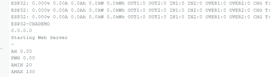

Arlin wrote: Sat Sep 14, 2024 8:40 pm Ok back to this. I think I found the problem. Is default IP for ESP32 should be 192.168.4.1 But mine is not defining the default serial.
And changing it to this.
I got this.
Posts: 2962
Has thanked: 328 times
Been thanked: 847 times
Re: ESP32 Based Chademo
Wifi starts further down. so only have it print the IP towards the end of the setup() section.

Tried it this way as well. Still 0.0.0.0
Also do I need to change WiFi.begin("Beetle_CHademo", "Fia84grapu"), to something else?

Oh how to get the Web page to load from my PC so I can set the settings etc.
royhen99
Posts: 265
Location: N. Wiltshire. UK
Has thanked: 22 times
Been thanked: 134 times
Post by royhen99 »
Assuming you have the the same version as on github, connect your wifi to ESP32-CHADEMO, password ChadMeO.
Then access the web page at 192.168.4.1 which is the default IP address for the ESP32 web server.

Thank you.
