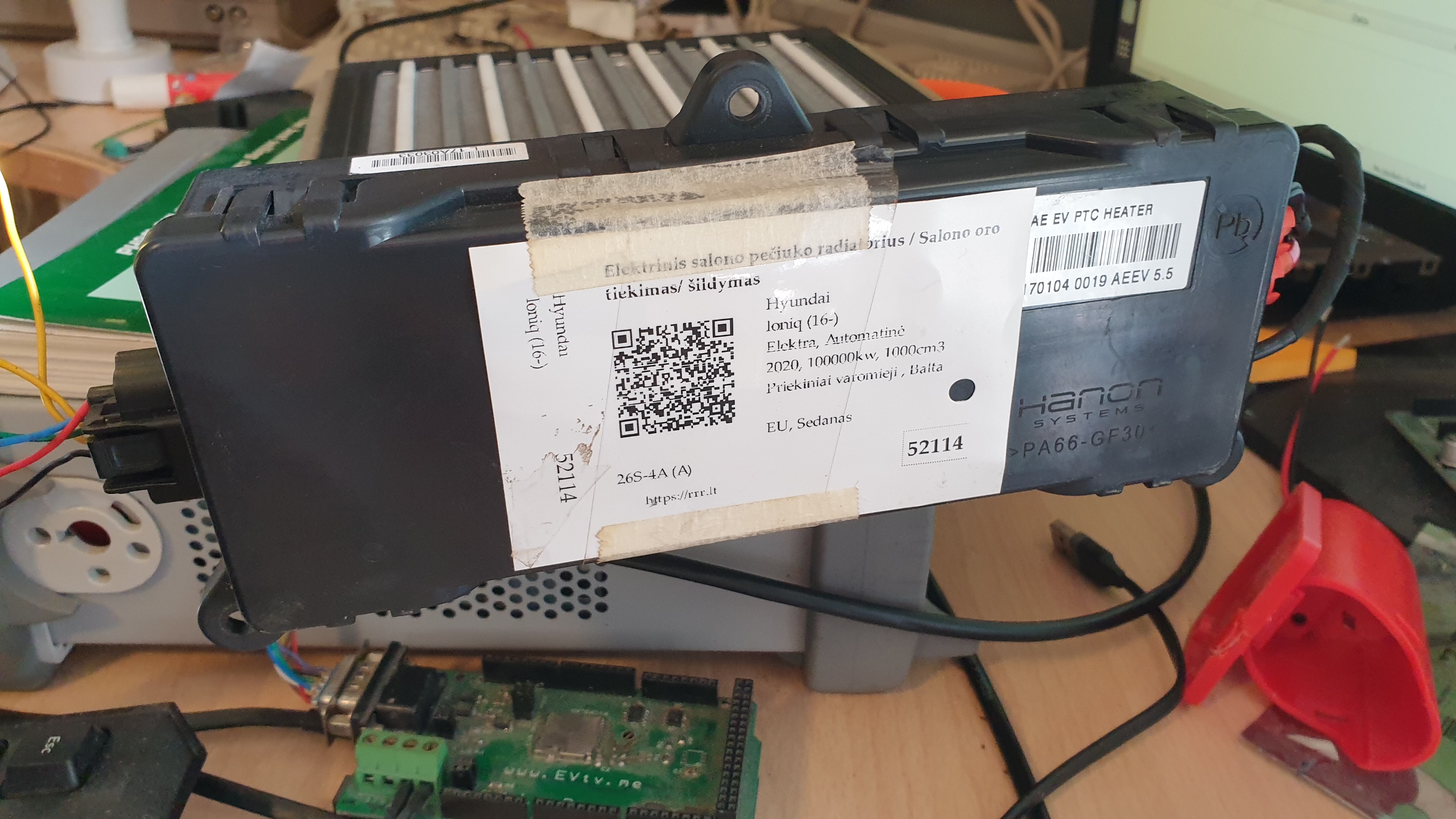

Hi steve,
I have one of these heaters (the one used 2017-2022) and intend to use it in my project, but I haven't got up to this part yet. It's CAN controlled by the AC control module (FATC), there's a dedicated CAN bus named COMP-CAN that has FATC, the AC compressor, and the PTC heater on it.
If you feel like doing some reversing, there's a log here of both PCAN and COMP-CAN buses where we were turning the heating and AC on and off.
In the logs on the PCAN bus, message ID 0x5CB (sent by FATC) has a signal with the climate control SetPoint in it so you should see it going to the high and low extremes. As this happens the COMP-CAN bus messages should show FATC starting the AC compressor or the heater, depending on the setpoint.
Looks like I made a very basic start on decoding the COMP-CAN messages here: https://github.com/projectgus/kona-ev-d ... can.dbc#L4 - but not really anything there yet. Will post again if I get back to it. If you look into it then please share what you find!
Low voltage control connector is 6 pins KET MG641107-5. Pins are numbered in two rows right to left.
I don't know how Interlock + and - works yet, but these pins are connected to matching Interlock + and - pins on the FATC module. Unsure which side is reading the interlock status or what signals "OK".
High voltage connector appears to be TE AMP part number 2103177-1. Plug seems easy to buy which is nice, and datasheets/drawings/etc publicly available. I have a note saying positive is Pin 1, but I have not confirmed this or figured out how to identify it on the connector...a pinout for it,
- 12V, powered when IG3 is on, 10A fuse (shared with FATC power) (red)
- COMP-CAN High (brown)
- COMP-CAN Low (white)
- Interlock + (yellow)
- Interlock - (grey)
- Ground (black)

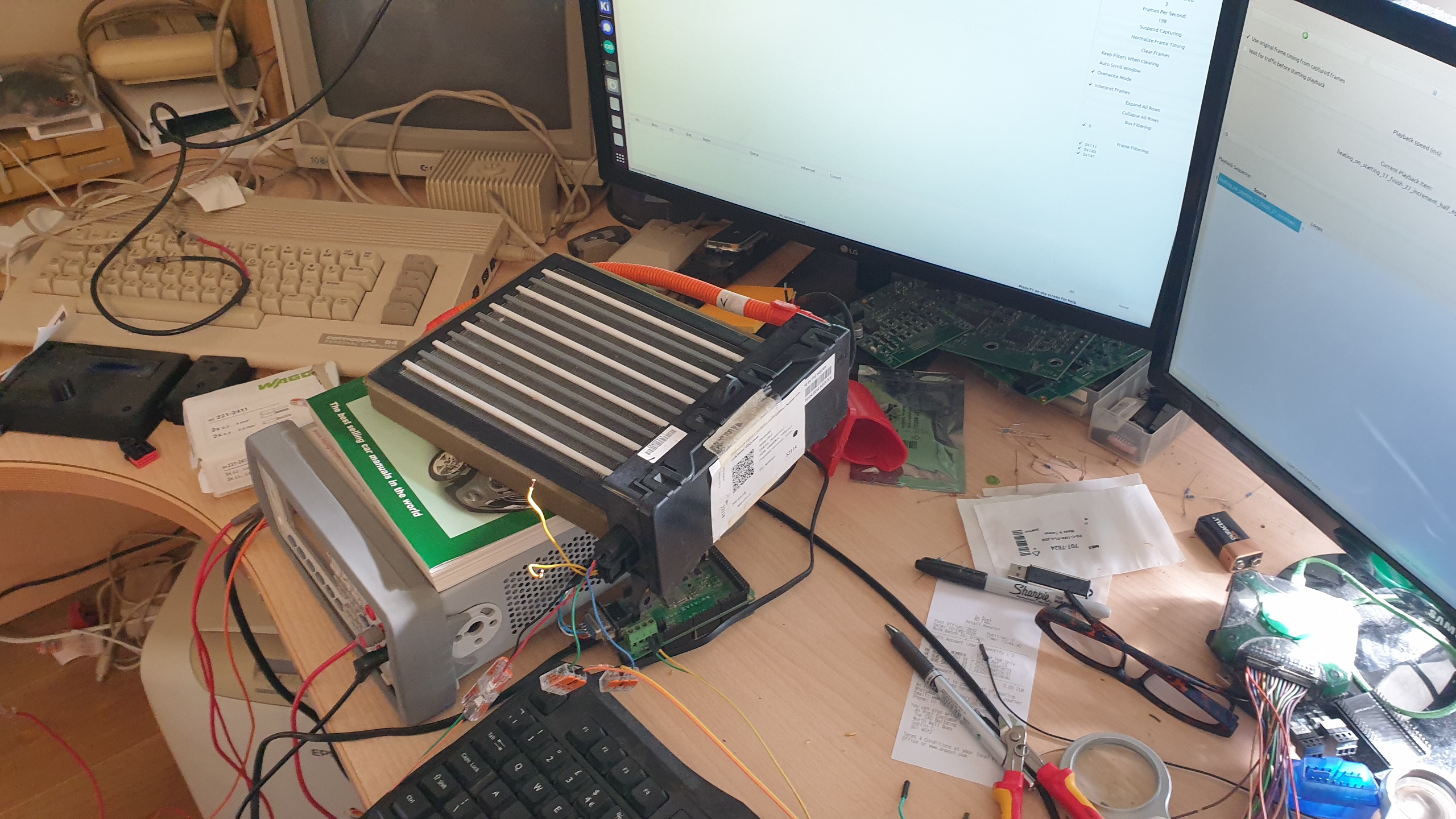

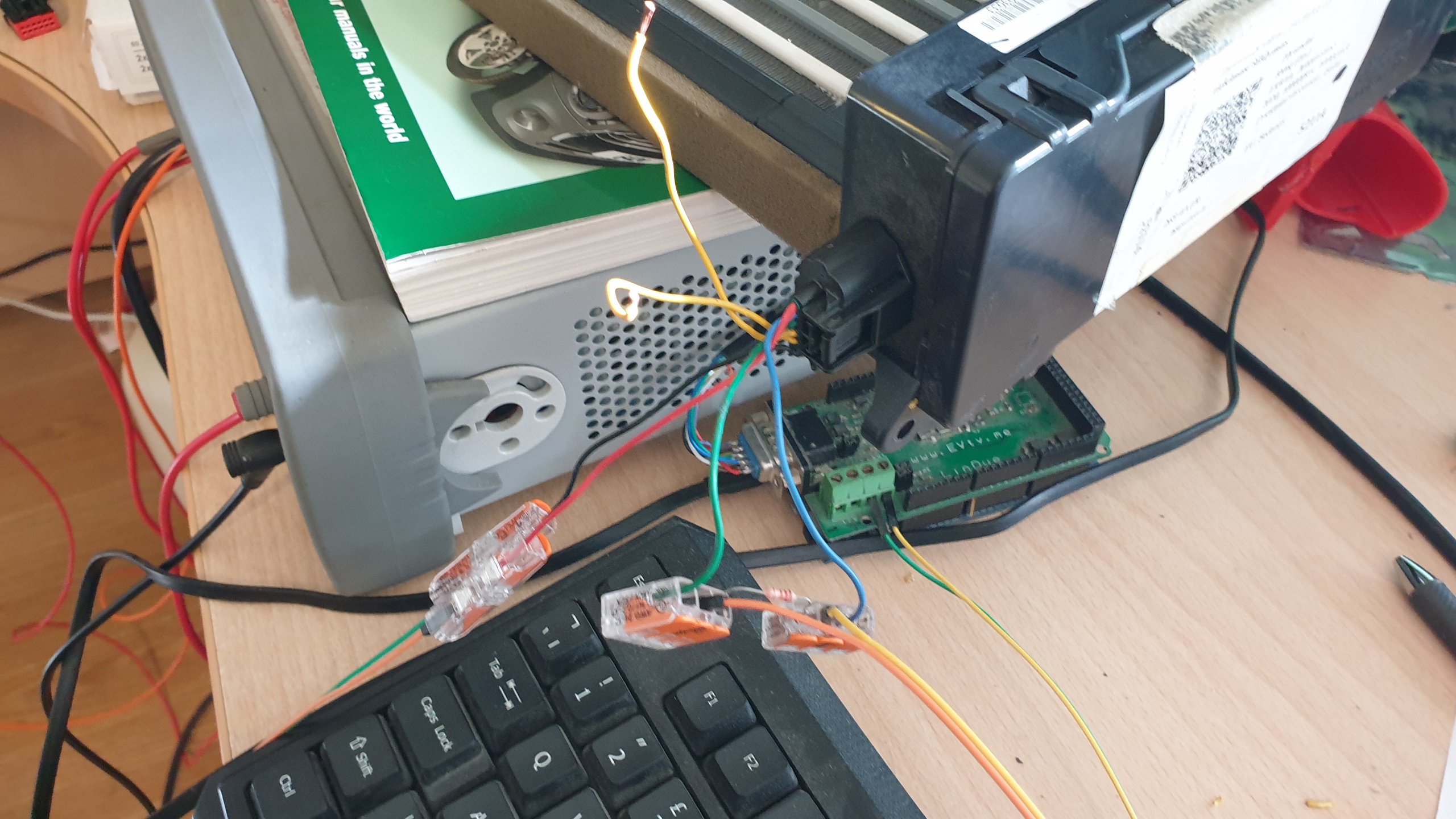

Sitrep:
This morning i took some logs from the the heater CAN bus on my 2020 Kona by tapping directly to the heater CAN. Attached are the logs.
I powered up my test heater with 12v, and received the 0x140 and 0x141 message IDS from it, confirming that it's communicating, and confirming that the logs contain 140 and 141 IDs.
I supplied 120v from a DC power supply to the HV.
I then replayed the 'heater on' logs to the heater hoping to see some current being drawn from the 120v supply. Nothing.
I played around with all combinations of the HVIL. Nothing
Not sure where to go from here.

I've been playing around with the heater with some success.
I got myself a 400v 1a power supply and that did the trick. It starts to work from ~250V
What i've got so far in terms of the understanding the data:
Messages 0x140 and 0x141 come from the heater.
0x140: byte 1 reports the heater temp. It sits at 0x3A in my office, and climbs to 0x46 when a hairdryer is pointed at it for ~30 seconds. These look like fahrenheit values, but I can't be sure. I'd be surprised if they are fahrenheit as the input setpoint appears to be in celcius.
0x140 byte 5 reports the voltage divided by 2
Message 0x111 causes the heater to start drawing current. From my logs from my test session in the car, it starts at 0x22 (17 decimal), and climbs to 0x40 (64 decimal) when I put on max heat. As @projectgus pointed out these look like setpoints in celcius.
That's all I have for now. I'm going to try to source a laser thermometer to see if I can reconcile the temps being reported by the heater.
