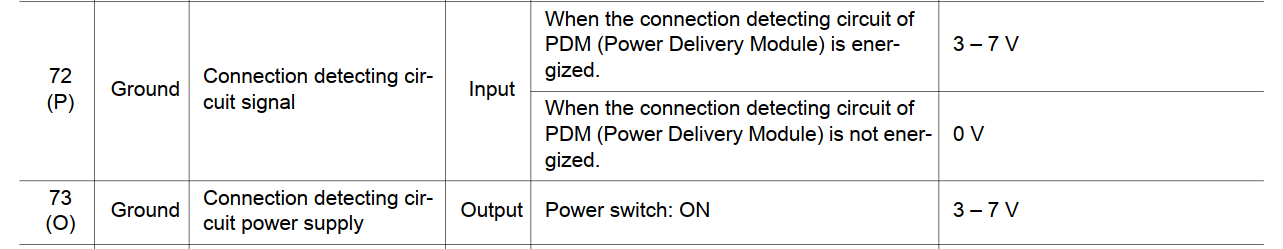

Nissan has only warning lamp lit up, as for example LBC would not give a system start OK if any battery side HV connector is not properly fit
EVB page 23: Detects the connector fit state with the function to detect the fit of the high voltage harness connector and
transfers the detected state to VCM so that the vehicle does not start with an unsteady state.
This snip is from Leaf SM EVC to get an idea what Nissan does for PDM and Inverter bus connection HV IL detection. There are just two microswitches inside the drive stack, one for each module (PDM top lid and inverter bus bar connection cover). Doesn't seem like there's nothing else there and the voltage generator and sensing circuit is in the VCU.
