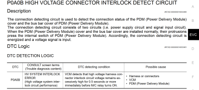

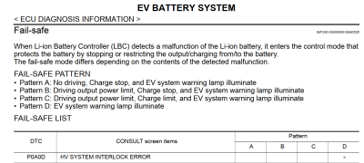

Re: Implementing HV interlock (Zombieverter)
Ok, now we're getting some discussion Sorry this post got out of hands and is bouncing all over the topic...
Also my thoughts have matured somewhat. A brain fart would be to supply the +12V for contactors through the interlock loop directly all sorts of sketchiness in that I don't want to do that
Just to get this thought through too:
If one would want to have a passive system for HV IL, a latching supply circuit with an open circuit indication could be sufficient, right?
Logic would be such that at vehicle start the HV IL circuit would need to be closed for contactor supply to turn on at IG On.
Once we have contactor power supplied, it won't be cut if for any reason there is a connection issue with HV IL circuit.
Indication led just for the sake that you will have some feedback why pre charge fails in this situation.
Above all possible options, I'm rooting for having this as a VCU (Zombieverter) input pin AND status.
My understanding of the reason of existence for HV interlock is to prevent maintenance/assembly errors resulting in a situation that a HV connector would be exposed. So a pre contactors engagement check should be enough.
If a (HV IL) connection would be cut while driving the VCU shouldn't do anything without additional information i.e. voltage loss message from a component etc. So this gets quickly complex and therefore a minimum effort type approach is justified.
Nissan has only warning lamp lit up, as for example LBC would not give a system start OK if any battery side HV connector is not properly fit
EVB page 23: Detects the connector fit state with the function to detect the fit of the high voltage harness connector and
transfers the detected state to VCM so that the vehicle does not start with an unsteady state. This snip is from Leaf SM EVC to get an idea what Nissan does for PDM and Inverter bus connection HV IL detection. There are just two microswitches inside the drive stack, one for each module (PDM top lid and inverter bus bar connection cover). Doesn't seem like there's nothing else there and the voltage generator and sensing circuit is in the VCU.
