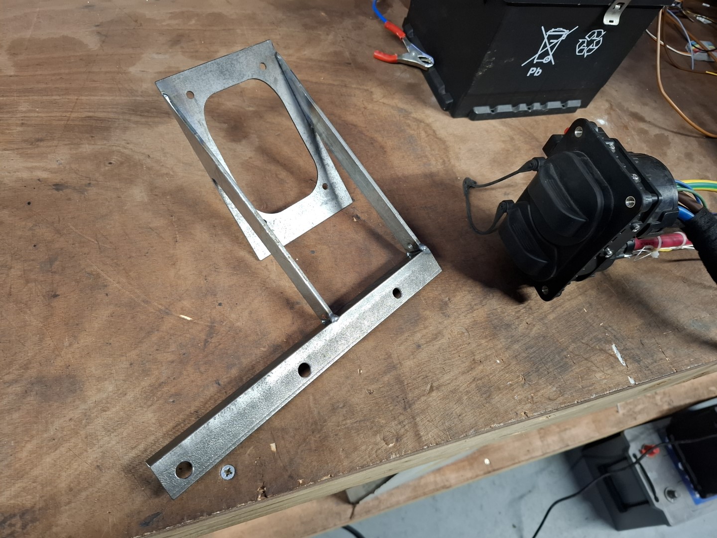

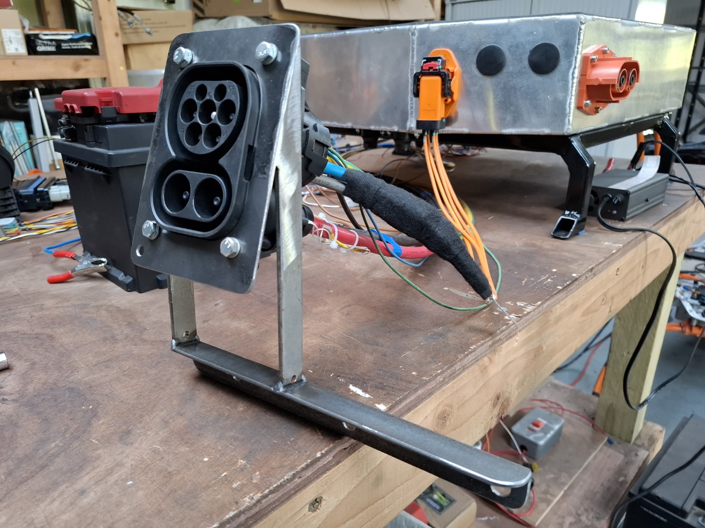

Charge Port:
Tidying up loose ends, time to finalise a location for the charge port socket. Space was tight behind the fuel filler cap, so mounting behind the front grill leaves it close to the HVJB

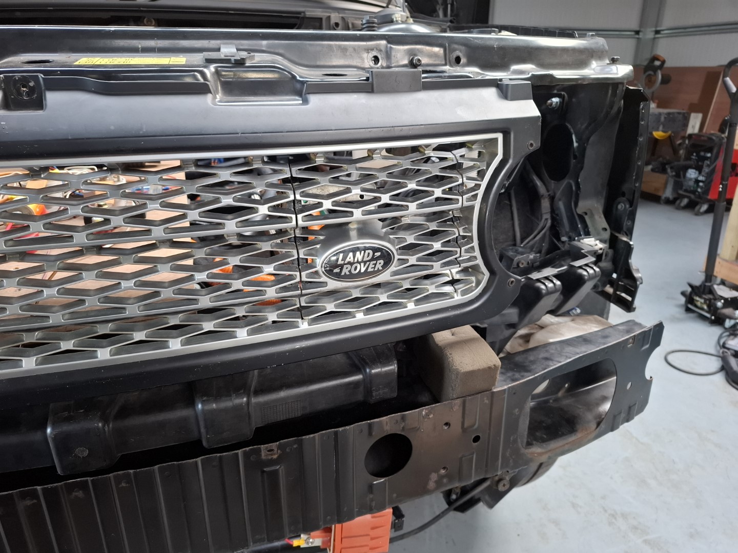

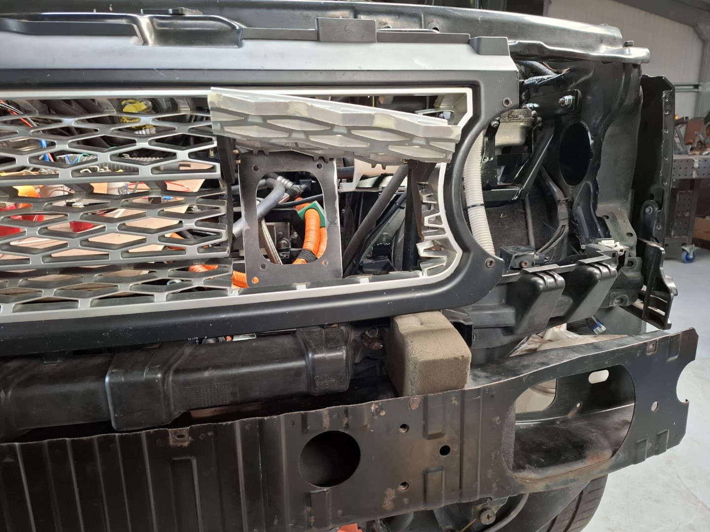

Charge Port:
Which means the grille needs some attention! This grille shape and pattern don't make it easy, so just started cutting!
Plan is to have a 3D printed hinge detail with 0 and 90 degree stops and accommodate an over-center spring option to hold it open or closed as needed. Some reshaped prototypes later and design works well
Parts to be bonded behind grille
Will tidy some cut edges and possbily repaint grille at some stage but good enough for now
The grille pattern dictates the cut lines, which dictates the hinge orientation and doesn't give the most ideal opening but still enough space

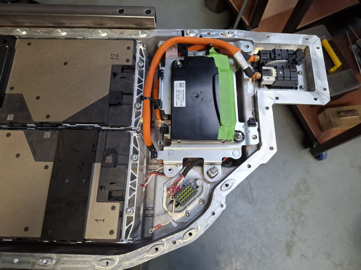

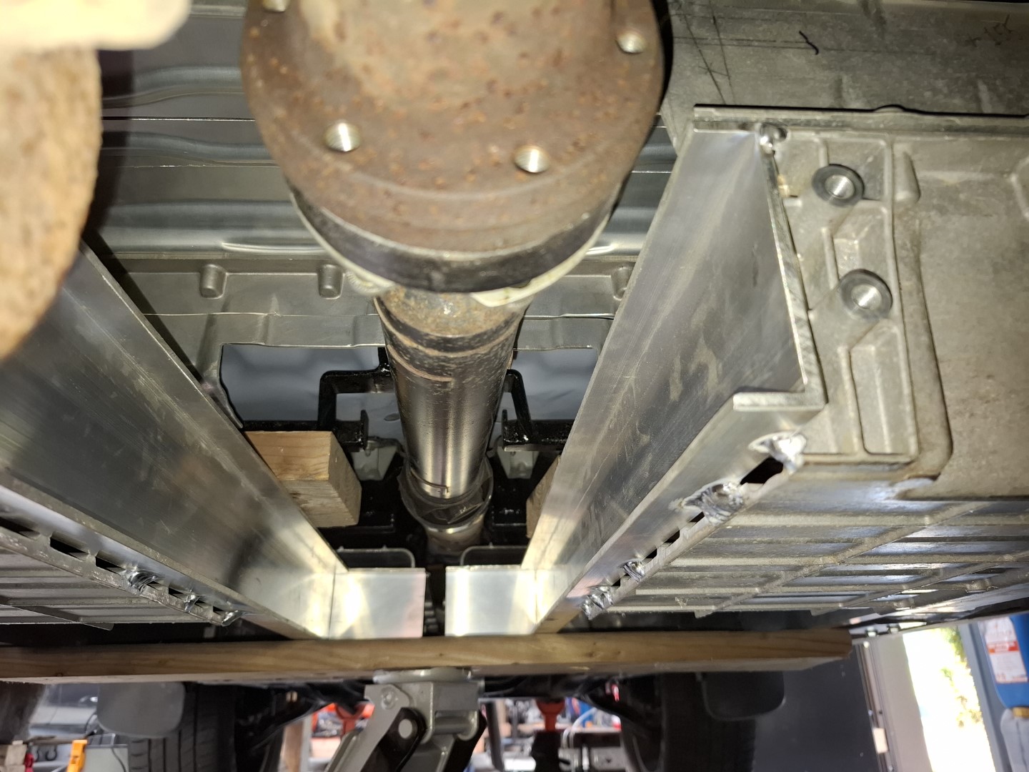

Battery boxin':
Got the aluminium welded battery box back and working on a mounting detail that makes use of the original battery box mounting frame. Keeping the original transfer case and the rear prop over complicate things a little!
Works out well reusing the original X5 pack HV connector and swapping the S-Box for more capable contactors. New low voltage connector located and original BMS master ready for use with SimpBMS
Cradle will be fixed to the original S-Box and BMS mounting plate
Ready for some testing with the latest ZV release

I'll be reorginising the order of the modules compared to the original X5 pack layout, which means the original BMS slave connectors don't reach or are in different order.
Anyone know if the BMS loom needs to retain the order of modules or if its ok to connect them to the closest modules regardles of order!?
m.art.y
- Posts: 713
- Location: UK/EU
- Has thanked: 38 times
- Been thanked: 37 times
Re: [WIP] L322 RR Vogue - The beached whale
Without S-Box you will be missing the shunt. While you can use simpBMS voltage reading you will still need at least a current sensor. You will need that for fast charging and to enforce any current limits in ZV. In the X5 S-box contactors are somewhat uprated but I was thinking if it could be possible to use the S-Box still but connect other contactors to it if need be.
The battery module order should not matter, as I think the address is assigned automatically by the position within the chain but I'm not 100% sure.
