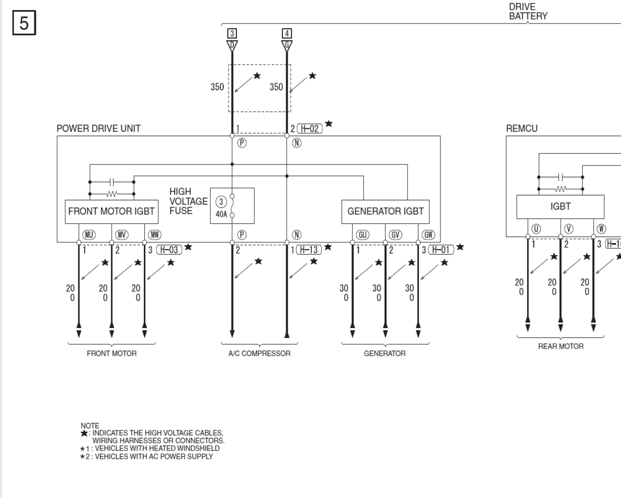

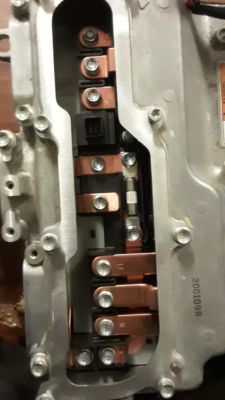

Hi guys
I am using the front generator motor with the front inverter for our ev setup.
Can someone please tell me what the connections on the attached pic are.
I need to know where the dv voltage goes and which 3 terminals to connect to the motor.
