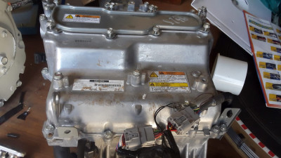

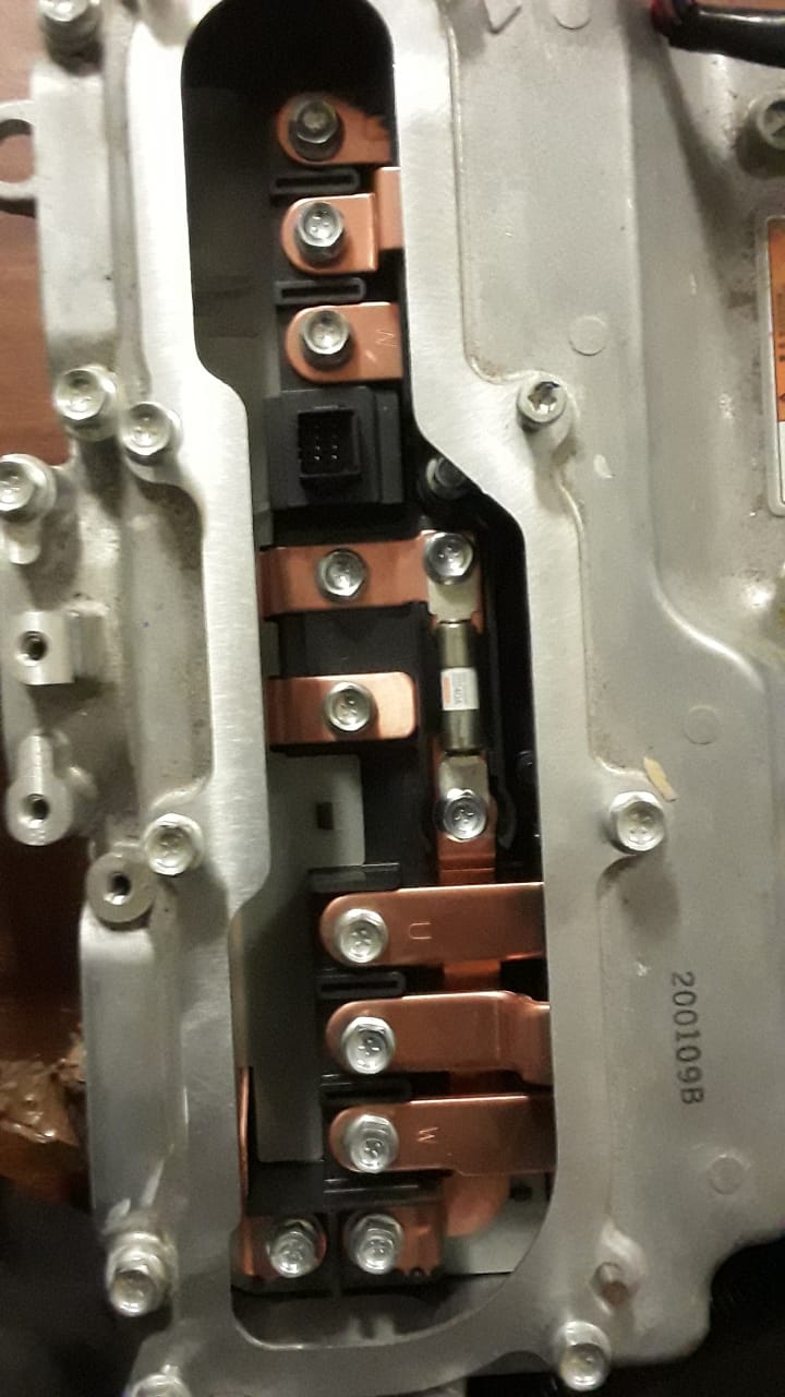

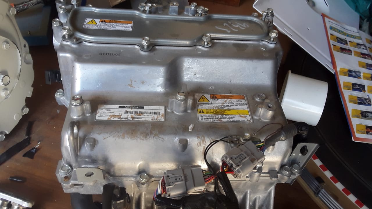

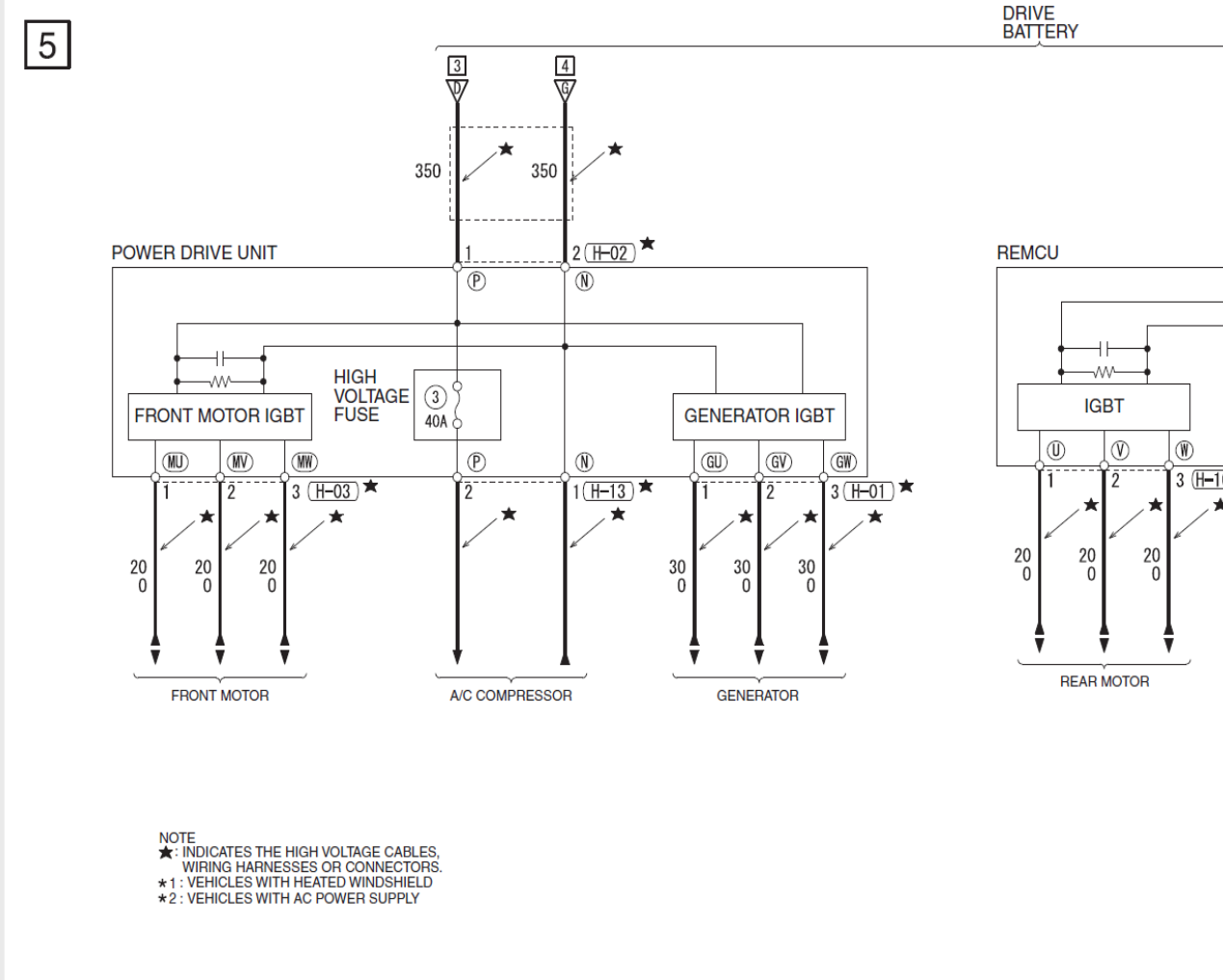

Hi guys
I am using the front generator motor with the front inverter for our ev setup.
Can someone please tell me what the connections on the attached pic are.
I need to know where the dv voltage goes and which 3 terminals to connect to the motor.

I have the same setup in my Triumph spitfire, the generator as a motor and the original inverter. But I got a couple of problems, first the rpm is limited, 1000rpm max one direction and 6000 the other direction. And the max phase current I got was about 230 amp regardless the rpm, the torque reported by the inverter never goes above about 70Nm. The setup as this is usable i a lightweight car but not ideal. I need to start in the first gear because in the second gear the 70Nm is just not cutting it. Yes it's works but very slow. And to go 100kmh I need to go to the 3e gear because I run out of motor rpm. And also I run the setup on 96s and the setup runs original in 80s, is was working on a low soc 96s battery but when I charged the battery the inverter was refusing to work. I needed to change the battery measurement resistor array values to let the inverter think it is measuring a 80s battery.
Last week I put a inverter with is running the openinverter firmware and that gives the motor(generator) is full potential! A can run 400 a 500 amps phase current and also no rpm limit anymore. I can start from 0 in 2e gear now and it goes faster then previous in first. And I can go easy over 100kmh in second gear now. So no chancing gear anymore and a lot more power!
So maybe you get more out of the original generator/inverter setup but then you need figurate out how. I'm curious to see if the motor on this inverter on the motor output has more power and no rpm limit. I have tried to run the inverter on the motor output of the inverter but it's was only very slow with almost no power..
Hope this helps you
