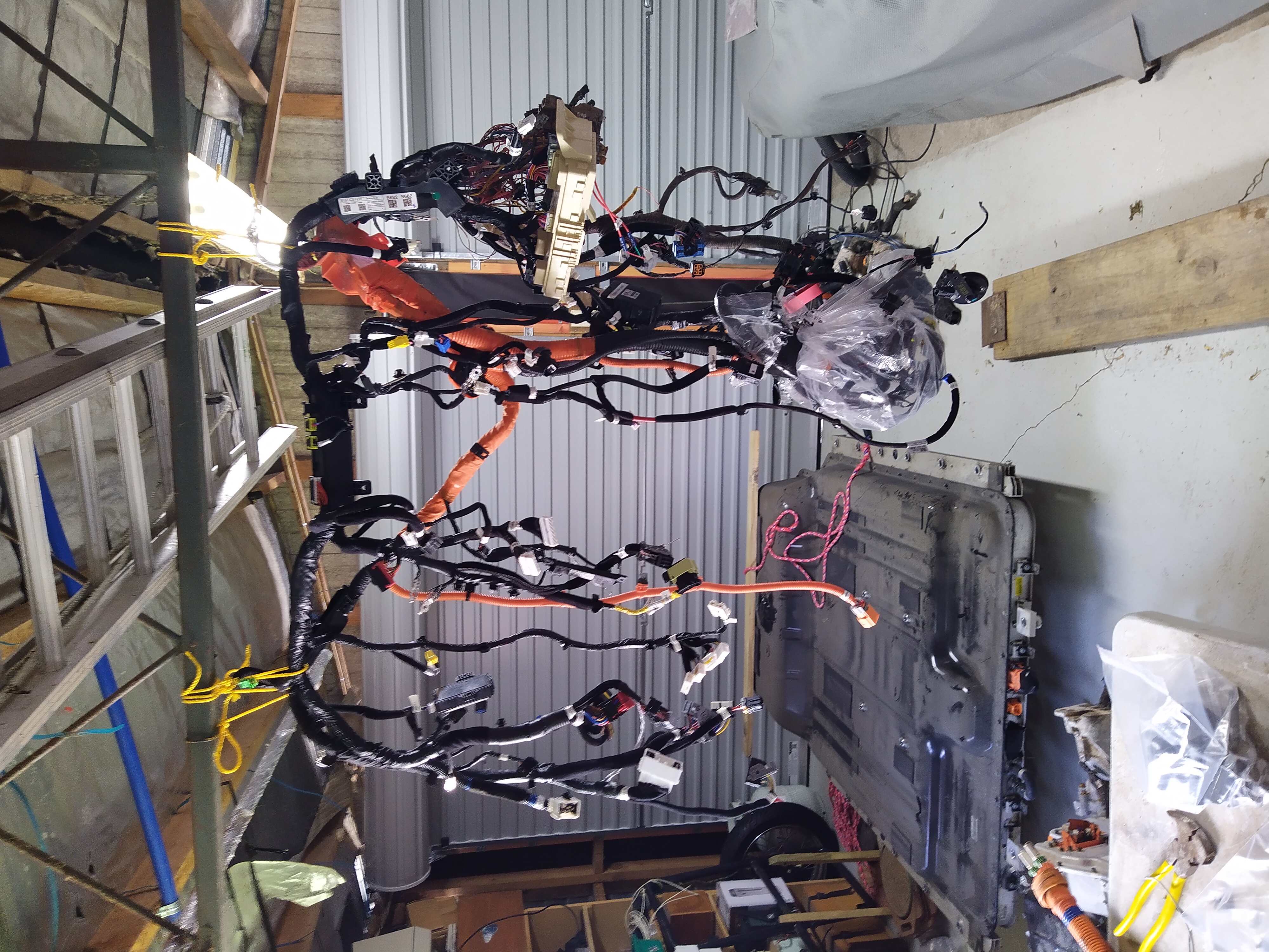

My car is a bit of a mess around the front, fuse box is crushed and the HV connection box got ripped off. The reduction box has the rear lug broken off taking 1/2 the output bearing mount with it.
I've just finished remaking the straps from the connection box to the inverter and charger. I now need to work out the wiring for the connector into the connection box, connector was shredded.

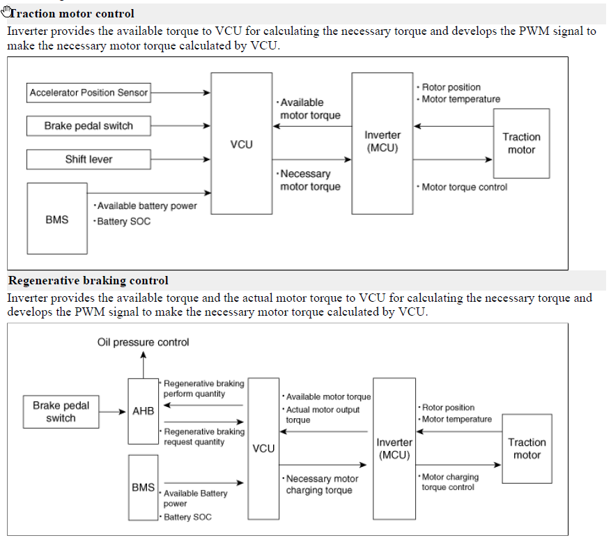

I can across this drawing in the manual showing communication between the VCU and the inverter.
When I get a bit further on I might investigate the inverter to see if it's possible to interface between the VCU function and the MCU function.
Could be a simpler point to control, or not

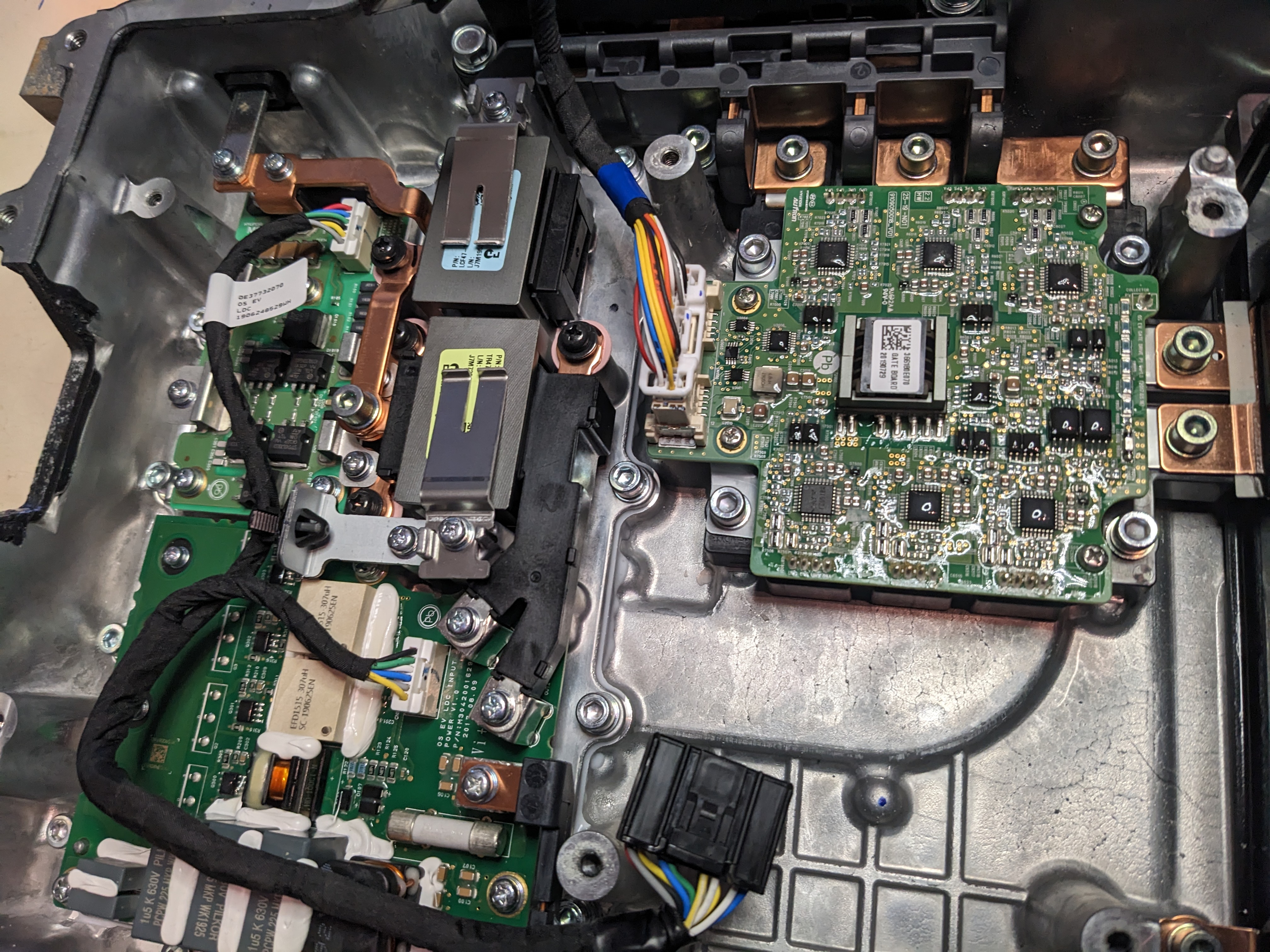

Pelland wrote: Sun Oct 13, 2024 1:59 am When I get a bit further on I might investigate the inverter to see if it's possible to interface between the VCU function and the MCU function.
It's a very good idea. I had the same thought, but didn't get too far with it - the VCU and the MCU are co-housed on the same PCB (see post about halfway up the thread). That board has two PCAN connections and I thought there's a small chance that one might be VCU and one might be MCU and they could be communicating between each other via CAN (plausible if the original R&D was two modules and then they got combined in a revision). However I haven't tried to confirm this in detail - keen to see anything you figure out.

projectgus wrote: Tue Oct 15, 2024 10:40 am That board has two PCAN connections and I thought there's a small chance that one might be VCU and one might be MCU and they could be communicating between each other via CAN (plausible if the original R&D was two modules and then they got combined in a revision). However I haven't tried to confirm this in detail - keen to see anything you figure out.

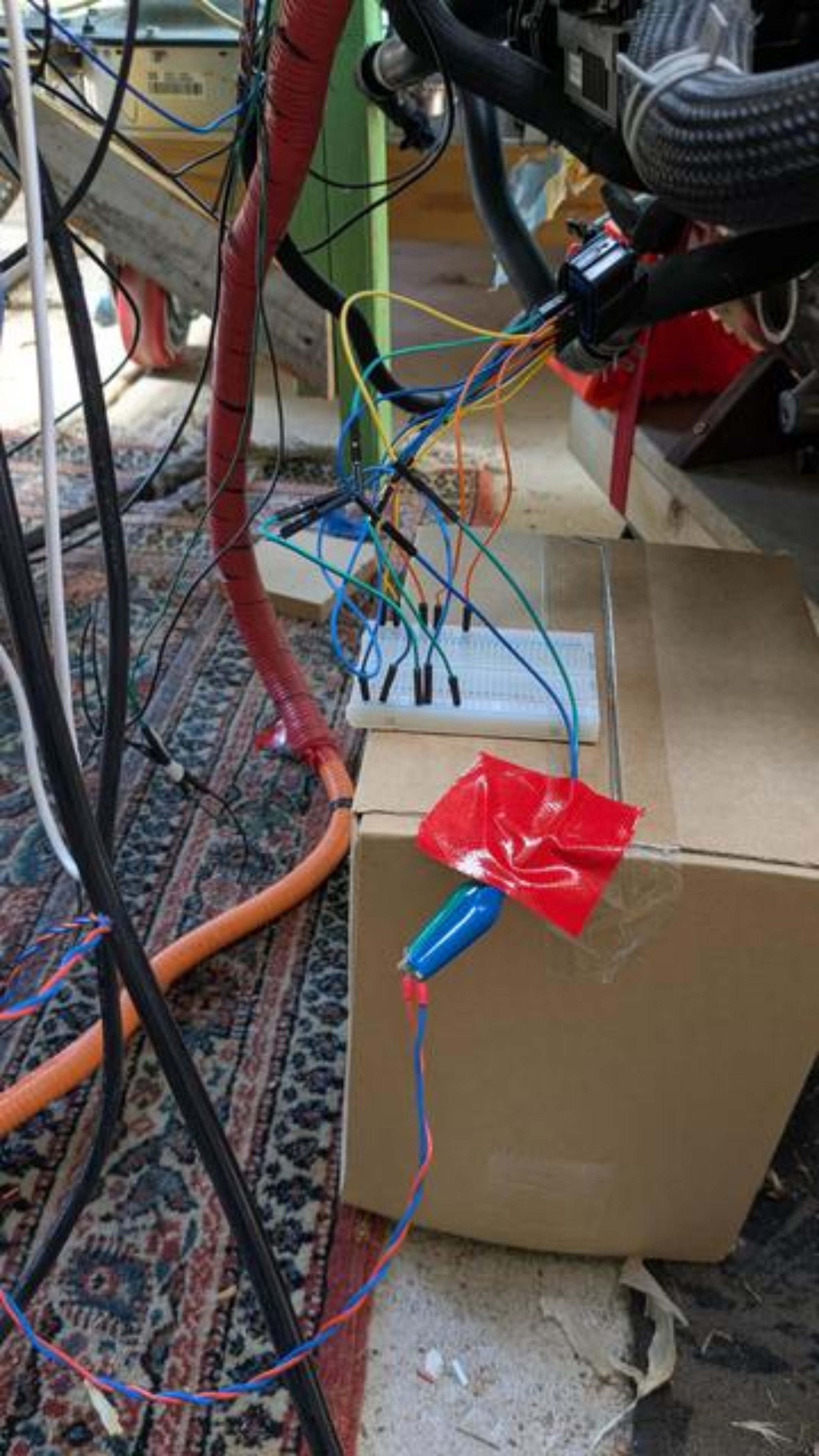

I had the opportunity to unplug the CAN junction connector on the motor stack and split out each module individually via a CAN bridge. Check out the dubious signal integrity:
The "MCU" CAN interface on the EPCU (pins 28 & 29 on the EPCU connector) doesn't seem to send any CAN messages at all. Even diagnostic requests, where it looks like there are separate UDS addresses for accessing the VCU and the MCU, all seem to go via the other "VCU" CAN interface (pins 9 & 10).
When I totally disconnected the MCU CAN bus connection the VCU still went into Drive, applied torque, etc. The only difference I could see is a fault code appears - U0146 which is apparently to do with gateway communications(?)
Totally disconnecting the VCU CAN bus connection caused everything to stop working - no Ready, can't drive, etc. So I guess the second interface isn't a redundant failover if the first one isn't working.
So... I'm not sure what that's about, maybe it's a leftover from an earlier stage of the design or maybe it serves some other purpose. But it seems likely to me that to control the MCU without going via the VCU would require internal modification (or replacement) of the EPCU circuit board.
Upside of these experiments, the DBC file for Kona PCAN messages is slowly filling out! The logs from this experiment are also available if anyone would like to do more analysis.

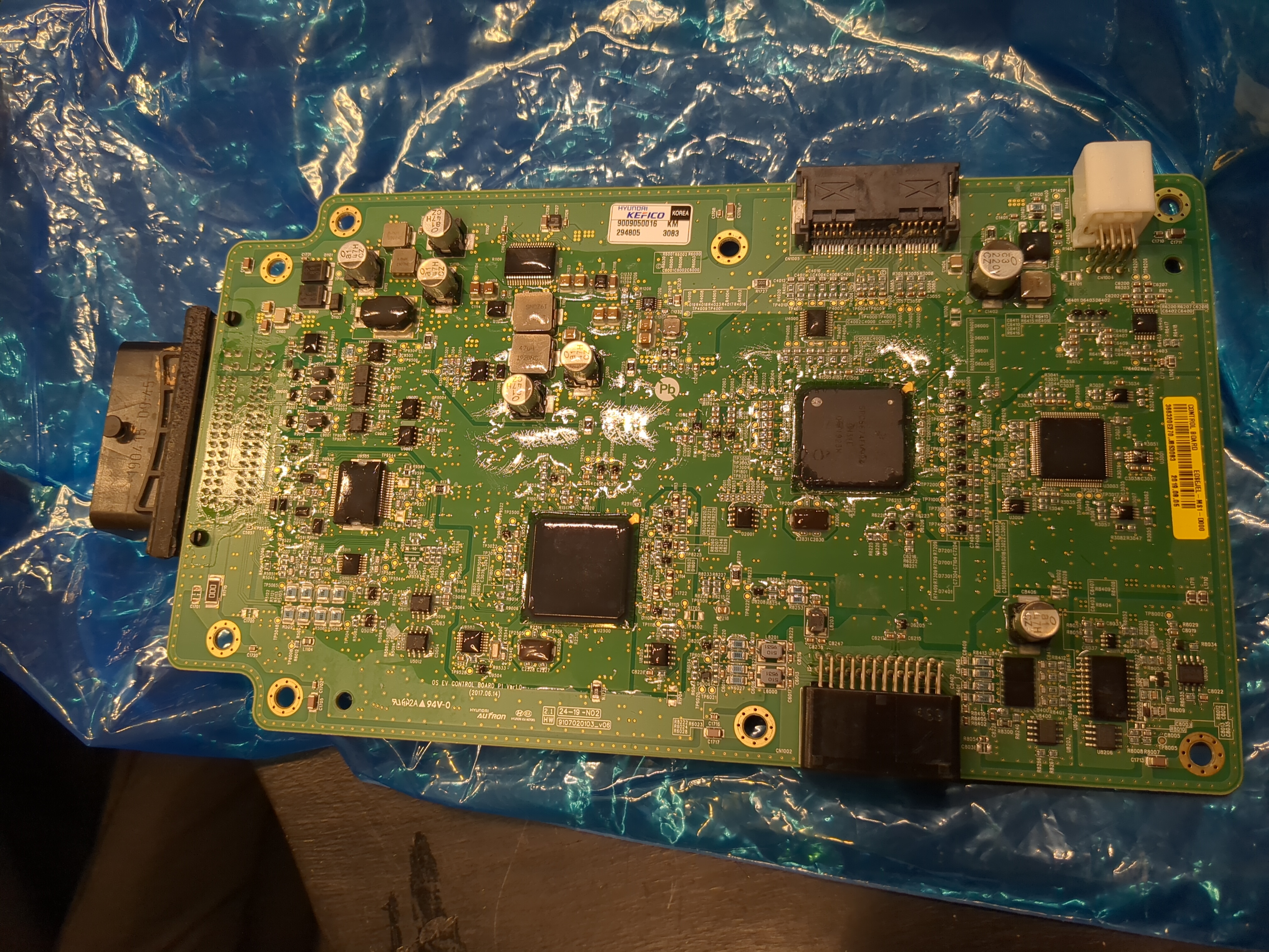

How similar do the EPCU of the Kona and of the Ioniq look like? Some Ioniq pictures I have here: https://github.com/uhi22/Ioniq28Investi ... ontrolUnit
Are these completely different designs? I would hope that they did not re-invent everything, and we could learn from the analysis of both. I hope to get a "defect" Ioniq EPCU soon to have a look at.

uhi22 wrote: Fri Nov 22, 2024 11:45 am How similar do the EPCU of the Kona and of the Ioniq look like?
Very similar, if not 100% the same. Maybe the IGBTs are lower rated, and I guess firmware is probably tuned differently...?
Your Ioniq DBC file was a great starting point for the Kona DBCs I linked in the last post. Some things turned out very different to what is in there, but a lot seems to be identical.

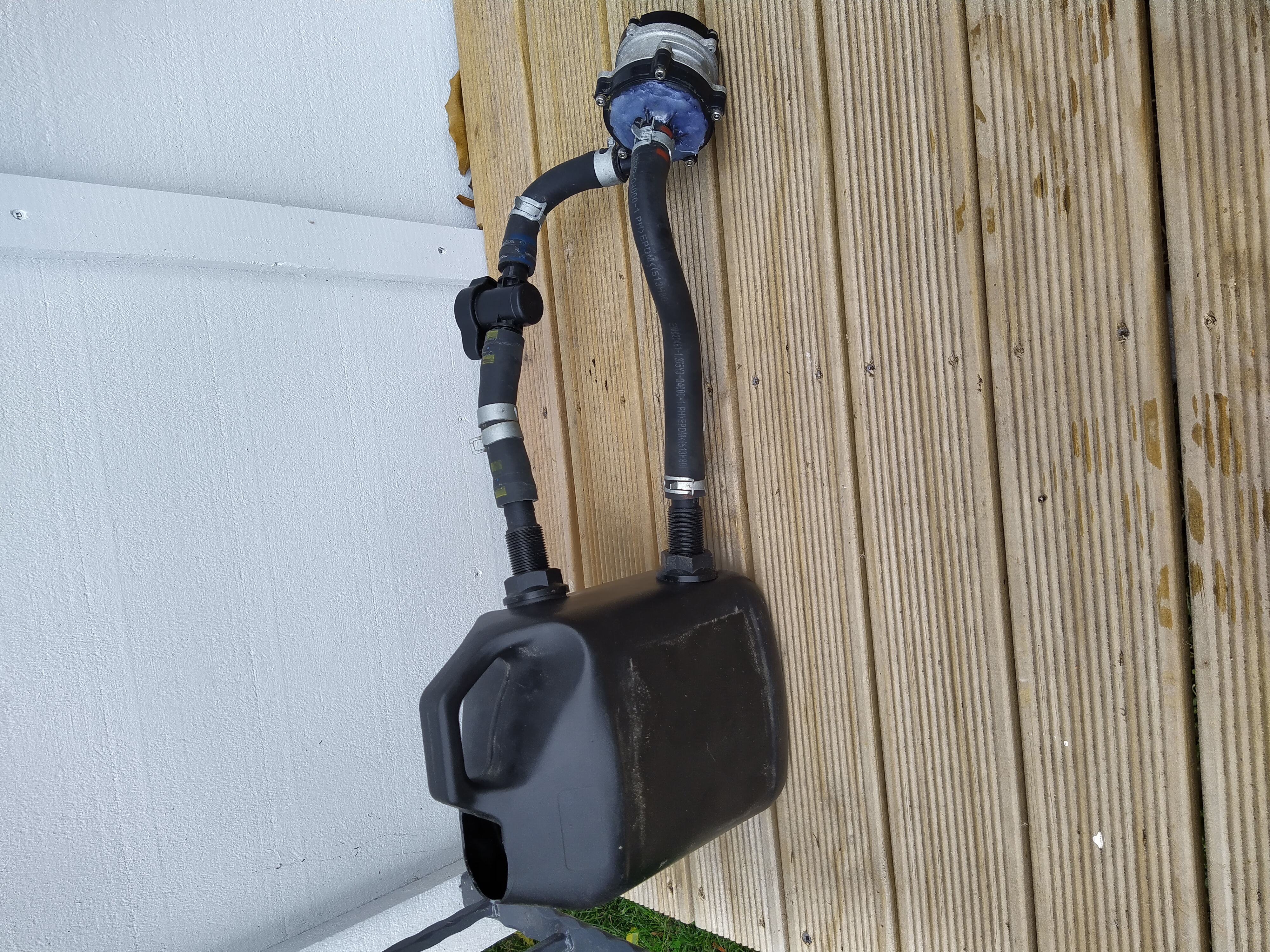

Pelland wrote: Mon Nov 25, 2024 2:50 am I started playing with the water pumps
Nice work with the pumps! I actually just figured these IDs out as well. OK if I merge some of your findings into the DBC files I'm maintaining?
The pumps have "run dry" protection so you may find you get different behaviour if you plumb some liquid in.
I haven't confirmed it myself, but I think uhi22 found the pump request sent by the inverter (should match the pump with status 0x570). See this byte in message 0x523: https://github.com/projectgus/kona-ev-d ... n.dbc#L278 - I have some logs where both pumps spin up, so can probably find the equivalent message to start the BMS pump as well.

Started testing the front pump with water connected and so far I can't get any of the 3 alarm bits that I was seeing under various conditions without water.
With flow fully open the pump will still cycle when not receiving CAN, but doesn't produce any alarms. Restrict the flow slightly and the pump settles to a steady speed.
So more testing still to be done.

Pump progress.
I discovered a red herring with the PSU I was using. When the pump does a rapid ramp up the current limit bites momentarily causing a voltage dip.
So keeping the current under control for some tests and using a fixed 20A supply for others I've managed to characterise the water pumps.
See attached spreadsheets.
- Updated And again error in low volgate threshold
Front pump only listens to the inverter on 0x523 for both speed and purge.
Rear pump listens to the BMS (0x4DE) for speed and the inverter (0x523) for the purge signal.
Bit 0 is a general alarm flag indicating a specific alarms in byte 7.
Only 1 byte (byte 4) I don't understand the meaning of. It seems to be something like flow rate, but thats just a random guess.
It's been a great little excesize in CAN hacking and has improved my understanding a lot. The more I use SavvyCAN the more I like it.

What happens on a "purge", exactly?
Apologies, I've been looking at the pumps so closely I forgot that not everyone has been doing that.
Part of the repair process for anything to do with the cooling is to initiate a "purge" to remove any air trapped in the system. Needs the expensive Hyundai service software to that though.
With no water the pump cycles at ~0xC7 every 2 sec on for ~ 0.8S.
With full water flow it pulses very rapidly for a while then settles down to running at 0x6A.
With water but flow stopped it starts up at ~0x97 and runs continuously.
So I'm guessing there some algorithm the pump runs depending on current draw.
I'll see if I can update the spreedsheet in my previous post.

Just put all the logs etc up for the water pumps.
https://github.com/Pelland-Coupe/EV_Hac ... ater_pumps
And we have a wiki page too.
https://openinverter.org/wiki/Hyundai_K ... lant_Pumps
Discovered error in lowvoltage threshold in spreadsheet, prvious post has been re-edited to correct. 7.9V on 9V off.
It looks like 8V is the lower limit used across a lot of things as its a standard criteris in a lot of the service sections - Battery 8V to 16V
