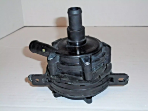

Tesla Model S/X / Nissan Leaf Coolant Pump
Tesla S / X coolant pump
Tesla Model S/X Coolant Pump
Both the Model S and X use a very capable (but curiously unbranded) coolant pump. Internet research seems to indicate it may be made by VariMax, though there are so many Tesla part numbers it's hard to say which actual model it is.
The Nissan Leaf also uses this or a very similar pump.

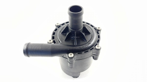

Bosch PCE (VAG and others)
Bosch PCE Coolant Pumps

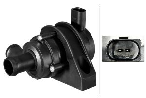

HELLA 8TW 358 304-601 Auxiliary water pump
VW coolant pump

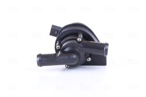

NISSENS 831060 Water pump Auxiliary water pump
