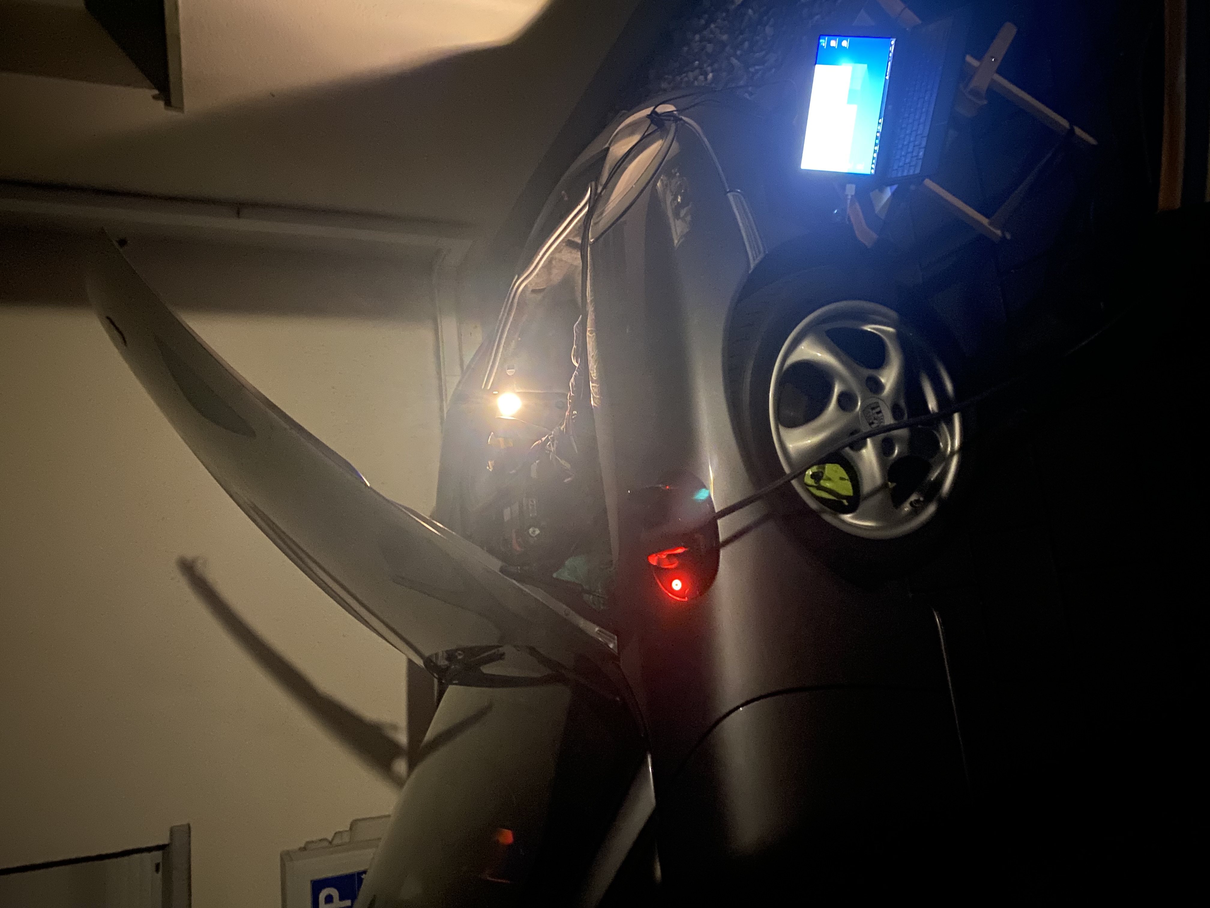

Post by modellfan »
Car is charging with the teensy code. @mitchy I would really appreciate if you can share your zombie Vcu code so we can join forces . Whould be sad to redo , what you already did.

** Remove/disable the simulate function in 'vw_mlb_charger.cpp' before using **
Ran into some issues when testing, but it does initiate a charge.
You may find it's too tied into signals from Zombie related to BMS (such as Cell Temp and Voltages).
I stripped out all of the UDS stuff for now, Leaving that for the CAN-Bridge... Or until Tom approves another 'config' toggle on the Zombie web interface (Which is already pretty overwhelming)
It should have a pretty good basis for CCS charging; So if you happen to have your system wired up with the DC Bus connections, I'd be interested to see if you can play around with the code to get it to work.
