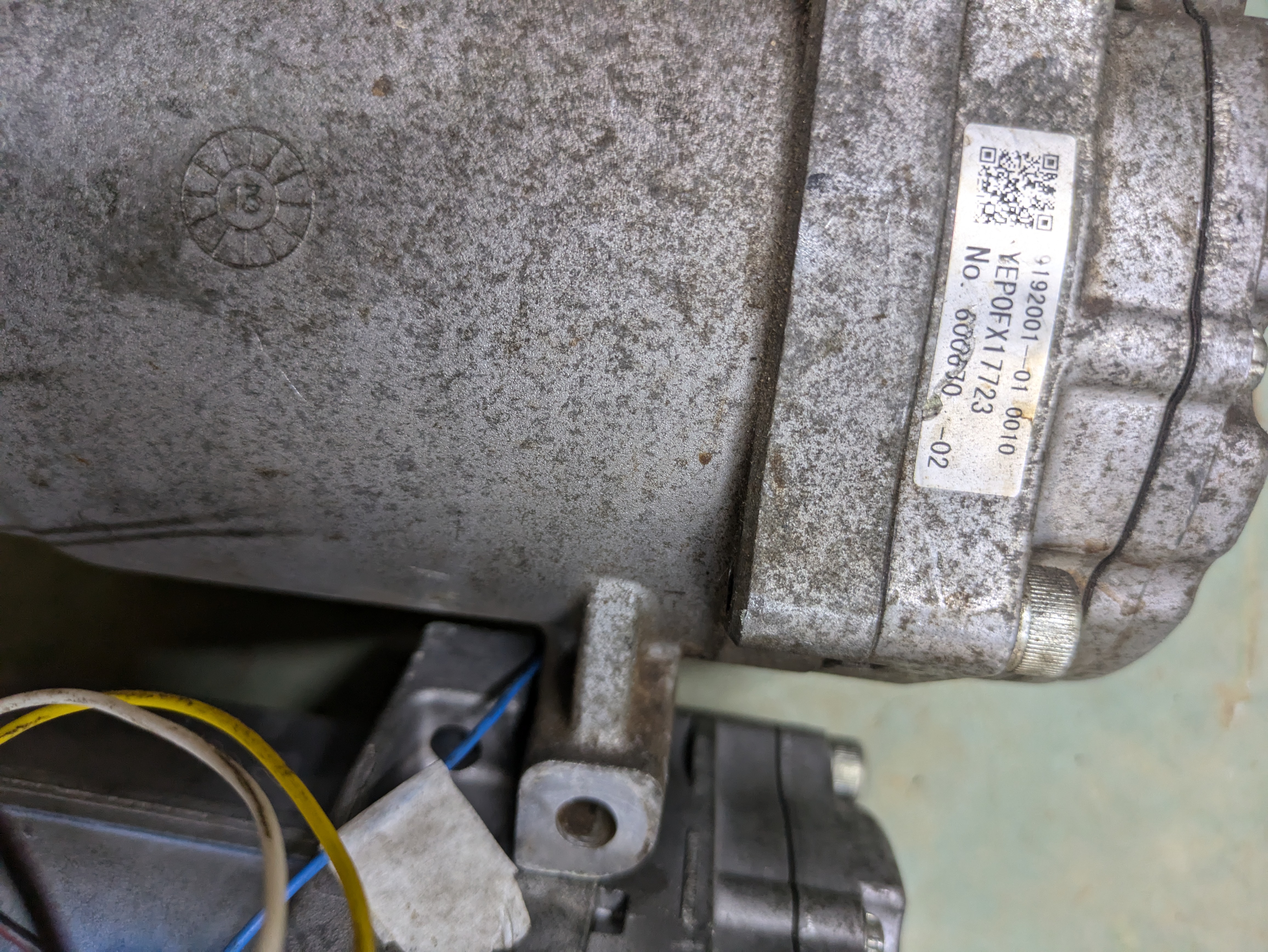

I Have two compressors with part numbers 9192000 AND 9192001

Can you please take pictures of your compressor and share them?
Re: Nissan Leaf A/C compressor 92600-3NF0A
These are the images from the eBay listing, since it is hard to take a photo of my compressor in my vehicle.
It is a ES27C according to the listing, and it is from 2015 according to the listing.
I think these are used in Nissan Leaf SV and SL editions.

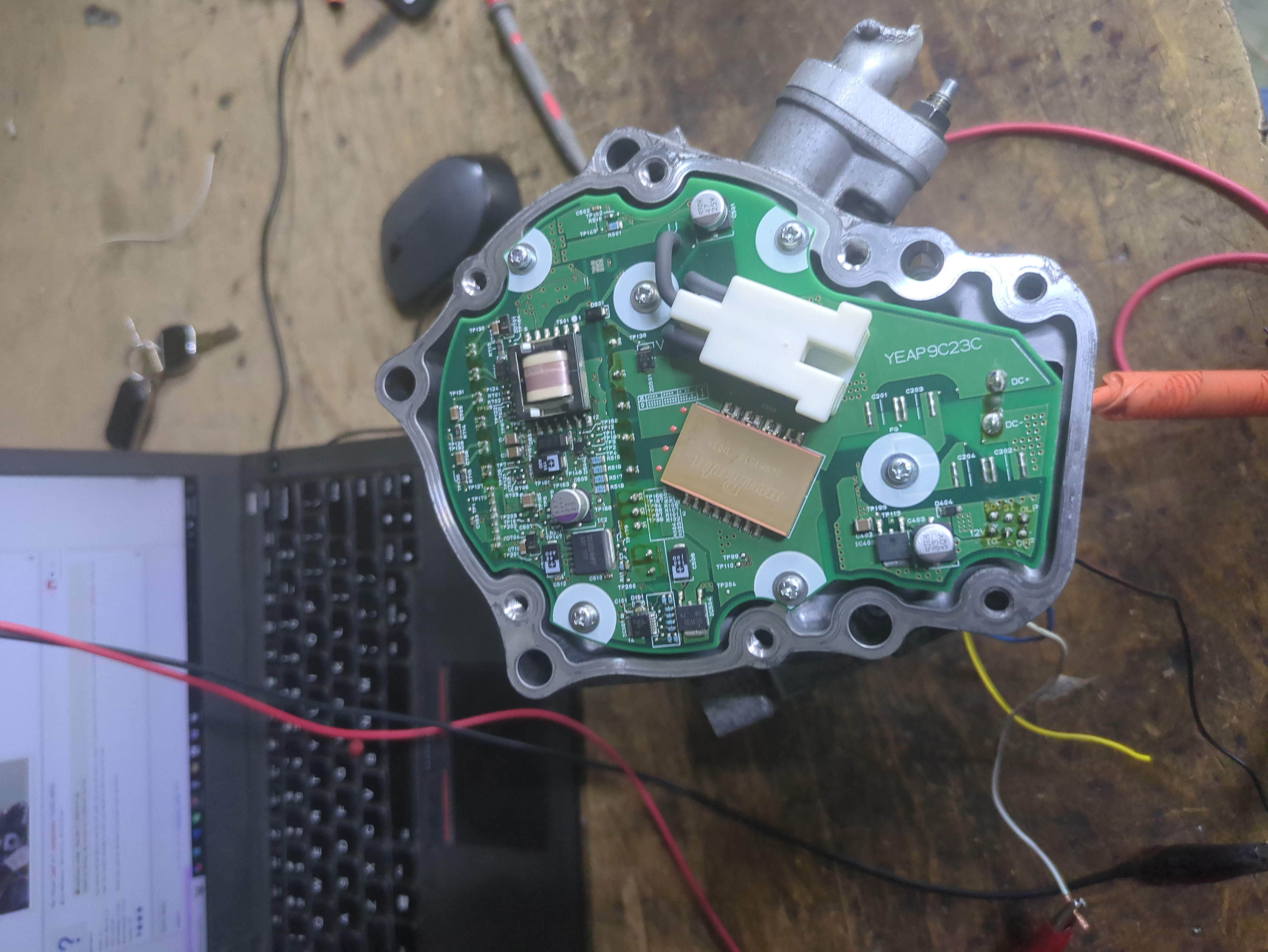

I Won't be continuing to use my earlier compressor from a GEN-1 but 92600-3NF0A as it just arrived, thee low voltage connector is well documented by Johu but i couldn't identify the polarity of the HV from this chat, I one can kindly share ,thanks

As always a meter in diode mode will tell you. If it displays 0.7V or so you have found reversed polarity. Or just connect your lab supply, see in which direction it shorts out.
aah,thanks,ive also found out that the compressor is exact part number but my low voltage pinout is on pins 2,4 and 5.guess the exact same test will help me get the polarity
Nice work, please keep us updated.
Also, the Nissan Leaf shop manual shows the polarity, though it was difficult for me to find. Let me know if you need more help on this.
