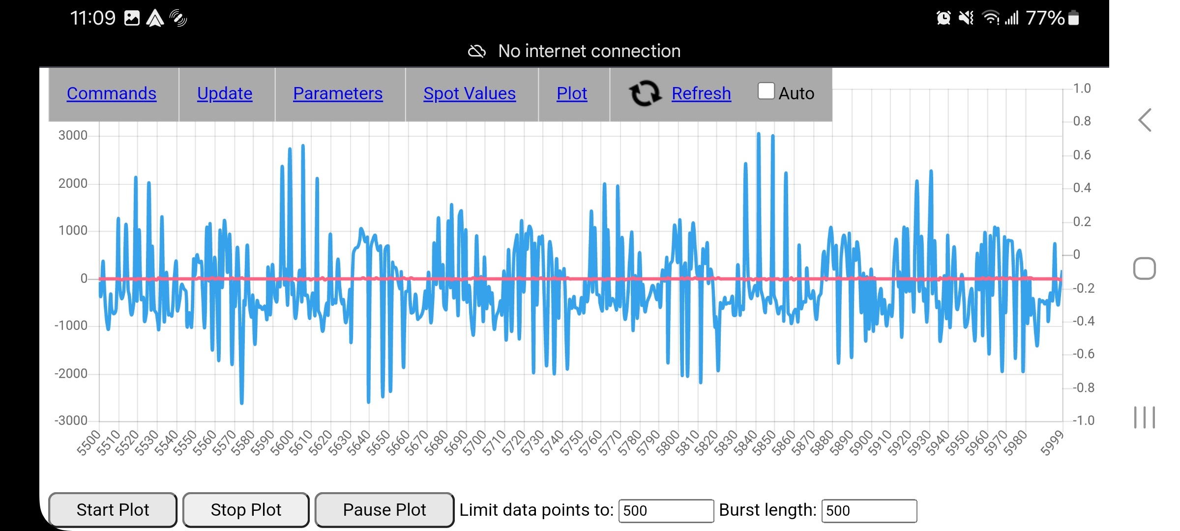

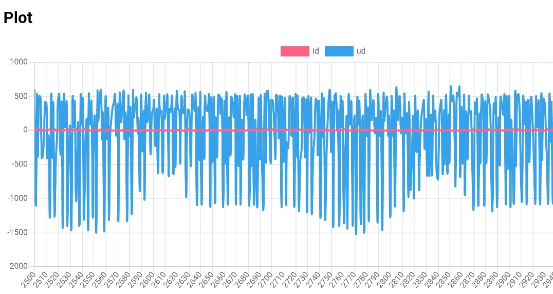

Zieg wrote: Sun Sep 08, 2024 7:16 pm Okay, adjusting syncadv seems to have fixed the high speed unintended acceleration after full throttle, but I had to set it to 9, not 11. I don't understand the physics well enough, but I was wondering if maybe that's because the motor is mounted in reverse?
Follow up to this, I increased my fwcurmax after realizing it should probably be -500 instead of -400. That got be better acceleration at higher speeds (BMS reported 130-some kW and the battery wasn't even full!) but as soon as I let off the accelerator, it started accelerating on its own again.
I noticed the parameters wiki page says this about syncadv: "Must be set so that ud remains at 0 when coasting below field weakening speed". So I did some slow-speed coasting and ud was bouncing between 500 and almost -1500. How close to 0 SHOULD it be? Or is it more like it should be 'centered' around 0? I tried reducing syncadv from 9 to 6 and that seemed to shift the numbers to something closer to +/- 1000. I didn't dare drive faster at that setting though.
Is it possible that I should be setting syncadv to something like -10 (Or, I guess, 65525) because the motor is running in reverse?

Zieg wrote: Sun Sep 29, 2024 7:02 pm Or is it more like it should be 'centered' around 0?
yes
Zieg wrote: Sun Sep 29, 2024 7:02 pm Is it possible that I should be setting syncadv to something like -10
No, that is handled in code
advancedAngle = angle + dir * FP_TOINT(FP_MUL(Param::Get(Param::syncadv), frqFiltered));
Could you plot frequency and iq as well?
Zieg
Posts: 378
Has thanked: 165 times
Been thanked: 159 times
Re: Inverter Firmware 5.35.R
Post by Zieg »
Okay, perfect, thanks. I'll grab another log with frequency and iq as soon as I'm able. I'll have to do some more testing with different numbers but it's looking like I'll end up somewhere around 6 for syncadv. Very interesting, I'm glad you left it as a parameter rather than hard coding it!

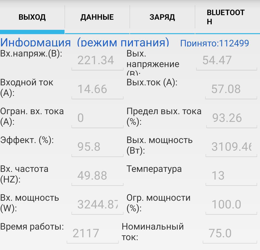

Is it possible in future releases to increase the charging current limit to at least 250 amps instead of 50?
If you use boost mode from a 220 volt home outlet via a diode bridge, everything is fine and the 50 amp limit is sufficient.
I use a 72-cell battery and a full voltage of 304 volts.
for boost mode, I use a 50 volt 75 amp power supply, but the firmware limitation does not allow using all available power.
in the future, I would like to use three such power supplies in a type-2 three-phase network, but the total current value would be more than 200 amps, and the setting allows only 50

Romale
Posts: 542
Location: Romania
Has thanked: 327 times
Been thanked: 92 times
Post by Romale »
the first screen is the operation of the inverter in boost mode. The input voltage is 54.5 volts. The input current is 57 amps.

Posts: 6969
Has thanked: 455 times
Been thanked: 1771 times
oh, crazy :) Yes can change it
