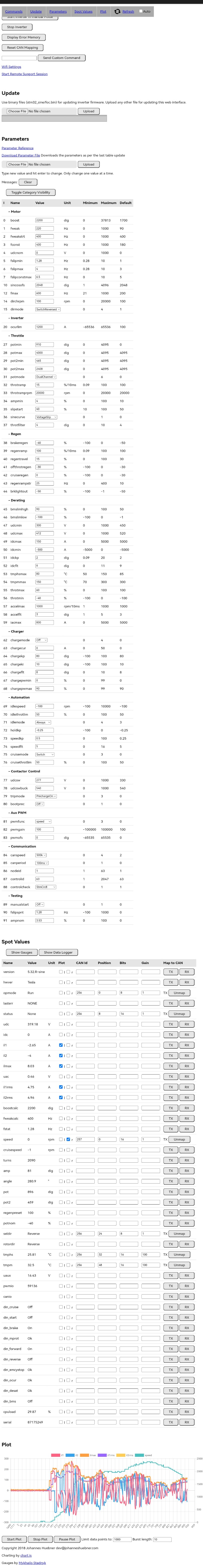

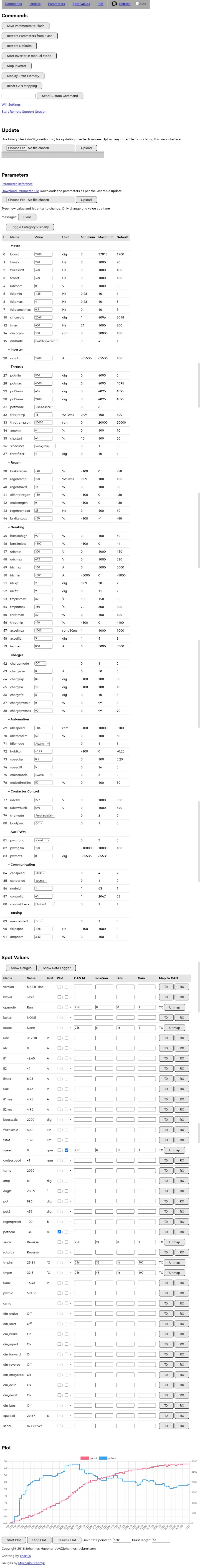

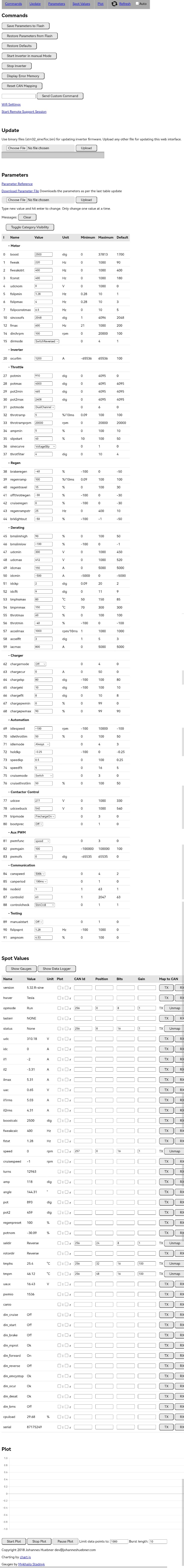

Hello, everybody.
I'm trying to get a sense whether my drive is behaving correctly. I'm reading what I'd think high currents on my ISA shunt - 40..80A (depending on flat road, uphill or downhill)- at 40mph (miles per hour). Is this normal?
Bellow are some captures from the drive web ui. I can try figure out how to map ISA current reading to drive speed too if needed. Perhaps my parameters aren't quite there.
This is a VW type 2 camper bus.
Thanks in advance.
Thanks in advance.

Re: SDU high current consumptions?
That seems very reasonable for crusing at 40mph in a brick shape.
You need to graph/log IDC, UDC and speed. A T2 Camper is not efficient at all so will take quite a bit of power to cruise at 40mph or higher.
You mention 40-80 amps, what is the voltage during that draw. Your spot values show 320V so you are talking between 12kW-25kW

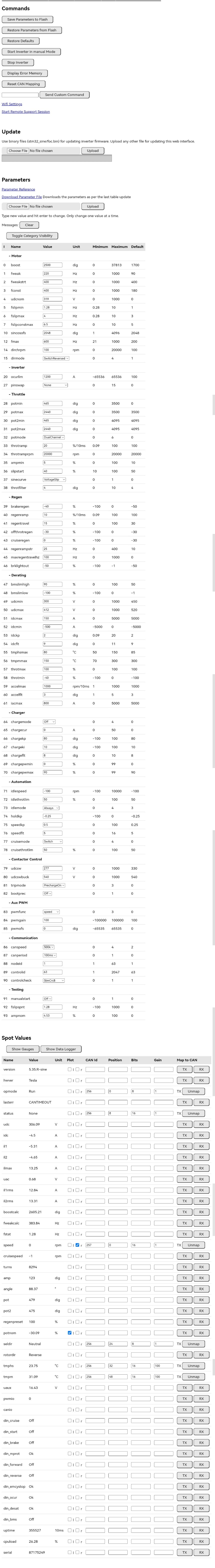

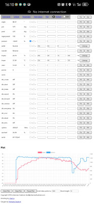

Some data of acceleration down the hill close to 40mph. Stopped for the day as my inverter started going into 60C. But another problem I'm noticed is that starting from uphill is difficult - as if starting from the 5th gear in manual when uphill - takes at least 10s to accel.tom91 wrote: ↑Tue Aug 20, 2024 9:24 am You need to graph/log IDC, UDC and speed. A T2 Camper is not efficient at all so will take quite a bit of power to cruise at 40mph or higher.
Udcnom as 0 looks off to me, though I don't use the sine firmware. Shouldn't this be your nominal voltage?
Look at catphishs params for reference https://openinverter.org/parameters/view.html?id=27
I only found the following reference in the code for the udcnom. Looking at the code and running tests, I don't think it helps with the current consumption as my udc is below udcnom at the moment.
Perhaps this is somehow related.
if (udcnom > 0)
float udcdiff = udcfp - udcnom;
float factor = 1.0 + udcdiff / udcnom;
//increase fweak on voltage above nominal
fweak = fweak * factor;
//decrease boost on voltage above nominal
boost = boost / factor;
Do you feel like my other parameters seem off for this type of vehicle? Thank you.alexbeatle wrote: ↑Wed Aug 21, 2024 4:24 am .... starting from uphill is difficult - as if starting from the 5th gear in manual when uphill - takes at least 10s to accel.\

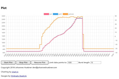

Yes. Thank you. I posted an example of udc, Idc, speed here...
Please let me know if this isn't what you meant.
Oh the graph is at the bottom, what is the speed ratio? as it continues to climb and current drops. Nothing wierd
50A and 320V is 16kW which is nothing for a bus shaped vehicle.
Back to testing after fixing mechanical issues...
Speed ratio ~Drive_RPM/96.8 still trying to find the exact constant, as it's off from the speedometer = phone GPS speedometer reading.
I've updated boost=2500, ampmin=5 and throtramp=5 (don't feel much difference after changing throtramp from the previous 20)
Which now feels like a lot smoother takeoff on the flat ground, but this in turn slightely raised the current draw and inverter temp.
But, if I start from the hill (tried 20% and 40% grade), the car barely climbs it even when I floor the pedal. Short hills, but the temps go up to ~60C from ~40C. As if I'm in 4th gear trying to climb a hill.
Any advice, please?
If at all possible, could somebody please help me figure out the slow acceleration problem? Thanks in advance.
Edit. I have since upgraded the firmware to the latest, added the 10k resistor to one of the channels on the dual throttle and have recalibrated the throttle. My new parameter set and a graph potnom vs. speed (flooring to go uphil). Also pot, pot2 and potnom graph
Edit2: Lowering udcmin to 240 gave me full throttle! Yay. Though I'm not sure why, as when I was plotting my udc it doesn't have major dips, perhaps invisible due to the sample rates.

Yes your potnom clearly was not reaching full.

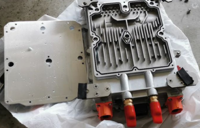

Check you cooling loop and ensure its vac filled. The inverter on the SDU is known for having issues with trapping air.

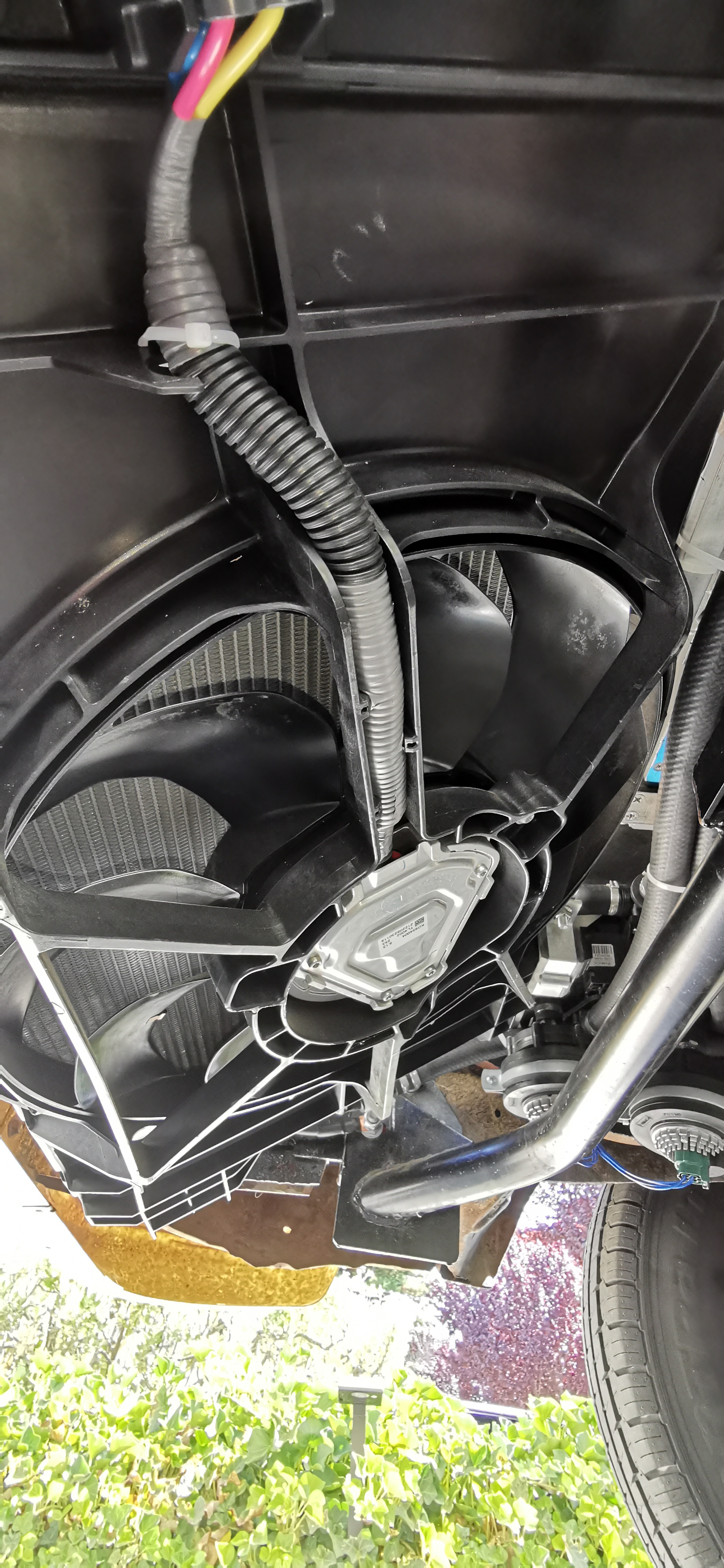

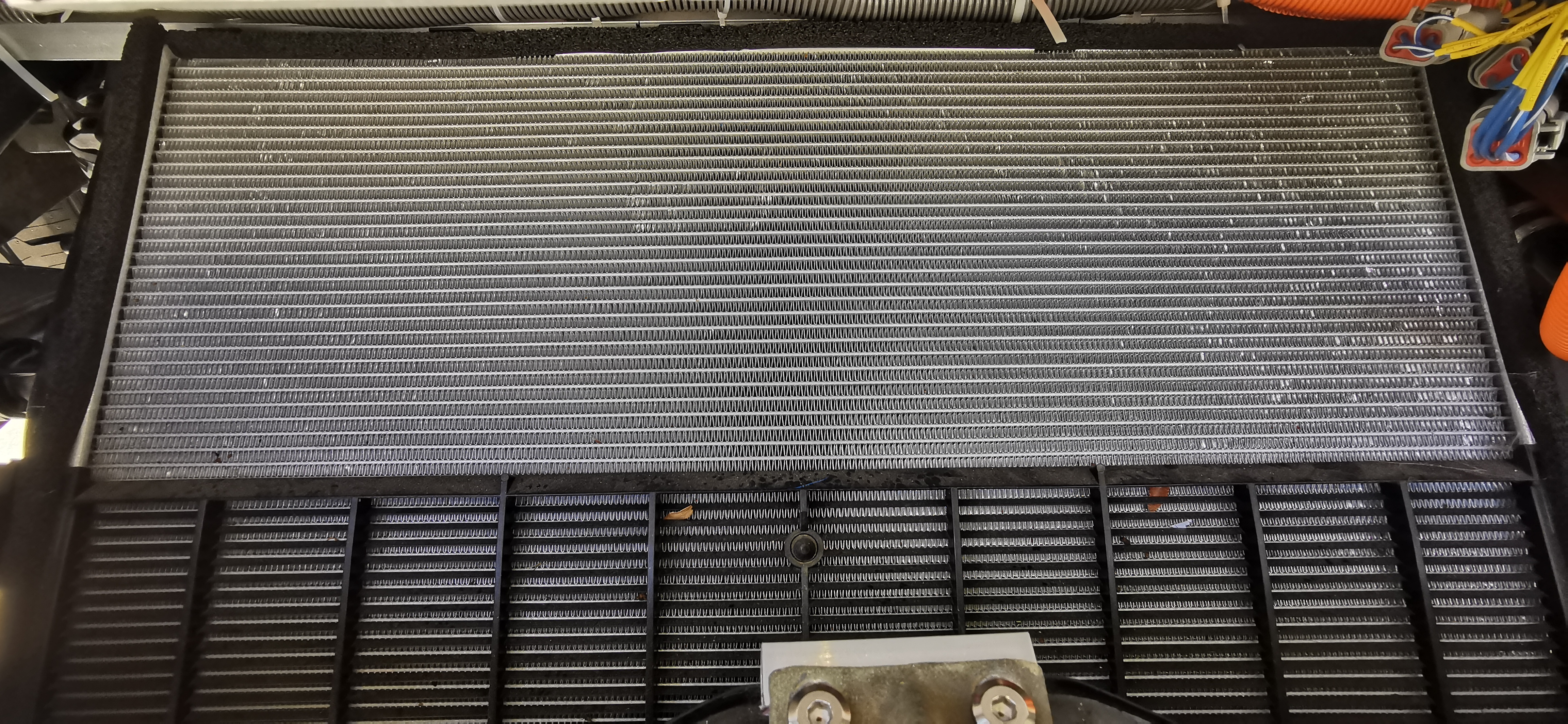

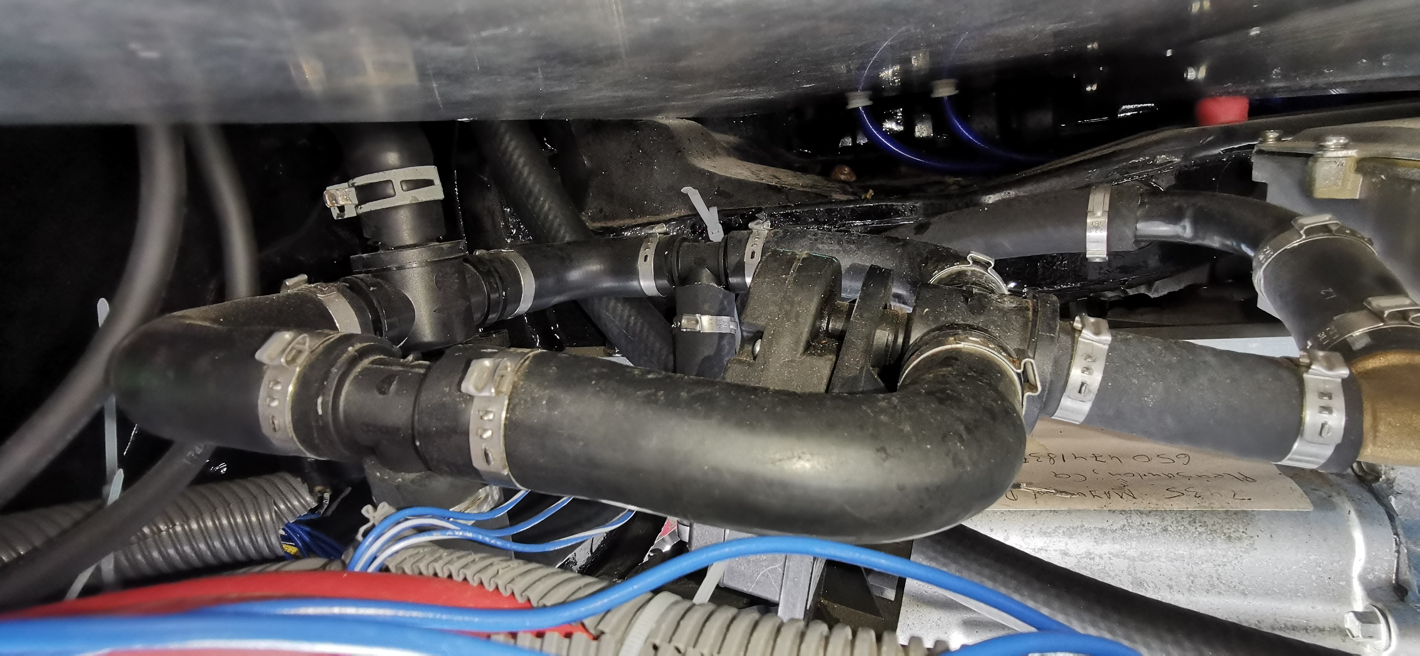

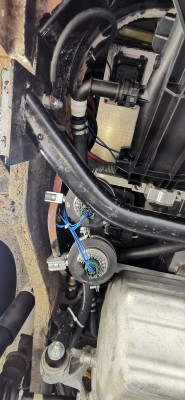

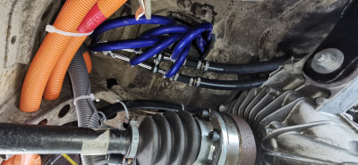

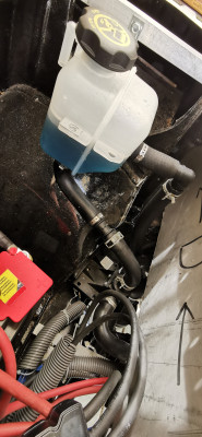

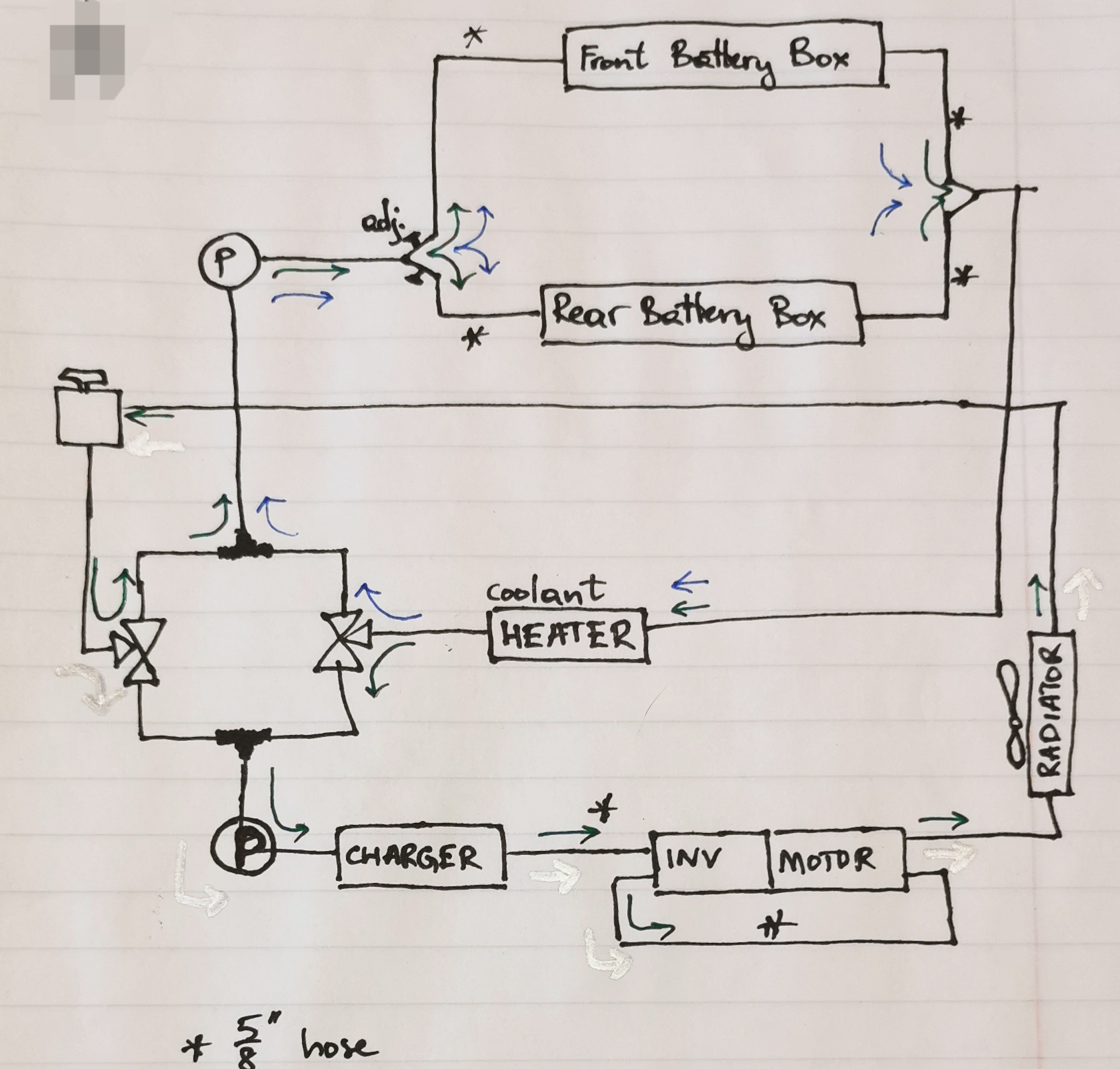

This is the diagram of my cooling setup.
The 2x 3-way valves either put all devices on one series loop (green arrow) or divide into two independent parallel loops (grey arrow + blue arrow).
* indicates where I have 5/8 inch ID hoses, otherwise - 3/4 inch ID hoses. Battery boxes use ZeroEV manifolds and blue are 3/8 inch ID hoses.
Coolant heater, not yet installed. Looking for what I can physically fit.
Radiator/fan - giant from Model 3. Blowing mode - pull. The VW bus has the ears on the side where the air is meant to enter, go through the radiator and pull by the fan.
Pumps - Tesla MS/Nissan/Ford pumps. So far I've been driving with the series loop. Uphilling for 1min makes my inverter linearly reach 50+C and practically doesn't drop when driving on flat and doesn't recover quickly on the flat ground. Gearbox exchanger goes to ~60C when climbing uphil, but then quickly recovers to ~25C on the flat ground (and it's downstream from the inverter!). The batteries stay at 16C..18C.
I don't want to damage the inverter so after 50C I park the car. I tried switching to parallel loop and run the pump and fan on my high setpoints when stationary, the inverter temp lineally drops down, but at the rate of ~ 0.25C/sec. Seems slow.
My fan/pump automation (for now just in series loop):
Battery>33C or gearbox>100C or motor >40C: pump=60%, fan=30% (high flow and low fan blow)
Battery>36C or gearbox>120C or motor >60C: pump=60%, fan=50% (high flow and high fan blow)
Battery<30C and gearbox<100C and motor <40C: pump=30%, fan=24% (low flow and low fan blow)
Even at low flow in series I see the coolant flow circulating through the bottle, so it completes the loop without any struggle.
Ambient temp during testing is quite low <20C.
Not really bad, the inverter can get a lot hotter. The temp sensor is practically on the hottest point. Cool down is not bad but you want to get more temp measurements in your loops to figure out if the coolant has actually warmed up enough in the motor. It might be you flow to fast.alexbeatle wrote: ↑Tue Sep 17, 2024 8:08 pm I don't want to damage the inverter so after 50C I park the car. I tried switching to parallel loop and run the pump and fan on my high setpoints when stationary, the inverter temp lineally drops down, but at the rate of ~ 0.25C/sec. Seems slow.
Which charger you running? The tesla charger is quite a large flow restriction.
Model S had a restricted bypass if one charge is used I believe.
Anyway data is key here, as always more measurements the better.
Isn't max temp = 85C?
Elcon OBC. The coolant fittings do look a lot larger on the outside (20mm) comparing to the inside. Perhaps I should add an adjustable divider valve.

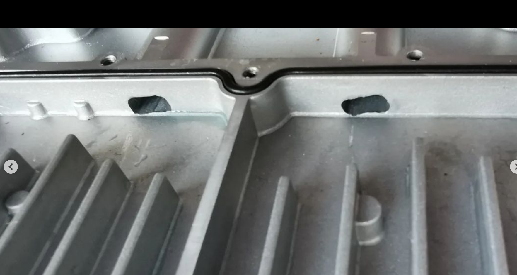

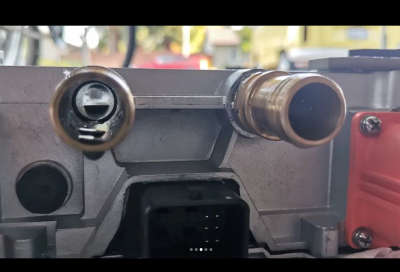

It seems like you have an air bubble in the inverter or coolant is bypassing it somehow. The heat exchanger cooling but the inverter not says this is very likely the case.
You can try to burp it. You need the outlets in the inverter to be the high point, can you jack one side or park on a steep hill to try to burp it with the pump running on high?
I agree with Tom on the vacuum fill. It's likely quicker and less of a headache to drain the coolant into a clean bucket and vacuum fill it with that coolant. Have some extra on hand, it will likely need some more.
The vacuum fill can also help find leaks before there's coolant in the system as a nice bonus.

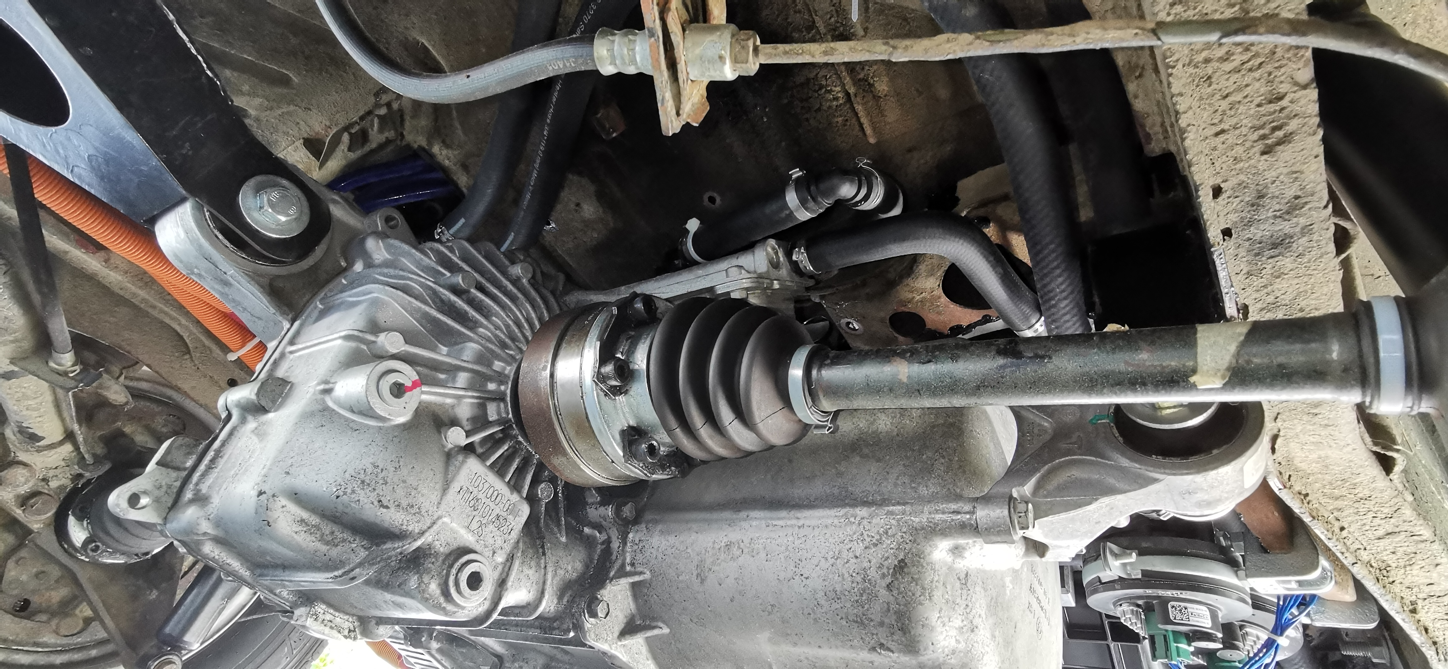

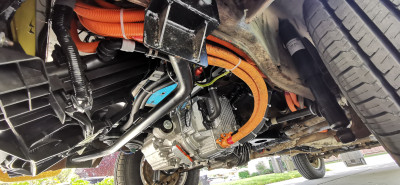

Not quite sure how this is possible if I have a hose going into inverter, then coming out and goes into gearbox cooler. No alternative path. See my diagram, perhaps I don't see it.
- Posts: 600
- Has thanked: 220 times
- Been thanked: 178 times
I'm your image you have the inverter touching the motor but a coolant loop jumping around the bottom. Is the coolant bypassing the inverter there?
And an air pocket means the coolant flows under the air bubble and doesn't have the surface area in the hot spot to pull the heat out.
If the heat exchanger is cooling off the coolant is flowing and moving heat. That leaves an air pocket or a bypass route for coolant as the things I can think of to cause that.
- Posts: 277
- Has thanked: 71 times
- Been thanked: 29 times
I see the confusion. No, having the inverter and the motor touching in the diagram simply means they're part of the same package. The cooling is in series only inverter->motor\heatsink.
