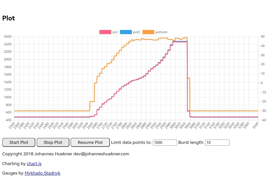

If at all possible, could somebody please help me figure out the slow acceleration problem? Thanks in advance.
Edit. I have since upgraded the firmware to the latest, added the 10k resistor to one of the channels on the dual throttle and have recalibrated the throttle. My new parameter set and a graph potnom vs. speed (flooring to go uphil).
Also pot, pot2 and potnom graph
Edit2: Lowering udcmin to 240 gave me full throttle! Yay. Though I'm not sure why, as when I was plotting my udc it doesn't have major dips, perhaps invisible due to the sample rates.
Next problem is fighting the inverter temps. The temps of the gearbox heat exchanger recover very quick, but inverter temps recover very very slow and after steep hill, my inverter temp is 50+ degrees C and drop slowly on the flat ground. Though this suppose is a separate topic.

Yes your potnom clearly was not reaching full.

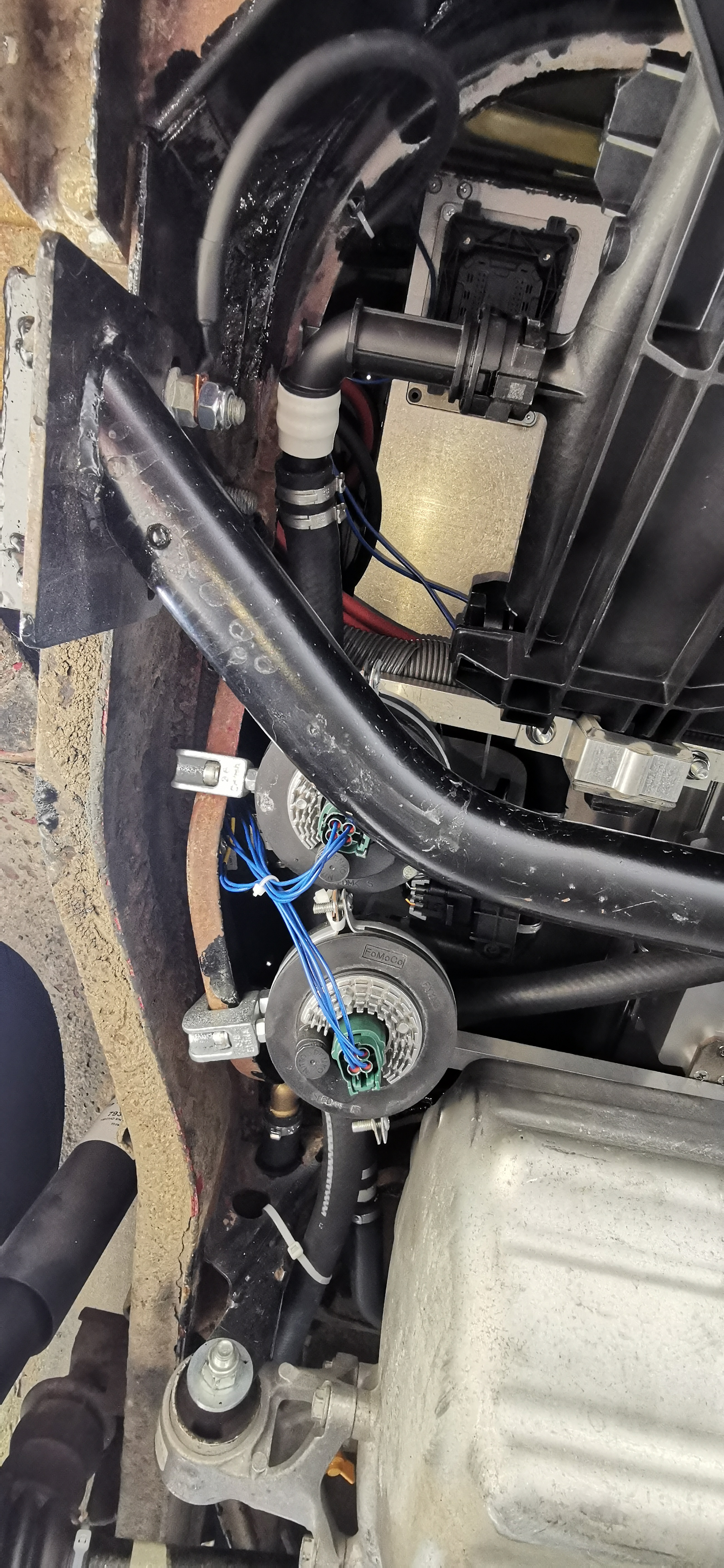

Can you share pictures of your coolant setup and the sizing of the pump and rad. How hot is the inverter getting to?

This is the diagram of my cooling setup.
The 2x 3-way valves either put all devices on one series loop (green arrow) or divide into two independent parallel loops (grey arrow + blue arrow).
* indicates where I have 5/8 inch ID hoses, otherwise - 3/4 inch ID hoses. Battery boxes use ZeroEV manifolds and blue are 3/8 inch ID hoses.
Coolant heater, not yet installed. Looking for what I can physically fit.
Radiator/fan - giant from Model 3. Blowing mode - pull. The VW bus has the ears on the side where the air is meant to enter, go through the radiator and pull by the fan.
Pumps - Tesla MS/Nissan/Ford pumps.
So far I've been driving with the series loop. Uphilling for 1min makes my inverter linearly reach 50+C and practically doesn't drop when driving on flat and doesn't recover quickly on the flat ground. Gearbox exchanger goes to ~60C when climbing uphil, but then quickly recovers to ~25C on the flat ground (and it's downstream from the inverter!). The batteries stay at 16C..18C.
I don't want to damage the inverter so after 50C I park the car. I tried switching to parallel loop and run the pump and fan on my high setpoints when stationary, the inverter temp lineally drops down, but at the rate of ~ 0.25C/sec. Seems slow.
My fan/pump automation (for now just in series loop):
Battery>33C or gearbox>100C or motor >40C: pump=60%, fan=30% (high flow and low fan blow)
Battery>36C or gearbox>120C or motor >60C: pump=60%, fan=50% (high flow and high fan blow)
Battery<30C and gearbox<100C and motor <40C: pump=30%, fan=24% (low flow and low fan blow)
Even at low flow in series I see the coolant flow circulating through the bottle, so it completes the loop without any struggle.
Ambient temp during testing is quite low <20C.
Some pictures.
Bottle:
2x 3-way valves:
Radiator and fan:
Pumps:
Hoses to the front battery box:
Hoses and manifolds going to the rear battery box:
Gearbox side of cooling:
Inverter and OBC side of cooling:
