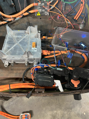

Photo attached of my sketchy in car testing. The standoffs on top of the charger are the mounting points for the DC-DC converter.

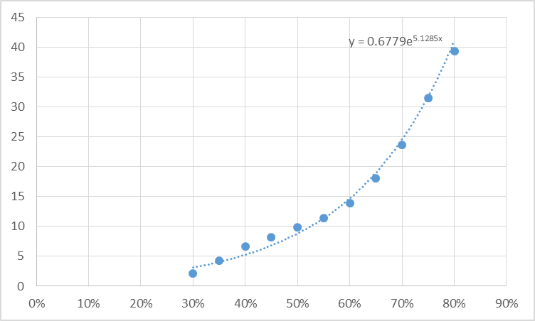

So I played around in Excel for a bit with the data that I collected.
Assuming the charger last night was putting out 220V, it looks like the best fit for the data is an exponential curve.
Excel says y=0.7125e^4.8935x
Playing around to find more round numbers (as I assume that someone had to pick this curve at some point) it looks to me like y=0.7125e^4.825x is a very close fit, though it misses a couple outlier points. My Excel file is attached, if anyone wants to tell me what I messed up.
Arber, did you find a curve that fit the Volt charger?

Which signal did you measure then, the command PWM or the return signal on another pin which is also pwn?P.S.Mangelsdorf wrote: ↑Fri Sep 06, 2024 3:25 pm So I played around in Excel for a bit with the data that I collected.
I never tested charger on its own. I always had another voltage measurement which would remove or reduce PWM when battery would be too high. But i think Volt gen2 charger had this logic built in as when i tried to charge almost full battery it wouldnt charge with more than 5A.
This was a static test with charger requested amps to 220Vdc? I would guess then PWM requests for 90% at 360v would be lower maybe at 18A?

The duty cycles provide above are what I was sending to the control pin. I was not able to measure the DC Voltage Sense or AC Voltage sense pins.
Interesting, I hadn't thought about the charger itself doing a ramp down.arber333 wrote: ↑Sat Sep 07, 2024 7:26 am I never tested charger on its own. I always had another voltage measurement which would remove or reduce PWM when battery would be too high. But i think Volt gen2 charger had this logic built in as when i tried to charge almost full battery it wouldnt charge with more than 5A.
No, I am assuming the station was providing 220V AC.

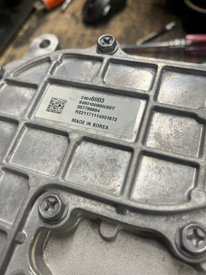

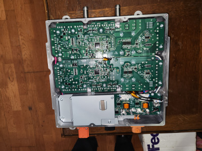

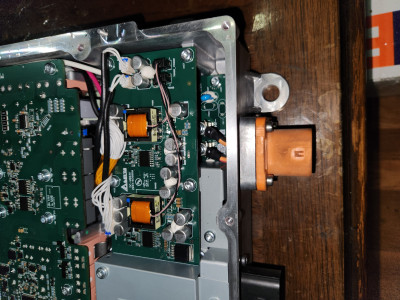

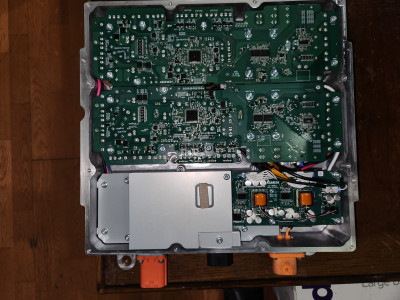

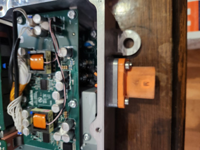

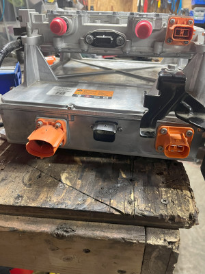

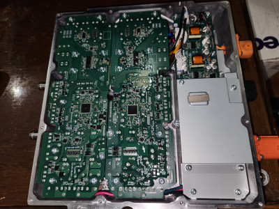

Not much of an update, but I do have a few photos to share (below), and I did get both units mounted in the car. It does look like the part number of the DC-DC converter might need updating, the one I had ordered had the necessary pins blocked off, and it looks like there are a mountain of very close parts with different pins blocked off. I have a new one coming tomorrow and will update once I know it works.
Anyways, here are the charger part number, DC-DC part number, and the two stacked. One note on the part numbers - it does seem like there are several different numbers used, and most wrecking yards list the components as the wrong thing on Ebay or Car Part. Both of these they categorized as "ECM"
DC-DC Charger Stack
DC-DC Charger Stack

what are the footprint dimensions of the bolt charger and dcdc converter? looks reasonably compact
- Posts: 1076
- Location: Raleigh, NC, USA
- Has thanked: 234 times
- Been thanked: 267 times
Re: Chevrolet Bolt OBC and DC-DC Reverse Engineering
I did measure this, but forgot where I wrote it down in the thrash for drag week. Its roughly 1 foot by 1 foot, maybe a little bigger. I'll find my notes when I clean the garage next weekend.ScythianNite wrote: ↑Wed Sep 11, 2024 12:47 am what are the footprint dimensions of the bolt charger and dcdc converter? looks reasonably compact

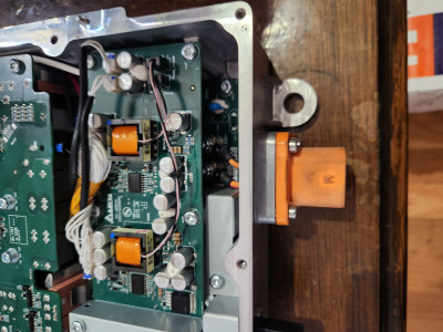

On 120V it only uses 1 of the 2 internal boards for charging. It's a 3.6kw charger on 120v essentially.P.S.Mangelsdorf wrote: ↑Fri Nov 08, 2024 3:25 pm
On my home, 120V wall plug EVSE, which can output 15A, the charger draws 12.4A, even when I turn the PWM duty cycle up, right now its just sitting at 70% and drawing 12.4A. There is a point where I can lower the amperage draw on that station (don't recall off the top of my head), but it won't exceed 12.4A. I did have an instance on DW where, at a Level 2 240V EVSE, I turned the PWM up too high, and the charger drew 7+kW on a 6kW station, which after about a minute made the station unhappy and shut off. I need to do some more experimentation and get some better data on PWM to A relation.
I wonder if the charger has some sort of hard coded limit on the amps it will draw on 120V power. I'll need to experiment with that a bit as well.
Not sure how the 11kw version would work though.
I have pictures I can upload.

Alright, I was able to get much better data yesterday using a clamp multimeter and my home 9kW charger. Data in the excel attached and my new github repo here: https://github.com/PSMangelsdorf/Bolt_OBC
Looks like on 240V charging the best fit curve is I'm hopefully going to find time this week to update my charge controller and see if I can make that work in the car.
I'm also hoping to start work on another project this summer that may require/allow me to work on integrating this into Zombieverter. But first, getting my simple Arduino solution working.
Edit to add: these are the AC current into the car.
