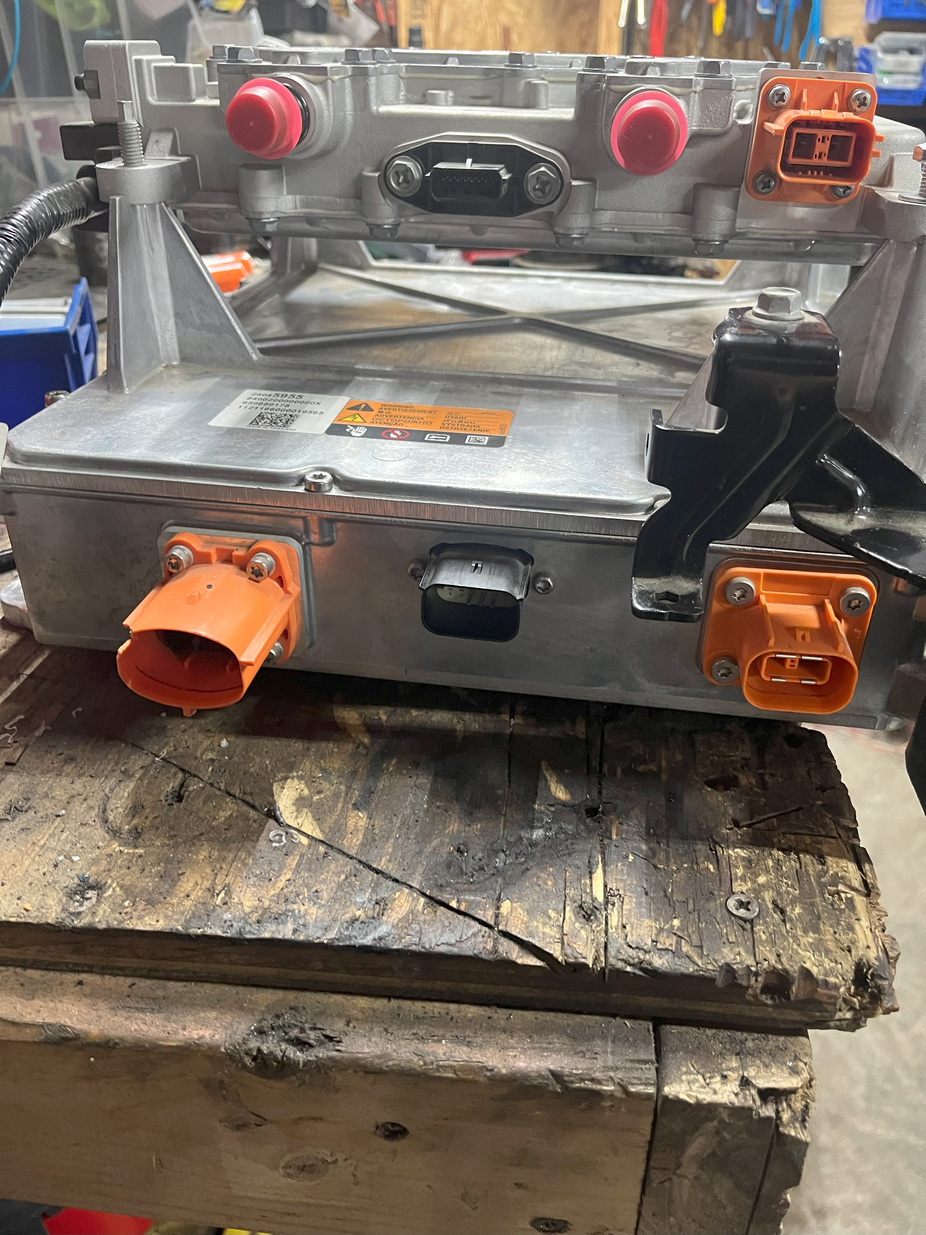

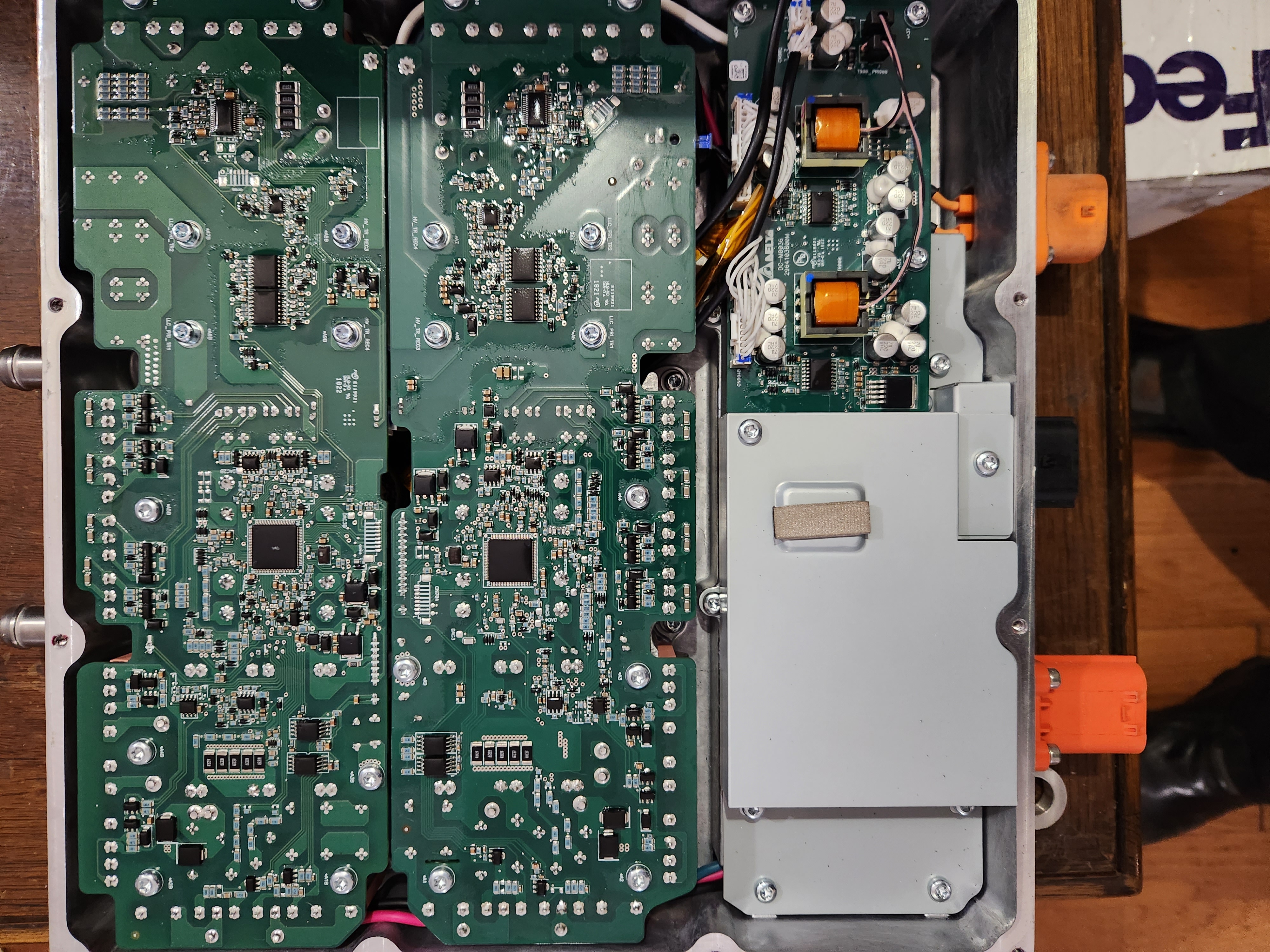

Not much of an update, but I do have a few photos to share (below), and I did get both units mounted in the car. It does look like the part number of the DC-DC converter might need updating, the one I had ordered had the necessary pins blocked off, and it looks like there are a mountain of very close parts with different pins blocked off. I have a new one coming tomorrow and will update once I know it works.
Anyways, here are the charger part number, DC-DC part number, and the two stacked. One note on the part numbers - it does seem like there are several different numbers used, and most wrecking yards list the components as the wrong thing on Ebay or Car Part. Both of these they categorized as "ECM"
DC-DC
Charger
Stack
ScythianNite

what are the footprint dimensions of the bolt charger and dcdc converter? looks reasonably compact
P.S.Mangelsdorf
Posts: 1231
Location: Raleigh, NC, USA
Has thanked: 323 times
Been thanked: 353 times
Re: Chevrolet Bolt OBC and DC-DC Reverse Engineering
Post by P.S.Mangelsdorf »
ScythianNite wrote: Wed Sep 11, 2024 12:47 am what are the footprint dimensions of the bolt charger and dcdc converter? looks reasonably compact
I did measure this, but forgot where I wrote it down in the thrash for drag week. Its roughly 1 foot by 1 foot, maybe a little bigger. I'll find my notes when I clean the garage next weekend.

P.S.Mangelsdorf wrote: Fri Nov 08, 2024 3:25 pm
On my home, 120V wall plug EVSE, which can output 15A, the charger draws 12.4A, even when I turn the PWM duty cycle up, right now its just sitting at 70% and drawing 12.4A. There is a point where I can lower the amperage draw on that station (don't recall off the top of my head), but it won't exceed 12.4A. I did have an instance on DW where, at a Level 2 240V EVSE, I turned the PWM up too high, and the charger drew 7+kW on a 6kW station, which after about a minute made the station unhappy and shut off. I need to do some more experimentation and get some better data on PWM to A relation.
I wonder if the charger has some sort of hard coded limit on the amps it will draw on 120V power. I'll need to experiment with that a bit as well.
On 120V it only uses 1 of the 2 internal boards for charging. It's a 3.6kw charger on 120v essentially.
Not sure how the 11kw version would work though.
I have pictures I can upload.
