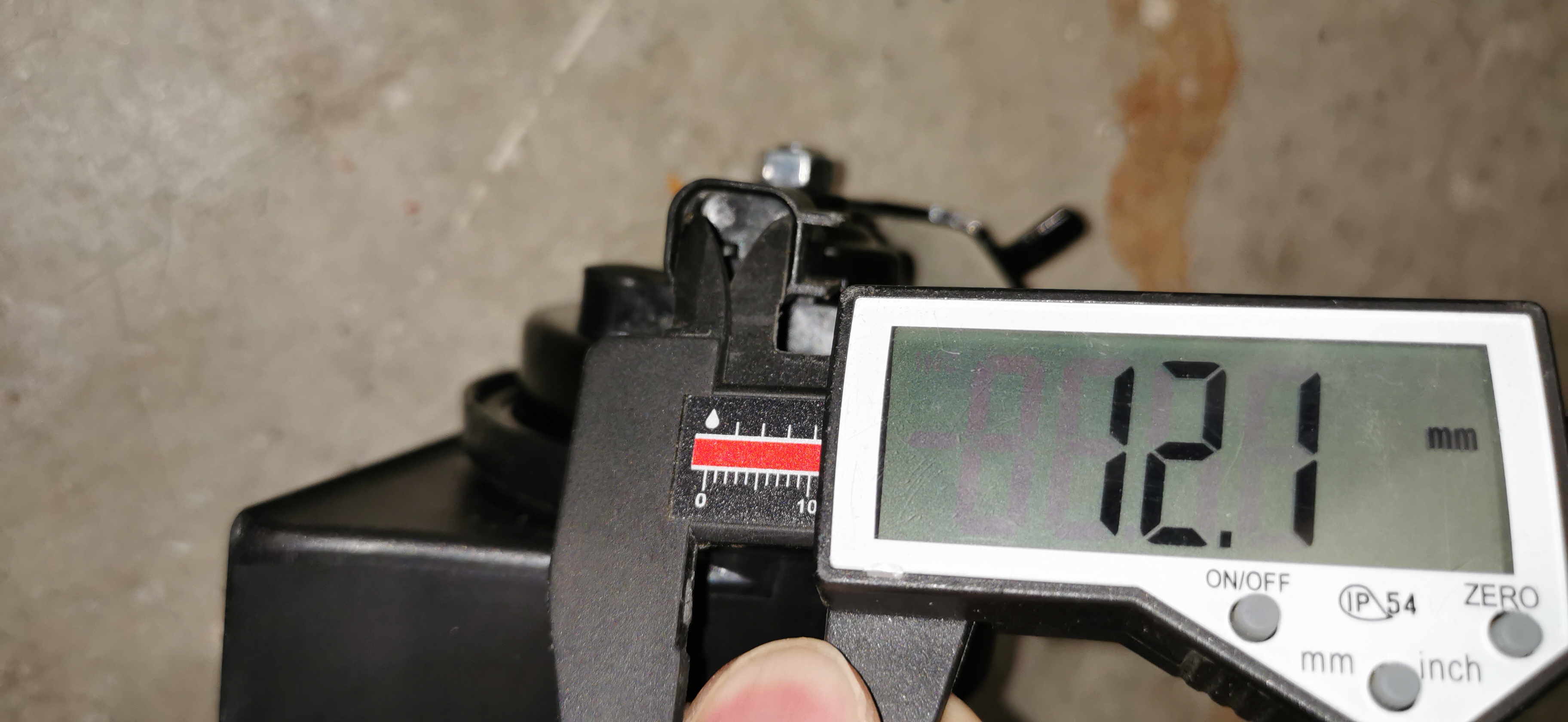

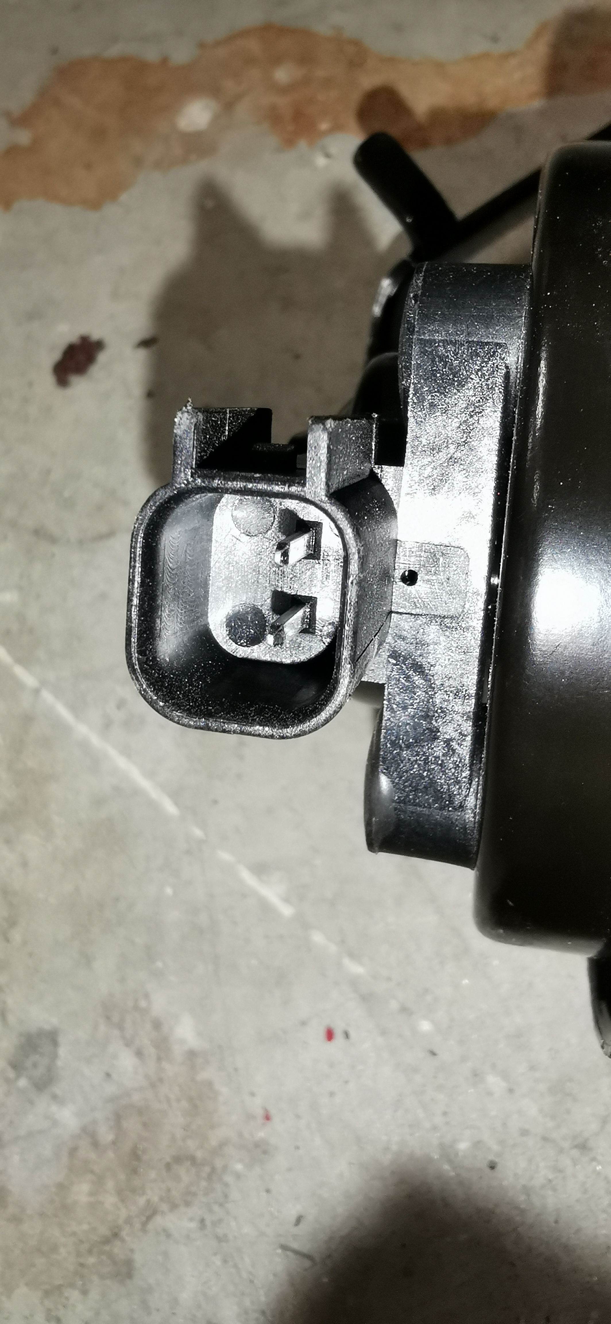

Folks.
Does anybody know what connector is used for the Tesla honk?
Inside dims 11x12 mm. 5.5 mm between pins. The pins are flat, not round.

Looks like a common fuel injector connector.
Bosch US car type
https://msel.co.nz/uscar-2-way-fuel-injector-connector/
Bosch US car type

Thank you!Doig5710 wrote: ↑Mon Nov 13, 2023 6:56 am Looks like a common fuel injector connector.
Bosch US car type
Not sure if the ones I bought are Bosch, but "fuel injector" was the right key word to finding these on Amazon.
https://a.co/d/51kPAin

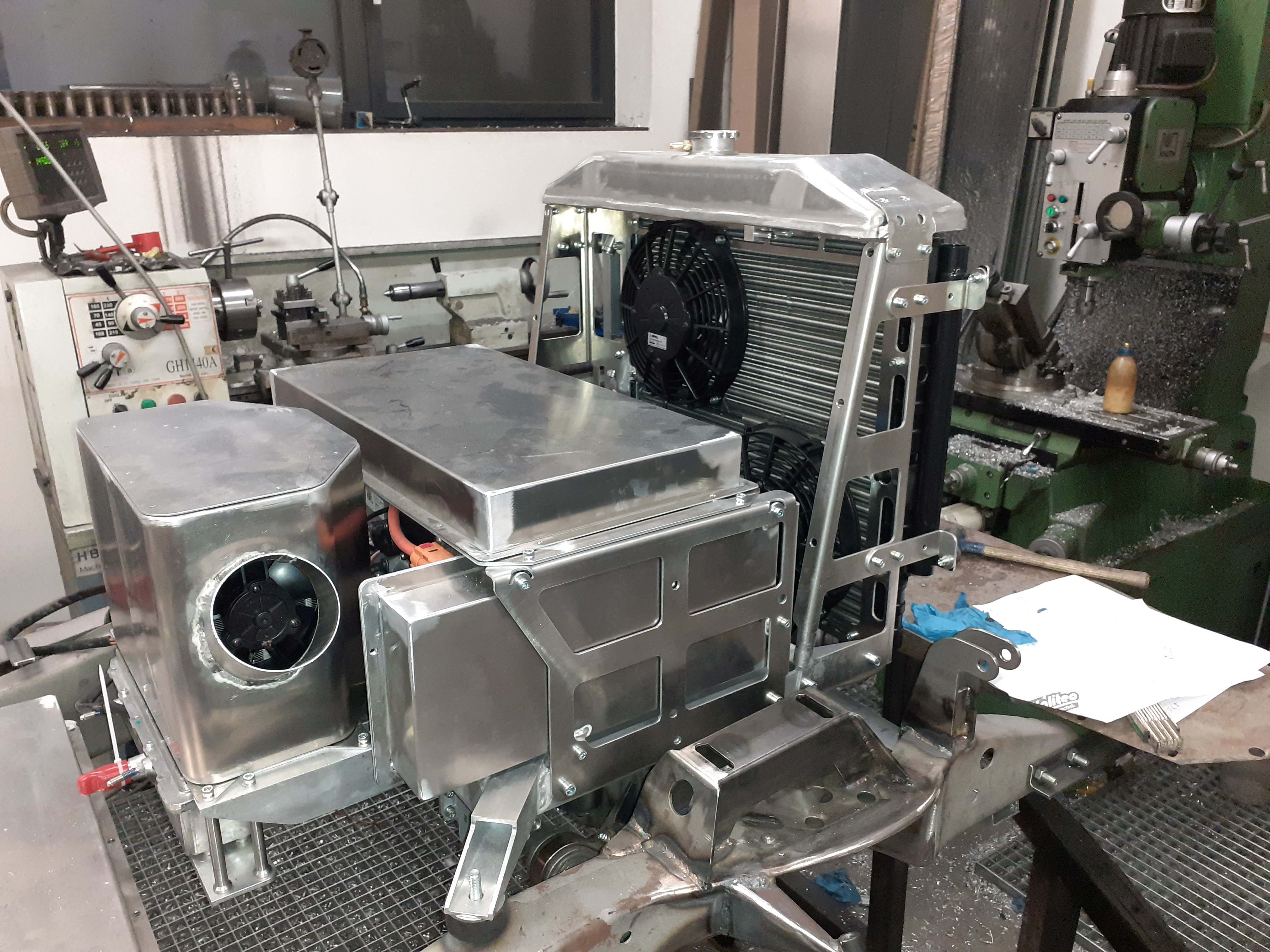

I use 2 of them, the upper one for the motor and charger, the lower one just for the battery. I attached it to the three holes where the fan was originally attached.
Depending on where you buy that fiat radiator some come with a blanking plug in that m22 hole which is nice

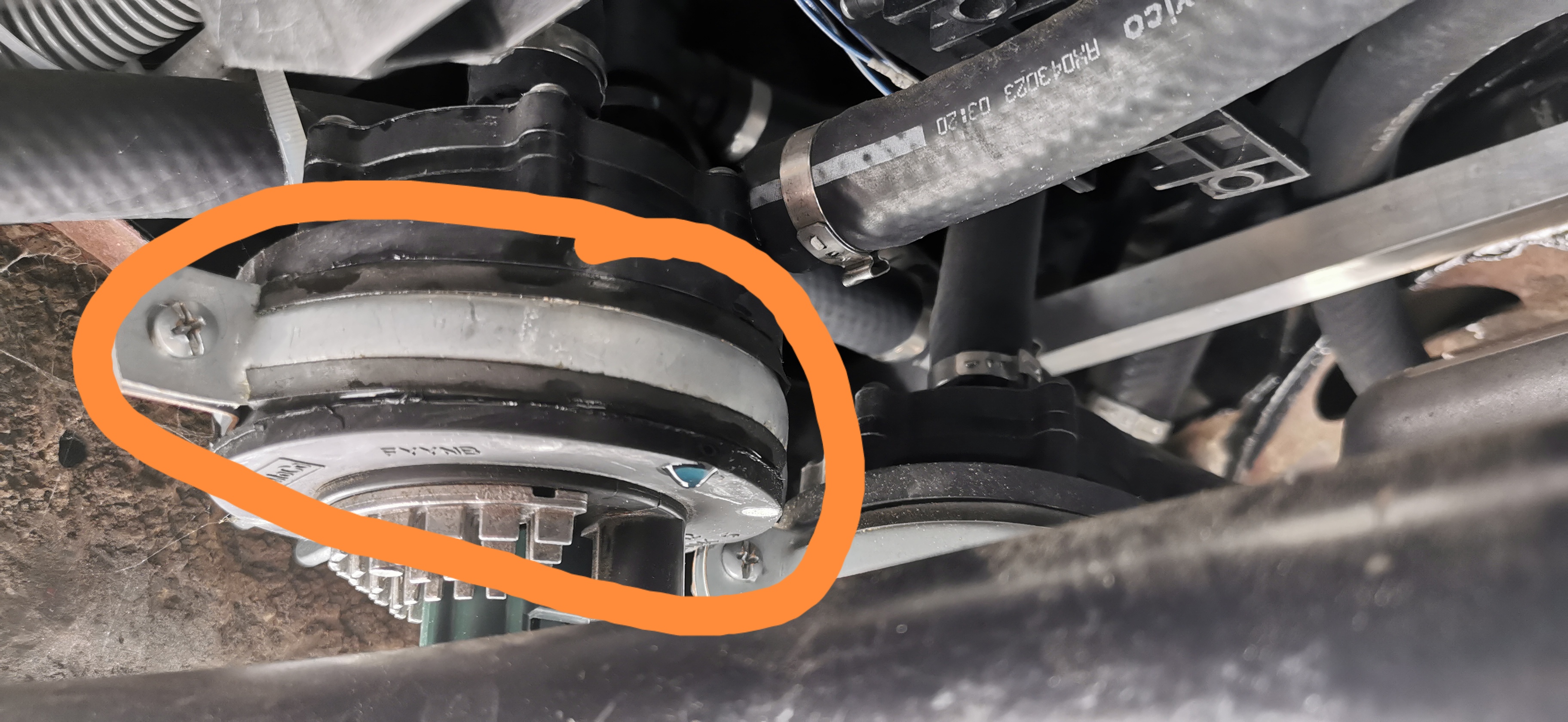

Are the Tesla/Nissan/Ford coolant pumps know for failure?
One of mine started leaking from the seals. The other one (identical) is ok. Haven't driven my conversion all that much yet. Seems to be happening overnight when the temps drop from 25..30C during the day to 10..15C at night.
From Lars' homepage (https://www.evcreate.com/using-tesla-th ... 20on%20the), my pump orientation is ok.

The early Tesla pumps, as used on the RAV4 EV, have a regular failure pattern. They don't leak, but they do stop pumping (either not running, or running too slowly, IDK). I've read about several failures of the early Tesla pumps, but none were for leakage. Failures are common, though not particularly frequent. The RAV4 EV has four coolant pumps, due to one being dedicated to a cabin heater loop with its own type of coolant.

I'm running two from a 2011 Leaf and no issues. Do you control the speed or are they full on all the time?
Did they come from a crash damaged car? Maybe a hair line crack.
