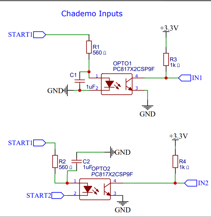

Hi can you tell me what kind I/Os you use?
IN1 and IN2 are pullup inputs? In DUE version i use IN1 with signal LOW (GND) and 12V pullup with NPN transistor releasing pin to pullup.
IN2 signal directly with 12V signal and then interim NPN transistor would pull the pin down.
How are the OUT1 and OUT2 used? As open collector directly or should i use additional relay?
TNX

Re: ESP32 Based Chademo
If only the circuits were opensourced. Oh wait they are on the first post.
https://github.com/jamiejones85/ESP32-Chademo
https://github.com/jamiejones85/ESP32-C ... hademo.pdf
I am actually making this application to use MCP2517FD circuit and i need to switch some things around and use a different library here...tom91 wrote: ↑Sat Aug 17, 2024 5:58 pm If only the circuits were opensourced. Oh wait they are on the first post.
Did you actually answer my question in your post? Not very helpful.
Did you actually use ESP32 to build Chademo VCU circuit? If not, then question to OP still applies as i only see gerbers and cant imagine what he used after the VCU.
So do you have any schamatic of interfacing VCU? TNX
Reallyarber333 wrote: ↑Sat Aug 17, 2024 6:31 pm I am actually making this application to use MCP2517FD circuit and i need to switch some things around and use a different library here...
This forum is turning to shit with people needing to be spoon fed everything that is answered already in the topics.
Sorry i couldnt see schematic on my github. Must be a problem with my fork version not being updated
EDIT: Yup... my version was really outdated and i seem to managed to remove that pdf... Tnx for details, ill get my act together... any day now.
