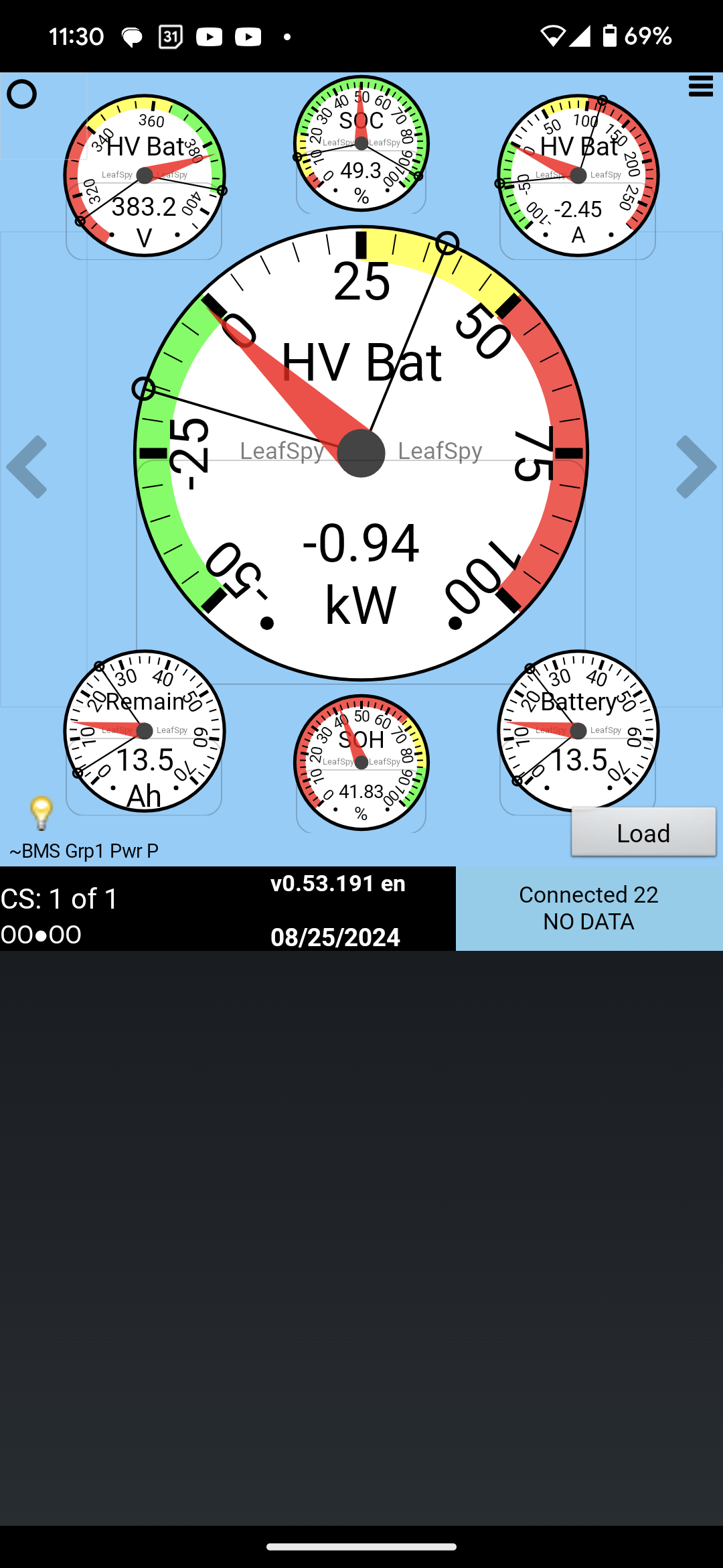

Thank you for the complement, and I'm glad that I was of some help to your project. Yes, I'm attempting to get the 6.6kw j1772 charger working, but still no luck. I moved the Leaf Battery CAN signal to the same CANBUS as the rest of the Leaf EV stack, but that doesn't seem to have helped. Also, yes I'm using the batter contactors. Hopefully the weather will allow for more troubleshooting this weekend.:)

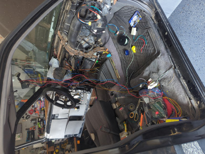

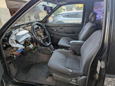

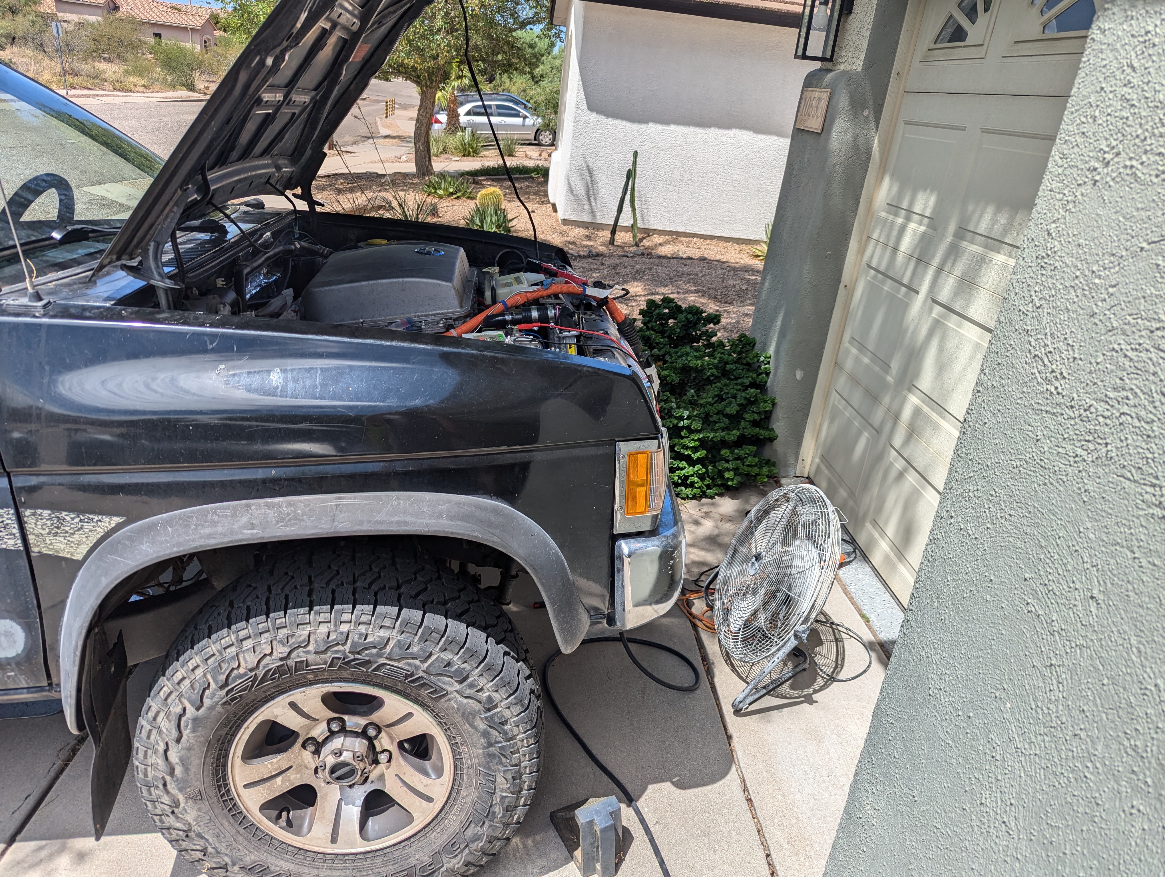

I finally got the Nissan to charge with the Leaf PDM with the help of J0hannes. He kindly provided me with his fork of the ZOmbieverter code for testing. I took the Nissan for a 5 mile trip to the gas station for snacks, and the only issue I noticed is a drive shaft vibration.
The speedo works!!! I added first 5 EV miles to the odometer. 🥳
Before I loomed the wires in the cabin
After looming most of the wires
It's taking a charge!!! :D
Charging. I don't have the fan installed yet, so I'm being cautious.
Possible future swap...

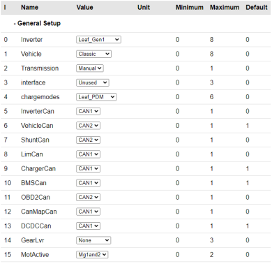

tom91 wrote: Sat Dec 07, 2024 6:58 pm Please post params for diagnostics.
Also why are you free reving it?!? This is not a real use case as there is almost no inertia.
I'm only revving it in neutral to show the issue in a safe way. The vehicle does the same thing in gear, but violently shakes the truck.
Here are the parameters:

https://github.com/damienmaguire/Stm32- ... _220a.json
Here are damiens params. Damien does not run any pedal regen on his leaf setup in his BMW E46
https://github.com/damienmaguire/Stm32- ... k220a.json
Here are the truck params
