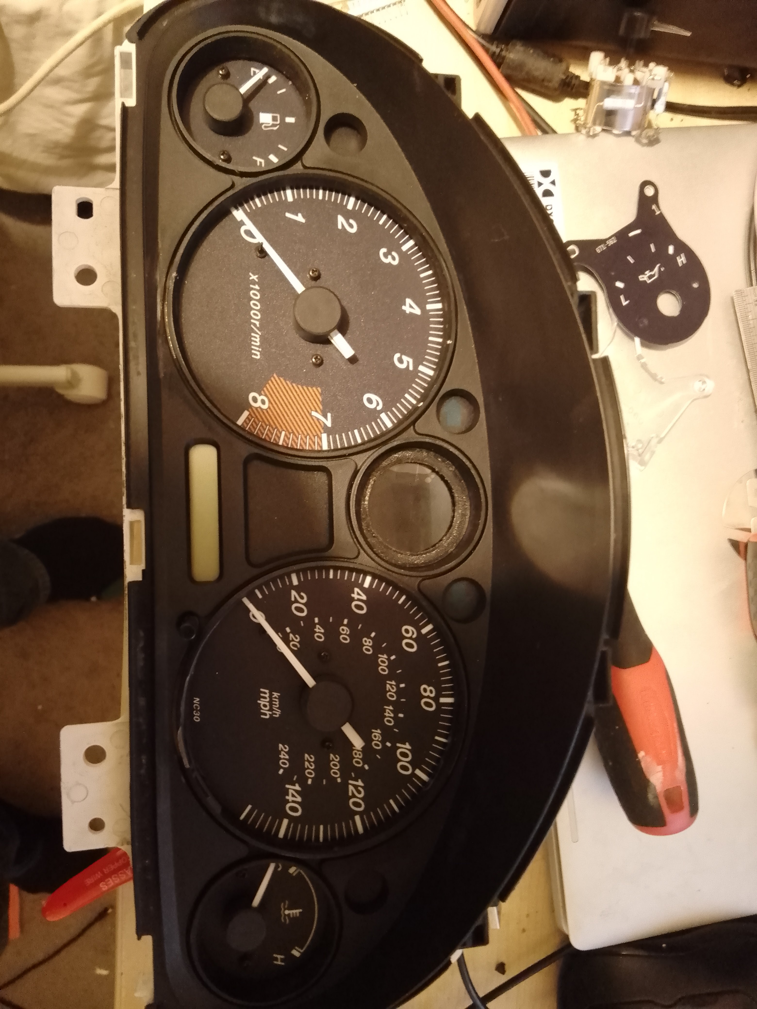

planning on modding in the round display to the OEM cluster?

ScythianNite wrote: Sun Dec 17, 2023 6:47 pm planning on modding in the round display to the OEM cluster?
yup 3d printed prototype ...

That's a nice gauge, where did you get it? Is it easy to run?

Jacobsmess wrote: Mon Dec 18, 2023 8:09 am That's a nice gauge, where did you get it? Is it easy to run?
they are cheap "GA9A01" from Aliexpress, along with a wemos s2 ... relatively easy to use with the E_TFT library in arduino ... follow the guide below and i modified jamies code for my uses :)
The only word of warning buy more than 1, as my fist one was duff and i thought it was a code issue, but it was actually the screen :(
https://dronebotworkshop.com/gc9a01/
https://github.com/jamiejones85/ESP32CanGauge

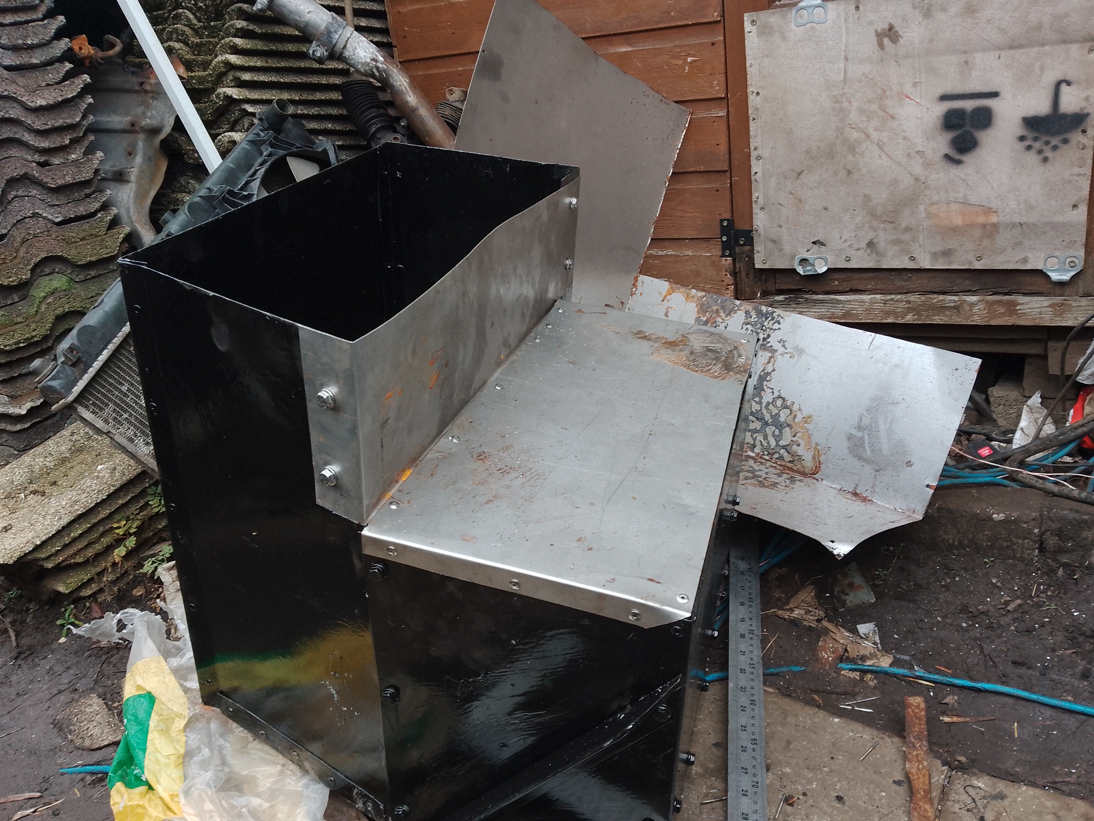

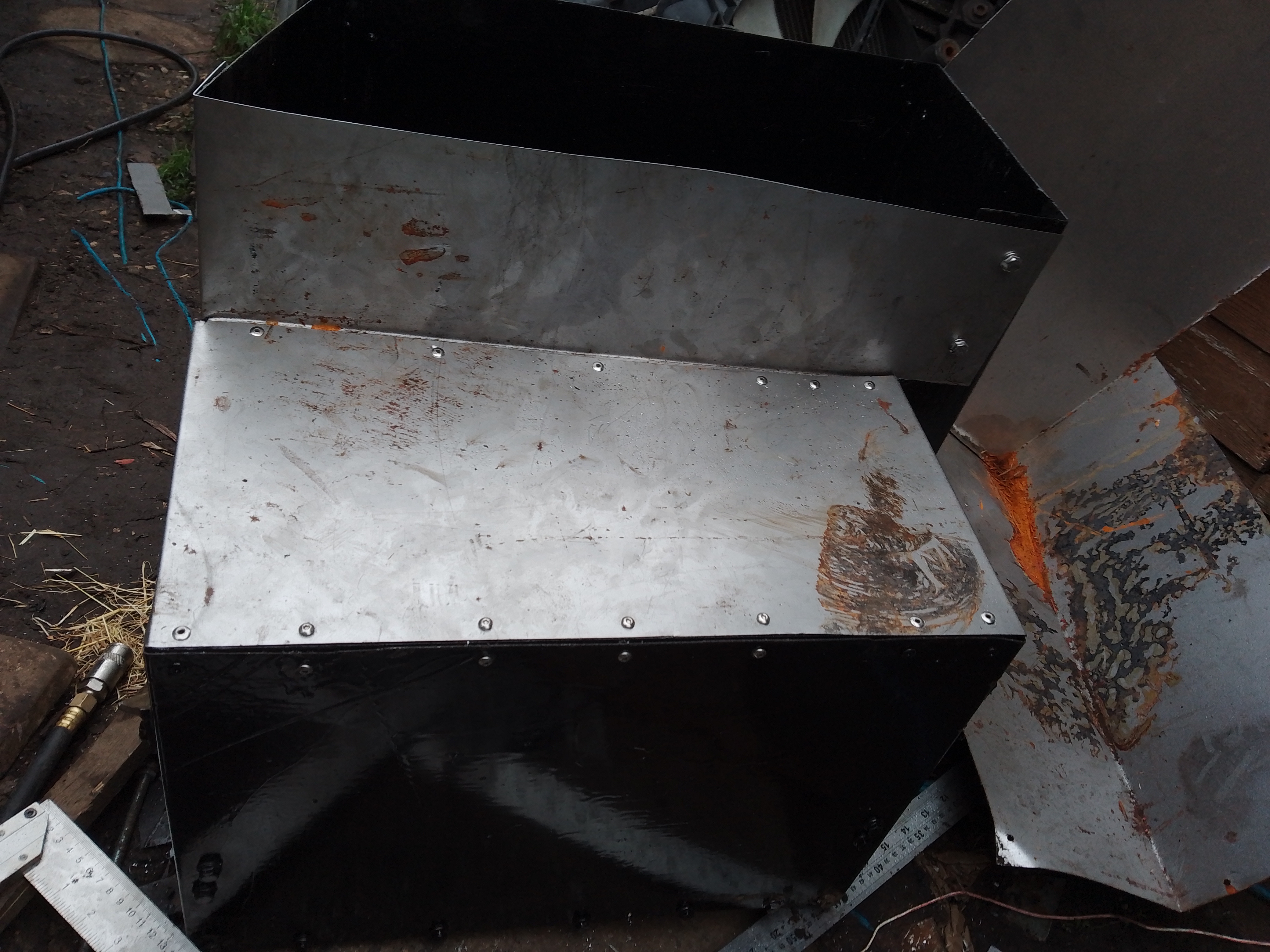

Lunchtime special ....
Somehow i DID NOT snap the 3.2mm drill bit or break the m4 Chinese tap.. go figure... sure i break loads tomorrow now :?
parts bin special here ... speed is of the essence at the moment.
i have to use small screws here as there isn't much clearance between battery modules and the frame and if i were to have a bump i don't want any bolt threads impacting the battery module.
