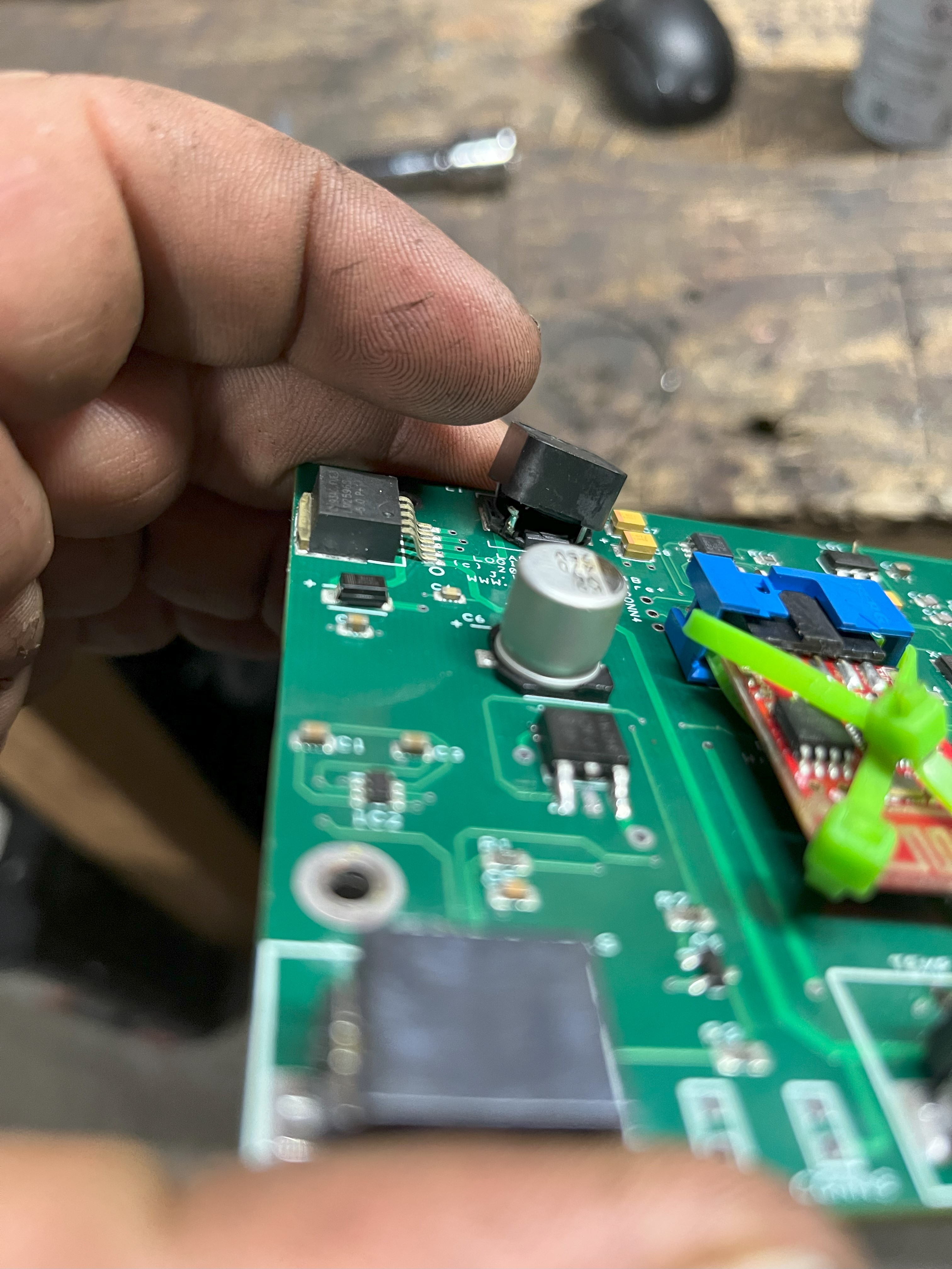

For those interested, the failed part on the control board:

Re: [DRIVING] 1940 Chevrolet with Tesla Motor
Also in (slightly) better and somewhat interesting news, this inverter was easier to remove than my base inverter was. The input current/voltage sensing could easily be removed to get to the main mounting bolts. It does look like it might be an earlier revision than the Base, which is interesting, but I'm not complaining.
Also, it looks like the gate drivers are ok. At least they aren't shorted out.

Well I got the new inductor in and soldered to the control board. I haven't really had time to test it with 12V, but plan on doing so and then maybe adding some hot glue to help it stay in place.
The new IGBTs are also enroute to my house, based on the (not very good) tracking from China, they are currently in customs in Hong Kong (I think) and might be here when I get back from State of Charge, or it might be another couple weeks. I haven't started disassembling the stage, I figured I'd wait and do it all at once.
