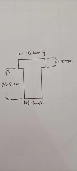

Re: [DRIVING] BMW Z3
you might want this then it's the dimensions of the brass posts, i did make the holes on the part 16mm and 12mm but they were really tight when i went to put them in so i turned them down slightly rather than mess with the printed part also there is an o ring at the step also worth noting it was designed for the bmw cables which are 14mm
I'm happy to share the freecad files if anyone wants to alter the dimensions
