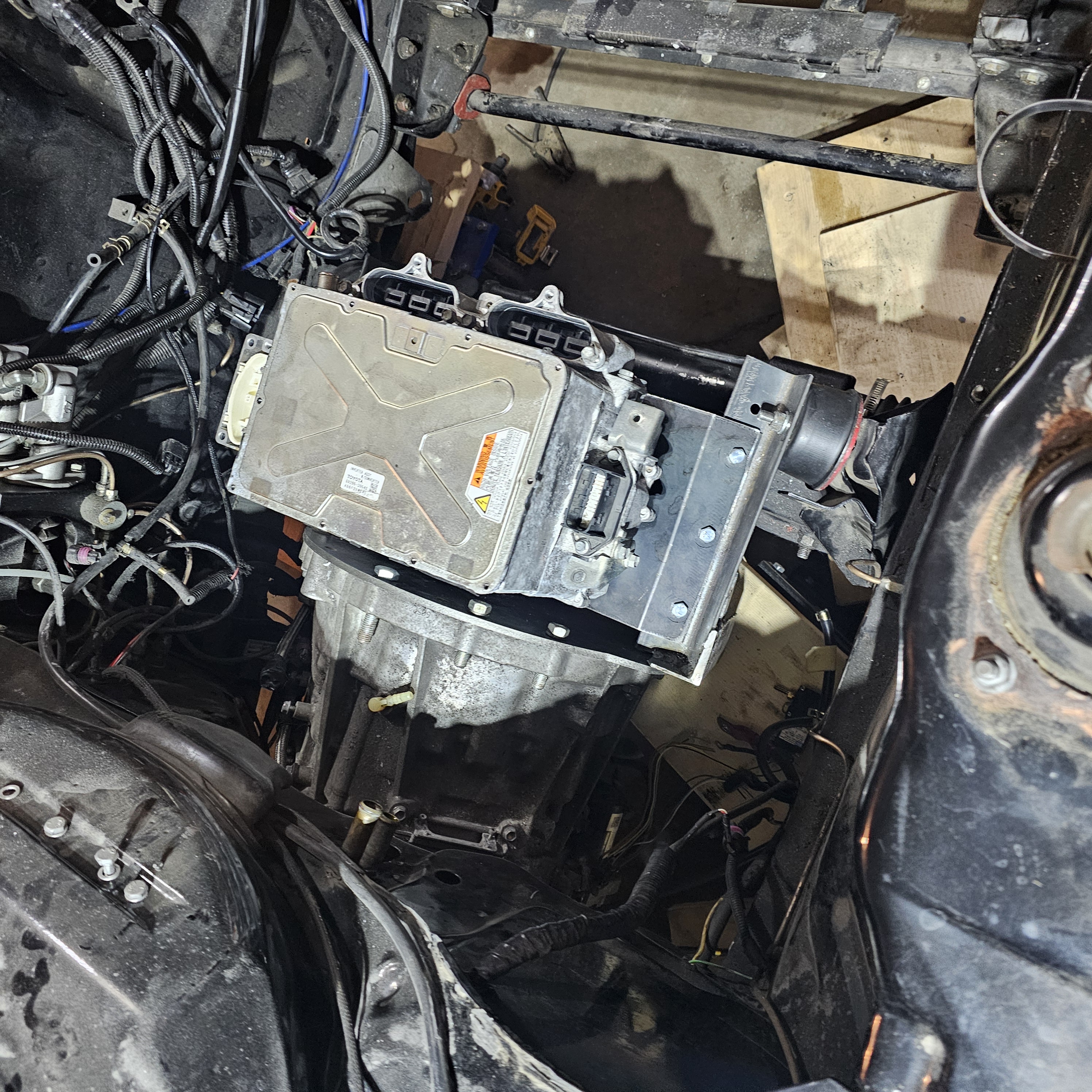

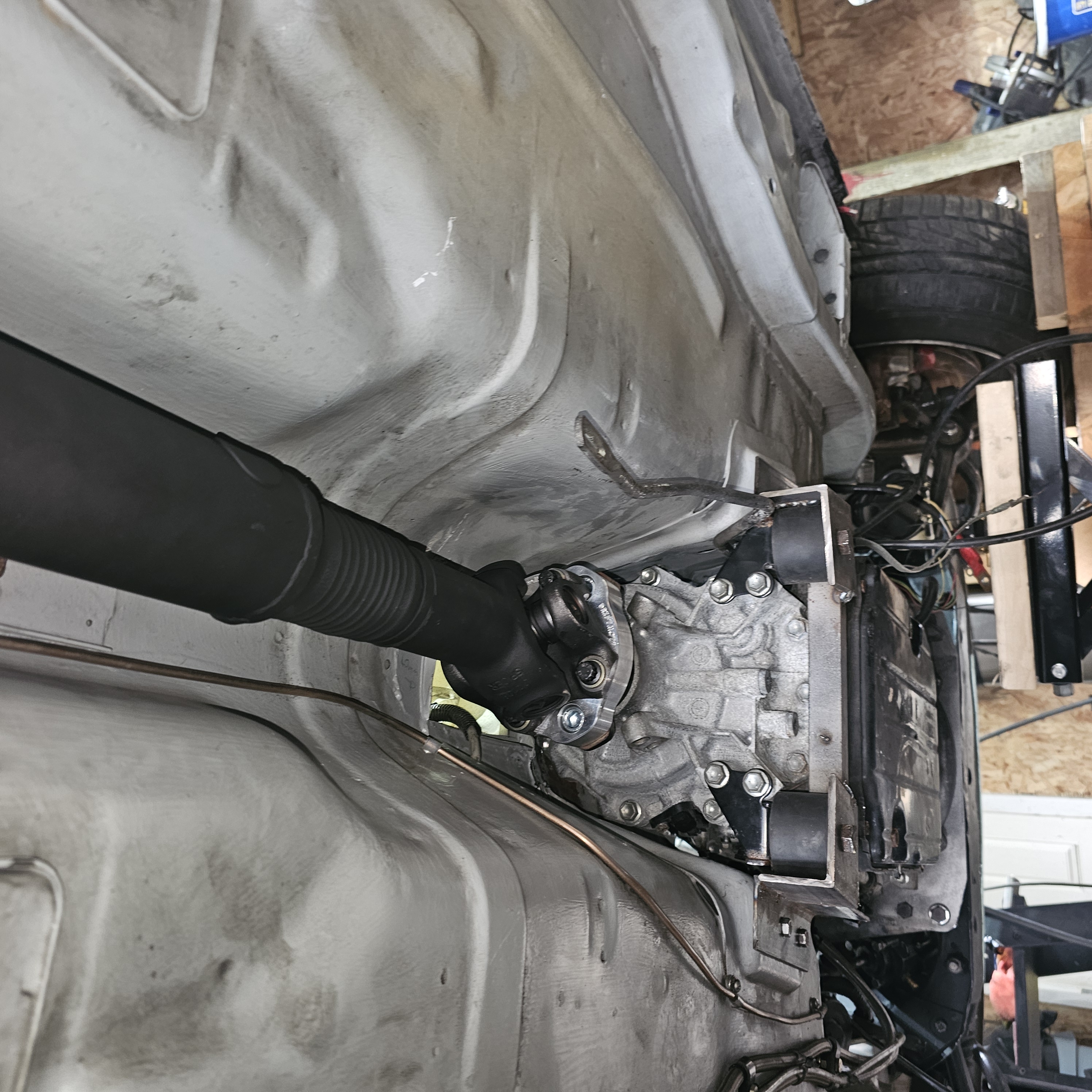

Driveline is complete, integrated slip thang.. more unforseen buckage though. 🤦‍♂️

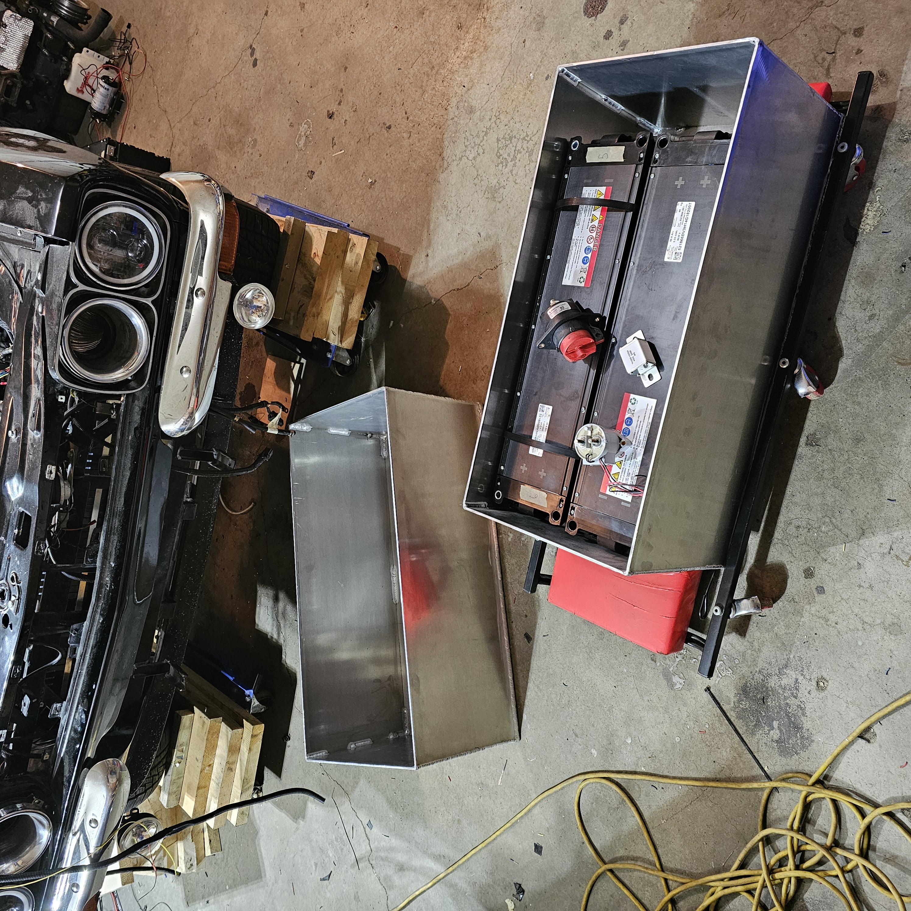

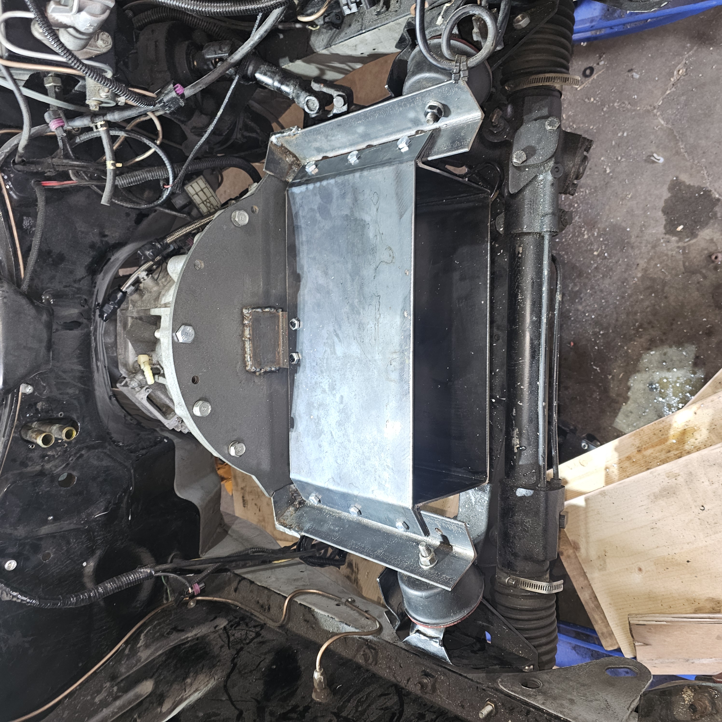

This was another easy part. Nothing I haven't done before. . . .
Made a sorta box/shelf to aid with packaging stuff.
The first attempt was to mount the inverter in-between the motor mounts down low, but it was too tight, so it's probs gonna live on the upper floor, might put the DcDc underneath.
Bit more bracing and welding, then some paint.

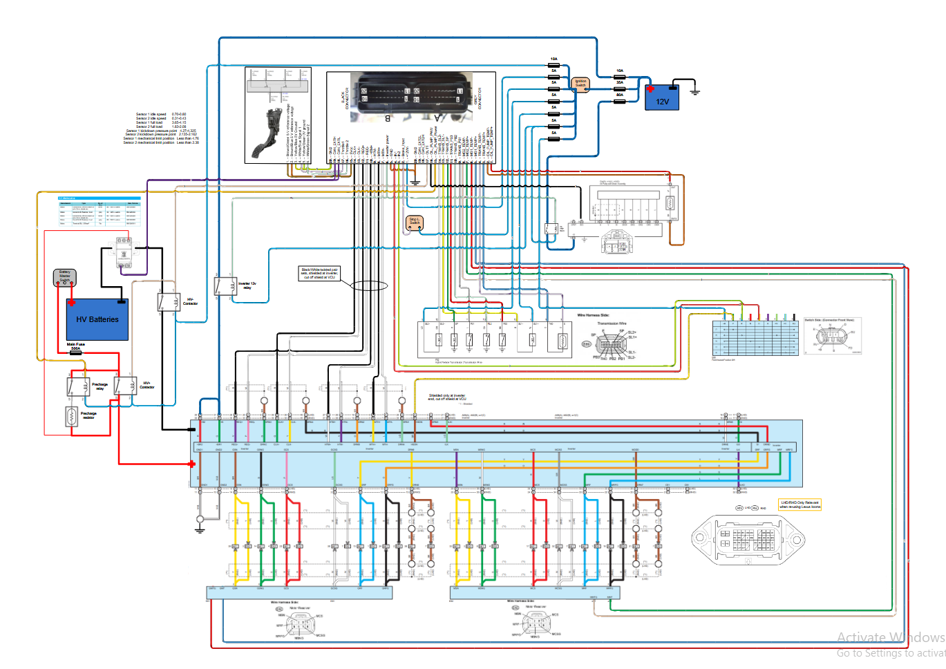

Hi.
Has anyone ever modified this drawing to the zombieverter pinout?
This is a great drawing, It will be a great help.
Will be straightforward to assign the correct pins on the zombie.
Has anyone had any future issues following this diagram?
GS450H Wiring overview V2.3.pdf
(1.31 MiB) Downloaded 540 times
robertwa
Posts: 187
Location: San Diego, CA
Has thanked: 129 times
Been thanked: 157 times
Re: WIP 1974 Ford Capri + GS450H
Post by robertwa »
It's a good diagram, I've followed it with success on my build. Between that one, and the leaf to zombie diagram & zombie pinout tables on the wiki there is enough to figure it all out

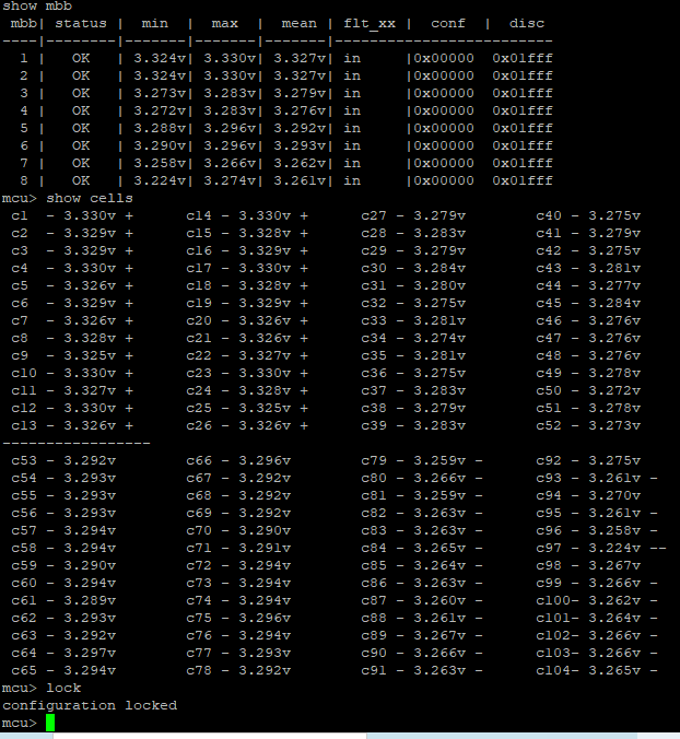

I moved away from the zombie and started concentrating on the battery setup
I'm using the ThunderStruck MCU and so far it been pretty straight forward with the A123 batteries.
I'm now in the process of charging each individual pack up to the recommended voltage and balance using the MCU to control a power supply.
Here's the very first look I had at cell voltages. I was pretty chuffed to get to this point! :D

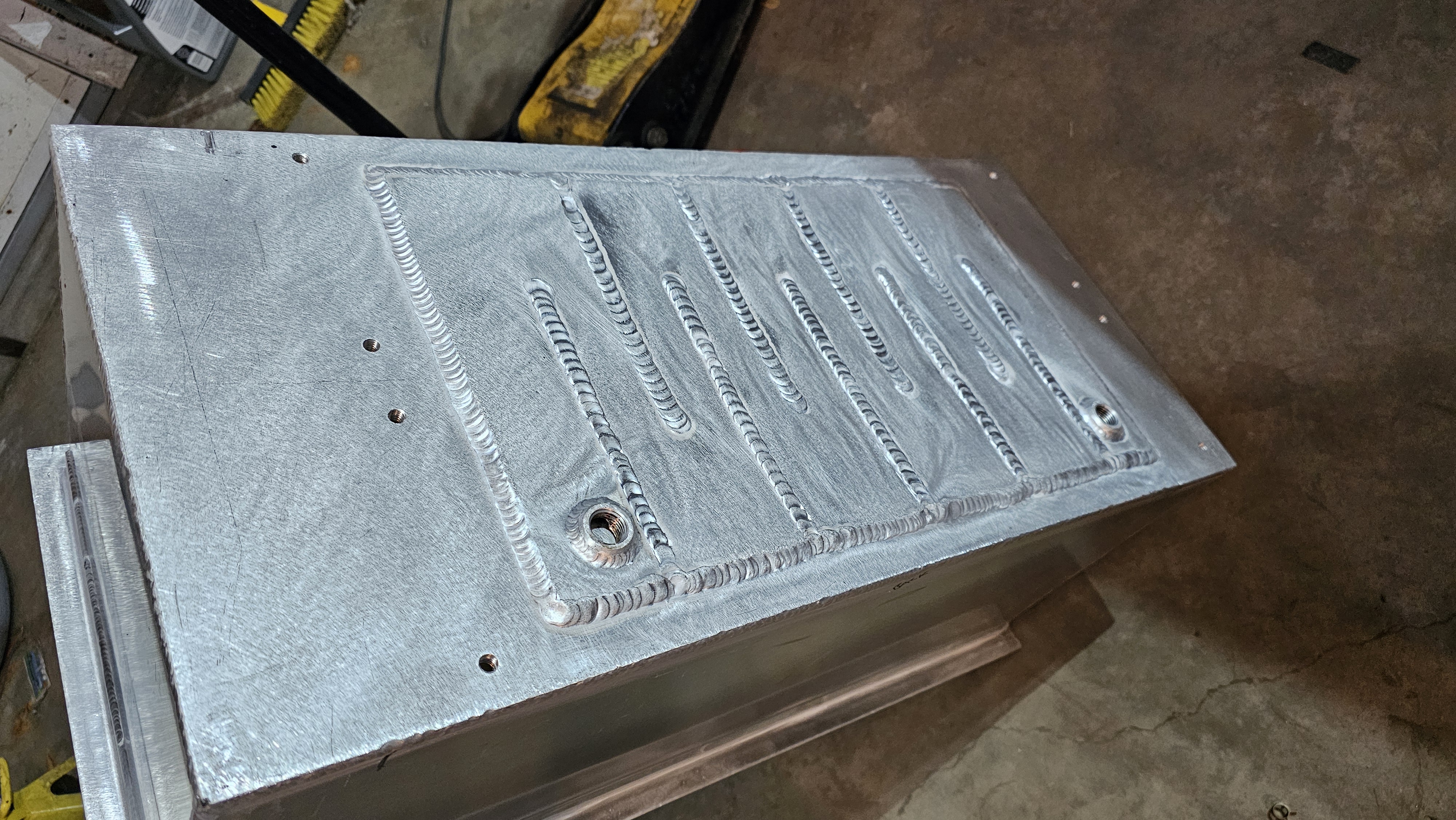

Started welding up some battery boxes too.
Going to figure out the oil pump issue and get the batteries all connected up and get them charging.

Worked up my battery boxes a little more with a coolant path, worked on the shifter assembly and mocked up a little more stuff.
Excited to get back at it.

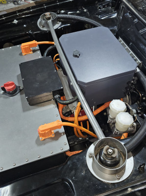

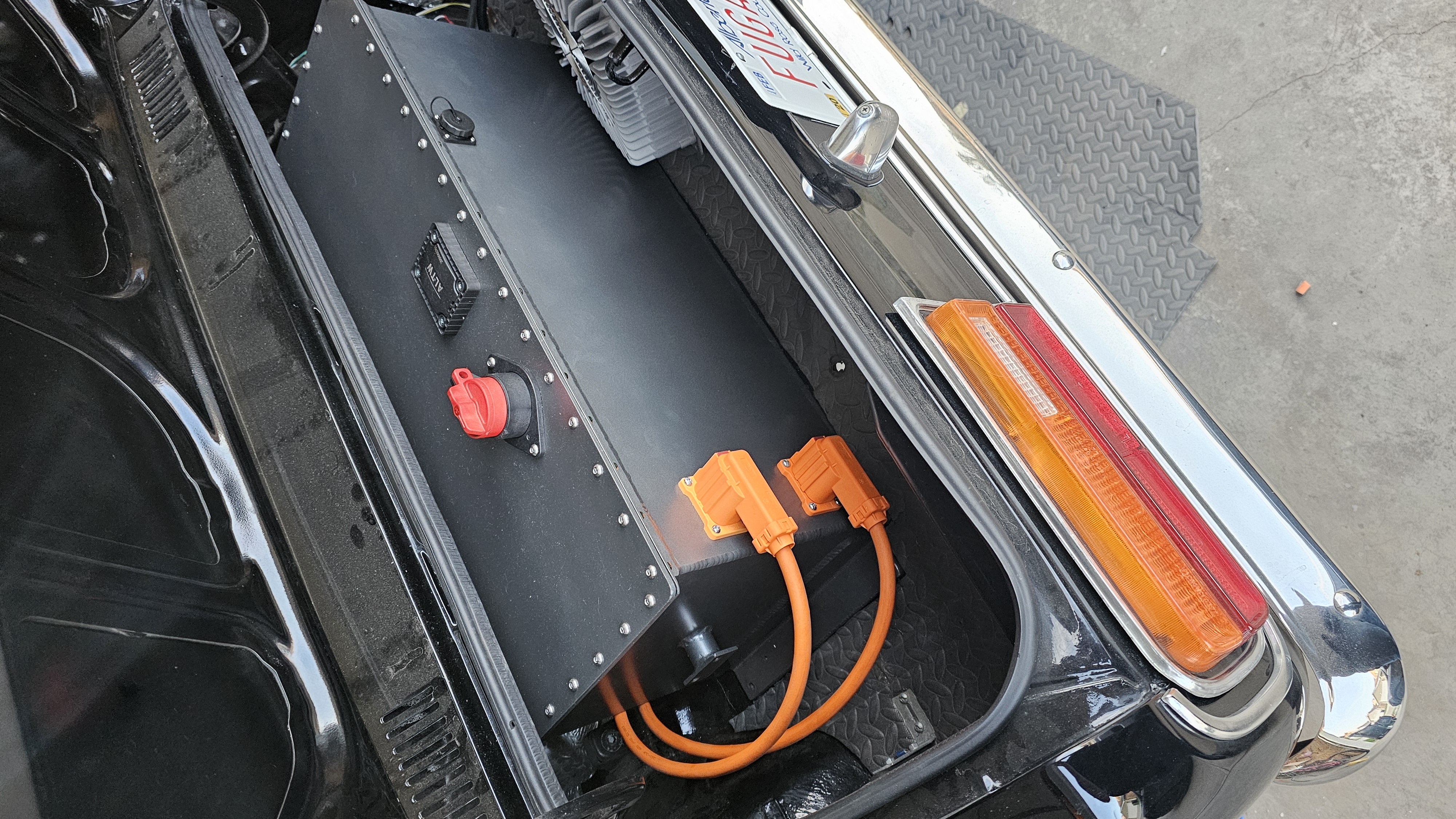

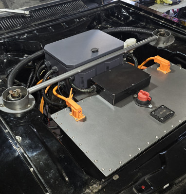

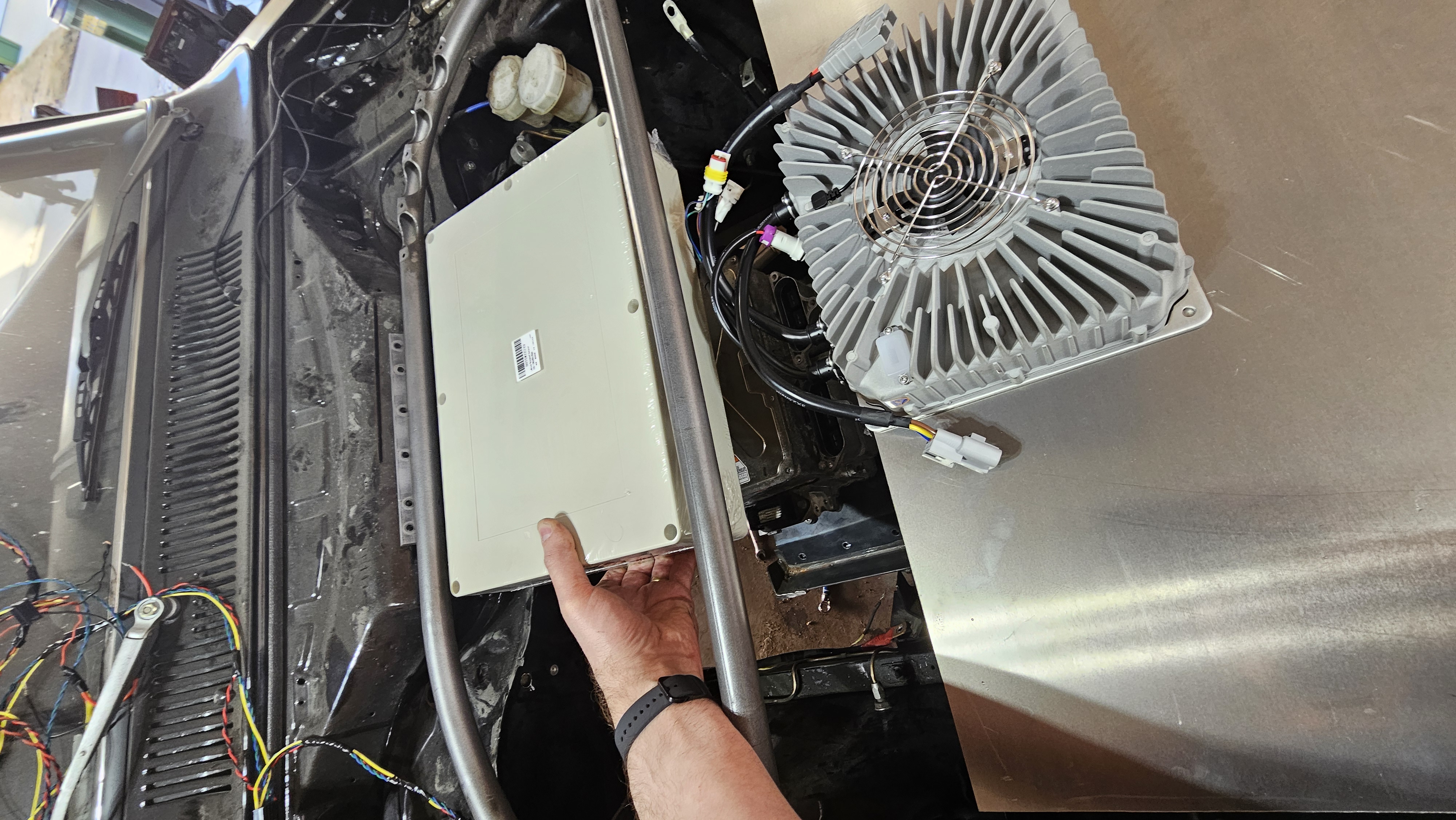

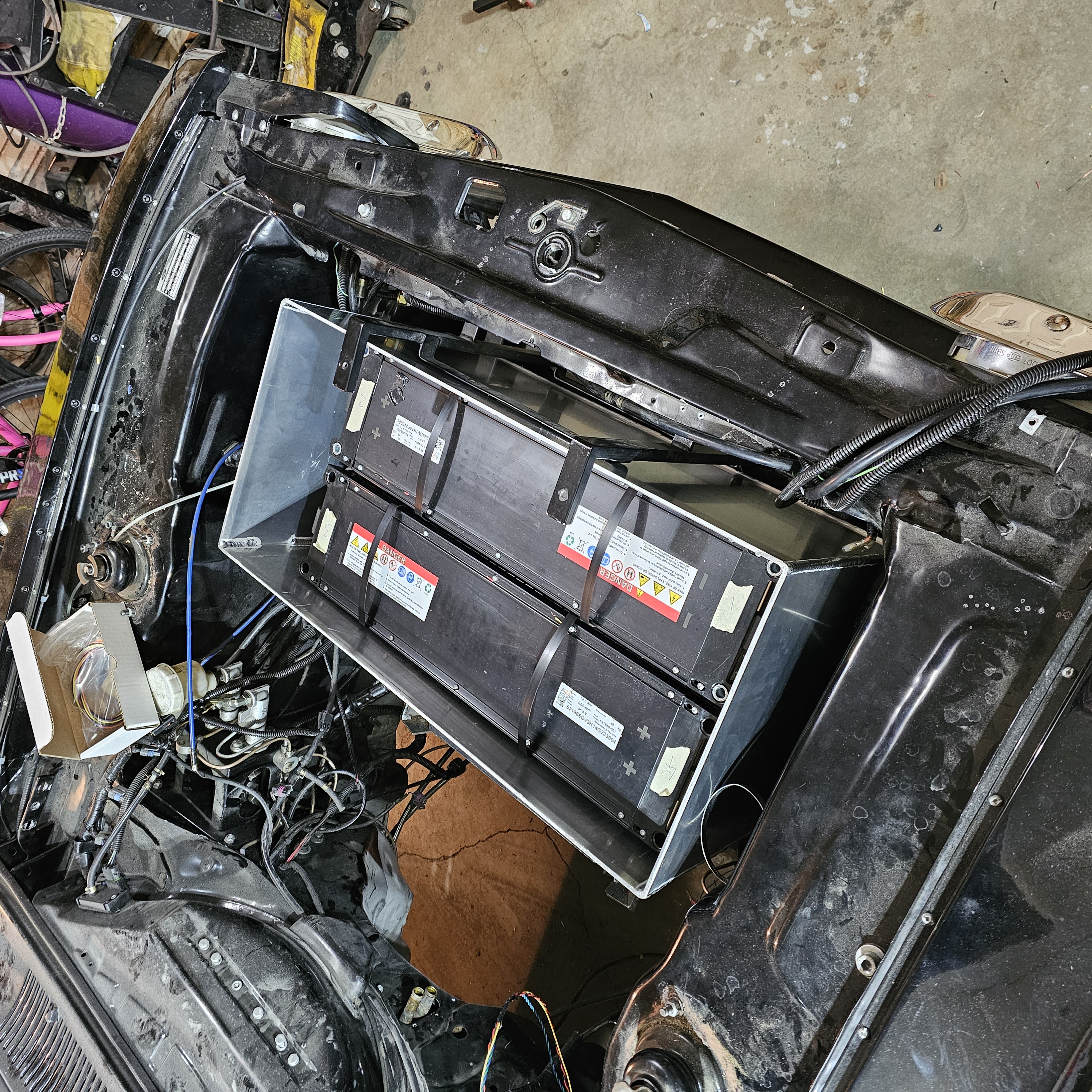

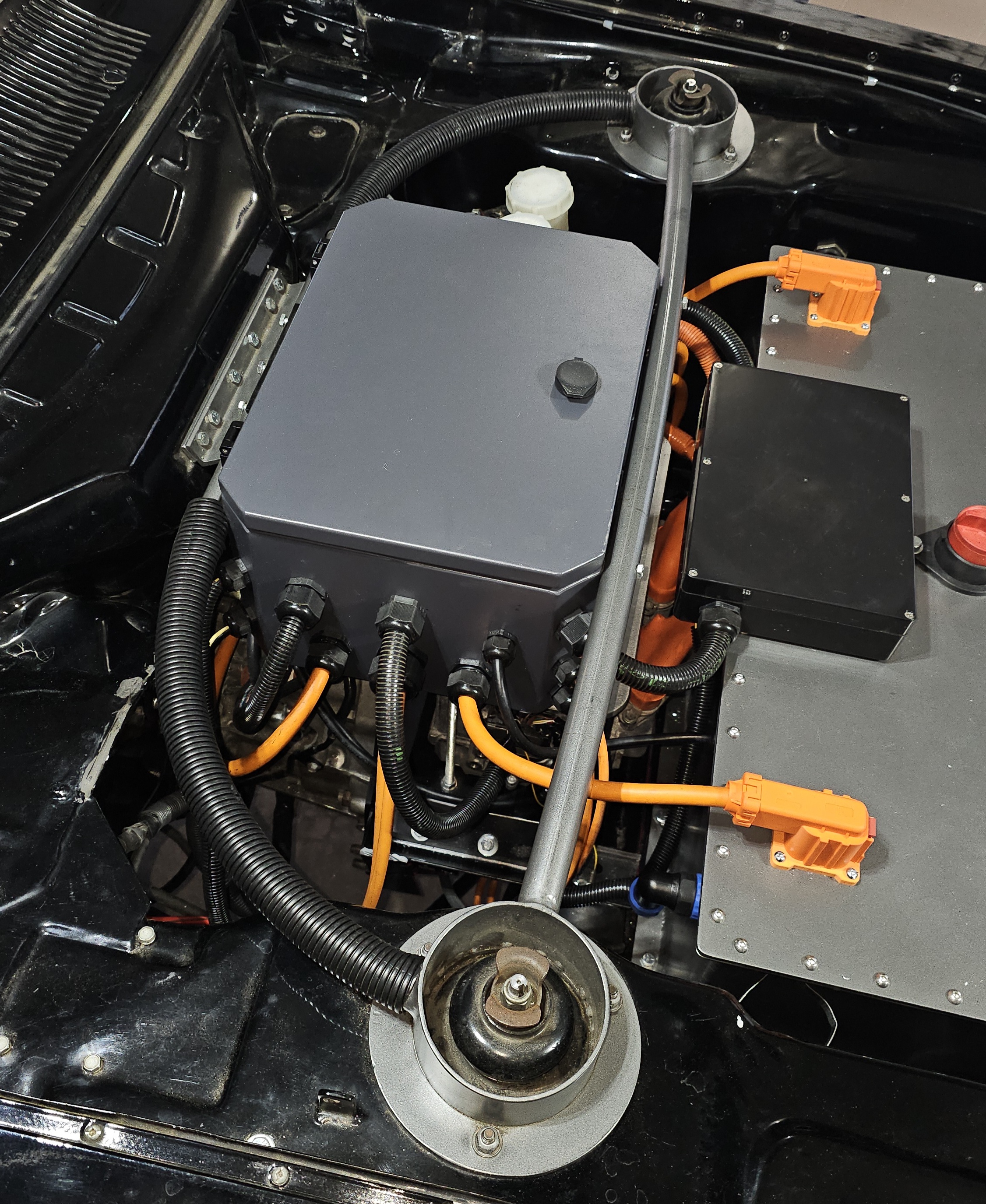

Some progress
Pretty much all the physical items in place, final wire up in progress.
Posts: 6969
Has thanked: 455 times
Been thanked: 1771 times
Wow, that is a super clean installation!

This looks really great. Any pics of how you mounted the gs450? I'm about to get into that part of my project quiet soon.
chrskly
Posts: 174
Location: Dublin, Ireland
Has thanked: 69 times
Been thanked: 69 times
Post by chrskly »
Oh, duhhh, they're right there back up in the thread. Sorry!

johu wrote: Sat Jul 05, 2025 6:45 am Wow, that is a super clean installation!
Thanks!
I like to plan things out in my head when I'm running boring (not drilling) machines at work...
Fingers crossed when I plug it in it will charge, and when I turn the key it will precharge, and when I push the throttle it will move. . .
