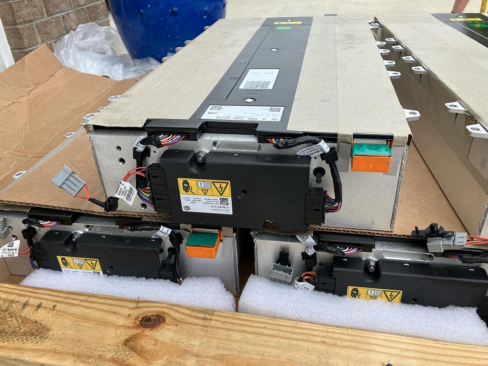

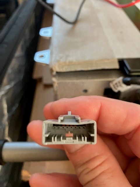

I have these Mercedes EQS modules. I am integrating these into my 1971 Beetle project, and right now I am trying to find the least expensive path forward for charging and BMS.
What I know: These are from a Mercedes EQS. They are CATL modules, 18s1p, 66v, 9+ kWh each. I have five, which I selected because they will fit in custom floor-mounded boxes and give my Beetle decent range and power. The prime mover is a Tesla rear SDU.
What I think I know: The black boxes on each module is a slave BMS. The 26 wires coming into this slave are probably 18 cell voltages, ground, temp, current sensors, etc. The open connector has 4 wires, which I ASSUME is for the CANBus.
What I don't know: So much!
CanBus is 2 wires, CANH and CANL. But there should also be a 12v in and a ground, right? Without 12v the CAN won't wake up and send signals? I have a CANBus logger, but I need help trying to figure out which wire is which. Is there a procedure to figure it out? So, I tried using a multimeter across the pins, and I did see 12v from a couple pins, which diminished to zero. Assuming that I discharged a capacitor? Can I assume that the pin that was 12v temporarily was the 12v in wire? I have 4 other modules that probably have charge in their capacitors still.
I have tried researching these connectors and these BMS, and there is not much info out there. One German website inscrutably calls this a "control module". I also haven't had much luck decoding Mercedes wire colors. Although each wire is orange with a stripe, I would guess that orange/black is B-, orange/red is B+, and orange/green, orange/blue is the CAN signal? I don't want to fry anything by tinkering without more knowledge.
My goal: I want to verify that I am dealing with a BMS slave, and log the CAN signals, so that I can send those logs to Vero Electric to see if they recognize the format and possibly if the Vero BMS 2.0 can run them. That would be an ideal solution.
If I cannot figure that out, I can go a full BMS. I would love to use the OpenInverter BMS cards, but they are 12-channel and ideally I would have 1 18-channel BMS board per module?
This is the advice that I am looking for. Happy to share what I learn, because these EQS modules tick a lot of checkboxes for EV conversions: They are compact, relatively light, sturdy, high-voltage, and at the very least have easy-to-access wiring harnesses!

Open up the slave module and take detailed pictures of the slave boards.
No point speculating.

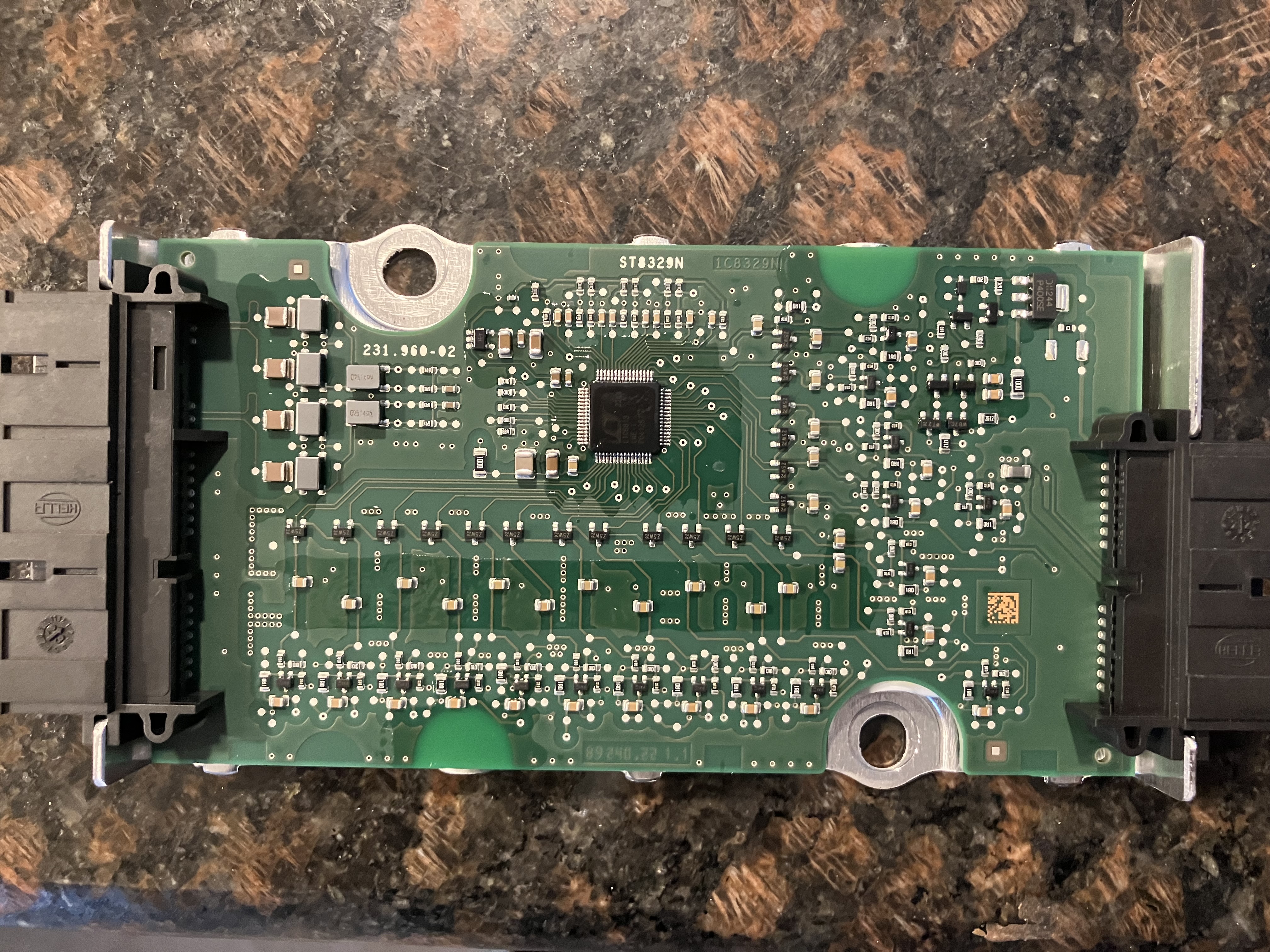

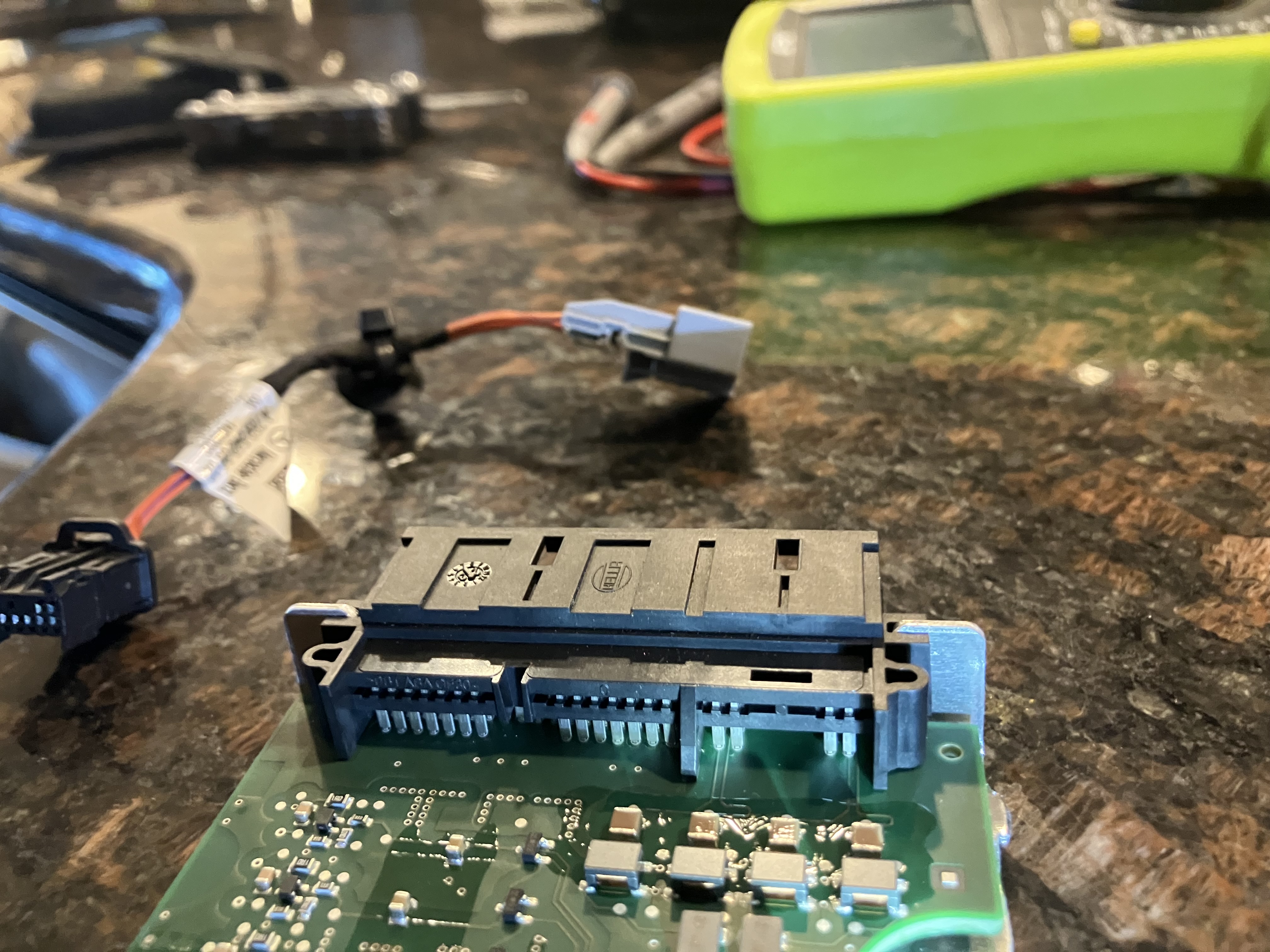

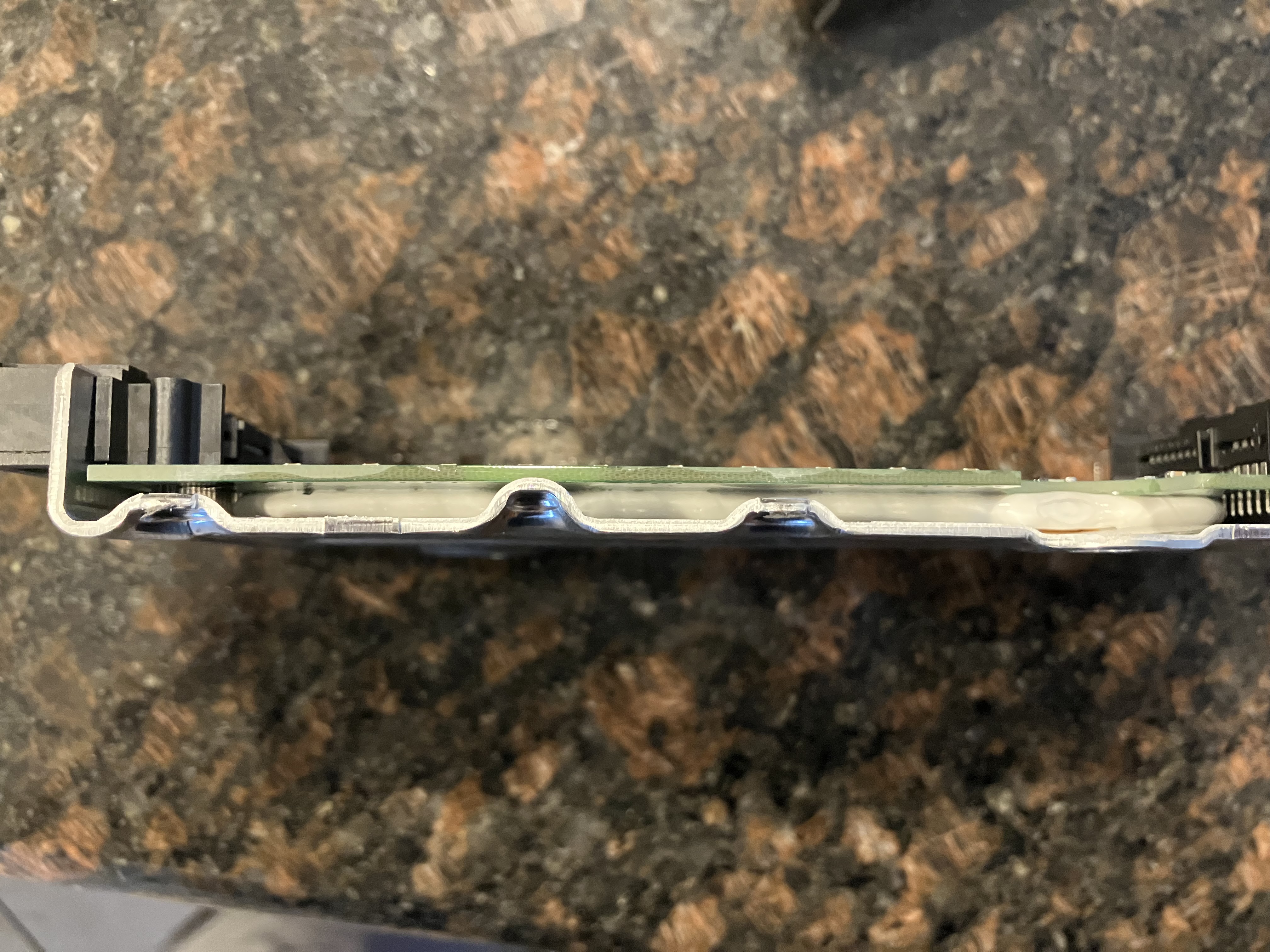

Okay, what I see: 18 voltage channels, 2 CAN channels?
The traces are so tiny I need a magnifying lens. But it appears the 4 wires in the harness use the outer 4 pins on that connector (out of 8) which each seem to go to a diode and an oscillator? No obvious 12v or ground. Can you make sense of this?

Re: Mercedes EQS modules with slave BMS boards
I don’t see any traces on the back so I think those inner 4 are just part of the Hella connector and not used in this circuit.
LTC6813 so its has ISO-SPI
https://www.analog.com/media/en/technic ... 8134fa.pdf
Old chip for something so "new"

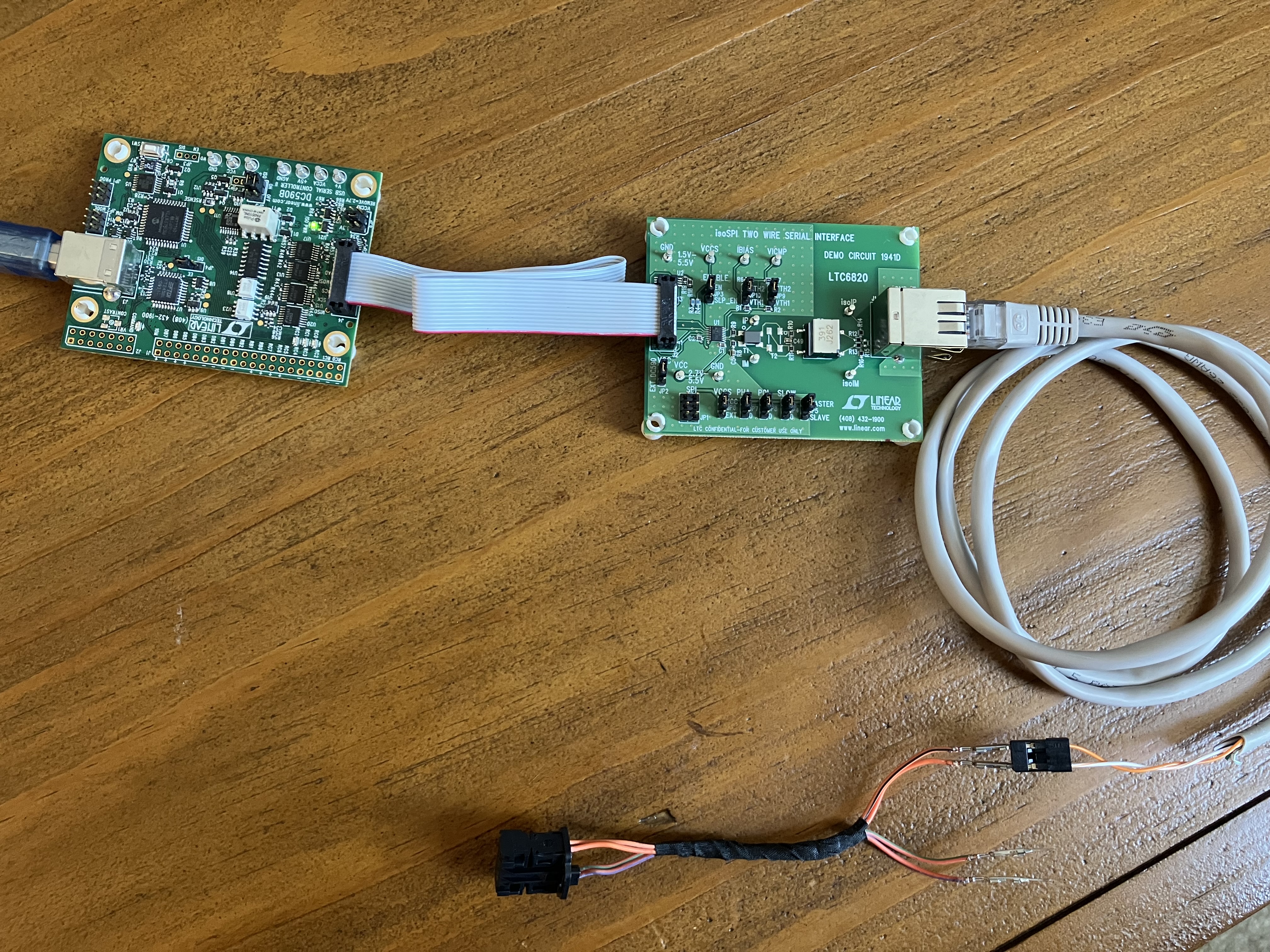

Okay I’ve learned that the DC1941D will probably work but you also need either the DC590B usb interface or the Linguino interface for it. Picked up the former on eBay and trying to get the SPI wires right to see if I can get data.
Also the connector to the SPI interface: found it on Digikey:
https://www.digikey.com/en/products/det ... 1/10478170
Here is my setup: Computer connects to the DC590B demo card. This can interface with a bunch of stuff (including a gas gauge driver I also have) but I am connected to the DC1941D. The RJ45 uses ONLY pins 1 and 2, which I connected to a connector so I can experiment with the final connection to the Mercedes BMS satellite. Now I don’t know which is SPI in and which is SPI out, and of those choices and don’t know which is IM and which is IP… so 4 possible configurations to test.
I still don’t know if the MCU will work; don’t want to drop $480 just to test it, at least without more data.

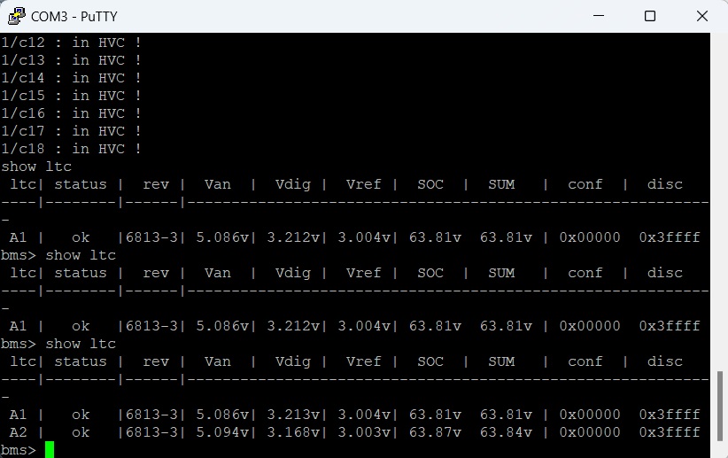

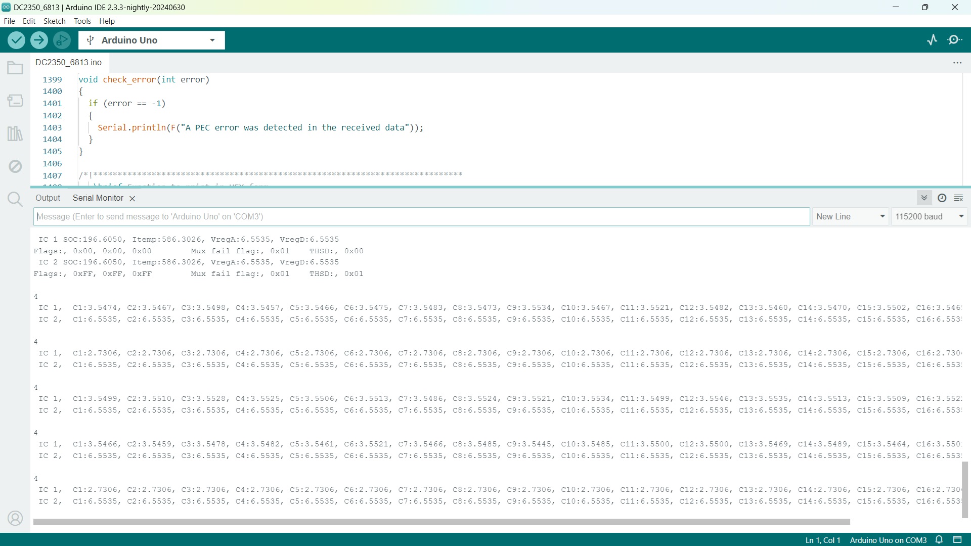

More progress! So, long story short. The "Quickeval" software and DC590 board does NOT work with the LTC6813 18-cell monitor.
So I tried using an Arduino Uno to read the cell voltages directly. That doesn't work, without building a separate LTC6813 circuit for isoSPI to SPI conversion.
Finally I broke down and bought the Linduino One (DC2026C), which interfaces with the LTC6820 isoSPI board.
Took a little setting up. The LTSketchbook available on GitHub doesn't seem to have the right part number, but I found the right code and installed it, and using the above setup, was able to talk to the modules!
And I immediately freaked out. I checked all 5 modules, and 2 of 5 are reporting less than 3 volts per cell (bad!)
But then I checked the MODULE voltage, and each are at more than 64 volts... Then I realized each of those "bad" cells are showing EXACTLY 2.7306v. I checked the documentation and this corresponds to a return of 0x00. And then I further realized those two modules are "left handed" modules. Which means I am probably reading the wrong "side" of the isoSPI...
So... Phew. I believe that I have a working way to communicate with the satellite BMS cards on the modules, and I believe that all my modules are good (and apparently at about 50% SOC?)
Also big takeaway: If I can communicate then the Mercedes modules are not using some sort of proprietary control suite. So... PERHAPS I will be able to use this to act as the Master BMS with some additional code (I found some SAE team code that might work) Or PERHAPS I can use the Thunderstruck BMS off-the-shelf?

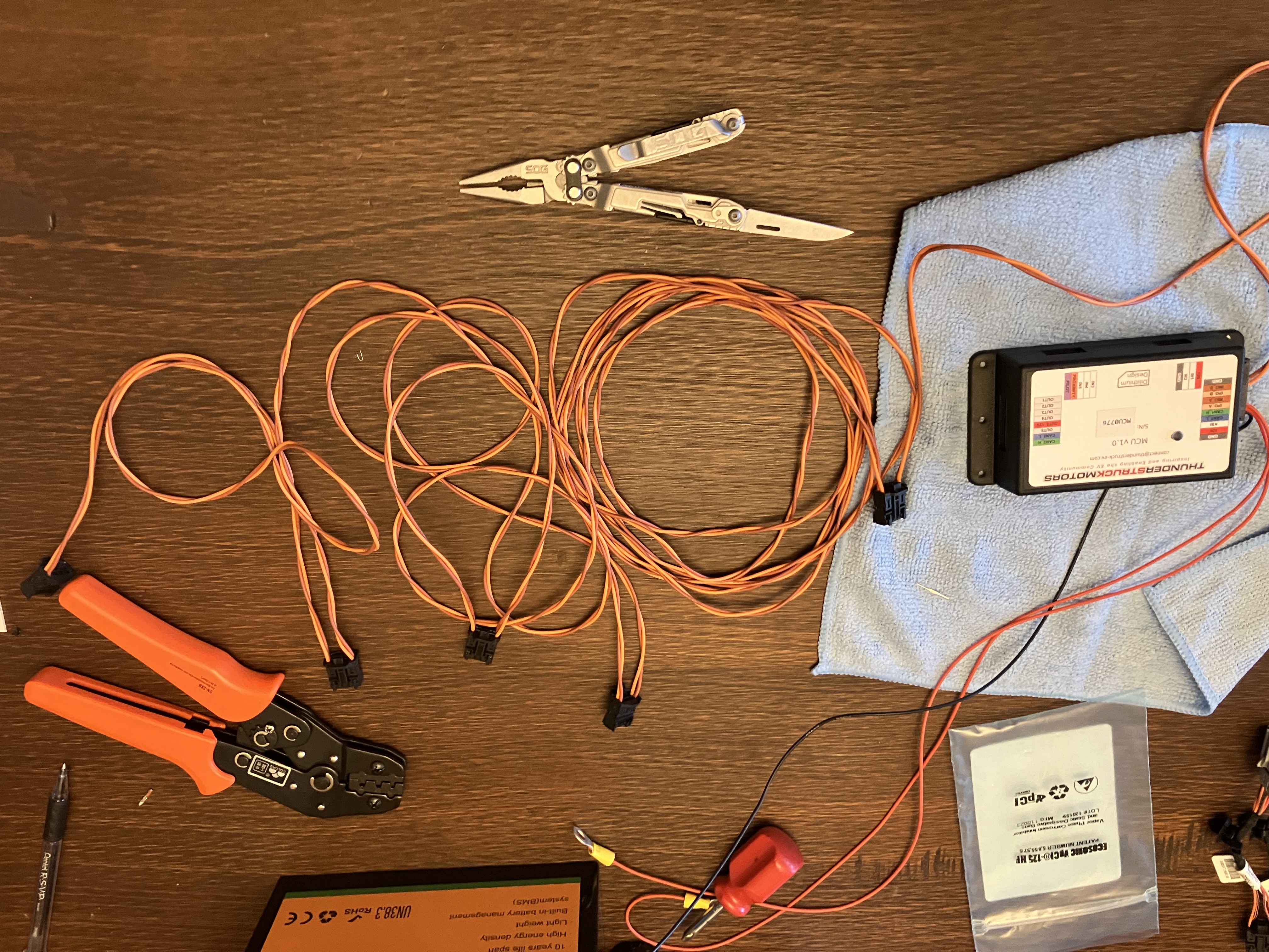

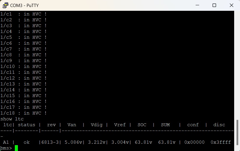

Time to announce an answer to the question: Can the MCU run the Mercedes BMS satellites?
YES.
Here's what you need to know. First, make sure you follow all the Thunderstruck MCU instructions. You need to set up a serial communication port using PuTTY, configure it correctly, then, at a minimum connect the 12v AND KSI to 12v, and the associated ground to ground. Here is the basic setup, I am using my LiFePO4 battery for power:

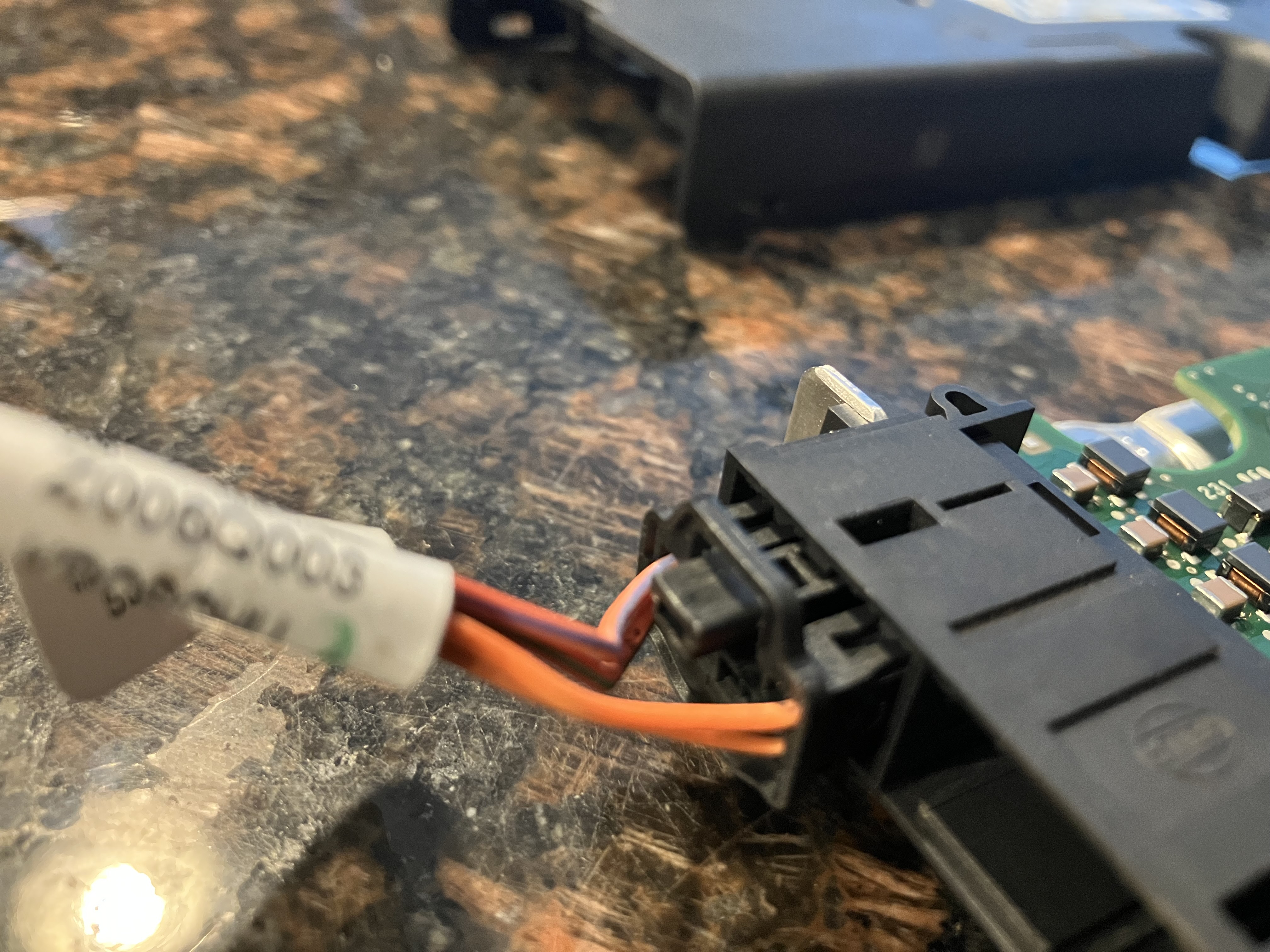

The MCU can handle 16 satellite BMS boards, for a maximum of 288 cells. I am 96 cells in 5 modules, so I only need to use one of the two provided IsoSPI ports. To test, I crimped open female tangs on each wire and tested:

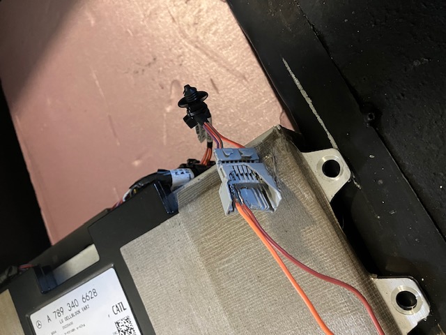

There are 4 wires on the Mercedes communcation plug. Just have to figure out which are which. 4 possible options for connecting them correctly, and I got it right literally on the fourth try. Test by running the "show ltc" command in the serial prompt, until:
So that's one down. Important data: orange/blue is IPI, orange/green is IMI. Which means the orange SHOULD be IPO and the orange/black SHOULD be IMO. Made another long twisted pair to go from there to the next module:

(Note I am getting "In HVC!" warnings on each cell. HVC is "High Voltage Cut-off", which I have not configured yet. The individual cell voltages are ar 3.55v, or somewhere between 20-50% SOC)
The wiring harness done, and now my eyes hurt:
YES.
And... This time, first try.
Now that I confirmed those, the other 3 are easy (assuming no damage to the satellite modules, but I checked those previously).
So, finally, Thunderstruck MCU orange (IPO_A) to Mercedes orange/blue (IPI) and MCU brown (IMO_A) to Mercedes orange/green (IMI), then Mercedes orange (IPO) to the next orange/blue (IPI), and Mercedes orange/black (IMO) to the next Mercedes orange/green (IMO), etc.
