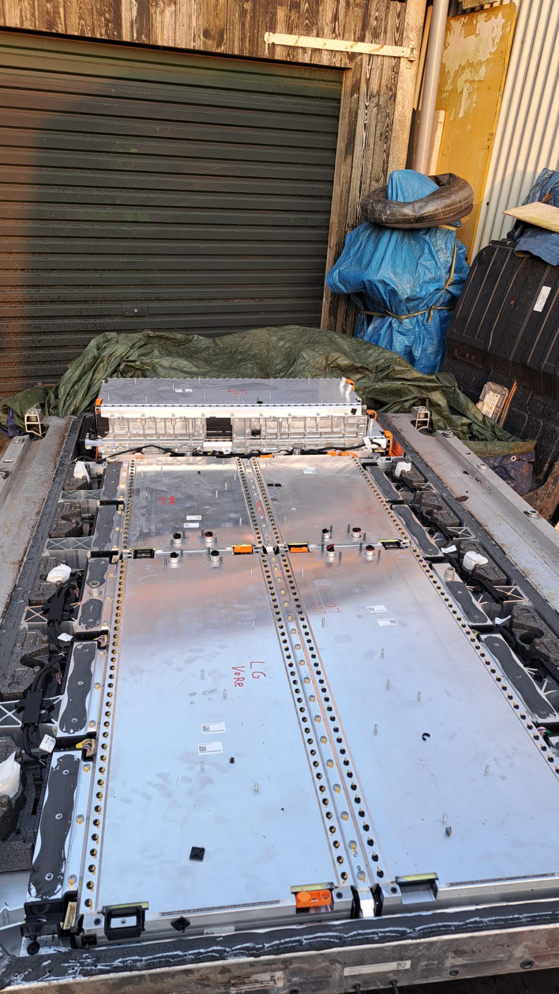

What I know: These are from a Mercedes EQS. They are CATL modules, 18s1p, 66v, 9+ kWh each. I have five, which I selected because they will fit in custom floor-mounded boxes and give my Beetle decent range and power. The prime mover is a Tesla rear SDU.
What I think I know: The black boxes on each module is a slave BMS. The 26 wires coming into this slave are probably 18 cell voltages, ground, temp, current sensors, etc. The open connector has 4 wires, which I ASSUME is for the CANBus.

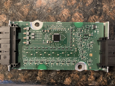

Open up the slave module and take detailed pictures of the slave boards.
No point speculating.

Re: Mercedes EQS modules with slave BMS boards

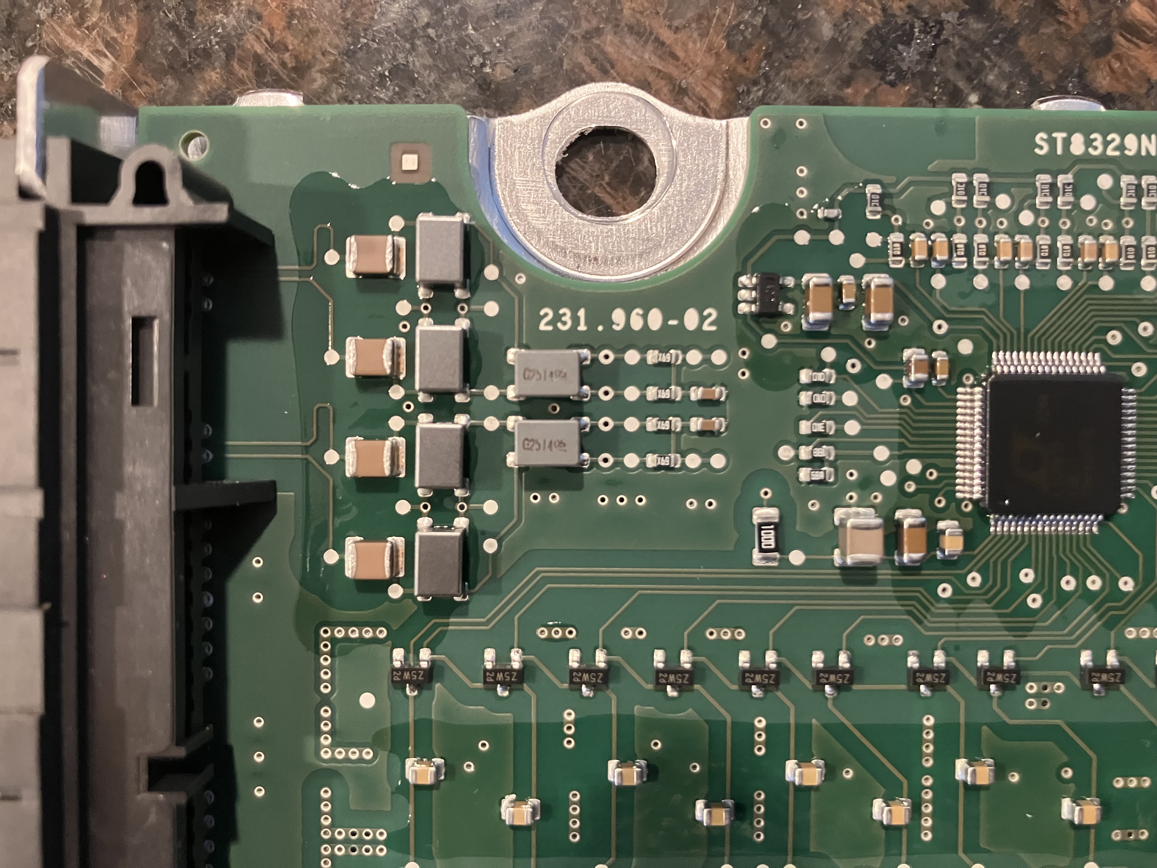

Okay, what I see: 18 voltage channels, 2 CAN channels?
The traces are so tiny I need a magnifying lens. But it appears the 4 wires in the harness use the outer 4 pins on that connector (out of 8) which each seem to go to a diode and an oscillator? No obvious 12v or ground. Can you make sense of this?
I don’t see any traces on the back so I think those inner 4 are just part of the Hella connector and not used in this circuit.
LTC6813 so its has ISO-SPI
https://www.analog.com/media/en/technic ... 8134fa.pdf
Old chip for something so "new"

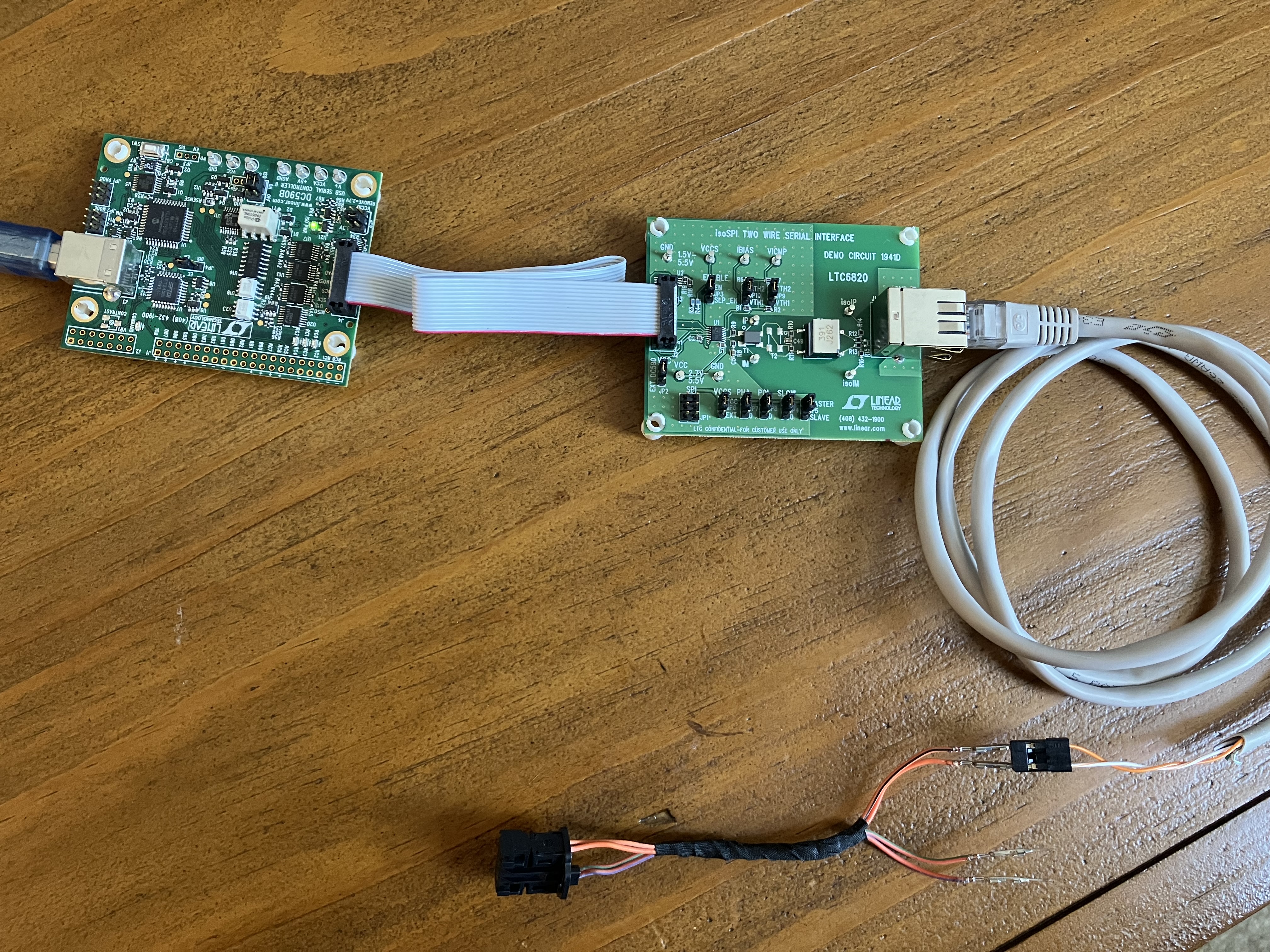

Okay I’ve learned that the DC1941D will probably work but you also need either the DC590B usb interface or the Linguino interface for it. Picked up the former on eBay and trying to get the SPI wires right to see if I can get data.
Also the connector to the SPI interface: found it on Digikey:
https://www.digikey.com/en/products/det ... 1/10478170

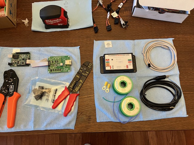

Here is my setup: Computer connects to the DC590B demo card. This can interface with a bunch of stuff (including a gas gauge driver I also have) but I am connected to the DC1941D. The RJ45 uses ONLY pins 1 and 2, which I connected to a connector so I can experiment with the final connection to the Mercedes BMS satellite. Now I don’t know which is SPI in and which is SPI out, and of those choices and don’t know which is IM and which is IP… so 4 possible configurations to test.
I still don’t know if the MCU will work; don’t want to drop $480 just to test it, at least without more data.

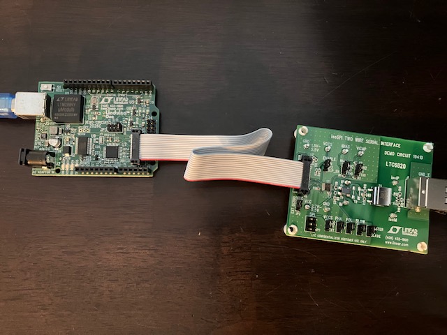

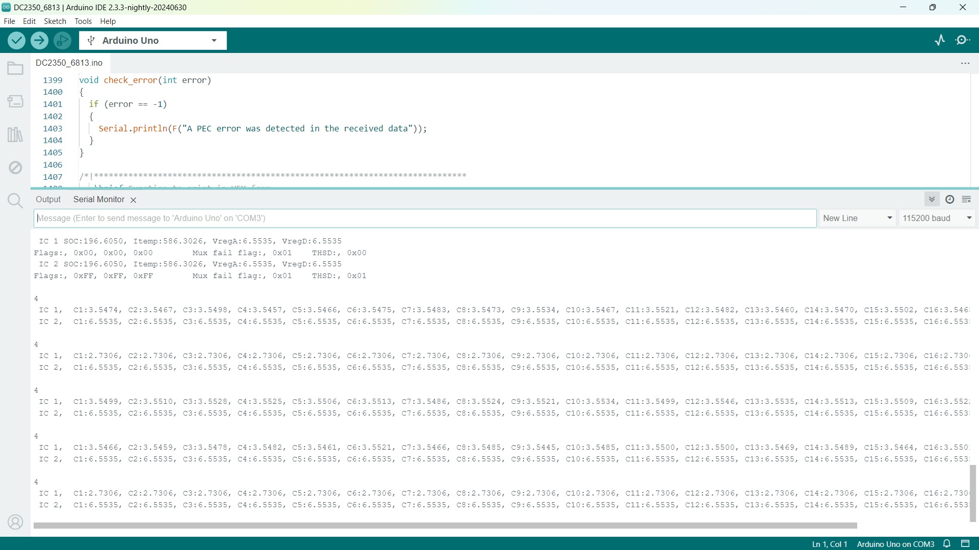

More progress! So, long story short. The "Quickeval" software and DC590 board does NOT work with the LTC6813 18-cell monitor.
So I tried using an Arduino Uno to read the cell voltages directly. That doesn't work, without building a separate LTC6813 circuit for isoSPI to SPI conversion.

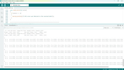

Finally I broke down and bought the Linduino One (DC2026C), which interfaces with the LTC6820 isoSPI board.
Took a little setting up. The LTSketchbook available on GitHub doesn't seem to have the right part number, but I found the right code and installed it, and using the above setup, was able to talk to the modules!
And I immediately freaked out. I checked all 5 modules, and 2 of 5 are reporting less than 3 volts per cell (bad!)
But then I checked the MODULE voltage, and each are at more than 64 volts... Then I realized each of those "bad" cells are showing EXACTLY 2.7306v. I checked the documentation and this corresponds to a return of 0x00. And then I further realized those two modules are "left handed" modules. Which means I am probably reading the wrong "side" of the isoSPI...
So... Phew. I believe that I have a working way to communicate with the satellite BMS cards on the modules, and I believe that all my modules are good (and apparently at about 50% SOC?)
Also big takeaway: If I can communicate then the Mercedes modules are not using some sort of proprietary control suite. So... PERHAPS I will be able to use this to act as the Master BMS with some additional code (I found some SAE team code that might work) Or PERHAPS I can use the Thunderstruck BMS off-the-shelf?

So you are finding so far what I said is true.
Good to know Mercedes have not opted to try and lock down their BMS for no real reason what so ever.
Another option to communicate with ISOspi modules is Arduino shield DC2617A from Analog Devices (they are in short supply though), this will plug into an Arduino board (Uno a bit slow?, Uno R4, Duo) this provides CAN bus and ISOspi. I have hacked the Simpbms code to work with Uno R4 and LTC6812 based Polestar 2 satellite modules, could be adapted to work with LTC6813 satellite modules. It would be nice to see a ISOspi version of EVS-BMS(new Simpbms) hardware, this would make it simple to use ISOspi based BMS modules.

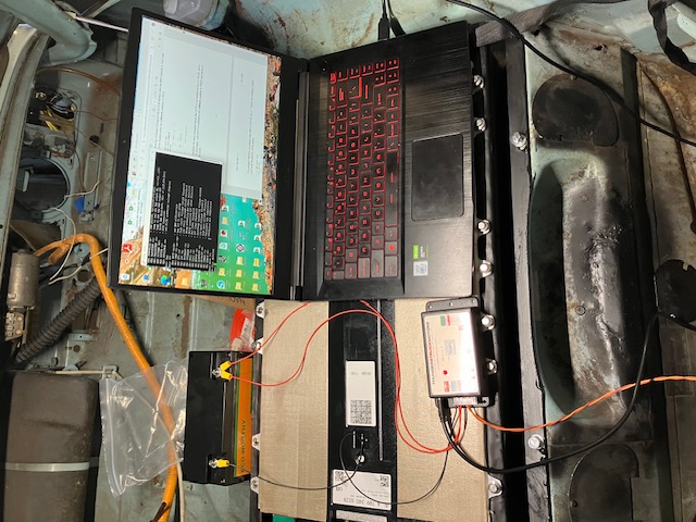

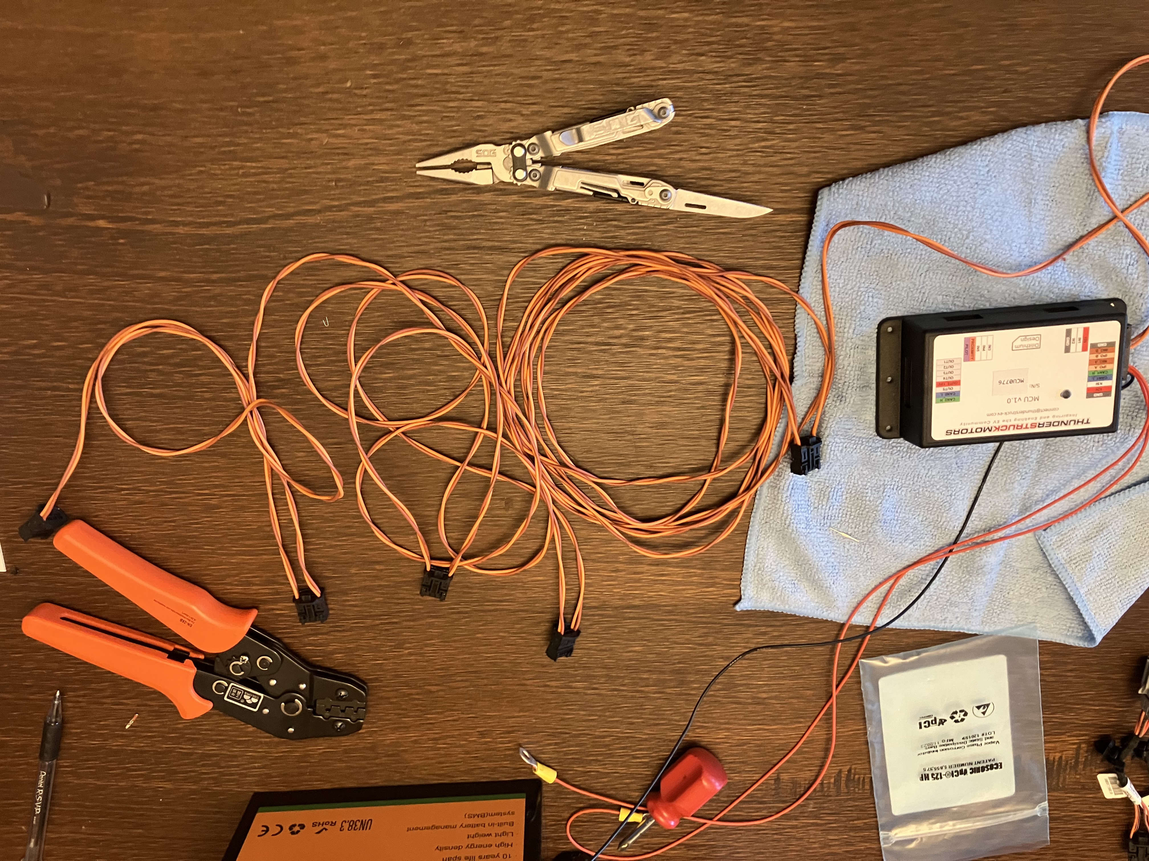

Time to announce an answer to the question: Can the MCU run the Mercedes BMS satellites?
YES.
Here's what you need to know. First, make sure you follow all the Thunderstruck MCU instructions. You need to set up a serial communication port using PuTTY, configure it correctly, then, at a minimum connect the 12v AND KSI to 12v, and the associated ground to ground. Here is the basic setup, I am using my LiFePO4 battery for power:
The MCU can handle 16 satellite BMS boards, for a maximum of 288 cells. I am 96 cells in 5 modules, so I only need to use one of the two provided IsoSPI ports. To test, I crimped open female tangs on each wire and tested:

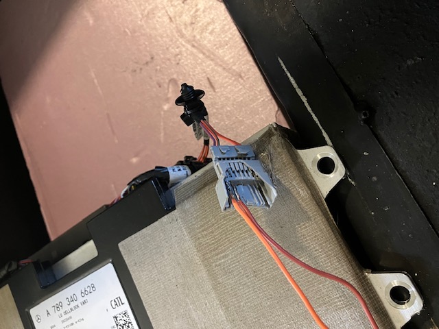

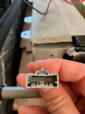

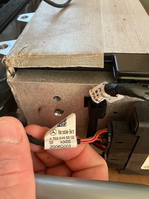

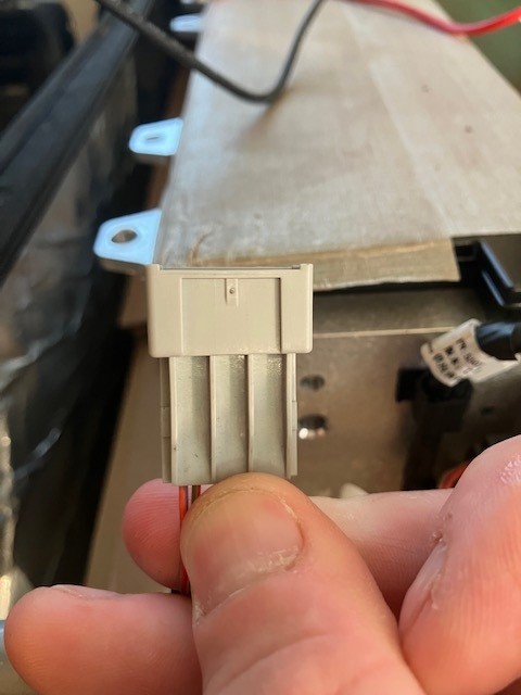

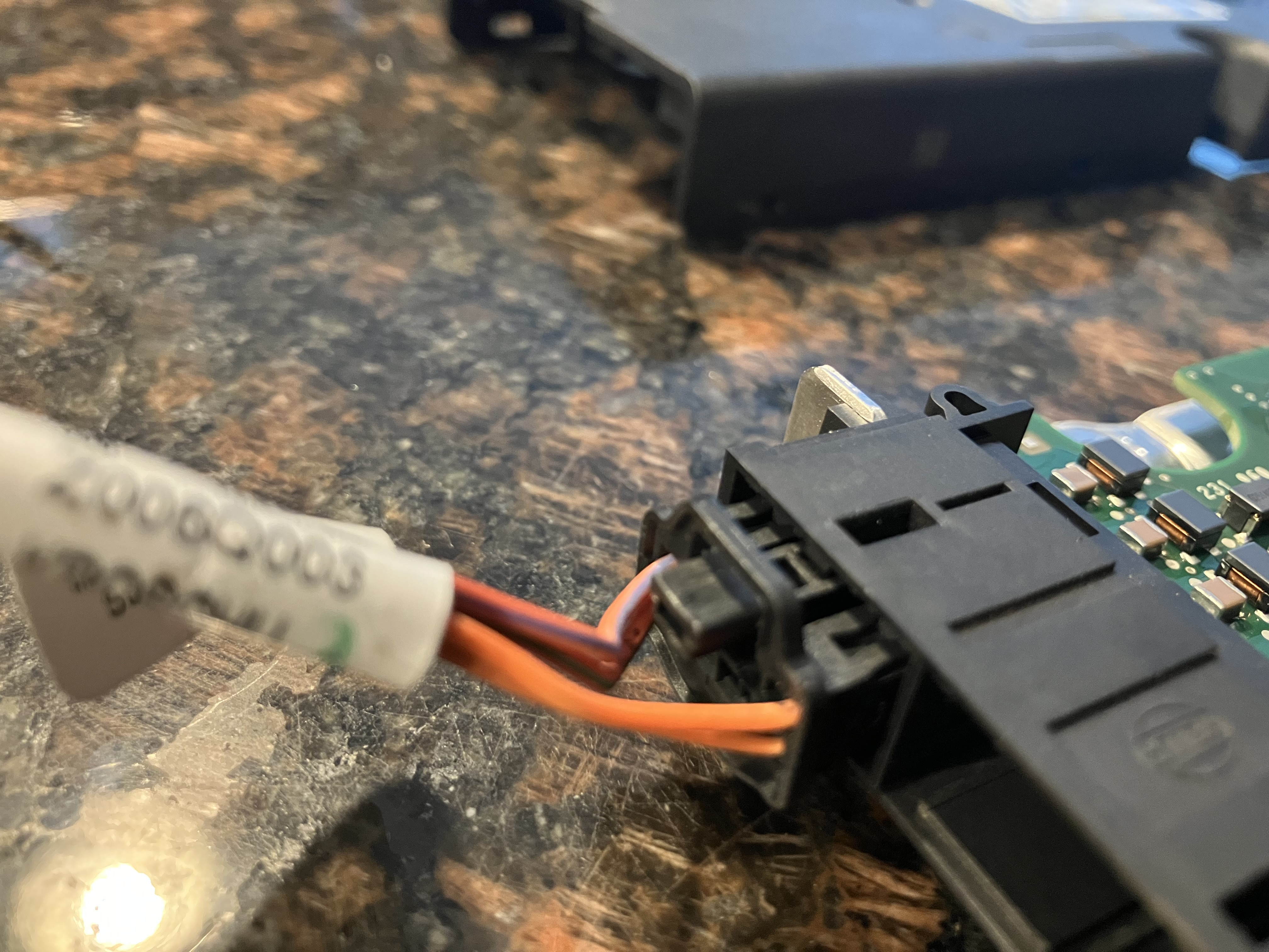

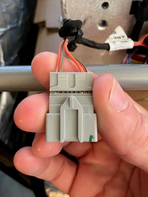

There are 4 wires on the Mercedes communcation plug. Just have to figure out which are which. 4 possible options for connecting them correctly, and I got it right literally on the fourth try. Test by running the "show ltc" command in the serial prompt, until:
So that's one down. Important data: orange/blue is IPI, orange/green is IMI. Which means the orange SHOULD be IPO and the orange/black SHOULD be IMO. Made another long twisted pair to go from there to the next module:
And... This time, first try.
Now that I confirmed those, the other 3 are easy (assuming no damage to the satellite modules, but I checked those previously).

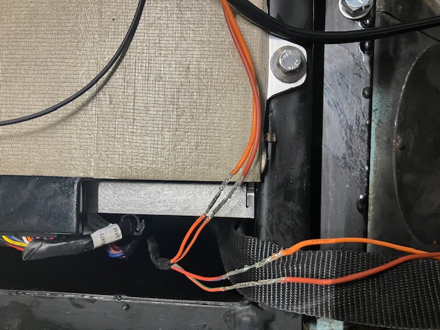

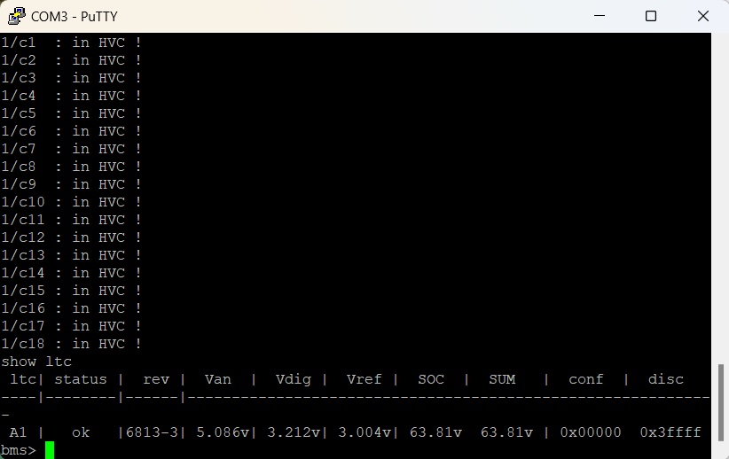

So, finally, Thunderstruck MCU orange (IPO_A) to Mercedes orange/blue (IPI) and MCU brown (IMO_A) to Mercedes orange/green (IMI), then Mercedes orange (IPO) to the next orange/blue (IPI), and Mercedes orange/black (IMO) to the next Mercedes orange/green (IMO), etc.

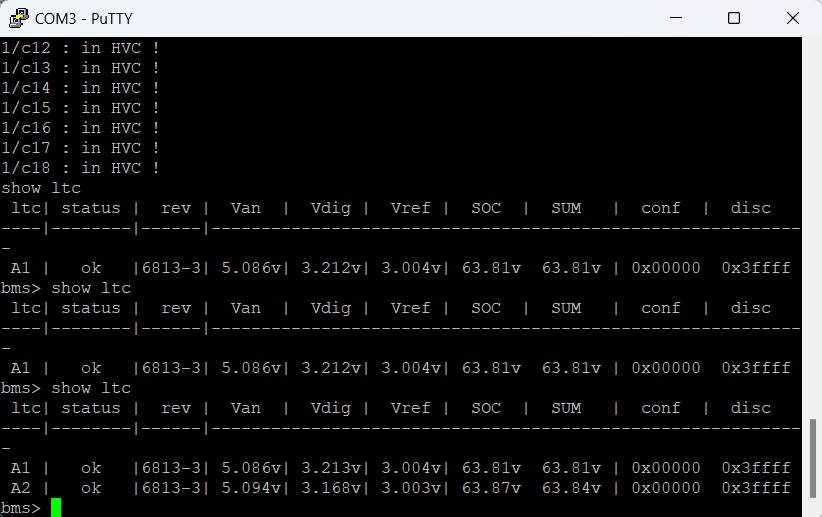

(Note I am getting "In HVC!" warnings on each cell. HVC is "High Voltage Cut-off", which I have not configured yet. The individual cell voltages are ar 3.55v, or somewhere between 20-50% SOC)
The wiring harness done, and now my eyes hurt:

Did you ever get a BMS to talk to the EQS modules? If not, I have developed one that can. Let me know if you are interested. It's still in Beta test, but I think you can handle it.
