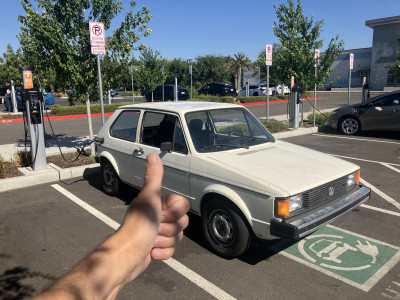

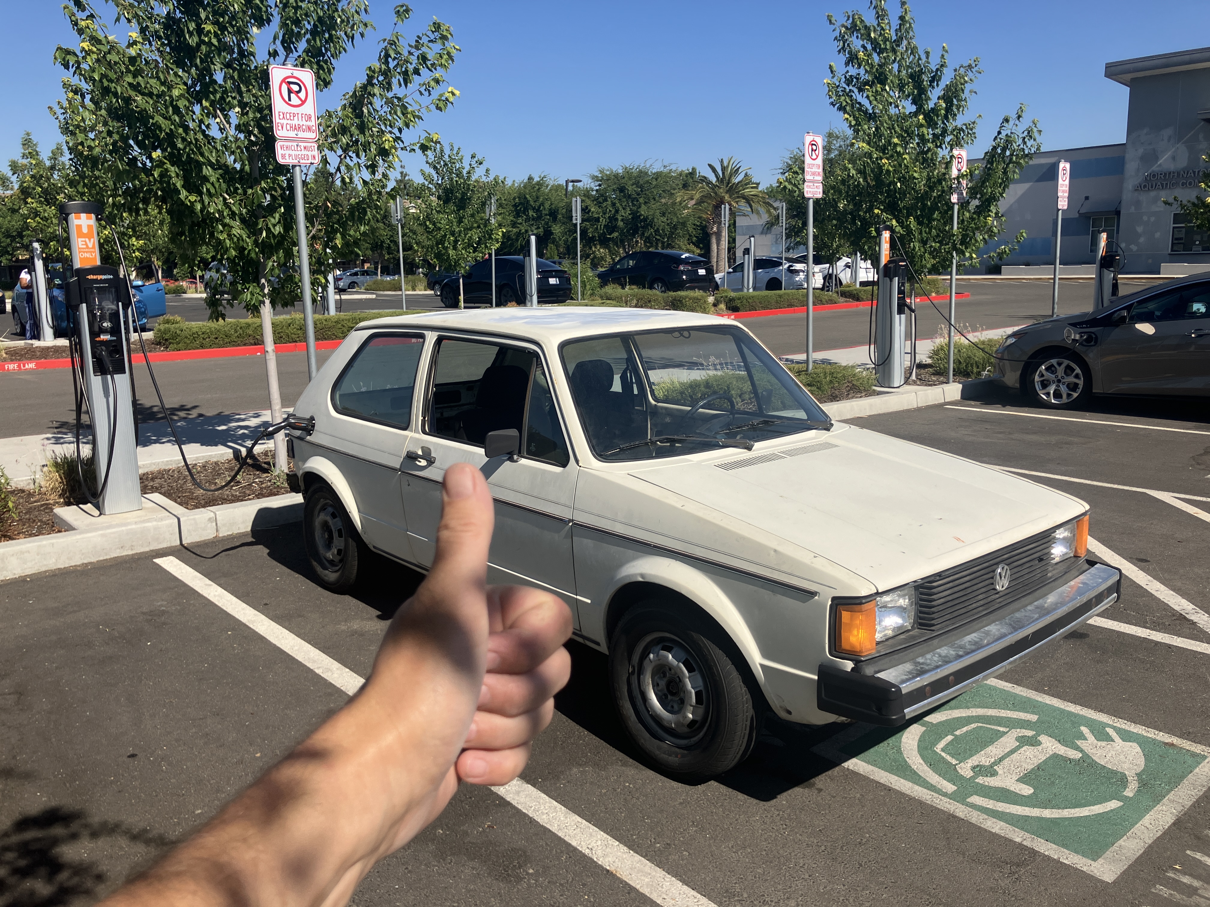

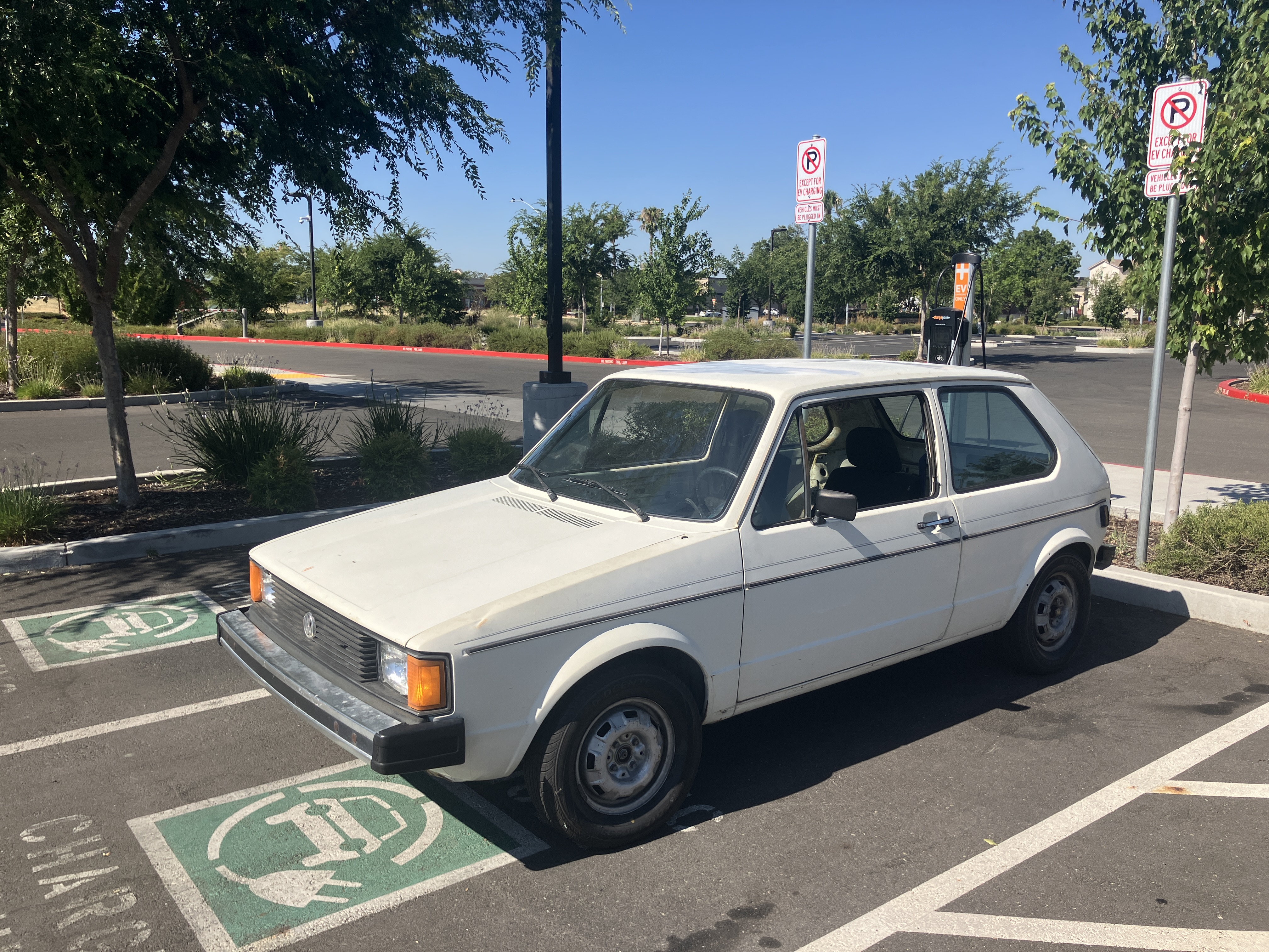

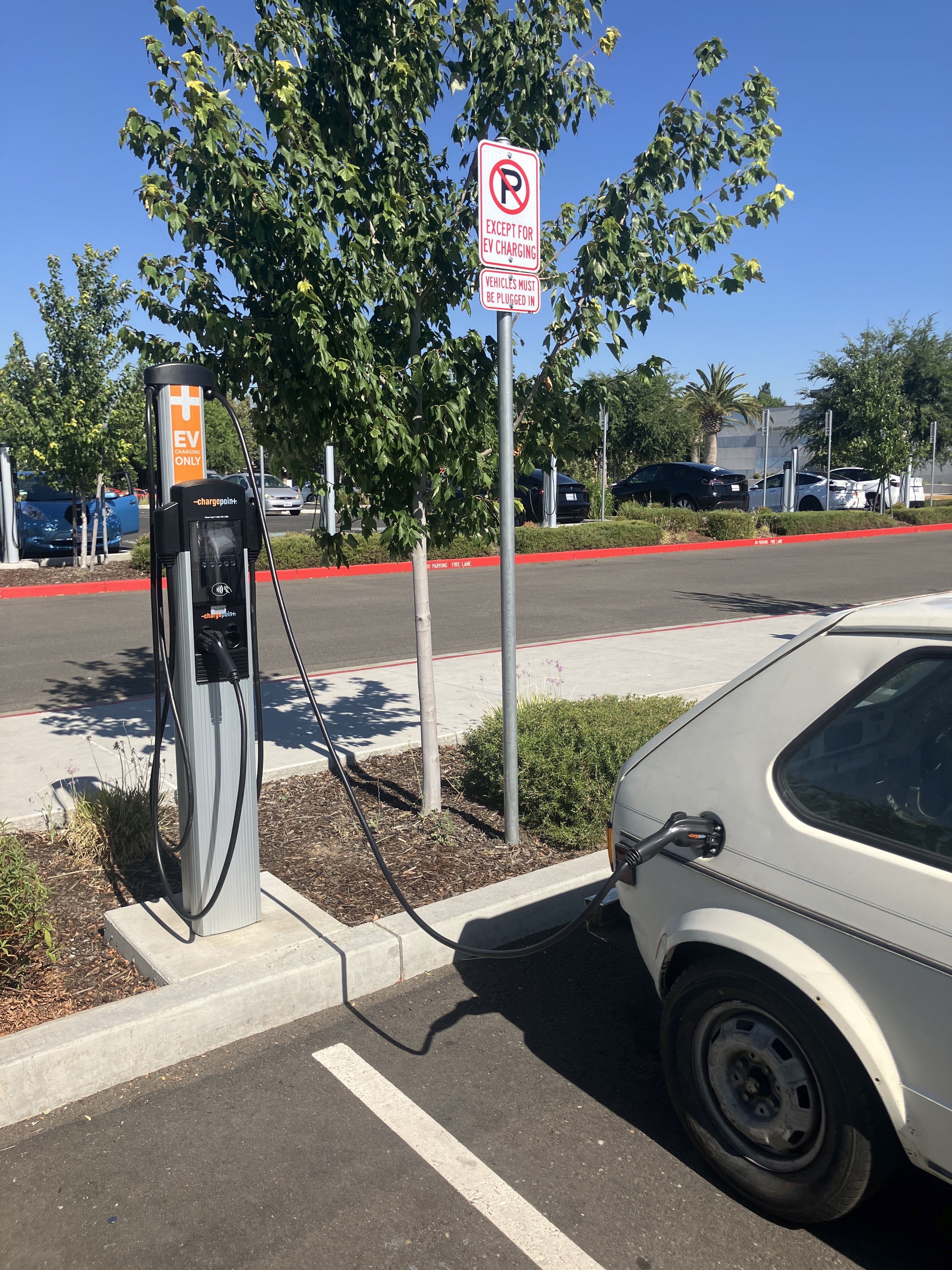

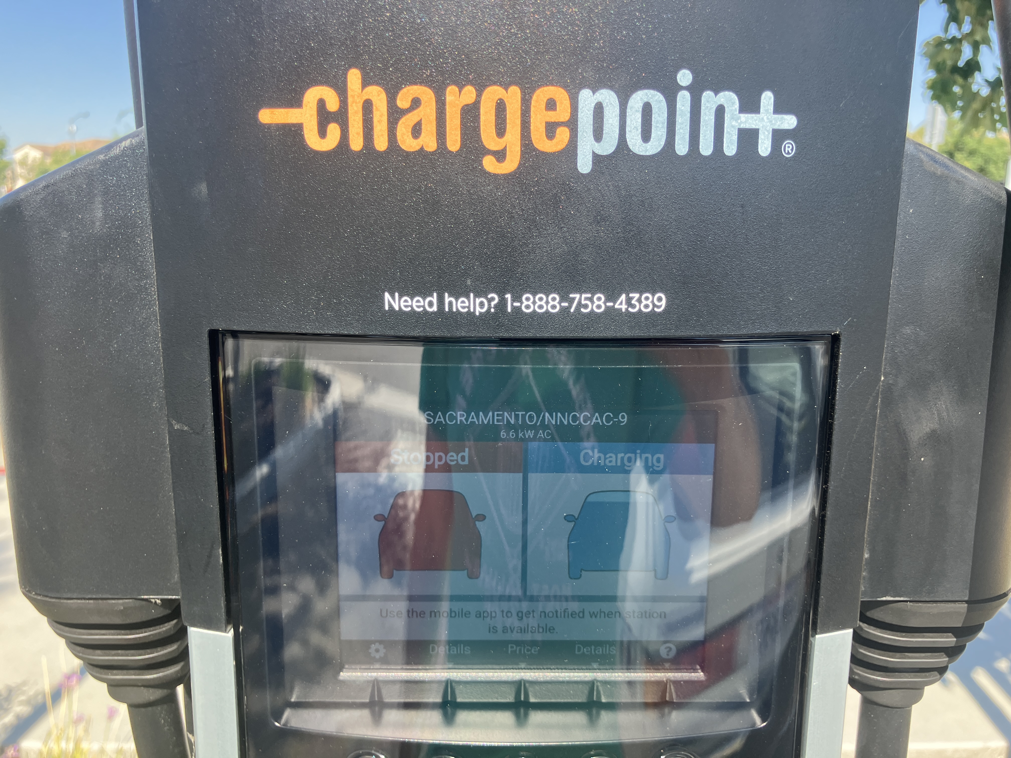

DIY EV VW Rabbit First Public Charging
Woodfie
Posts: 242
Location: Auckland NZ
Has thanked: 221 times
Been thanked: 95 times
Re: [DRIVING] 1984 Voltswagen Rabbit Prius Gen 3 ZOMBIE
Post by Woodfie »
Nice One, and the Free charger was Free of other Evs 😃

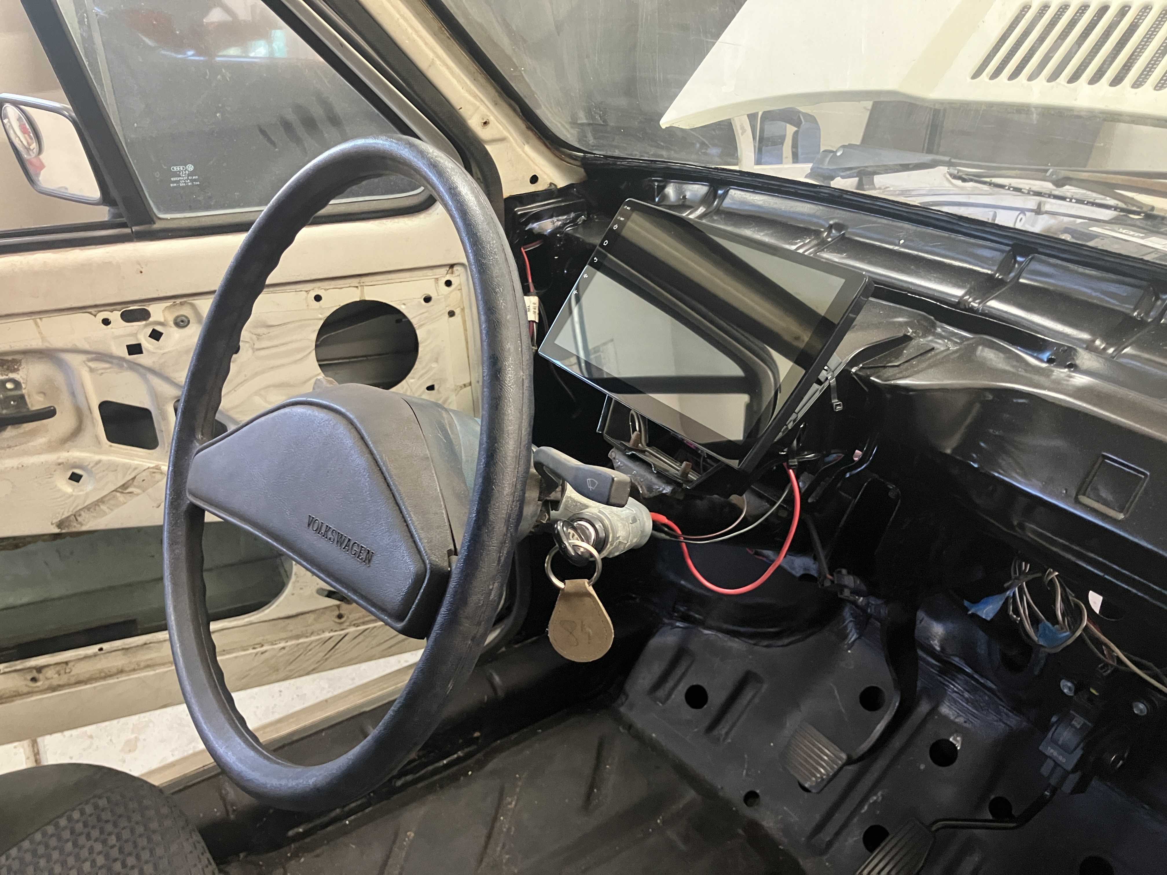

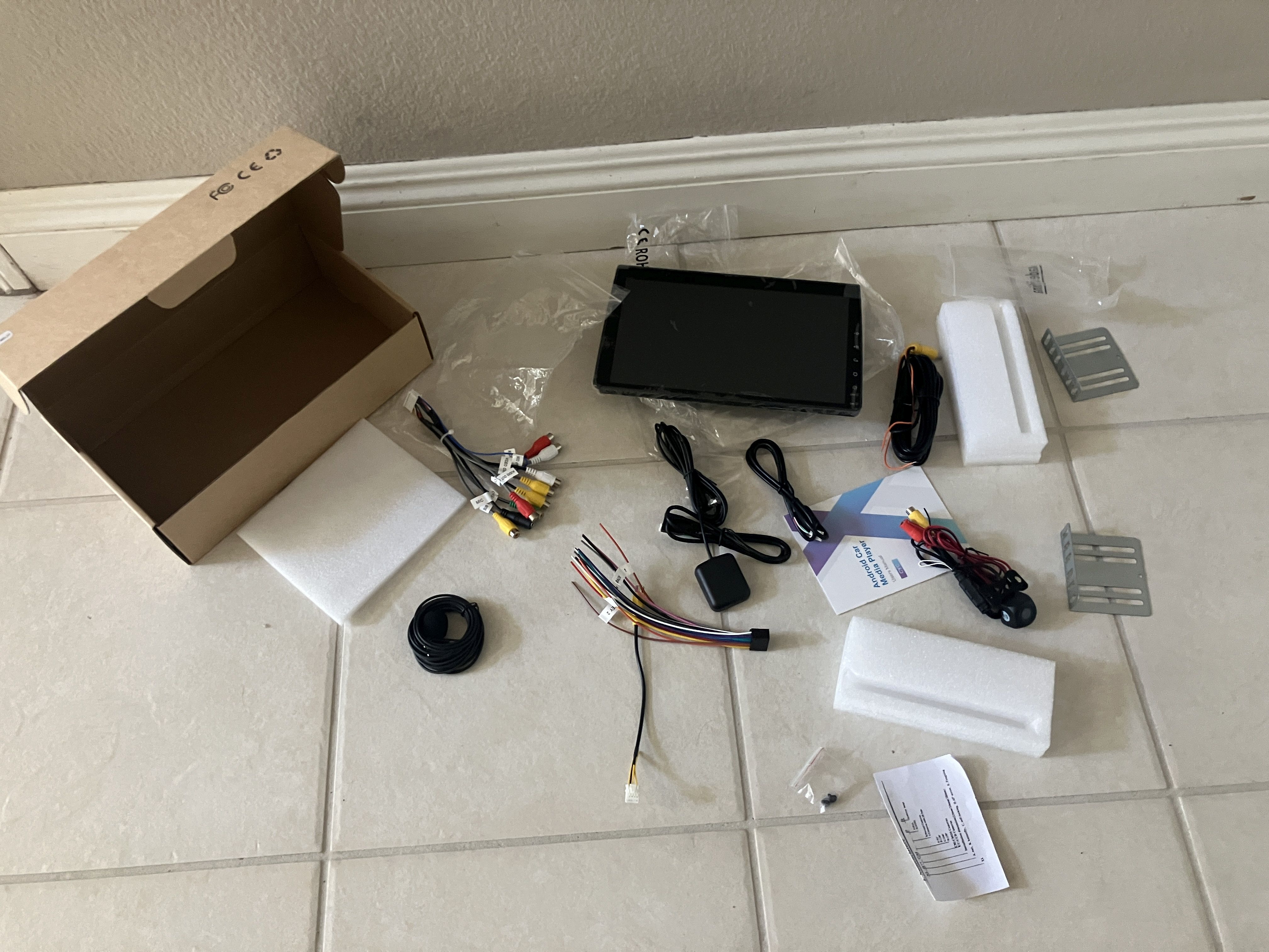

I suppose you'll be blaming me when the cheapest nastiest with the worst reviews on Amazon Android head unit runs like a dog and fails to connect to anything.
Fair enough!
Gregski
Posts: 2873
Has thanked: 530 times
Been thanked: 1190 times
Post by Gregski »
Alibro wrote: Tue Jul 09, 2024 4:13 pm I suppose you'll be blaming me when the cheapest nastiest with the worst reviews on Amazon Android head unit runs like a dog and fails to connect to anything.
Fair enough!

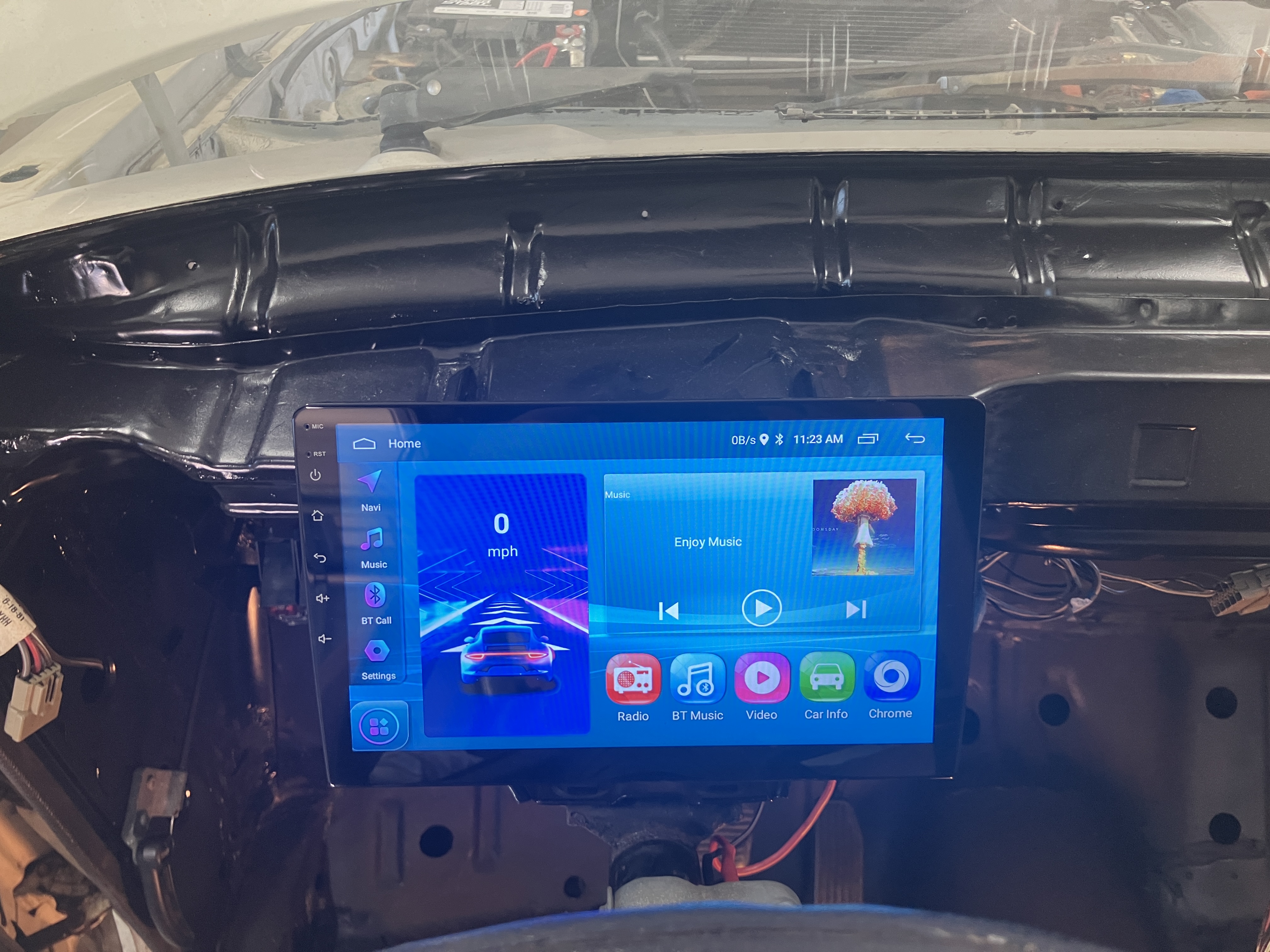

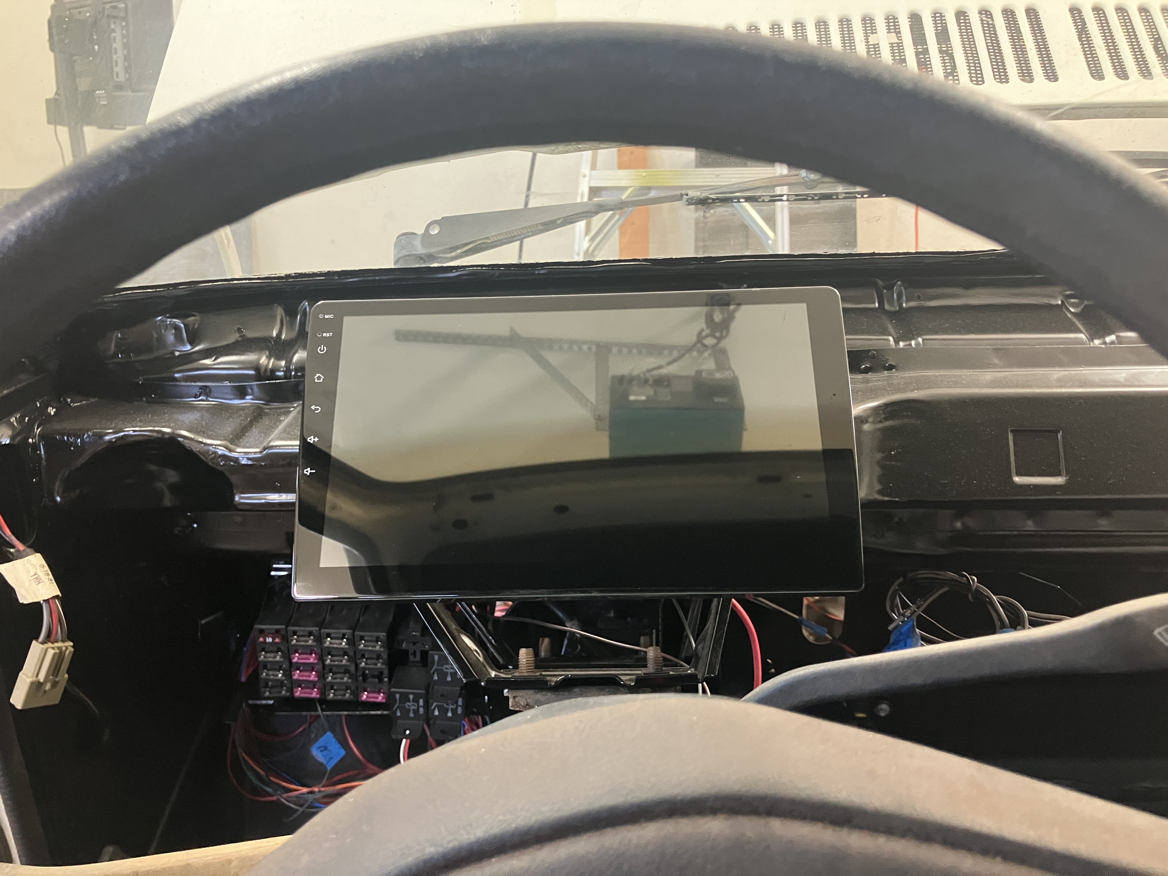

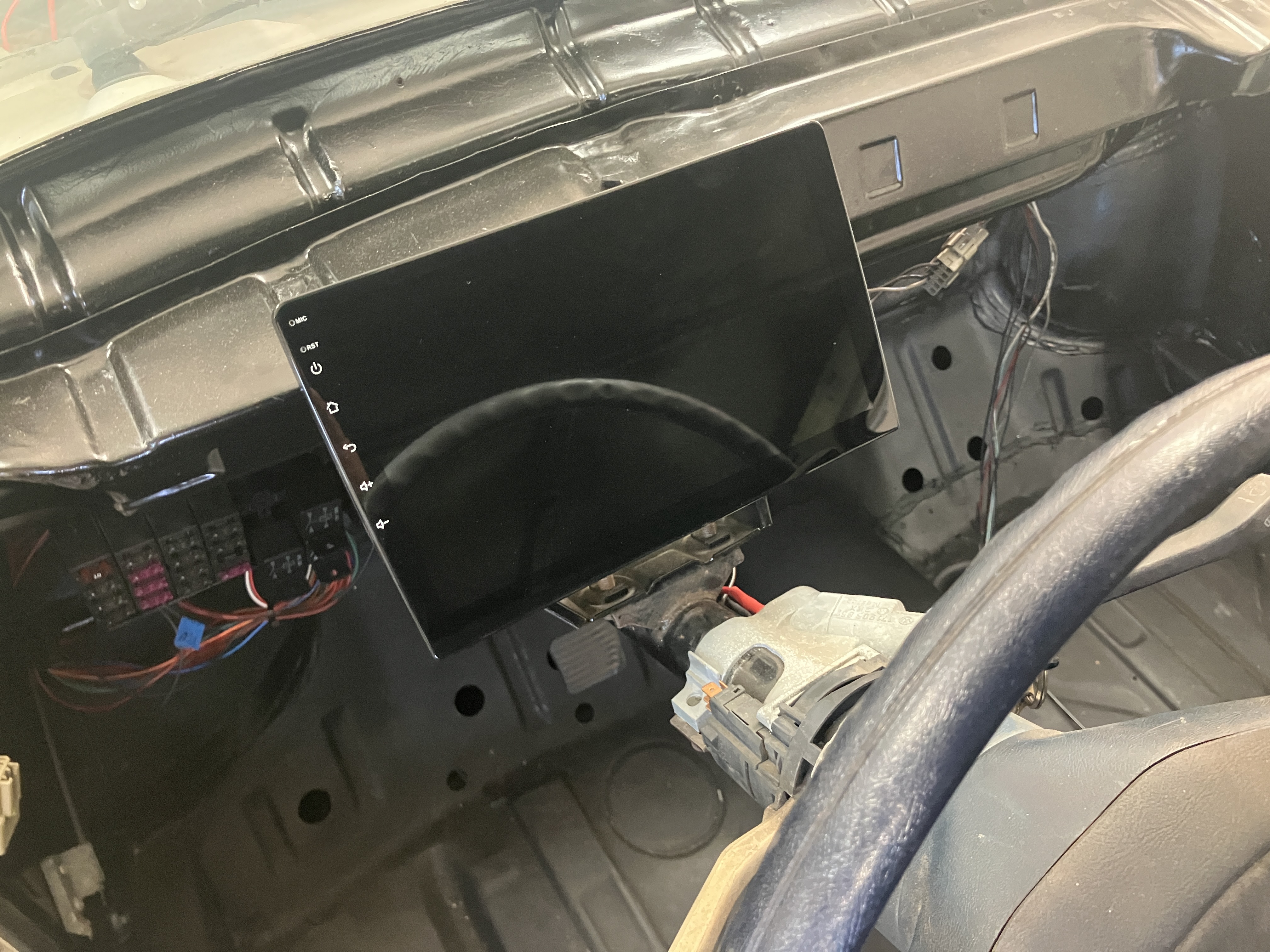

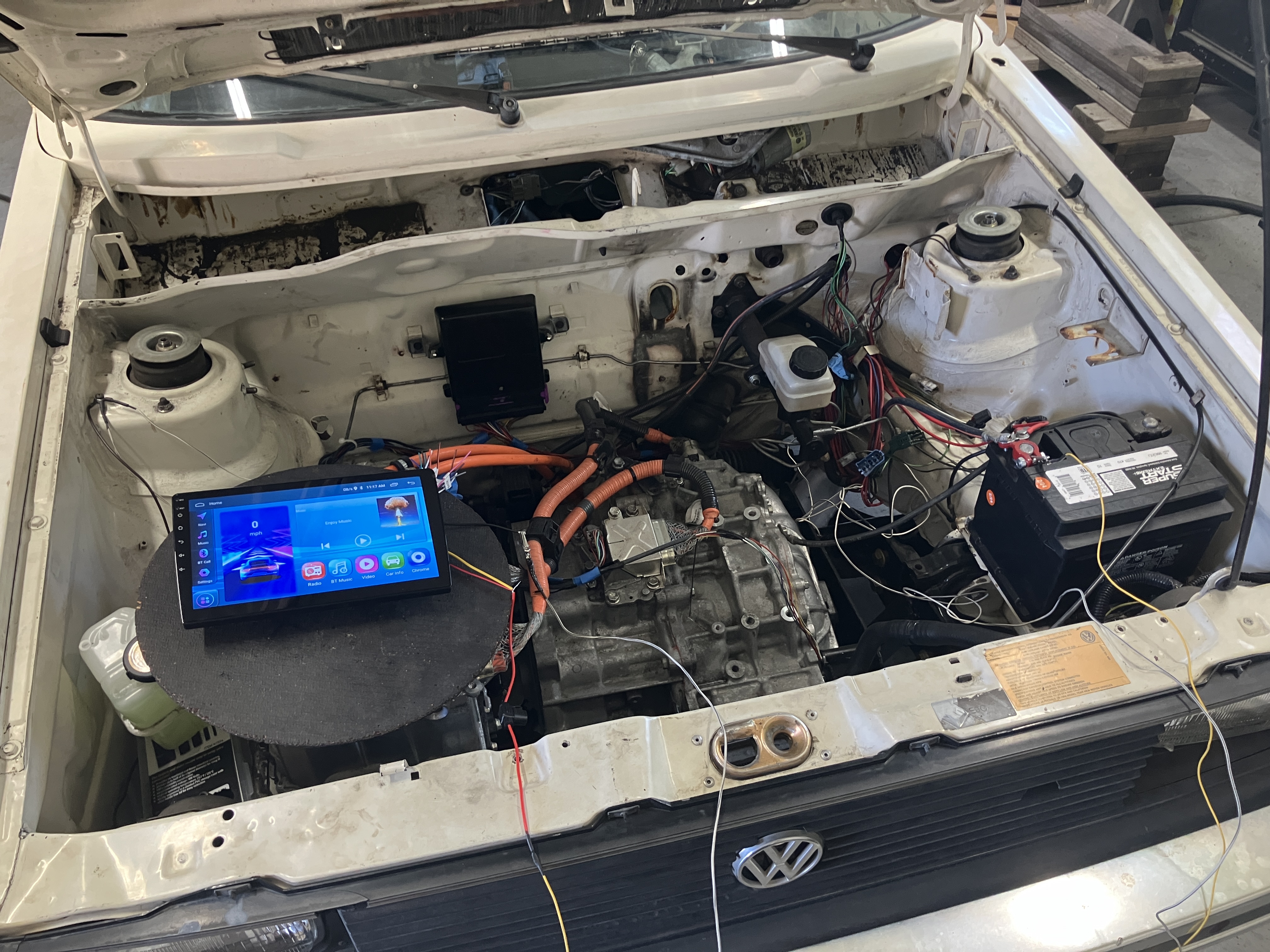

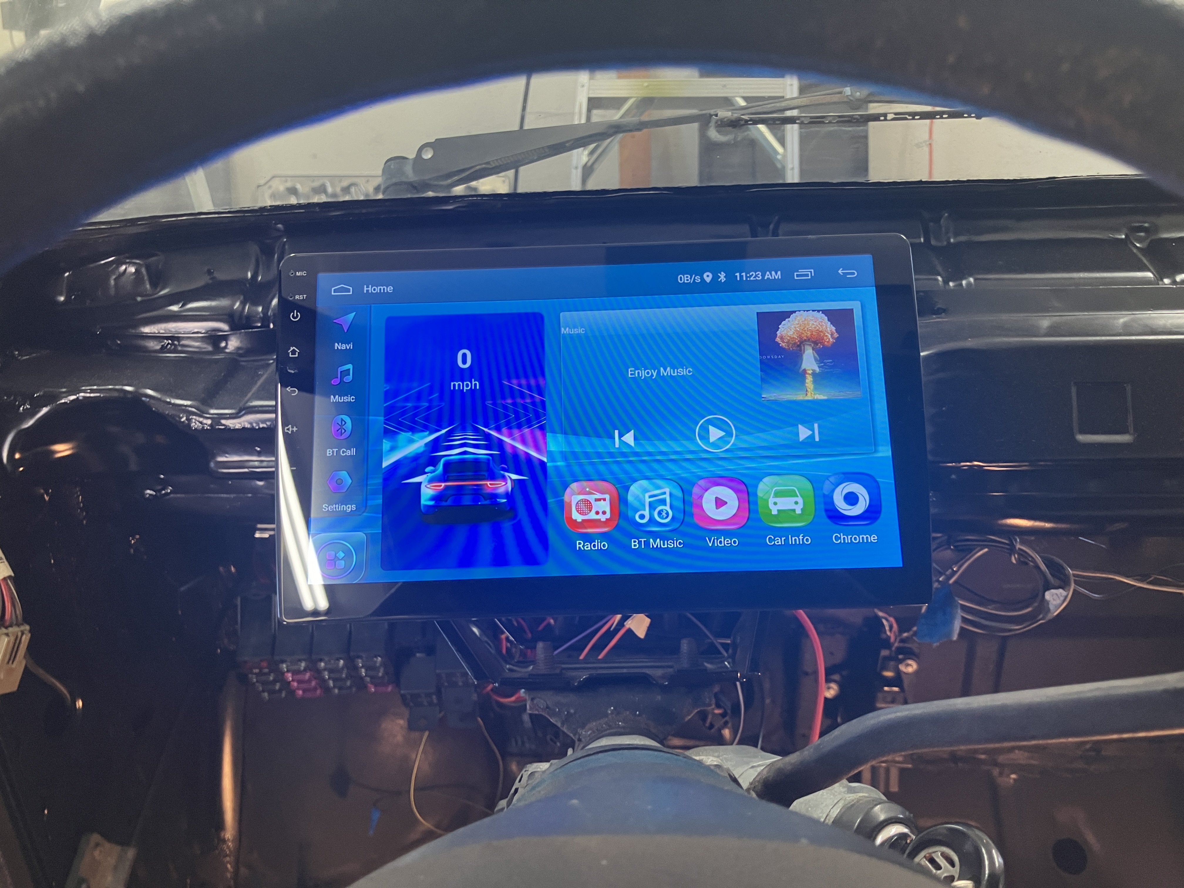

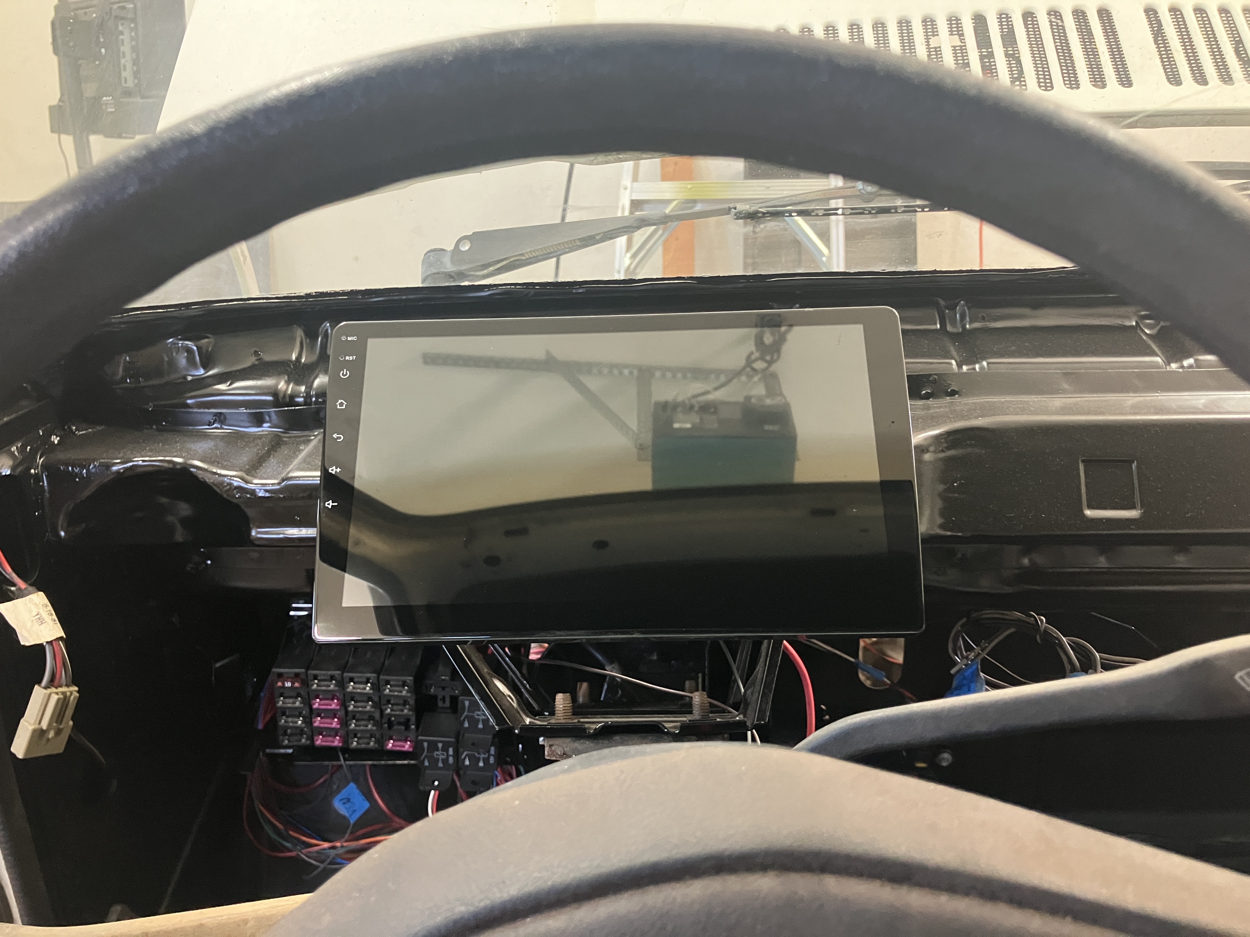

NATURALLY !!! It is 10" though and [ahem] yours was only 7
Hikity Android 11 Double Din 10.1 Inch Touch Screen Car Stereo
Hikity 10.1 Inch Android Car Stereo Double Din Wireless Apple Carplay, Android Auto GPS Radio Navigation for Car
  • WiFi
  • Bluetooth
  • FM Radio
  • Mirror Link
  • Mic
  • Backup Cam (2+32GB)
... so it's gotta be good!

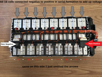

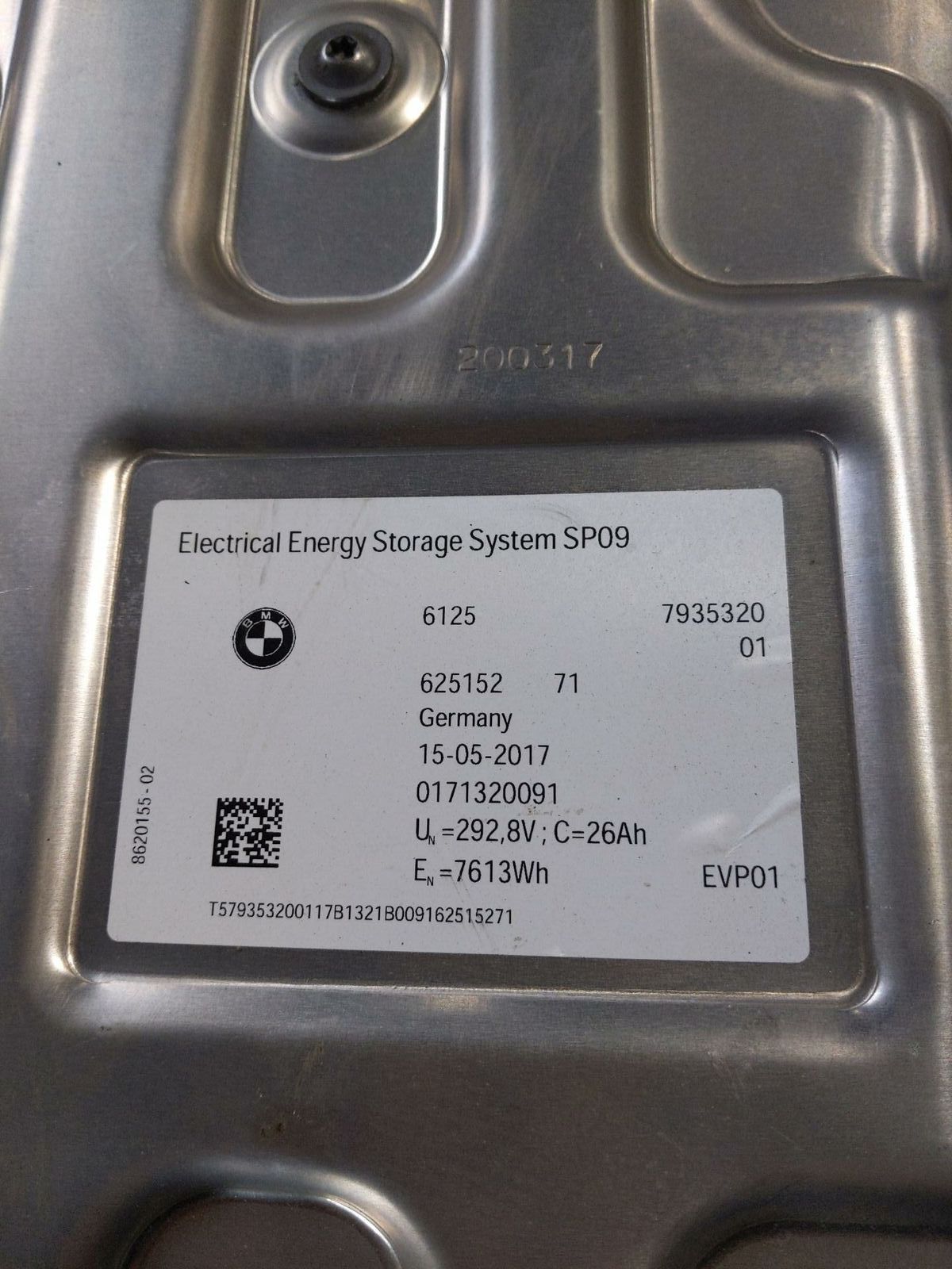

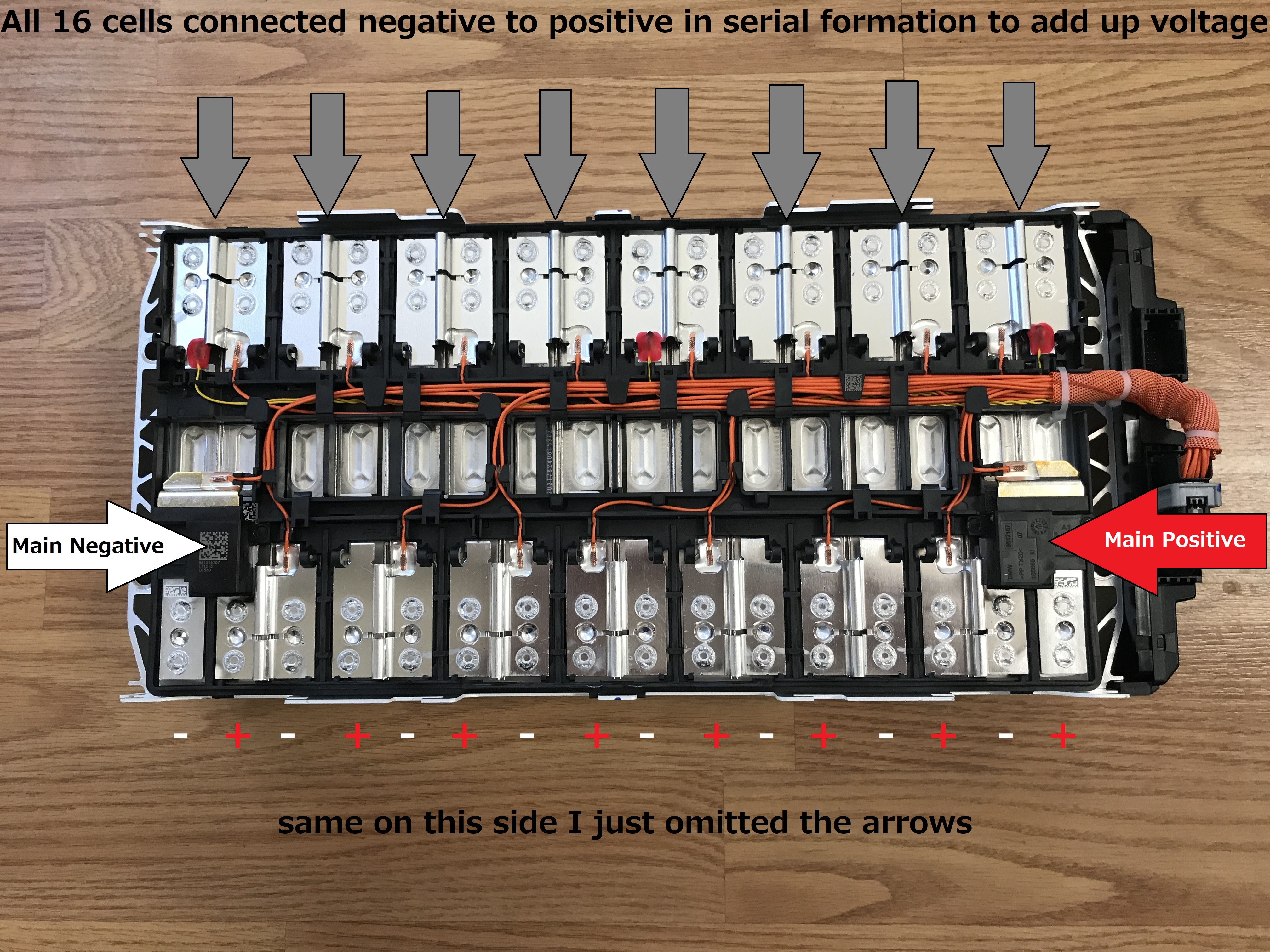

So let's talk charging so I can tell you what you already know
so I am getting braverer and braverer as I charge this dinky 2018 BMW 330e PHEV battery pack, which consists of 5 modules and 80 cells (16 cells per module)
DISCLOSURE: I happen to have some BMW 530e battery specs for the battery pack code name SP06 but I don't have any for the 330e so some maths were involved to come up with the table adaptation
PACK MODULECELL COMMENT
331v 66v 4.14v Max
327v 65v 4.08vMy Goal
320v 64v 4.00v Next Set Point
310v 62v 3.87v Current Charge Limit
300v 60v 3.75v 1st Charge
292v 58v 3.65v Nominal
224v 45v 2.80v Min
yes this would be more better with some more decimals, but I'm just spit ballin' here
below is one of the five modules with it's 16 cells holding hands nicely in a row

Just wondering about venting - obvious for prismatic, but how do pouches vent? Got 1/2 of the VW modules mounted upside down but they are pouches inside of the modules
after seconds upon seconds of research I bought the cheapest biggest touch screen display thingie with 90% of features I will never use
Woodfie
Posts: 242
Post by Woodfie »
Nice display work, Screen away......
