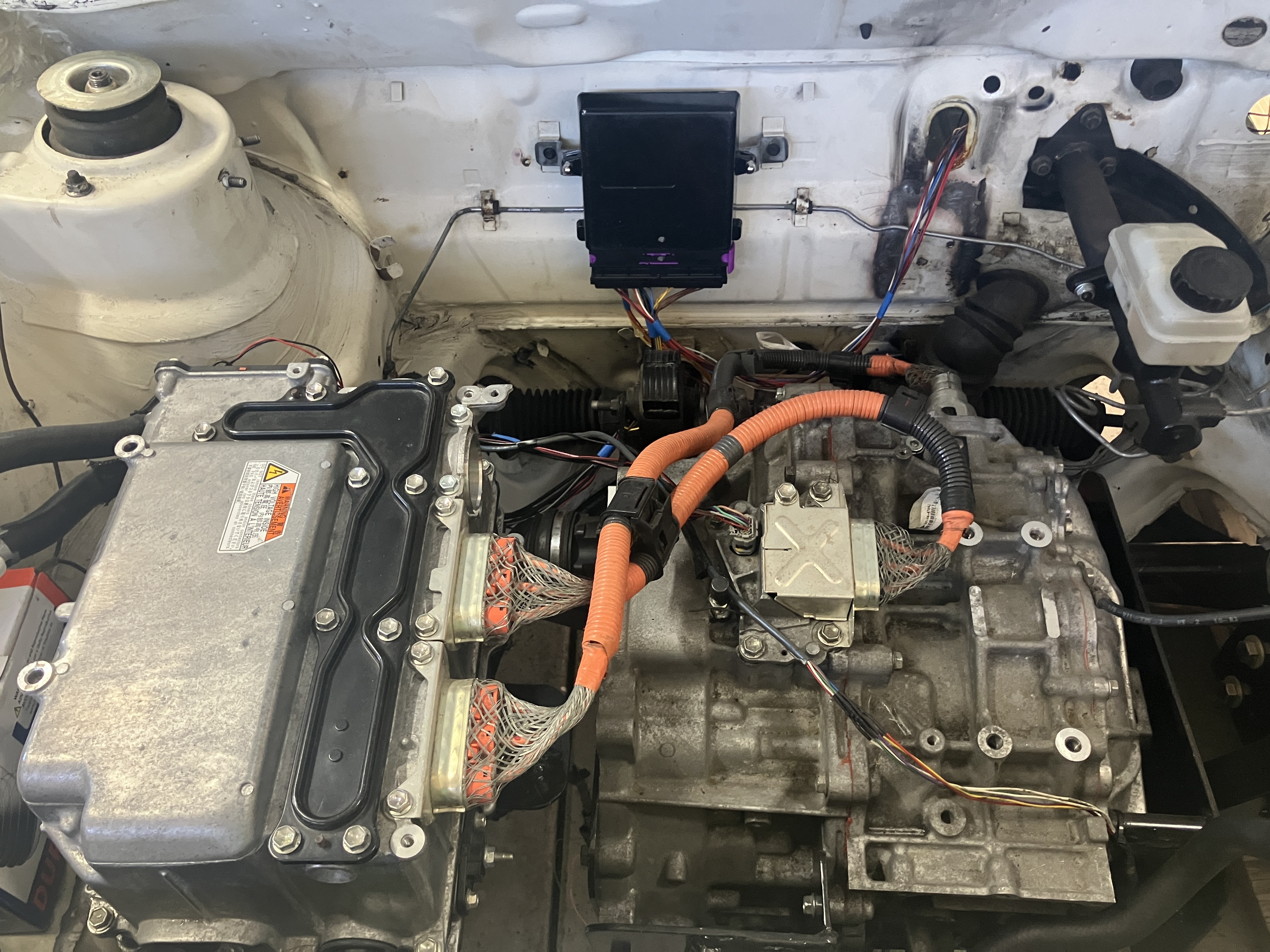

actual footage of me heading into the garage in this heat to tackle the low voltage wiring

it appears The Greg will end up using 30 of the 56 ZombieVerter pins
05 - Prius Water Pump PWM 3 used to control the speed of the pump
12 - Prius Transmission MG2 Temp -
13 - Prius Transmission MG2 Temp +
14 - Prius Transmission MG1 Temp -
15 - Steering Column Ignition T15 In
16 - Prius Inverter Control REQ-
17 - Prius Inverter Control REQ+
18 - Prius Inverter Control CLK-
19 - Prius Inverter Control CLK+
20 - Prius Inverter Control MTH-
21 - Prius Inverter Control MTH+
22 - Prius Inverter Control HTM-
23 - Prius Inverter Control HTM+
27 - BMW Safety Box CAN EXT Low
28 - BMW Safety Box CAN EXT High
29 - Prius Transmission MG1 Temp +
31 - Negative Contactor Low Side Switch used to turn on and off the Outlander charger
32 - Prius Inverter Power Low Side Switch used to turn of and off the Inverter via the Zombie
33 - Main Contactor Low Side Switch used to turn on and off the Outlander DC-DC to charge regular car battery
43 - Mitsubishi Outlander Charger CAN EXT 2 Low
44 - Mitsubishi Outlander Charger CAN EXT 2 High
45 - Honda Fit Throttle Ground
46 - Honda Fit Throttle Channel 2
47 - Honda Fit Throttle Channel 1
48 - Honda Fit Throttle +5v
52 - Steering Column Start position
53 - Toggle Switch Reverse Direction
54 - Toggle Switch Forward Direction
55 - Body Chassis Ground
56 - Car Battery via fuse Permanent +12 Volts (always on / on standby)
