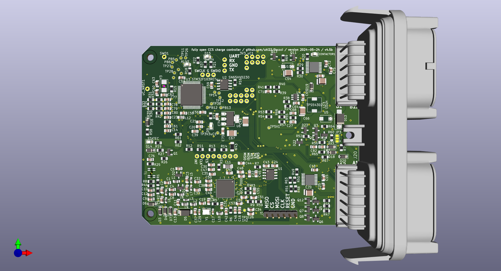

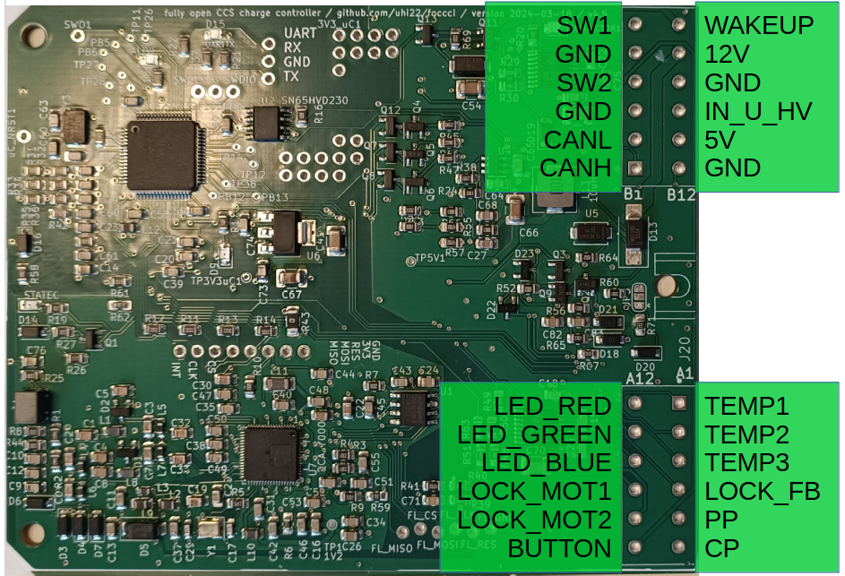

Finally got around to re-assigning the connector pins and made the flash SPI easier to access. Moved some components around to reflect the new placement also. I'm calling it 4.5b as it is electrically identical to 4.5. Didn't want to burn up another version resistor. Does that make sense?
Here is the new assignment I've "padded" the unused pins with GND. That way, both the contactors + and - lead can be inserted into the Deutsch connector
EDIT: now that I look at it I could swap 5V with GND so contactor pins can be adjacent.... DONE
https://github.com/jsphuebner/foccci/tr ... assignment

Can I just check: the FOCCCI wiki page shows the pinout of versions 4.5 and below, whereas the 4.5b version referred to in the quoted post is 'new' and not currently shown in the wiki page (as of today at least)?
A humble suggestion - going forward it would be useful to include a board version to pinout mapping, ideally in the wiki.
- Posts: 6969
- Has thanked: 455 times
- Been thanked: 1771 times
Re: Develop a QCA7000 board?
Added a new column with 4.5b mapping
Can you upload the png?
Thanks.
I was unable to add a new version of the board pinout image as it claimed the original version was an svg and the image from the post is a png, but I have added the 4.5b version as an additional image.
- Posts: 6969
Thanks, I think it is better to have both versions anyway
