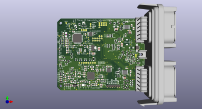

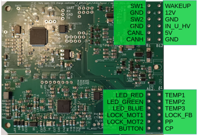

Finally got around to re-assigning the connector pins and made the flash SPI easier to access. Moved some components around to reflect the new placement also. I'm calling it 4.5b as it is electrically identical to 4.5. Didn't want to burn up another version resistor. Does that make sense?
Here is the new assignment I've "padded" the unused pins with GND. That way, both the contactors + and - lead can be inserted into the Deutsch connector
EDIT: now that I look at it I could swap 5V with GND so contactor pins can be adjacent.... DONE
https://github.com/jsphuebner/foccci/tr ... assignment

Re: Develop a QCA7000 board?
Right, I'm aware about these devices. Was thinking about getting one but they are still a bit pricy and if you look at comments from users who have bought them they aren't fully compatible. You rely on what they provide and have to wait for updates from the vendor.asavage wrote: ↑Thu May 23, 2024 8:03 pm As opposed to one of the off-the-shelf CCS->CHAdeMO adapters?
Believe this solution / project is a few steps further down the road and you have the freedom in getting fixing issues on your own or getting help much faster. Of course it requires to mod your car but given my one is more than 5 years old there is no warranty anymore.
Lastly it is more fun this way
Can I just check: the FOCCCI wiki page shows the pinout of versions 4.5 and below, whereas the 4.5b version referred to in the quoted post is 'new' and not currently shown in the wiki page (as of today at least)?
A humble suggestion - going forward it would be useful to include a board version to pinout mapping, ideally in the wiki.
- Posts: 6711
- Has thanked: 368 times
- Been thanked: 1541 times
Added a new column with 4.5b mapping
Can you upload the png?
Thanks.
I was unable to add a new version of the board pinout image as it claimed the original version was an svg and the image from the post is a png, but I have added the 4.5b version as an additional image.
- Posts: 6711
Thanks, I think it is better to have both versions anyway
