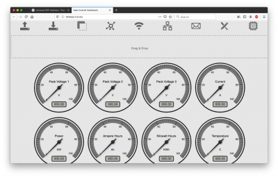

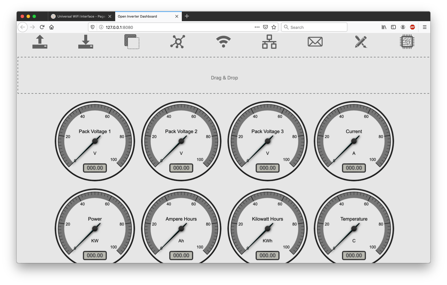

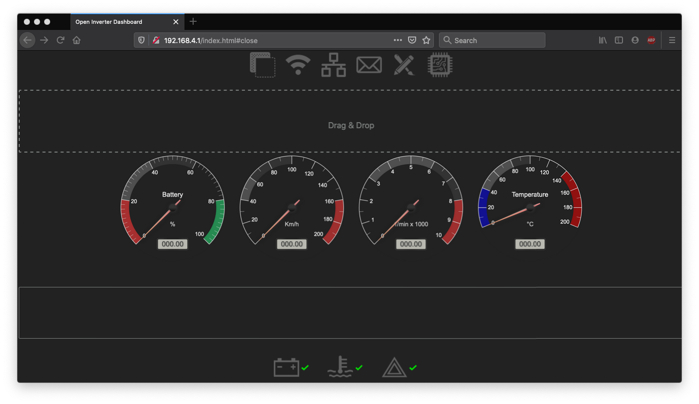

Out of pure excitement!!! I am going to build the First Beta.
As usual flashing with command-line:
esptool.py --port COM1 --baud 115200 write_flash 0x000000 flash-WeMos-D1.bin
esptool.py --port COM1 --baud 115200 write_flash 0x100000 flash-spiffs.bin
This is how back-side drag-drop interface looks like.

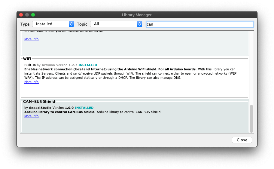

Bigpie wrote: Sat Feb 29, 2020 8:37 am Could you list the output of arduino-cli lib list?
Yes I must have used conflicting CAN libraries on the other computer, just comment out offending lines for now.
Name           Installed Available Location
RemoteDebug    3.0.5     -         user
WebSockets     2.1.4     -         user
CAN-BUS_Shield 1.0.0     -         user
AESLib         2.0.6     -         user

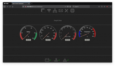

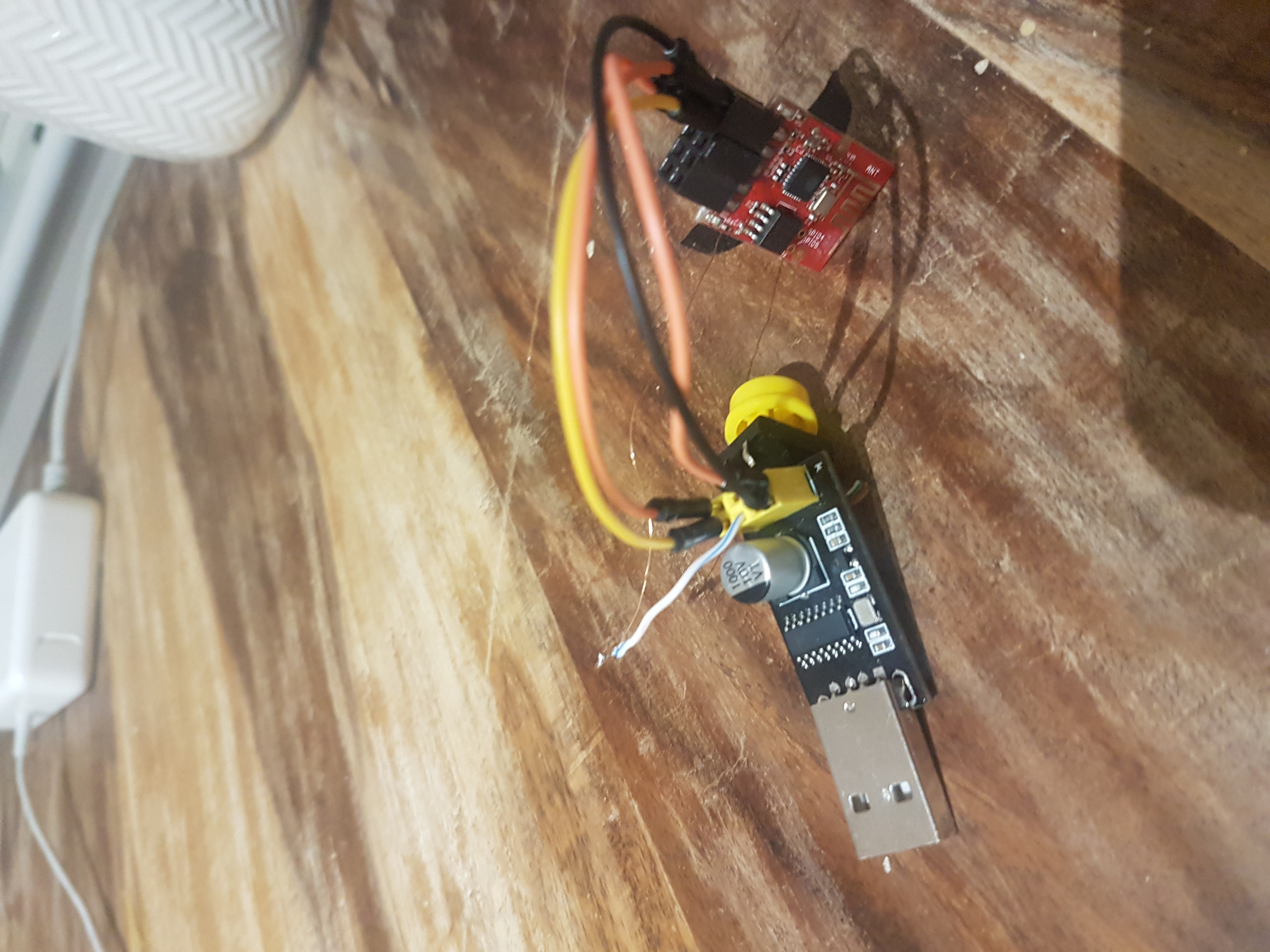

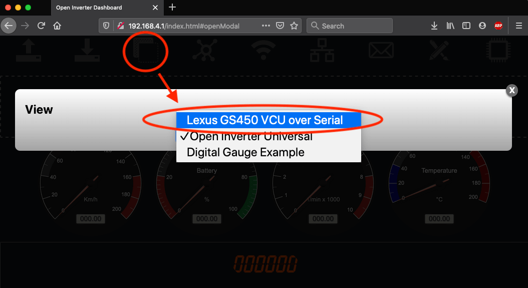

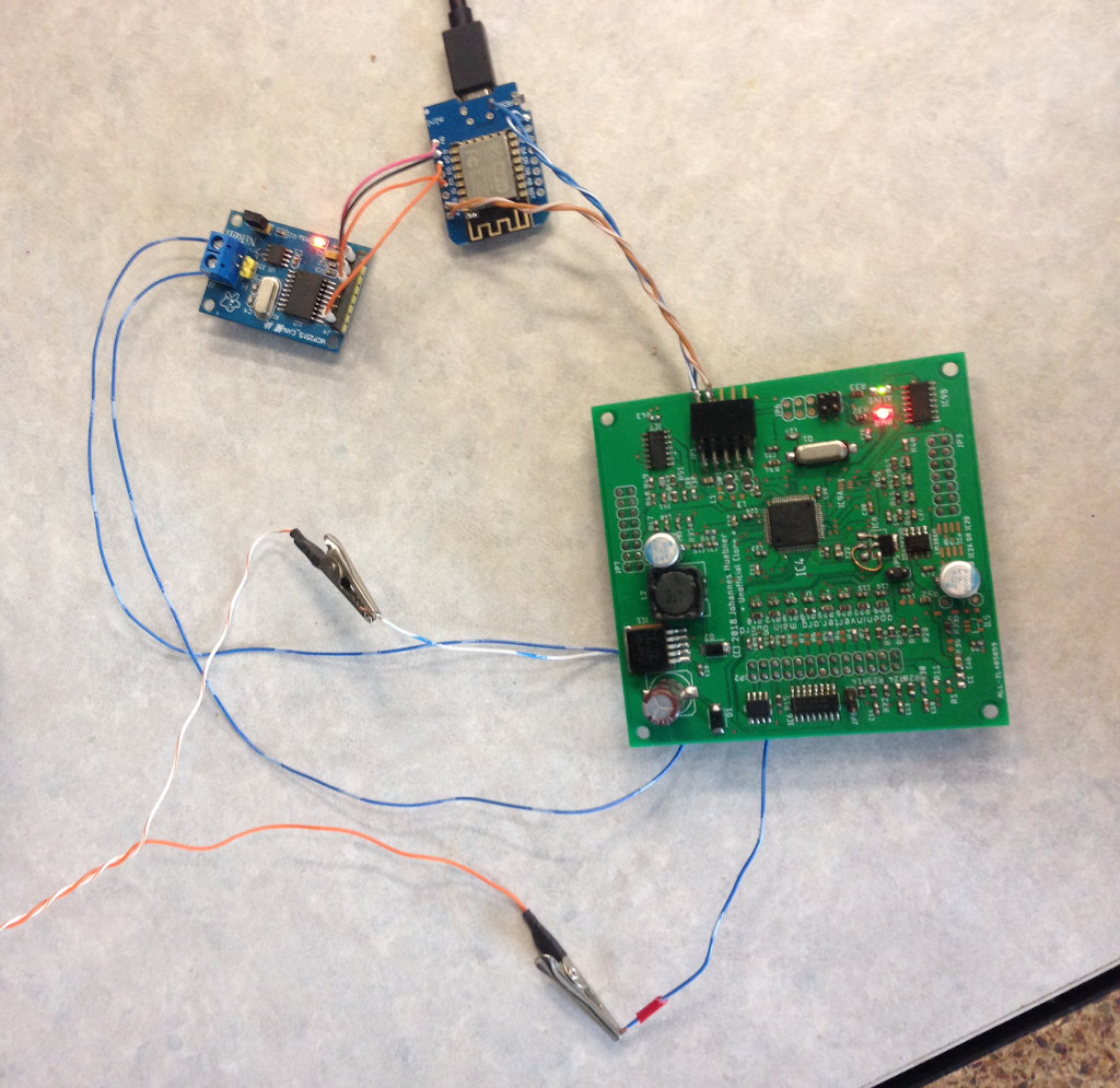

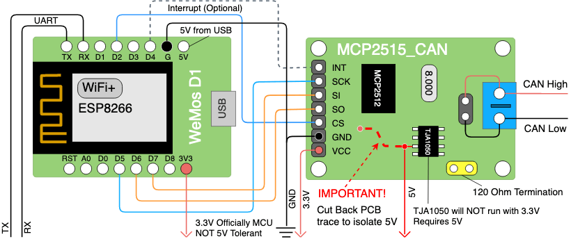

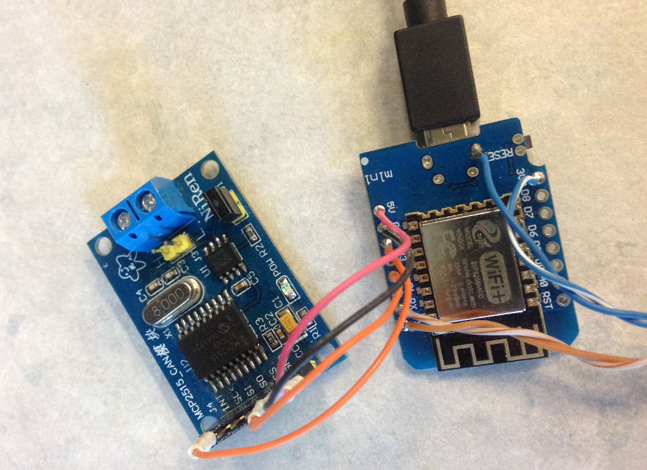

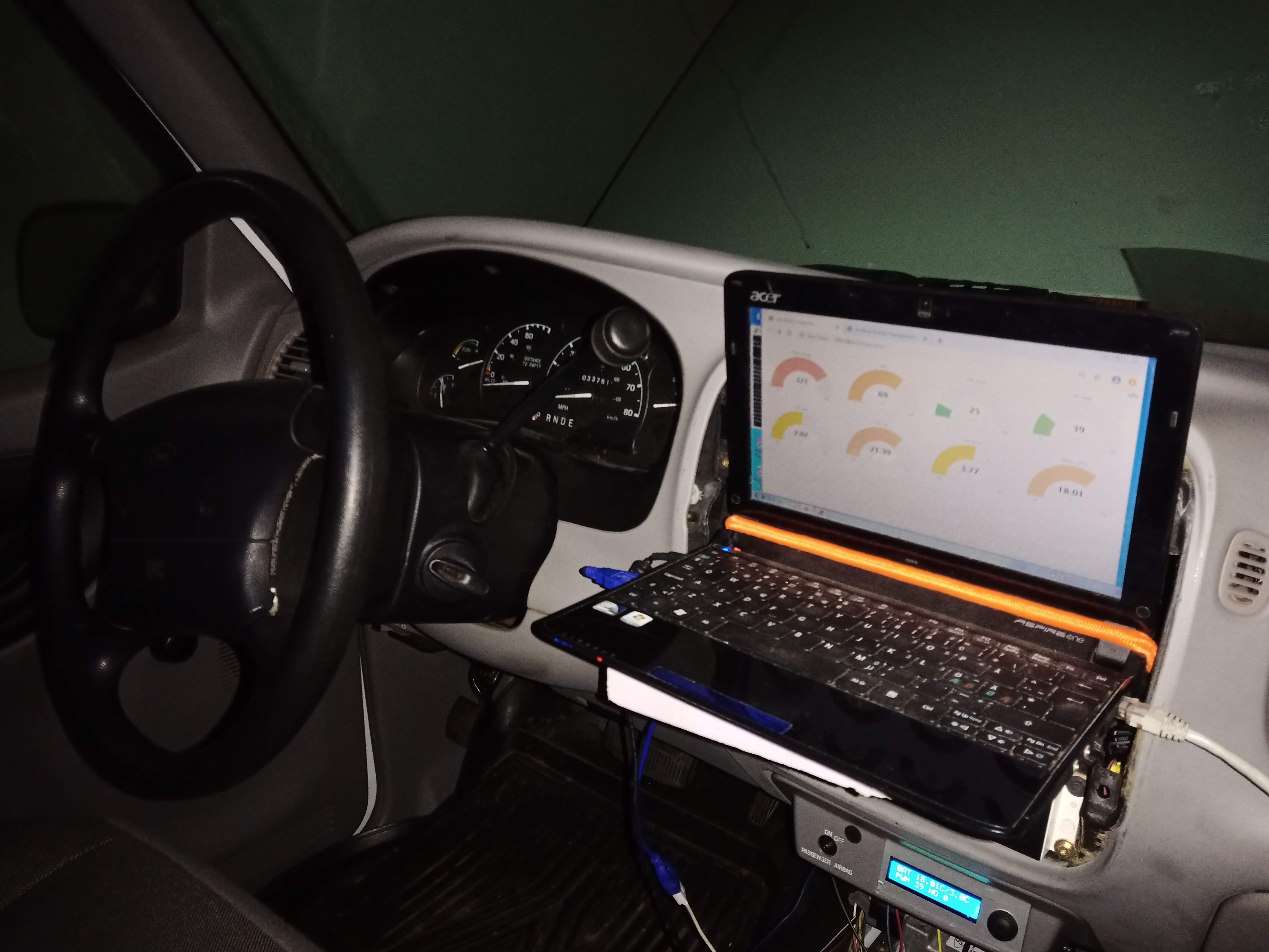

Ready for live test! ESP8266 binary here
Once loaded you will need to switch the view (default is Open Inverter).
Click the background, the view will flip, then select "View Menu" -> Lexus GH450
Turns out connecting ESP8266 to CAN is not easy, full SPI connection (Olimex not supported)
EDIT: Connect TJA1050 separately to external 5V, because TJA1050 can not run with 3V3.

Bigpie, setup in my truck. works very well.
I can now setup a gauge view of all modules.
Would be nice to have different pages for different modules in action.
Like Charge screen, Drive screen, battery diag and so on.
And have it switch to the right screen, when charger is 'conencted' or truck is in 'run' mode.
Would suggest to have some kind input possibilities, like buttons with configurable commands?
The inverter already have the option to be configured via CANbus.
This is my temporary setup, will have a phone or pad in the place of the 2-din stereo.
