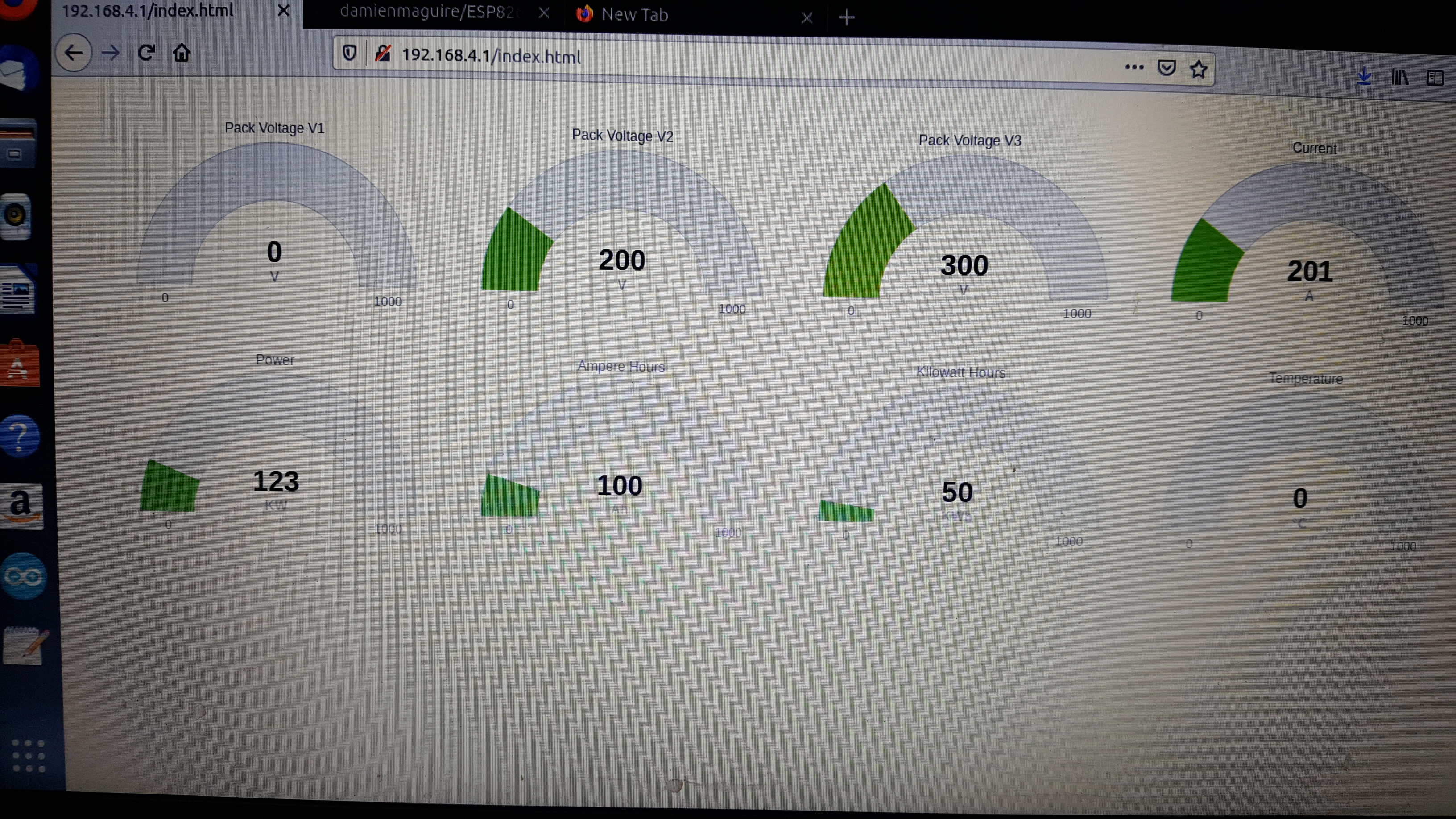

So with most of the projects carrying the necessary hardware for the Olimex Wifi module (including new Chademo controller and V5 Tesla charger boards) , I wanted to design a simple and easy to modify wifi interface. As my web programming skills went out of date around 1998 I've been working with a freelance developer. First release now up on Github :
https://github.com/damienmaguire/ESP8266-WiFi-Interface
There are two versions. One updates each gauge individually and one updates them all at once. There is a nice little demo video on the repo. Expect more updates soon and I'll be adding wifi to various projects as we get things debugged.

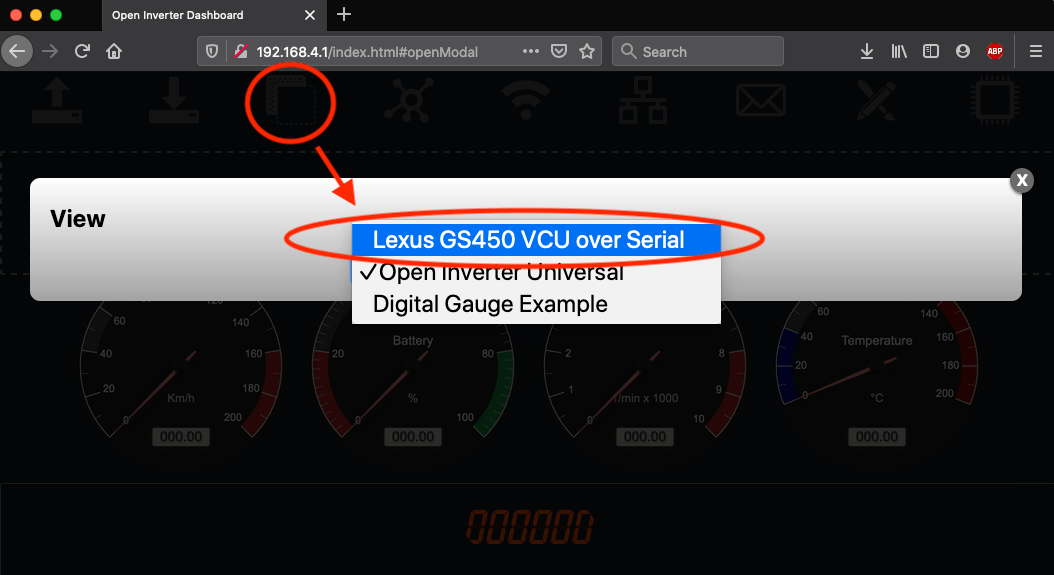

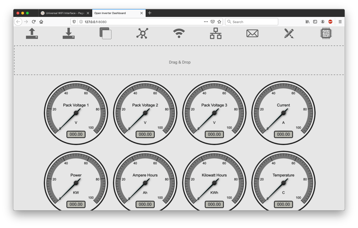

Stick some of the features you are looking for up as issues on github and I'll pick some up. Web programming is my bread and butter these days.
Any reason you're maintaining 2 versions? I would combine.
I've started making changes to my fork for the gauges to be loaded from a config file.

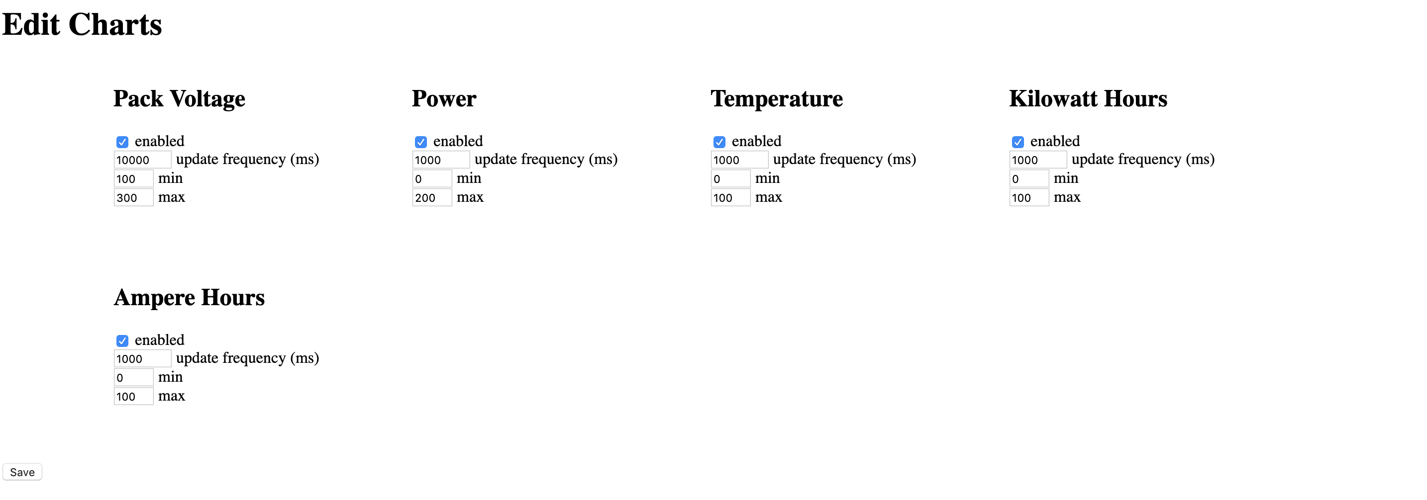

I've added and edit page, I'll create a PR once my ESP8266 arrives and I've tested it. Only using my mock at the minute.

My first suggestions: It would be nice if you could edit the names and units of the gauges in the config page.
Then they can be used for anything......... Like SOC, very useful in a electric car :)

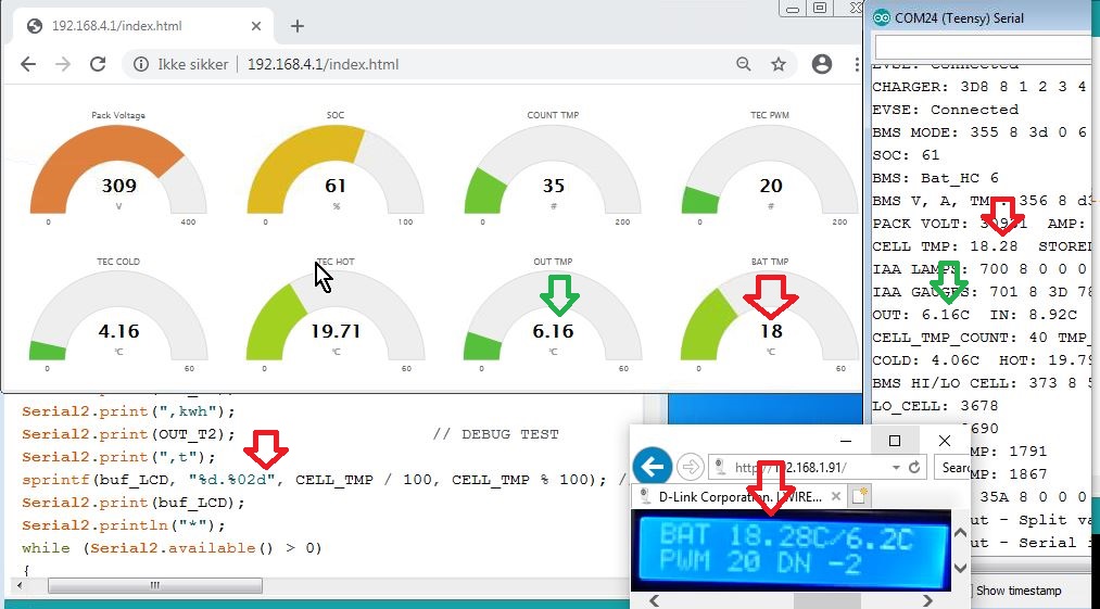

Can someone help me with my decimal problem??
This is just a "for fun" project, not very important.... ;)
I get right number of decimals on serial console LCD and web "green arrow"
But on BAT TEMP I get no decimals in web, but right in serial console and LCD "red arrow"
SERIAL2 is where the ESP is connected.

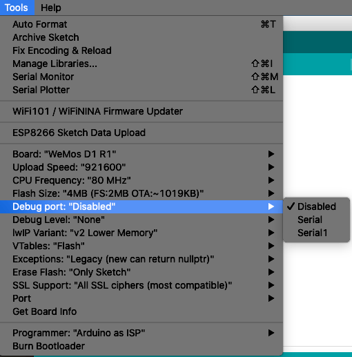

I'm not able to get any serial data out after "SDK:2.2.1(cfd48f3)/Core:2.5.2=20502000/lwIP⸮" on my MOD-WIFI-ESP8266 any suggestions?
It's serving up my files from SPIFFs and returning data from my new endpoint, but struggling to debug without the Serial IO
dima
Posts: 157
Re: Universal WiFi Interface
Post by dima »
Arduino "Debug" serial interferes with the real serial ....therefore you cannot use serial to debug. Make a dynamic web page instead.
