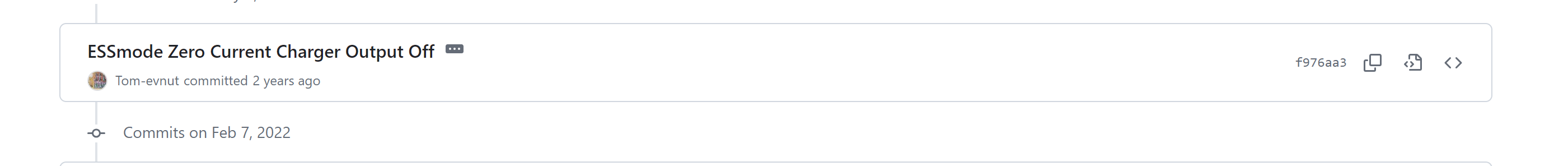

Post by alexbeatle »
tom91 wrote: Sun May 26, 2024 10:28 pm Wait you change to which version and the Tesla comms are stable? That is not really logical as the base level software for the comms has not changed since the start.
Doesn't make sense to me either. I looked through the commits too.
Here's a short video of BMS running on Feb2022 commit, ISA shunt CAN comms no value spikes:
Here's the latest commit, ISA shunt CAN comms has value spikes...
Later on the newest commit lost comms to the batteries and went into error, while the Feb2022 no error - waited way longer than that.

Please give me the exact firmware number you are using. I have not heard of this issue from anyone else so this sounds quite like a specific problem to you and your setup. You are using the provided .hex to flash the firmware right?
tom91 wrote: Mon May 27, 2024 10:22 am Please give me the exact firmware number you are using. I have not heard of this issue from anyone else so this sounds quite like a specific problem to you and your setup. You are using the provided .hex to flash the firmware right?
This hex gives me issues...
https://github.com/Tom-evnut/TeslaBMSV2 ... ENSY32.hex
Also compiled .ino, but same problem...
https://github.com/Tom-evnut/TeslaBMSV2 ... aBMSV2.ino
This hex works for me..
Thank you for you help.
