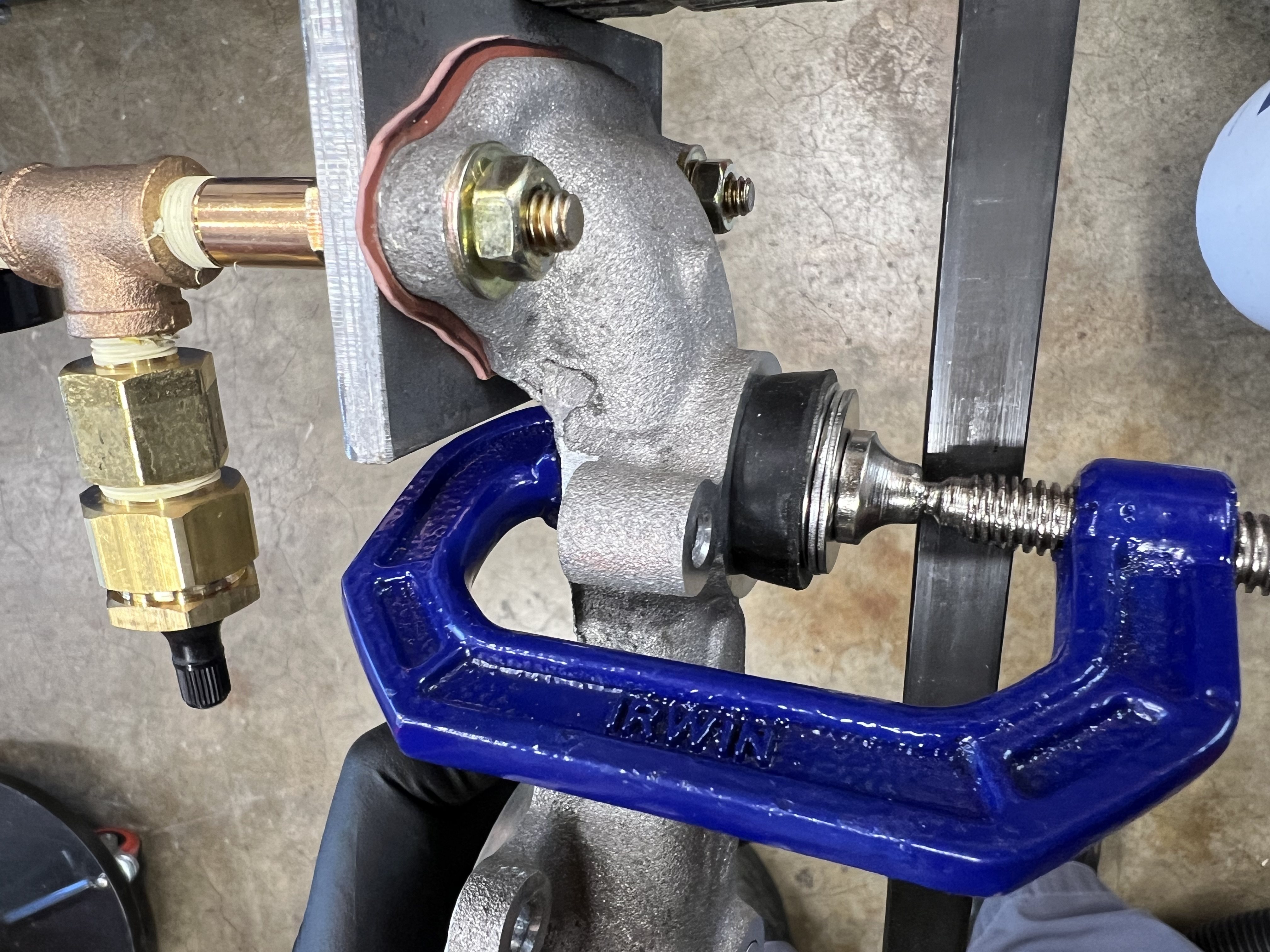

Bit of crossposting: coolant manifold plug of 6061:

Lots of places do machining. I got one easy quote from one place, got a ballpark figure, and I'm not interested in chasing lower prices or lower minimum quantities. I'm retired and don't need the hassle of retail sales again. I already "sell" pre-assembled ethernet cables for the Tesla Powertrain Diagnostics program used in the RAV4 EV, and that's been hassle enough. Plus the inevitable people who receive something and then don't like it/claim it doesn't fit/claim it ruined their LDU/etc. Not gonna be me.
You know what? I don't care. I am active in three communities around the LDU, and I'm only going to post this info once; it took HOURS -- almost two man-days -- to put the pics and descriptions together, and if someone can't be bothered to run down the pics, I just don't care anymore. Don't want to create an account? I get that. Go do your own measurements on your own LDU and make your own mistakes.
I can't make information barrierless for everyone.
It doesn't matter if I posted on Instagram, X, TikTok, or FB, somebody would complain that "it's too hard" to find the info. I wrote an entire G'damn Wiki on the Tesla GEN1 OBC and still had complaints about this, that, and that other thing. If I put it on YT, I'd get compaints. If I offered to mail detailed specs via snail mail, I'd get complaints. Github? Complaints -- got one just last week from there.
And then there's the people on phones who complain that the pictures are too large and their phone won't render them properly. I've run a hobby website forum for DECADES and have heard it all before, and I'm done trying to accommodate every last person's issue with FREE content.
I spent $50 on Toytota online subscritions and an entire Labor Day weekend a couple of years ago, pulling service content for the RAV4 EV, collected as much as I could and put it in a ZIP file . . . and got complaints that it was "too hard to find things".
In the past, I tried to maintain info in multiple locations, and it just multiplies the work. If you miss an update on one site, you field questions/corrections well into the future, and you just can't maintain multiple data stores. It has to be one place, I chose my one place (the RAV EV is the community I'm most active in), and it'll have to do.
Yup, could be done with an o-ring seal instead of Loctite 640 . . . but I discarded that idea fairly early on a year ago. A mechanical retainer would be required, as you noted. And there's no need to ever remove the plug for any reason, so why bother with installing a failure point (o-ring)? Gluing and pressing it in is adequate and has no downsides over an o-ring seal.

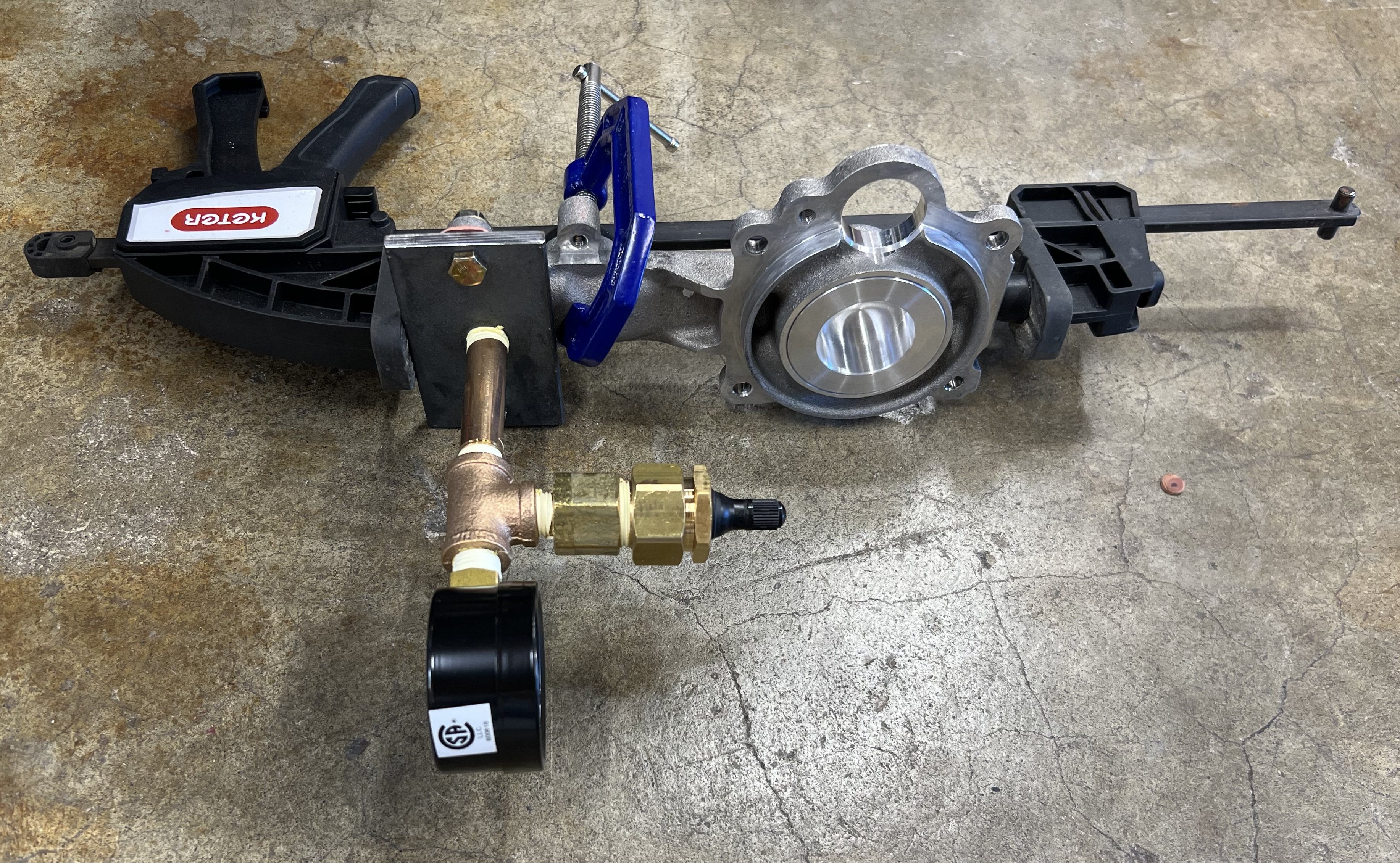

The second plug, .005" oversize + Loctite 640, passed 30 PSI for two hours with no leakage. 30 PSI pressure differential is at least ten times what that plug should ever see, so I was satisfied with the result.

That's not mine, though roughly the right idea. Some of us batted around several sets of dimensions. You'll notice that there's no counterbore dimension on that drawing, and it's 2mm too shallow IMO. And I wouldn't normally specify outside radii such as that; from an engineering standpoint, I prefer chamfers on outside 90° edges, and radiused corners on inside ones.
This is the drawing I handed to my lathe man. mm in blue ink, inches in pencil. Scale is correct.
I believe that the SS formed sheet metal plugs coming are 55.2mm (.008" OS) and are designed to deform & crush into place, similar to a seal cage. I am skeptical that that much interference fit is needed/desired in a more-solid 6061 plug, so I started with .003" OS, and while that would have worked fine, I liked the fit of .005" OS better. I have a "feel" for this, but while I worked in a mechanical engineering department with real engineers, I'm not one myself, and am more of a cut-and-try man when it comes to this kind of thing.
Also, the lathe man agreed that .003" would be "enough", so I let him convince me And, with the lightly pressurized system in the LDU, and an appropriate sleeve/bearing mounting compound, it would be.

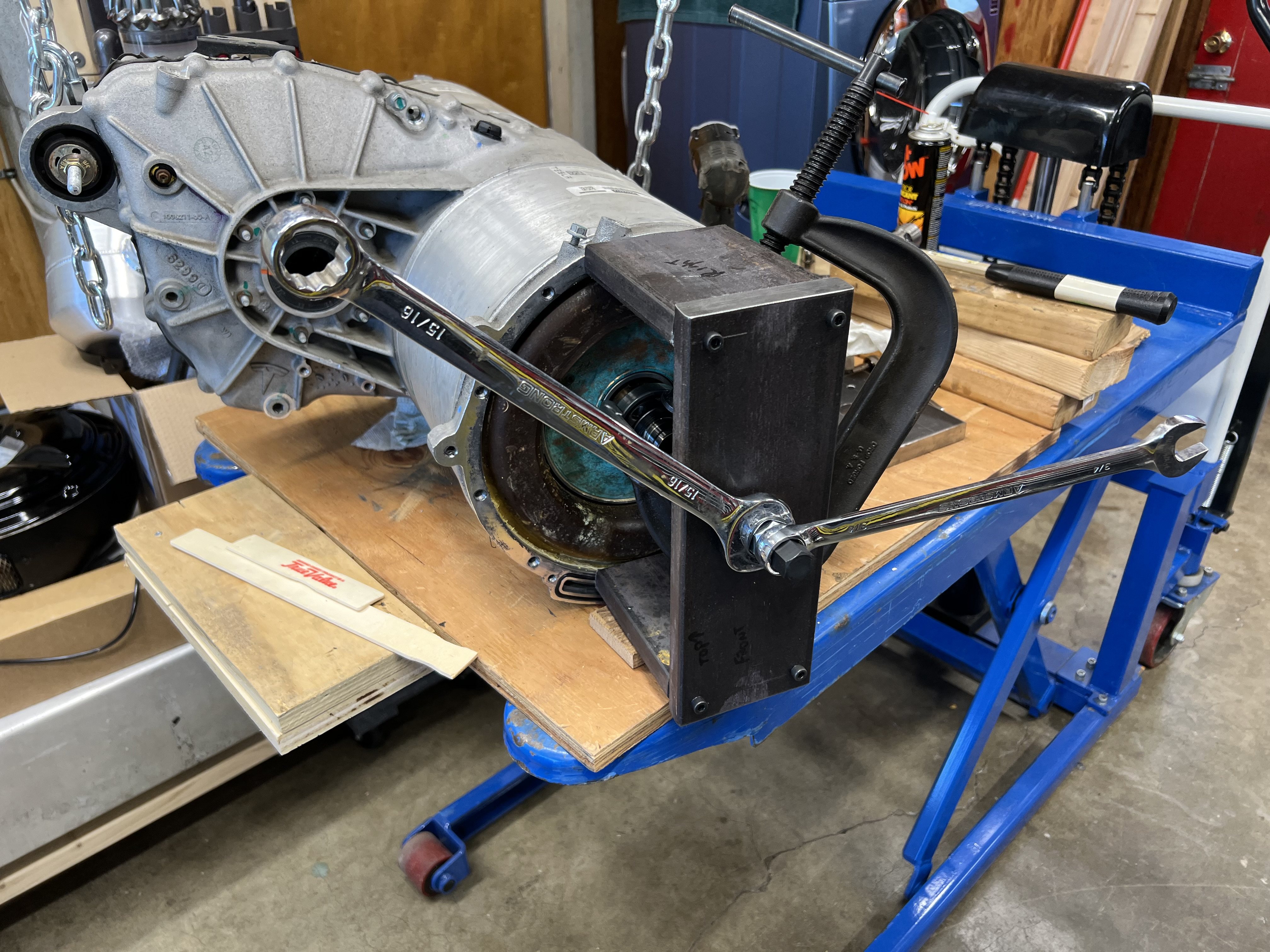

Removing the rotor wasn't a walk in the park for my recent LDU repair; I fabricated a fixture setup to allow enough pulling force to remove the rotor with the inside bearing remaining in the case.
It wasn't simple or easy, but other than replacing the inside rotor brg., it allowed me access to as much of the stator as is possible. I was able to use a water-based cleaner and surfactant to remove all the coolant and corrosion byproducts from the exposed stator laminations, "wash" the exposed surfaces, blow warm air on the stator for a day, then douse everything I could with IPA (99%! not 70%!) to further dilute any remaining water that stubbornly wouldn't evaporate.
