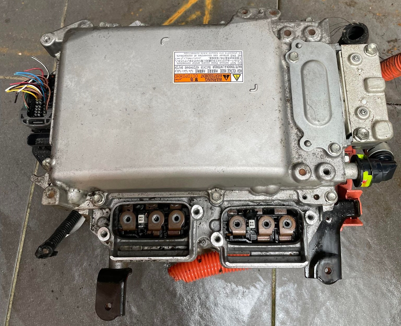

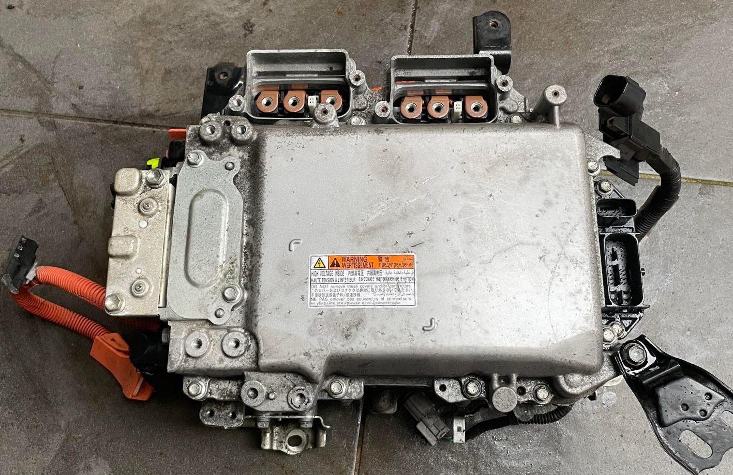

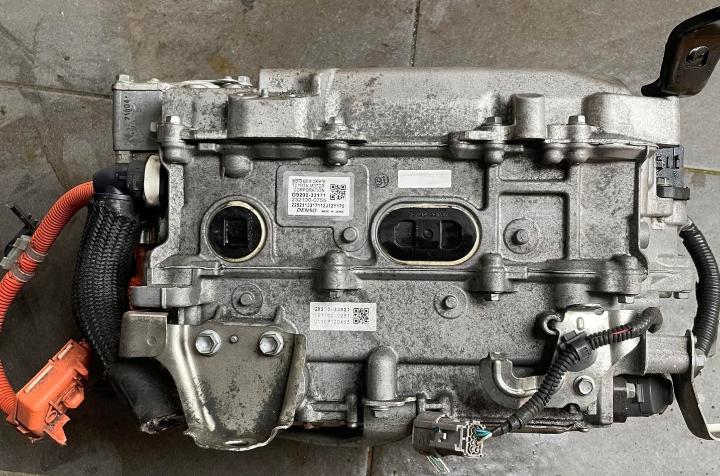

Here are photos of 2 candidate inverters (both from Toyota Camry Hybrids - AVV50, with P314 Trans). According to the only identifier I can make out, the part numbers are both G9200-33171.
Using the VIN for an Australian Camry - 6T1BD3FK30X142521 - the website https://japancars.ru/index.php?route=ca ... lk_id=8431 shows:
- Reference number - G9200
- vendor code - G92A0-33021
- Description - INVERTER ASSY, W/CONVERTER
- Release period - 11.2013 - 04.2015
- Note - AVV50
The thot plickens!
