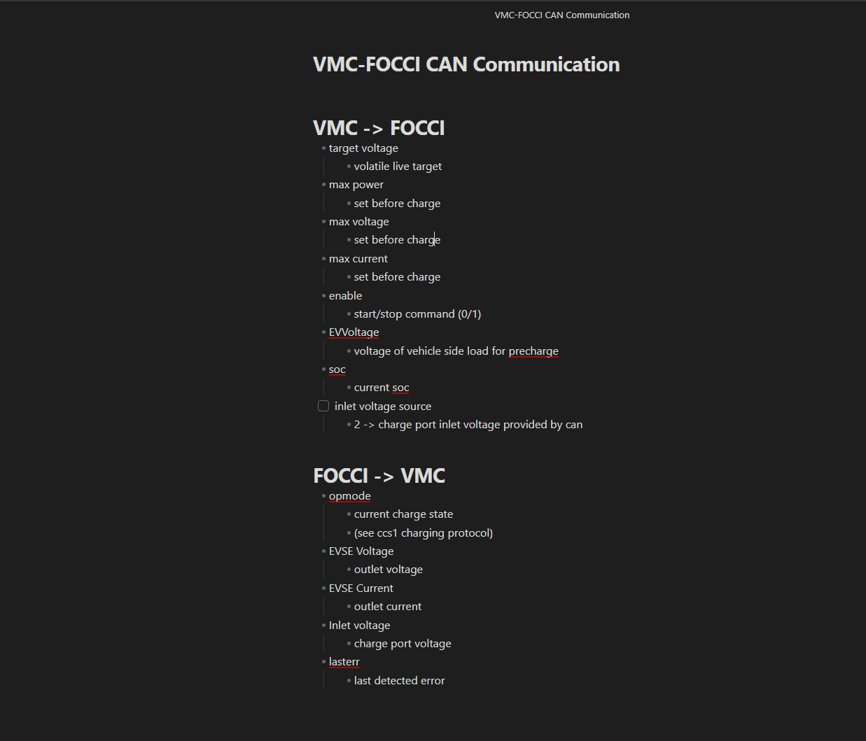

Hi All, I've mentioned in some prev postings but I am currently trying to implement DC CCS1 charging into a larger project and had this task mostly thrust upon me. I have a FOCCI board as well as the ESP32 interface and have finalized the plans to implement it all. I would be very grateful if someone could look over the below images and descriptions and let me know if they seem some errors/problems.
High-level Schematic: I do not yet have any thermistors connected but have plans to do so in the future along with a Bender AGH420 leak detection system.
Communication between Vehicle Management Computer (VMC) and FOCCI: I am not sure if there is any information I am missing but so far, this is what I have. The vehicle-side communication is done by a python can interface that will continuously send the can messages on the bus and read from FOCCI.
- [ ] ISSUE #1

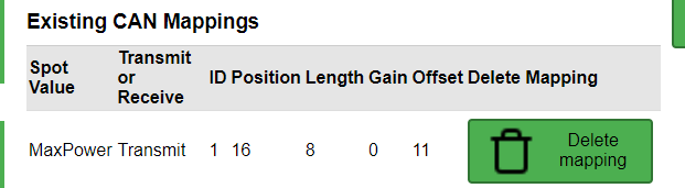

I attempted to configure FOCCI to send the max power parameter over can and while it did send a message with the correct id, there was no data in the message other than an arbitrary offset (added to see if the message was truly empty). I simply powered up FOCCI and the esp32 interface board and attempted to read these data values and had the above issue. This is quite a large post so apologies in advance if this is too much for such a forum. I have some limited experience in this area but not with projects like this so again, apologies if this is quite a "newb" post. Had this project thrust on me so I'll take any help I can get. These forums have been a very friendly place so thanks to those who have already assisted.
EDIT: One last question, I've been trying to send messages from the PCAN interface connected to my PC to FOCCI but haven't been able to verify that it's receiving these messages and the data inside them. Outside of my CAN mapping being incorrect, how could I test this? I would prefer to verify all aspects before attempting charging but I'm slowly running low on time.

Re: First-Time Config of FOCCI And CCS1 vehicle charging
Gain=0 and x*0 is 0
In the diagram it looks like you're feeding 5V to Foccci? This is not necessary
The CCR might be redundant as the driver chips are quite strong, lets say 5A total contactor current (limited by reverse protection diode)
"1) Set MAX params, inlet voltage src, target, etc... before connection to charger"
--> The max parameters and inlet voltage source are "parameters", in the sense that you configure them once when you build everything together, you save them into flash, and there they will be the complete car life. No need to write them each charging session.
"2) On begin sending SOC and EV side voltage to FOCCI as well as target voltage over CAN from the EV"
--> Not only on begin. Send the SOC always. It is only used to show it in the chargers screen, not really important but nice.
The BatteryVoltage needs to be send before connecting to the charger, yes.
The TargetVoltage can be a fix value which is the max battery voltage for 100% SOC. The charge current can start at a low value (1A) and increase slowly to a value what ever the BMS is allowing. Or use a fix 5 or 10A for the first tests.
"4) Set enable to 1"
--> No. The enable should be 1 from the beginning. Connect to charger afterwards.
For stopping the session, you can set enable=0, yes. Or press the button for 1s, or end the session on the charger. The Foccci will end the session, including waiting for voltage ramp down and connector unlocking. Afterwards you can pull the plug.
For the testing without much risk, just use your intended setup, but instead of the battery, connect a light bulb. Make sure that the BatteryVoltage and the TargetVoltage is matching the allowed voltage of the bulb.
If you want to skip the CAN communication part for the beginning, set the DemoControl to STANDALONE and the DemoVoltage to e.g. 230V. Connect a bulb instead of your battery to the contactors. And then just plug in.
When you change your battery, yes. And most likely you will not "send" them, you use the web interface (or command line tool) to configure them and write them into flash, so they will be there "forever".
Foccci/Clara will do not ramping. It is just forwarding the values to the charger. The charger may apply a current ramping, but this is depends on the charger type. I have no experience of the case that the vehicle requests "full" current from the beginning, maybe this also works fine. My Hyundai is ramping up approx 1A per 30ms. To be discussed, whether a ramping inside Foccci/Clara should be implemented.
No, neigther Foccci nor the charger will shutdown if the TargetVoltage is reached. The charger just will provide this constant voltage then. Usually, in this constant-voltage-mode at the last percents of the charge, the battery current will decrease, but this can last nearly infinitely. It is up to the user, to terminate. Either by pressing the stop button on the charger, or the button on Foccci, or sending enable=0 via CAN based on a certain SOC or a certain minimum current reached.
In best case prepare a serial-to-usb converter to record the logging messages. This helps a lot for trouble shooting, or to just confirm that everything is fine
Edit: And as Johannes already wrote: Do not apply 5V to the Foccci. The only supply is the 12V (9 to 24 is fine). The 5V is an output to feed the voltage sense board.

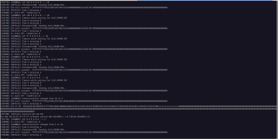

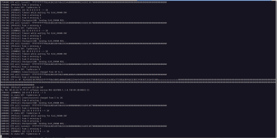

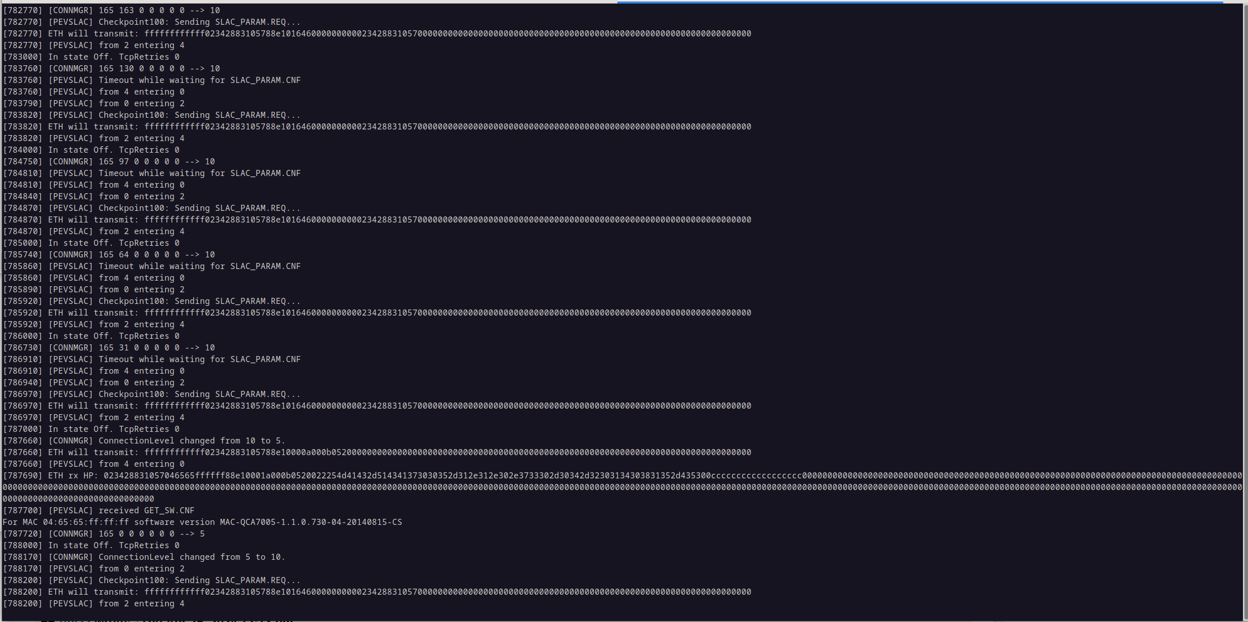

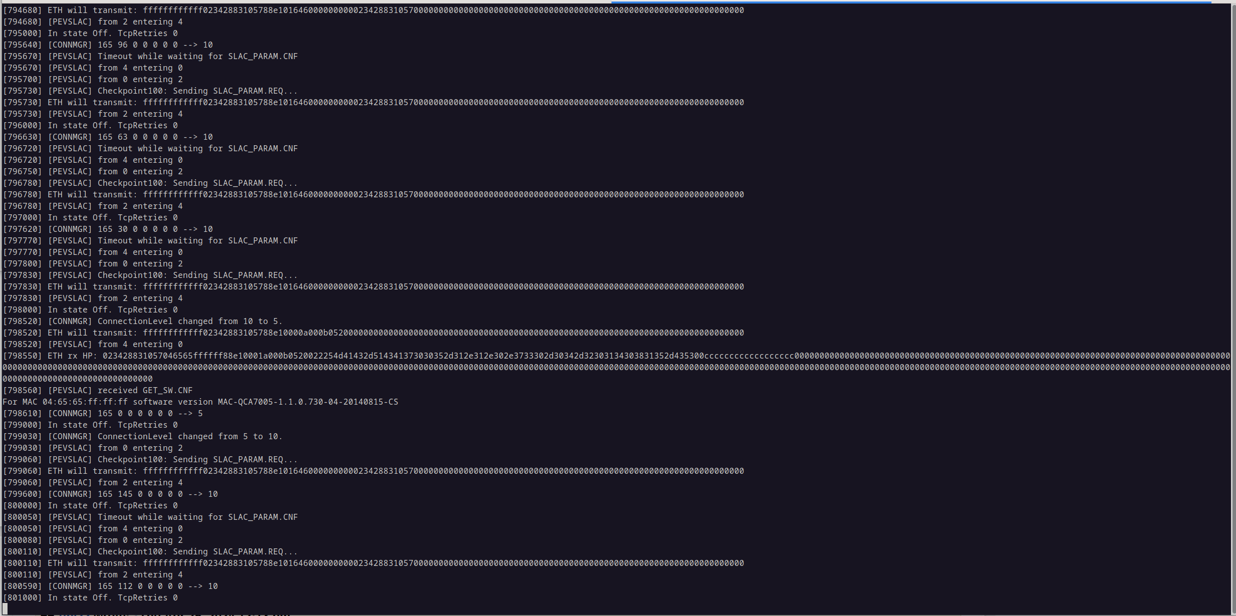

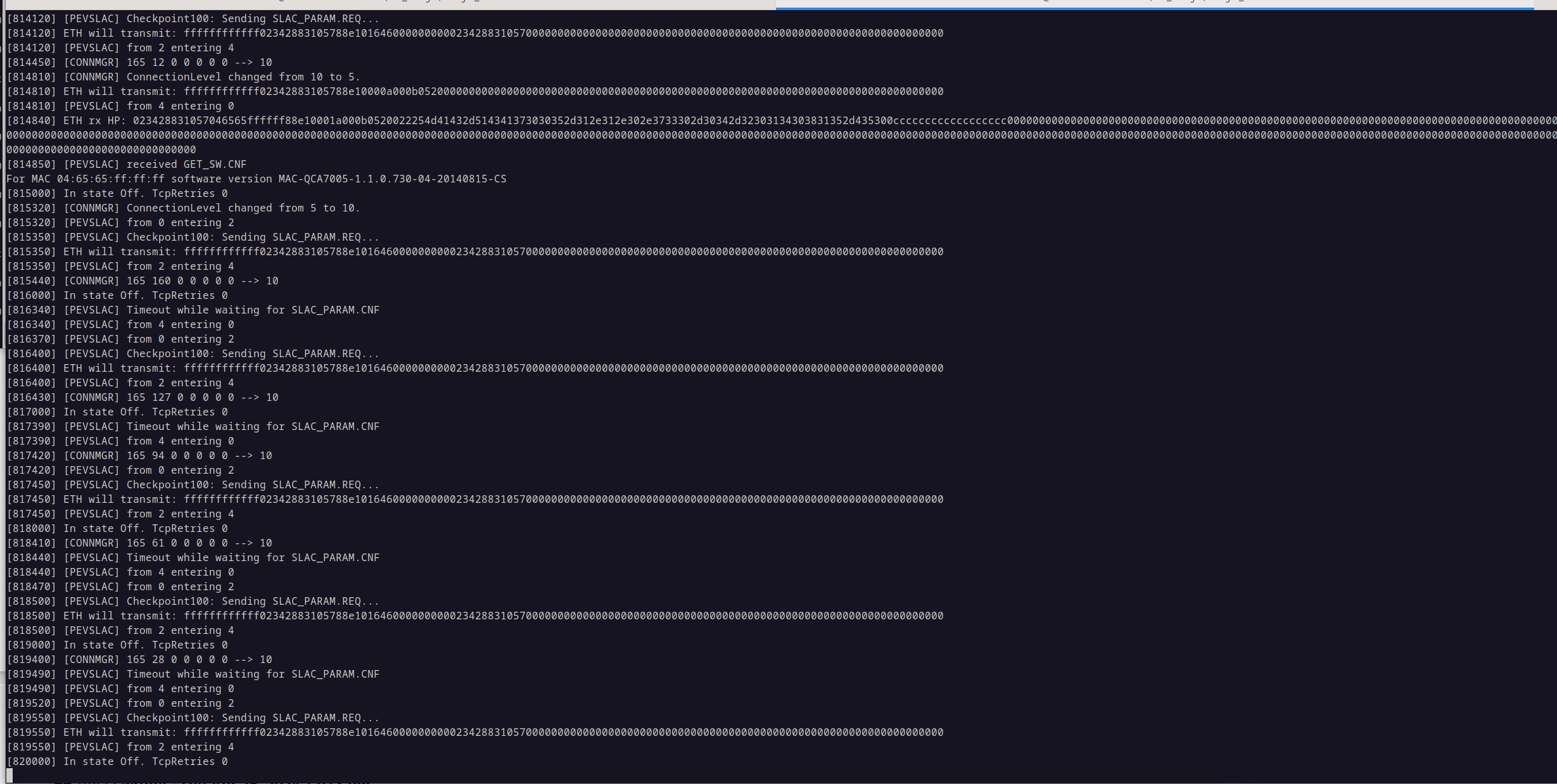

Keep attempting to charge but without making any hardware changes, the EVSE seems to have stopped recognizing when it is plugged into the inlet. Is there anything on the software side that could be causing this? All I am doing before charging, outside of sending can data to the charger, is set enable to 1 on startup.
The only suspect thing is that control pilot duty is reading 0%, even while the charger is actively connected. Could the problem be with the connector (inlet or plug)?
- uhi22
- Posts: 1117
- Has thanked: 206 times
- Been thanked: 617 times
The 0% CP duty is clearly pointing to an error, either of the charger, or of the wiring. First point is to take a multimeter, and measure on the unconnected charger whether there are 12V between CP and PE. Second, check whether the CP of the inlet is connected to the CP pin of foccci. Third, with removed Foccci connector and plugged-in charger, you should see the 12V on the CP pin of the Foccci harness. And when plugging everything together, the CP should change from 12V to 9V and then after some milliseconds (up to a second) change to 5% PWM with -12V and +9V. In best case, you could use a scope to check this.
Ran into trouble
Again, the charger will not recognize when it is connected. I verified continuity across all my connections but noticed only 4.5V across CP and PP. This would seem to be outside the range you mentioned earlier. I have attached three screen shots. The first is sitting unconnected, the second two are when the charger is physically connected to my hardware. It is during this period that I measured 4.5V.
Charger I am using is Qingdao Penoda Portable DC CCS2 Charger. I knew there are differences between CCS1/2 (I did not order this charger) but because there were promising signs early on in testing, I figured they were backwards compatible. However, now I'm suspecting that this may not be the case (as was discussed in the above lined forum post), and now I just feel a bit silly. Maybe a setting like my PP variant is set incorrectly? I have it currently set to 2.
I wonder, could this have something to do with it? Our SOC is pretty close to 90% when charging. I think it was much lower last time I attempted.dougyip wrote: ↑Mon Apr 29, 2024 4:20 am 3) It appears that SOC is not strictly for display (at least on the PhiPhong charger). It does enforce some safety monitoring. The charger faulted out and would not restart when we hit 95% SOC (number was incorrect, we were probably closer to 75%) with 80kW charge power. When the transmitted SOC number was changed to 75%, were able to re-start and continue at 80 kW.
Edit: Fudged the SOC sent to the charger and it made no difference. During the last successful set of connection tests, there was no load connected to HV and all the BMS values were fudged as well (Values resembling 65% SOC)
