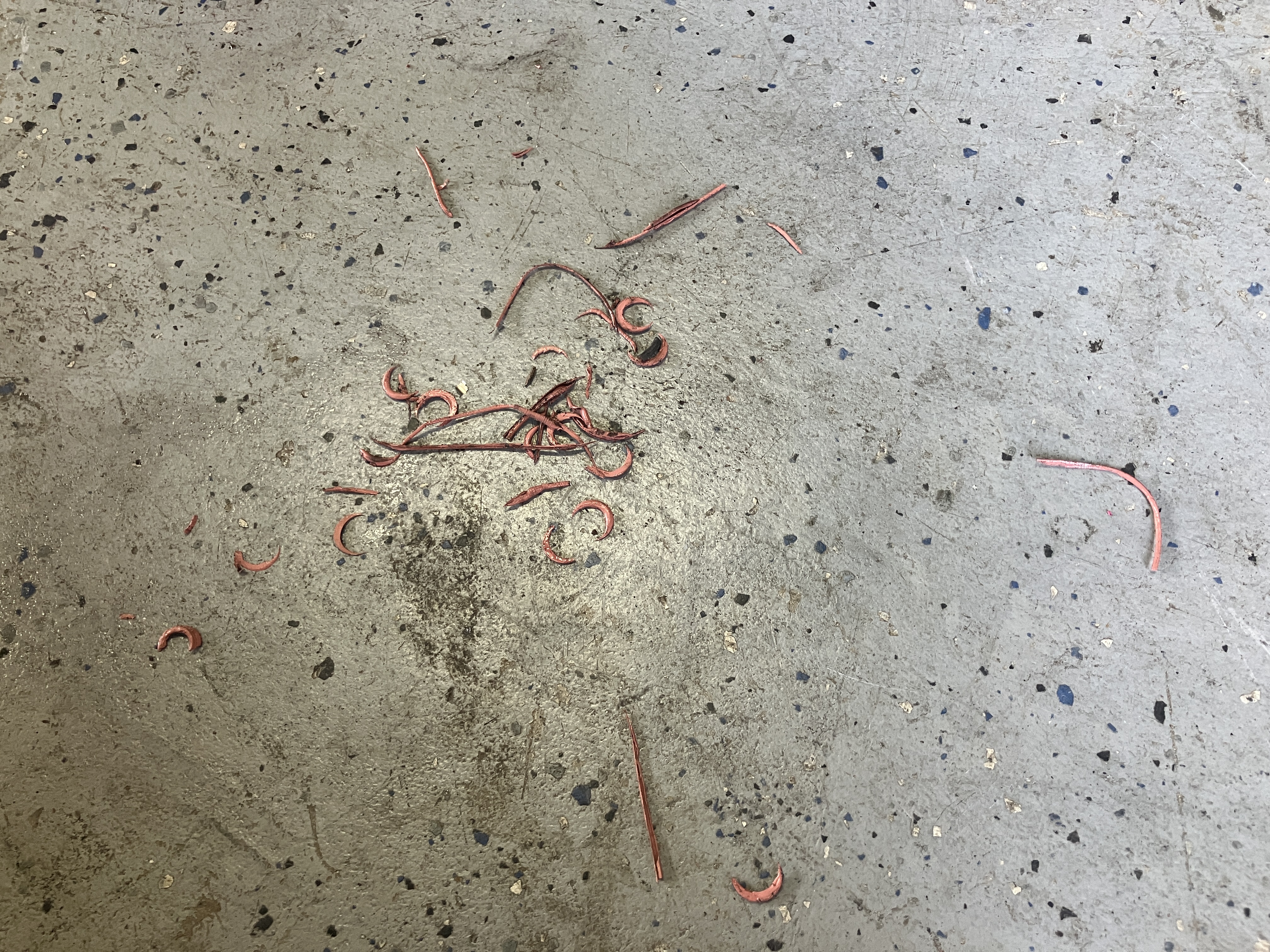

so I thought it was the Parking Pawl causing that click clock noise
- Gregski
- Posts: 2743
- Has thanked: 500 times
- Been thanked: 946 times
well it was one of them days
I decided to drop the transaxle, so naturally first I had to either grow a third arm, make some friends, or invent the Soloist 7000

Happy to report the problem has been fixed, I will leave the technical explanation to the masters.
Toyota Prius Open Transaxle Motor Action
