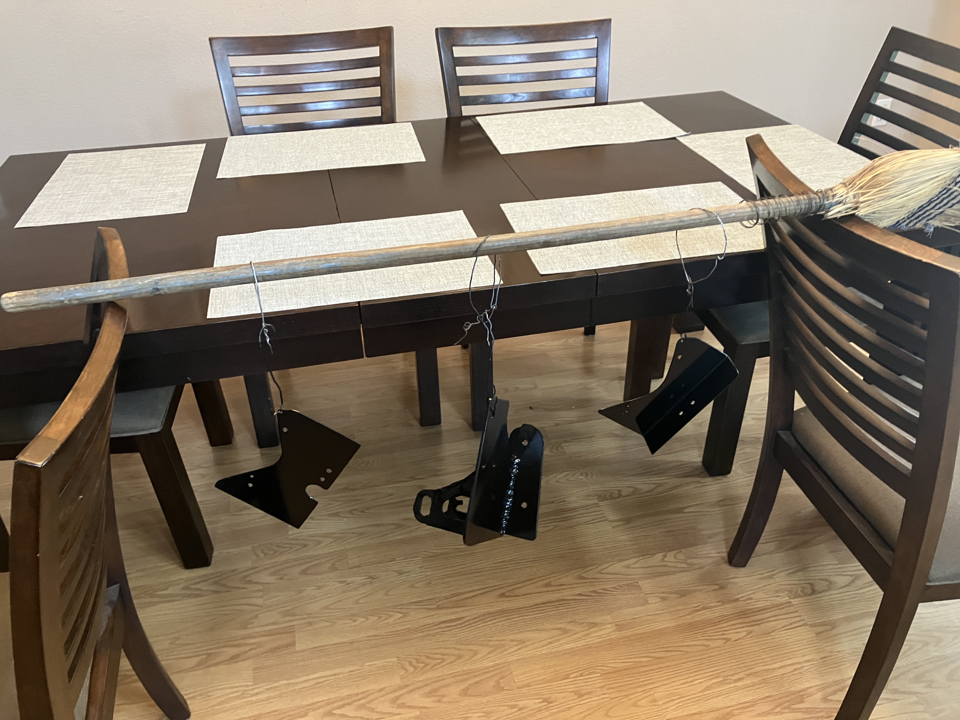

Post by Gregski »
with the transaxle out I thought it was as good a time as any to make some things black (after making them red)
I luv this primer
I wanted to hang these up to cure in the garage, but the wife insisted I move them into the formal dining room, while she's on Girls Weekend Out !

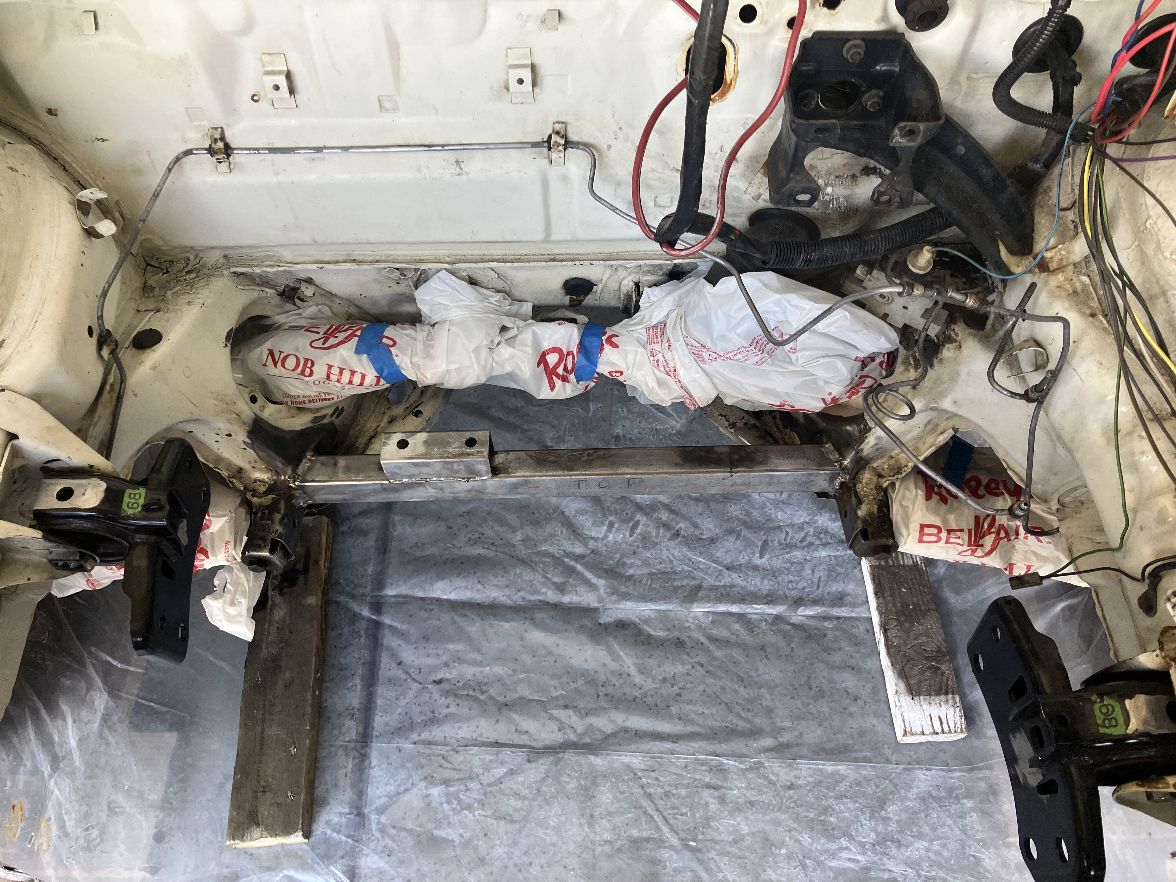

Post by Gregski »
I also managed to get the Paint Booth inside the Rabbit
nailed the color match
