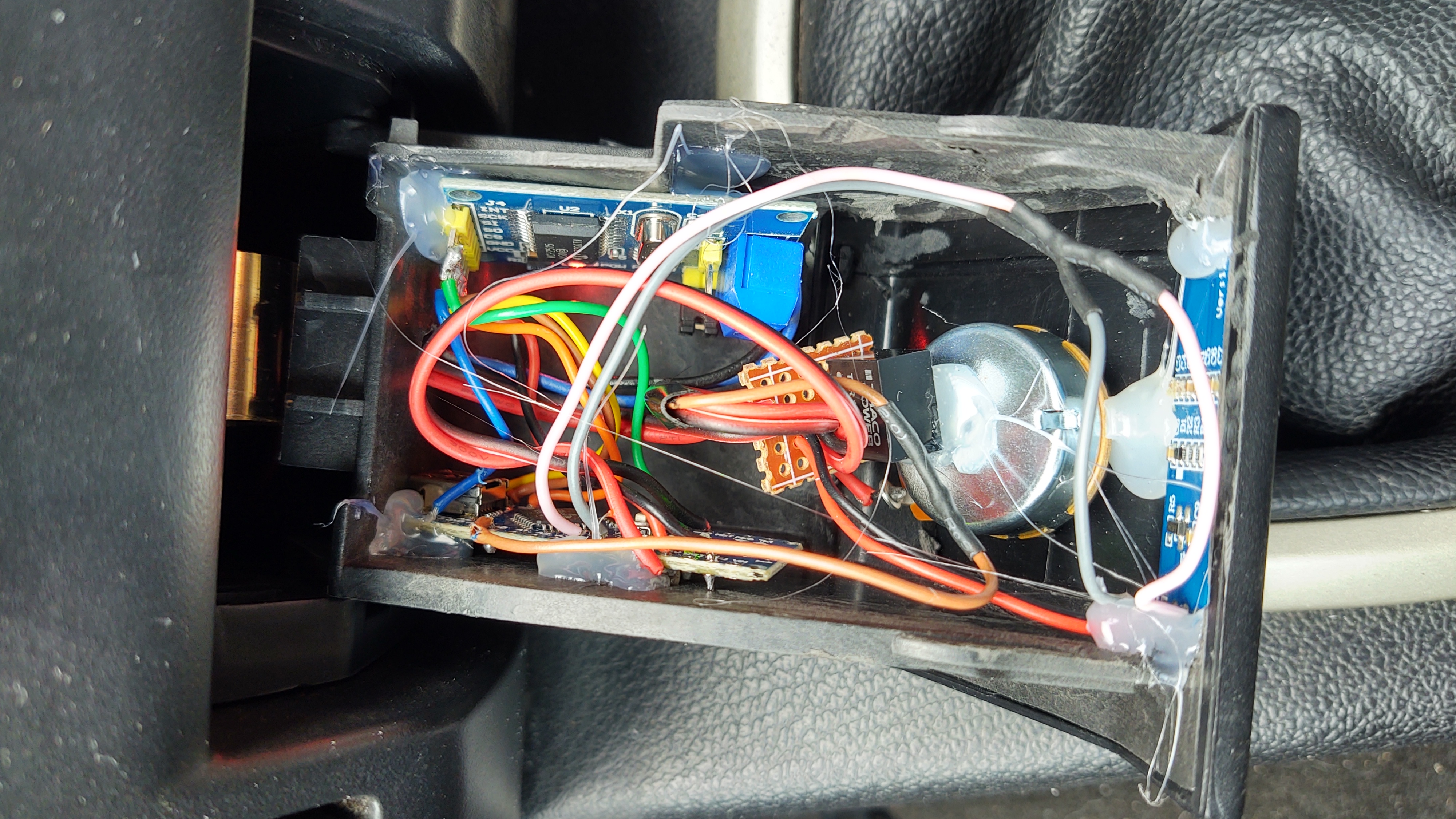

This is a copy and paste from the Outlander heater thread.
Here is a quick update of the heater situation now I have it installed.
It works!
The longer version includes a minor disaster and a change in design.
While testing I managed to drop some solder on the board while it was running. This caused the operation to be somewhat sub-optimal so after first replacing the MCP2515 I then had to replace the Arduino and of course it was no longer soldered to the vero board.
Originally I had planned to mount the board under the bonnet and feed wires through to the dash but while staring at the new pile of wires I had an idea.
OK so neat it isn't but this was more a proof of concept than a final installation. In order to tweak the code I will need to remove the Arduino as I didn't give myself enough room to plug in a cable but that can wait a bit. I have plenty of other things to work at in the meantime.
Jamie/TurboPete's code works great however in my application I might need to adjust the temperature difference before the heater switches to half power. It looks like it switches to half power while around 10°C below requested temp. This means if I request 55°C it only gets to around 50°C which is not quite enough. I find myself turning it up to 61 or 62°C to get the desired 55°C.
I assume this will change as we get into late Spring so for now I am keeping the adjustment and code as is. I have a second ash tray that I can use if I decide to use Arber333's code without a POT.

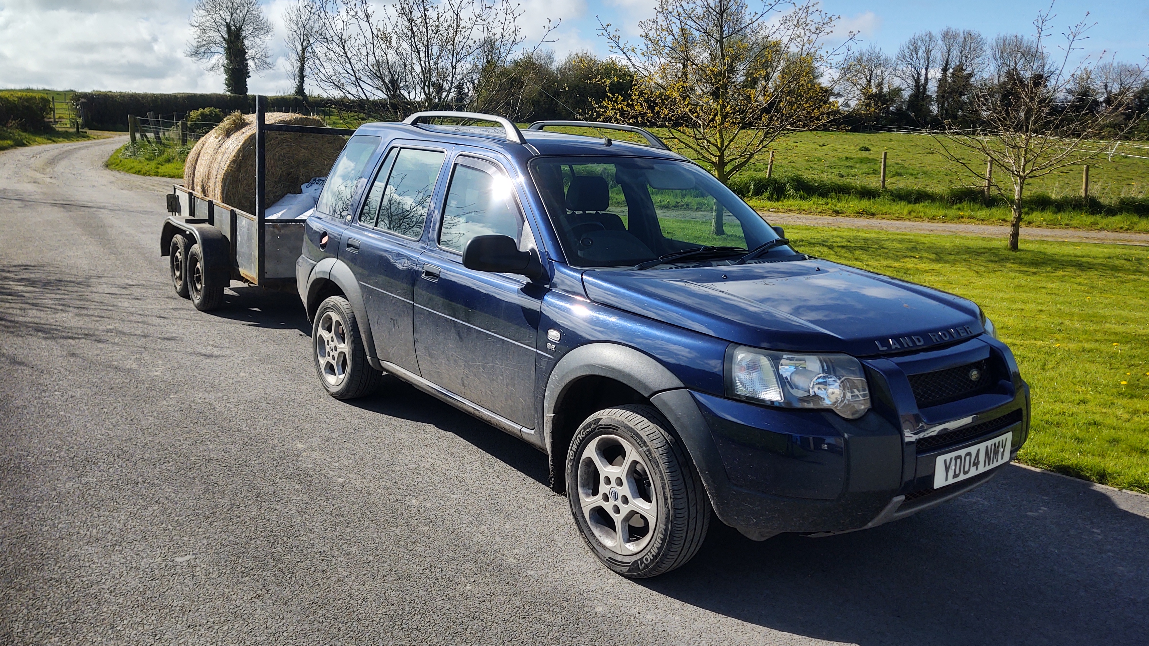

Re: [Driving] Freelander EV With Gen1 Leaf electrics and EVBMW VCU
Latest video
And I put a few miles on the car over the weekend.
I always wanted this to be a practical workhorse that I don't need to be too precious about
Every time I use it to tow a trailer it's another time I don't burn out a little bit more of SMBO's Kuga clutch.
Thanks, I've now done almost 500 miles since it pigged on me (technical term) and it's been driving great.
For people to say EV's can't tow is just stupid, to say they can't tow very far is a bit less stupid, especially if the load is bulky and/or heavy, also if you need to recharge with a trailer attached it is not easy. In my case I have only towed for a few miles so it is difficult to say how much difference it makes.
Keeping this car 4WD and keeping the towbar were two priorities for me as I wanted it to be as practical as possible. I plan to go to a town 4 or 5 miles from home next week to collect stone to fill holes in our lane. It's a job that needs done every year and I usually get 1 tonne at a time.
The BMS will be happening this summer but I have concerns over the layout of my batteries. The LEAF BMS is designed for a split in the pack at cell 48/49 but my pack splits at a different point so I need to come up with a plan to prevent the BMS going up in smoke.

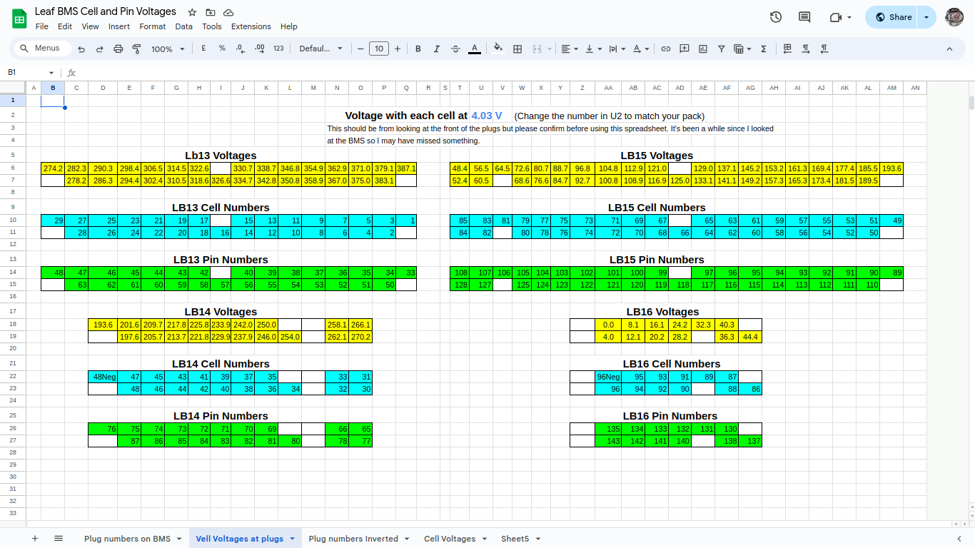

The last few days I've been struggling to get my head around the BMS again. Although it probably won't be able be able to keep the pack balanced it's a good idea to have it working as I can use a simple Bluetooth dongle and App called LeafSpy to monitor the voltages of each cell. Having the BMS working means I'll be able to see if any cells are out of balance and if necessary I can intervene manually. I really should have had it sorted months ago but I knew it was going to be a pain so kept putting it off. I had it connected and working a couple of years ago on the bench but that was with all the modules in one place. Now I have some in the front, some in the fuel tank area and some in the boot so it's not so simple.
During the week I spent several evenings working on it and then pretty much the entire day yesterday soldering testing, pulling apart and resoldering cause I messed up.
This was the mess I was in earlier.
After many cockups, a few poor decisions and some generally dodgy workmanship I think I have it sorted.
Some time ago I made up a spreadsheet to give me the expected voltage at every connection for any given cell voltage. I was able to test all the voltages and even discovered a fault in the spreadsheet so today I'll sort out a 12V supply for the BMS, hook up the CAN leads and hopefully see the condition of the battery pack.
My confusion was caused by the numbering convention by Nissan, they count the most positive cell as cell 1 and most negative as cell 96. The lowest number cell in the boot is 41 so I started there when I should have started at 96. I figured trying to meter and count the voltage from cell 96 to 41 would be too complicated so I metered from the most positive end and managed to confuse myself completely. Eventually I dug out the spreadsheet and once I had this in front of me it all started to make sense.
I got the connection numbers from the Nissan Leaf service manual and it worked before so I'm confident it is correct but another complication is at cell 48. There is an extra negative connection for cell 48 because the BMS is galvanically isolated between cells 48 and 49, to protect it from stray current drain when the HV service disconnect is pulled. Basically if this was not there the BMS would be shorting out the HV service disconnect, thereby maintaining the HV circuit, This would not only be dangerous but if there were a stray power drain it would melt the BMS.
My service disconnect and contactors break the pack at cell 41/42 so I have to try and figure out a way to ensure the BMS is never connected when the contactors are open. I'll probably use a relay to make/break the connection to cell 49 and ensure it is only ever active while the car is in drive mode.
Has anyone ever tried this before? I had heard I am likely to cook the BMS with the battery layout I'm using but I don't have much choice as moving battery modules to the front of the car is not an option without a LOT of work.

- Posts: 6711
- Has thanked: 368 times
- Been thanked: 1541 times
You could move the "negative" contactor between 48 and 49 and move positive and precharge to the end of the pack. Don't break between 41 and 42, by Murphys law this can and will go wrong
That's a great idea thanks. I already have two contactors in the rear battery box breaking the neg and pos as well as in the HV junction box so it should just a matter of reconnecting the neg.
I was concerned there would be positive voltage on the cable and connector If I broke the pos and neg at 48 but it never occurred to put only the neg contactor in there.
Thanks again.

So good and bad news for the BMS.
The good news is it's working. I can see every cell and have been able to manually drain a few that were too high. They were maybe 40 or 50mV higher than average so not disastrous but bad enough to potentially do harm if the pack were fully charged as they could have been slightly over 4.2V. This is not a major issue so long as they don't drift higher and get really out of balance. I'm pretty certain that I've caught them in time.
The bad news is that with my pack layout the BMS can only be accurate at around 0A so I will need to disable it when driving or charging which is not ideal. This is due to the resistance of the contactors cable and fuse in the wrong position as far as the bms is concerned and the length of the cable. I think moving the neg contactor to between cells 48 and 49 will protect it from harm when the car is turned off but can't help when it is on. There should be almost zero resistance between all the cells and I have a measurable resistance between cells 40 and 41 due to a fuse, contactor, manual disconnect and around 5m of cable being between them.
I'll probably fit a switch somewhere to turn the BMS on and off when I want to check the pack but in the meantime I'll just pull the fuse for the BMS once I'm happy the pack is balanced.
This was the output from LeafSpy earlier (While charging) You can see cell 40 looks odd but this is because of the resistance in the cable etc.
Three of the modules are higher the the rest, two 4S and one 2S.
This is it while not charging so very little current and cell 40 is not so odd looking. The voltage of each cell in LeafSpy jumps around a lot so don't take these figures as 100% correct. Cell 95 was much better looking after I balanced the module it is in. And this is it now, I'm still draining the two highest cells with a buck converter set to 150mA so the two higher ones are not there yet.

So you are manually balancing the cells when needed..?
Maybe move the upper and lower limits a bit tighter to allow for more drift in the individual cell voltages?
With slight loss of range, but more peace of mind?

Yes mate, as far as I know the Leaf BMS balances with only 10mA so virtually nothing. I have been trying to drain 50mV from the two cell module using the BMS wires and after more than 10 hours it has hardly changed. I'm using a CC buck converter to draw 150mA so at 10mA the BMS wouldn't have much effect.

Oh, them BMS systems really don't hurry with the balancing it seems.

I had a big day yesterday in my Freelander EV as I drove it to a MG dealer approx 39 miles from home to see a MG5.
TBH I had no intention of buying it but I wanted to have a test drive in one as I am thinking of replacing my old C Class estate and the MG5 seems to fit the bill. The problem with the one I went to see is the range as it is the smaller battery 52kWh model and for my work I really need the 62kWh version. The charging infrastructure in Northern Ireland is pretty poor and for work I often end up driving up to 200 miles in rural areas so having a range of 150 to 180 miles is just not enough.
Realistically the 62kWh model has a summer range of 220 to 240 miles if driven sensibly but a winter range of 200 miles max but this is enough for me to make it home 99% of the time. I should be able to give it a 10 or 15 min top up on the way home if necessary.
The great news is I was shocked by how nice the MG5 is to drive. It was comfortable, quick, had all the toys I want, didn't feel at all cheap, and even passed the Mrs test so I am actively on the lookout for a suitable car in this country. Unfortunately there are very few around so it is a waiting game. The one I looked at yesterday was a 2021 model with around 35k miles and they were only looking £11k for it which I thought was a great price.
The other big news is the Freelander was fantastic for the 78 miles drive and we made it home with plenty of power to spare.
I charged it today to the same level it was at before we left and it took 28kWh to refill with electrons.
So if it took 28kWh to drive 78 miles that is 2.8 miles per kWh, which is pretty amazing for a DIY EV conversion of a not very aerodynamic car. The journey was approx 60% dual carriageway at 60 mph, 30% country roads at 50ish and 10% town driving.
In theory with a mpkWh of 2.8 and a battery capacity of 38kWh the range is 106 miles and I'm fairly confident that would be possible but I should probably say 90 miles is the range and have a 10 to 15 mile buffer.
The thing I need to be careful of is the odometer is around 7% off because of the smaller tyres I have at the moment. When we got home the odometer was reading 85 miles for our 78 mile (according to Google Maps) journey so this is something I need to take into account until I get new tyres fitted.

So the manual balancing helped a lot as the imbalance is now down to 40mV when fully charged and 30mV when mostly discharged. I don't know if that is good or bad but at least I now have a BMS so I can keep an eye on it and intervene if necessary.Alibro wrote: ↑Thu May 23, 2024 7:55 am Yes mate, as far as I know the Leaf BMS balances with only 10mA so virtually nothing. I have been trying to drain 50mV from the two cell module using the BMS wires and after more than 10 hours it has hardly changed. I'm using a CC buck converter to draw 150mA so at 10mA the BMS wouldn't have much effect.
