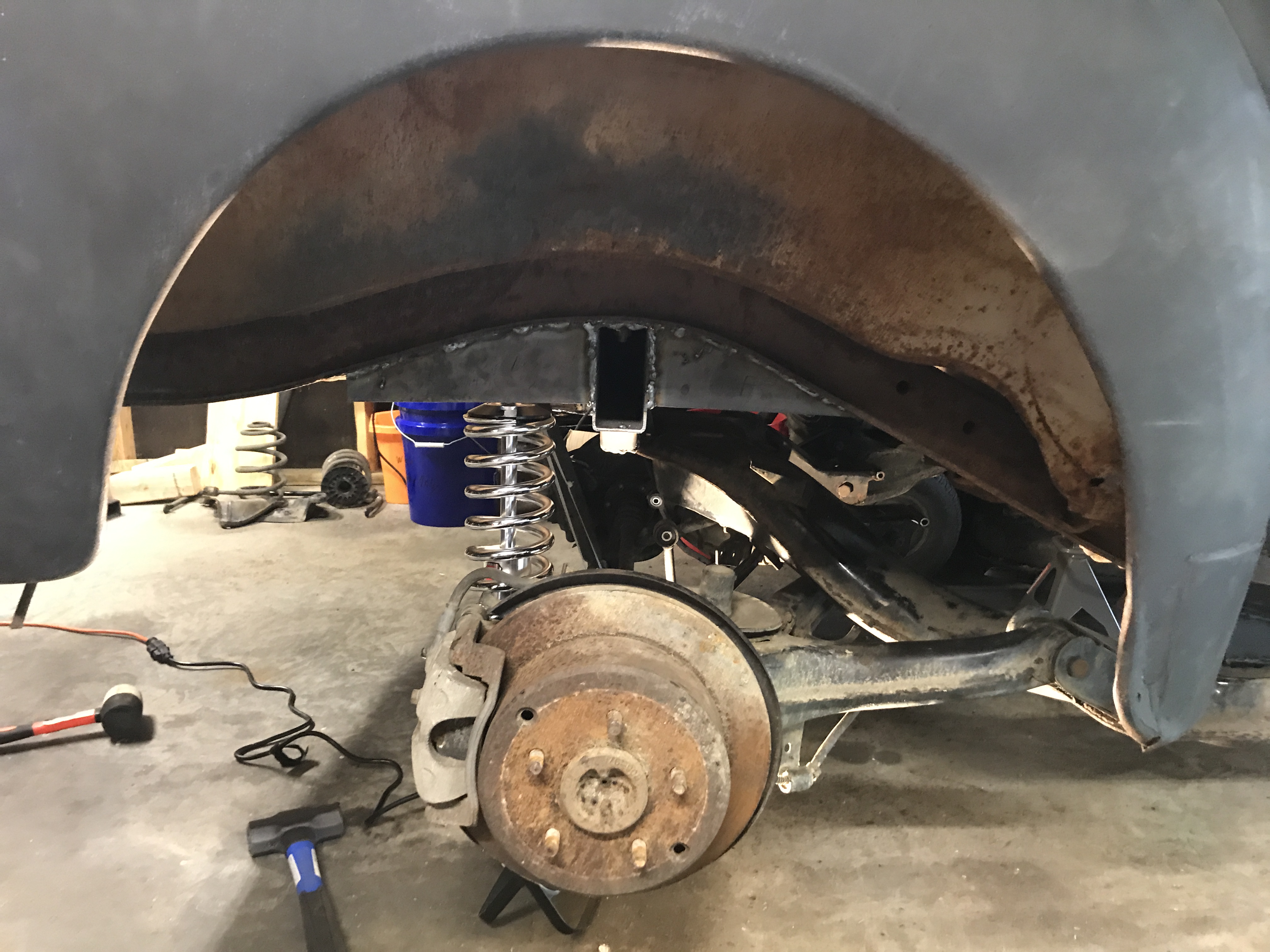

My main rear suspension mounts are done, and the passenger side rear control arm is in place. The driver's side just needs to be bolted in, I ran out of time this weekend. From there, I will just need to fabricate coil spring perches and shock mounts. I hope to switch to coil overs in the future, but right now I just want to get it running.
Further work is on a tentative hold. I need more parts before I can do anything, and I've put a hold on spending due to the covid-19 crisis. Mostly being over cautious and diverting "fun" money to emergency savings. So for now, its just finishing up what I already have, and prepping as much as I can for when I can get the next big items (motor and cage) purchased.

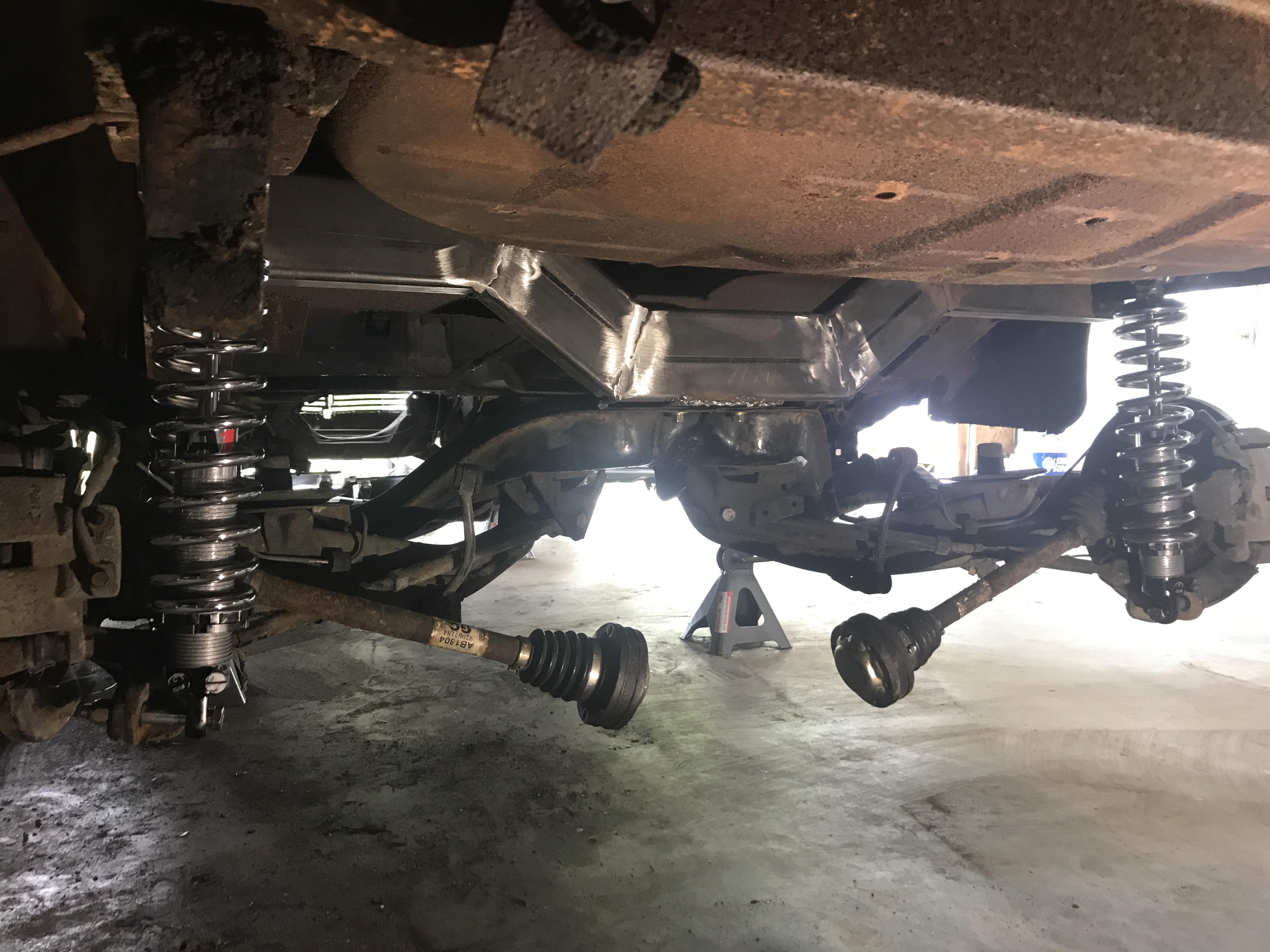

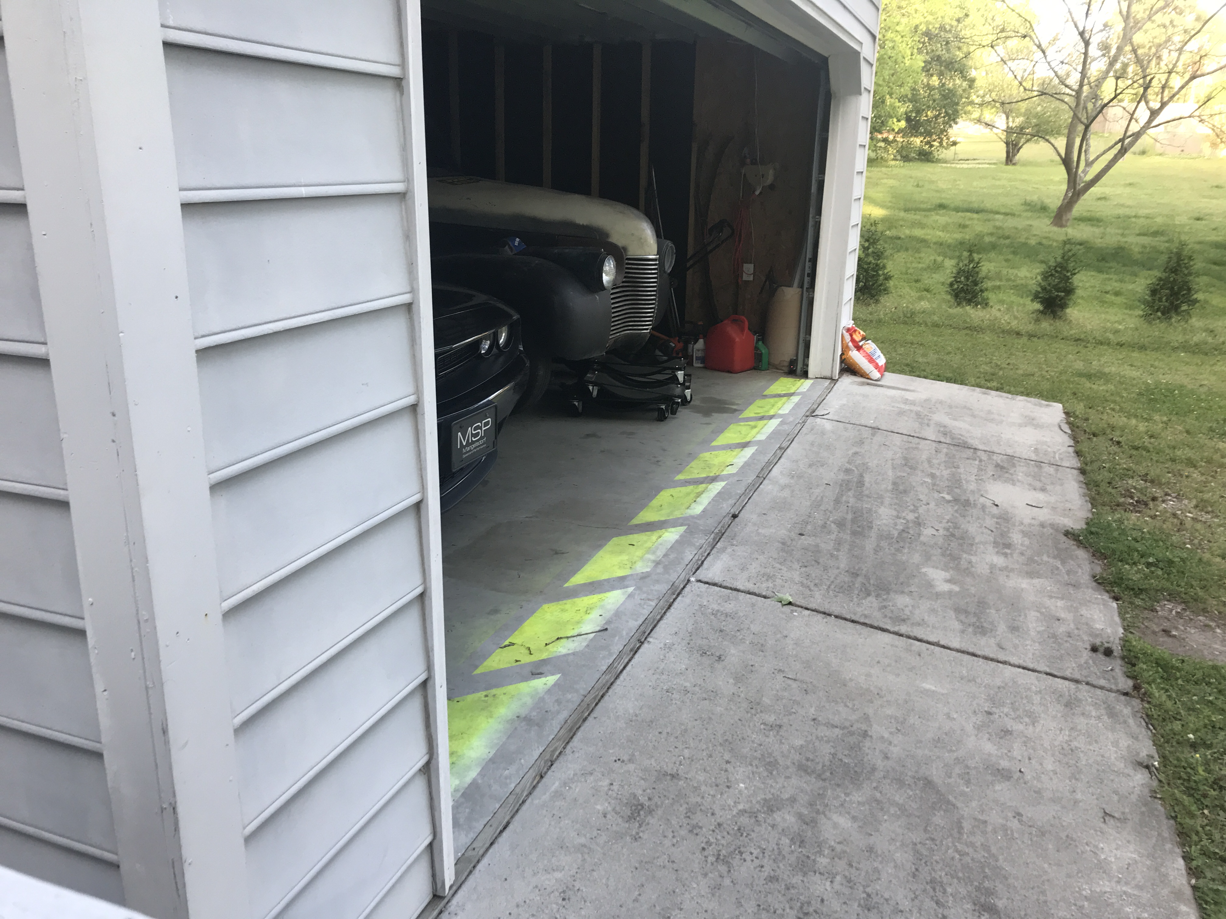

Finally an update with photos!
The rear suspension is complete. The shocks will need adjusting once everything is together, and I will likely need to tweak the spring rate once all of the weight is in the car. Good thing vibrations are my field. The plan will be to get everything put together, and then adjust the rear spring rate until everything is compressed the right amount at the right ride height etc. Then I'll se the front spring rate with math so that the vibrational modes are decoupled.
At this point I cannot proceed until I get an LDU in the garage. Likely in the next 1-2 months.

-the rear suspension from the passenger side
-a cool shot (in my opinion) of the 40 and my daily in the garage
