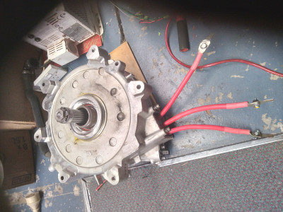

No exploring options for a small motor to couple to the input shaft of a gs300h for CVT control. But I think it will require too much work to couple and is probably bigger than I need for this application.Woodfie wrote: ↑Fri Jan 26, 2024 11:11 pm I checked with my friend, At this stage, the MGR , housing has not been cut down.
Will update you when any relevant pictures are taken, is not sounding imminent.
When cut down, I guess it would be a comparable size and Kw to the I 3 Rex,
One complication is that the MGR I think drips or mists oil around the windings, to take heat to the outside case, and the oil is lifted to a channel by reduction gear rotation then distributed by spray from the rotor.. I could be corrected on this, was many years have passed.
Is your intention to use this as a generator?

You could start here:Jacobsmess wrote: ↑Thu Jan 25, 2024 9:45 am I've come across a very cheap one of these and I was wondering how easy it might be to modify the body to remove the diff. Has anyone opened one of these up? Looking at the pics it's difficult to tell but I'd be interested to know if it's possible to separate the motor from the diff and make it much smaller.

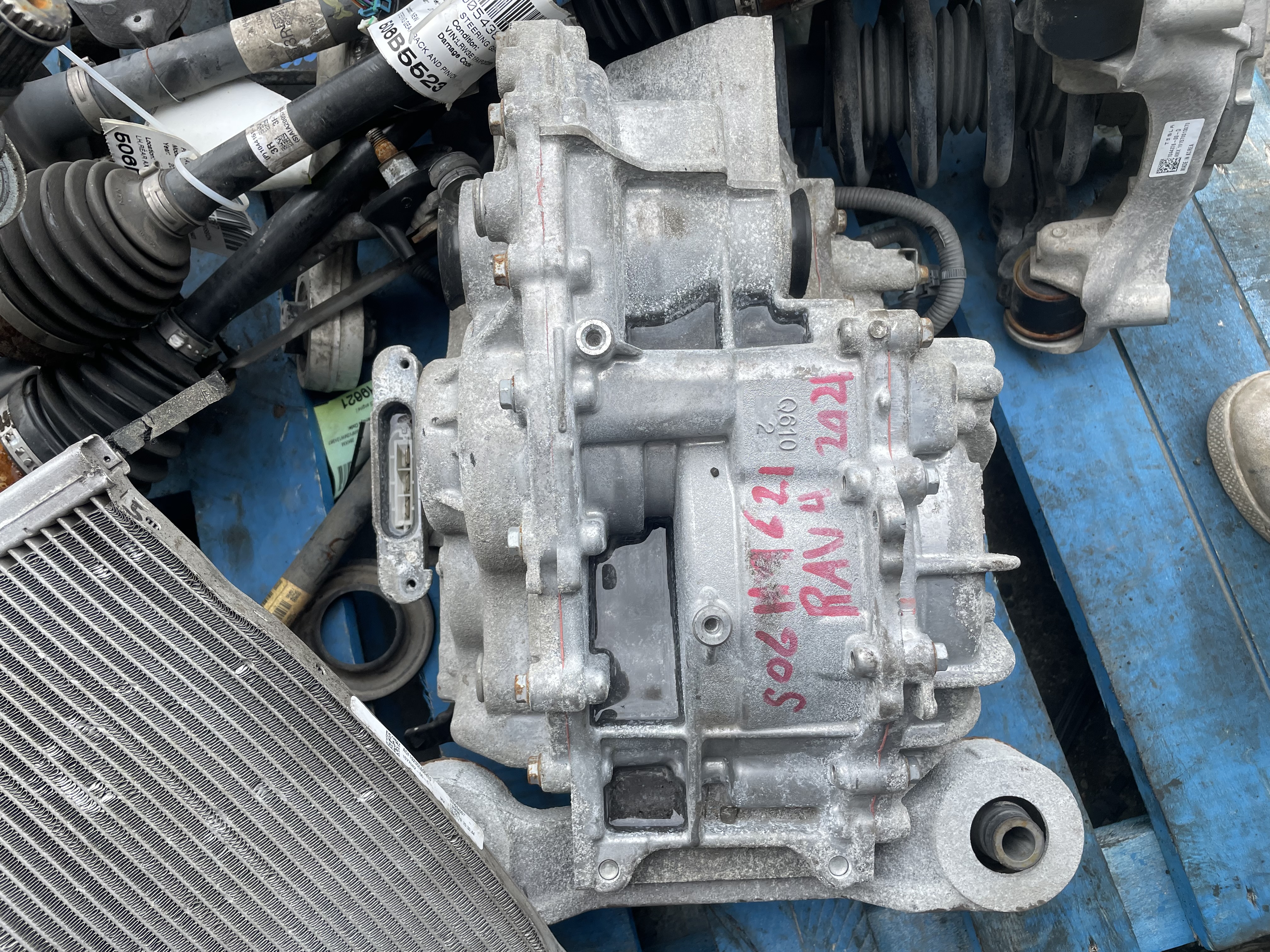

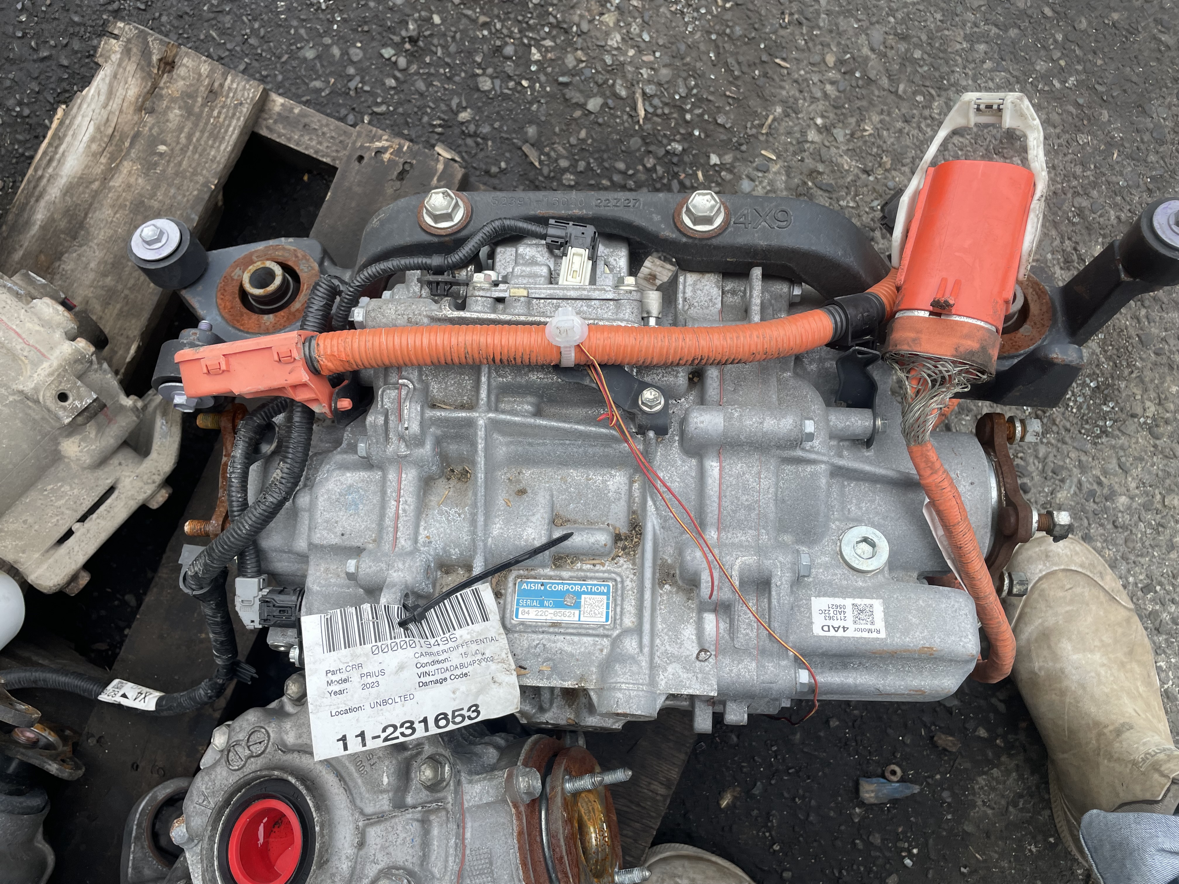

went for a trip through a local wrecking yard, and wow so much ev and hybrid stuff now!
Came across what looks like to be next gen Toyota mgr units

Re: Toyota MGR Rear Traction Transaxle
rear toyota prius motor has a dedicated inverter. Interesting. However very low performance specs, likely due to indented purpose of low speed awd.
https://priuschat.com/threads/prius-awd ... re.202285/
EDIT: My bad this is an old prius not the 2023. will look for right specs.
This say 30kw unit https://www.guideautoweb.com/en/makes/t ... mited-awd/
Here some nice specs and pictures https://toyota-club.net/files/faq/19-10 ... wd_eng.htm
