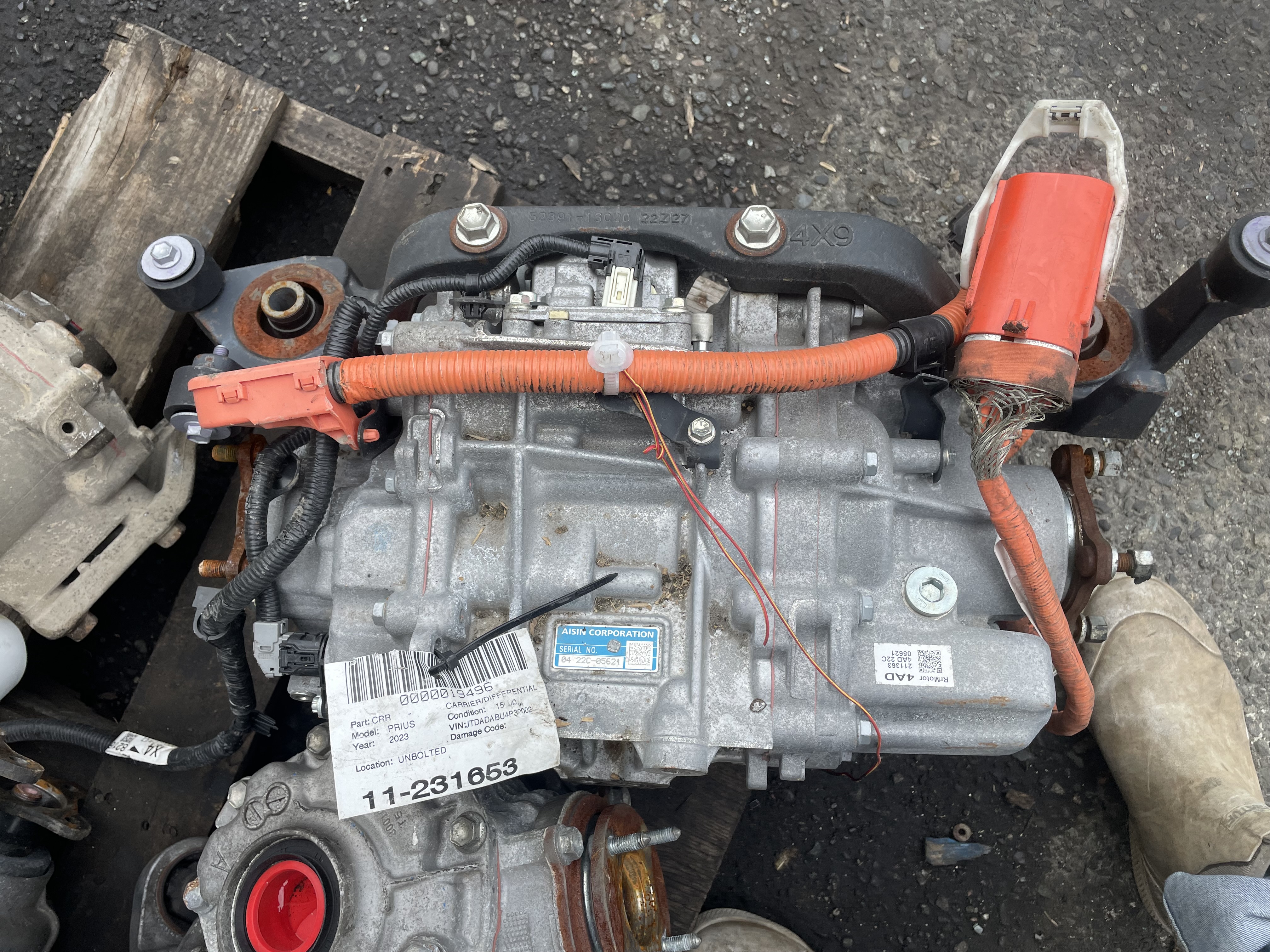

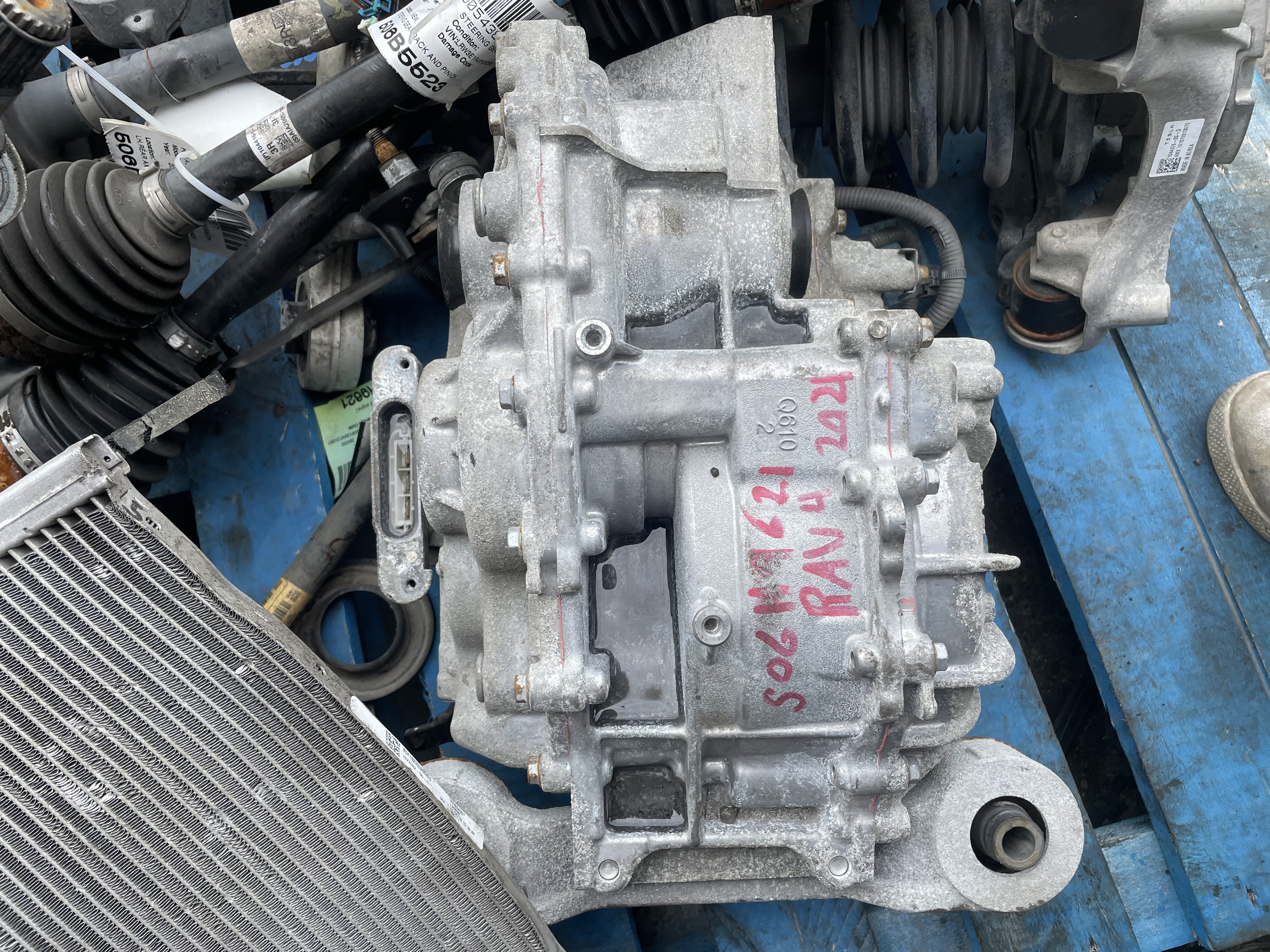

went for a trip through a local wrecking yard, and wow so much ev and hybrid stuff now!
Came across what looks like to be next gen Toyota mgr units
