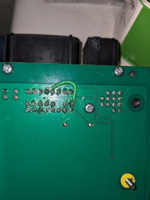

I had a customer request a drop in solution for their off road rig which could get them more power than stock. They are running a Thunderstruck controller and they don't want to have to rewire/reconfigure everything if they change back and forth between inverters.
I'll be the first to say - what Ive done to accomplish this for them isn't as safe as it should be, but this is an offroad rig.
One of the first things about the Gen2 Leaf adapter which doesn't make sense IMO is the location of the RUN pin. The factory Leaf enable pin lines up with the Out DCSW pin which isn't particularly good since that's usually got 12V coming into it. So since I wasn't using this, I cut the trace to the DCSW function and jumped the RUN pin over to this location.
I also threw together a quick 3d printed spacer for the mounting screws so the case wouldn't get charged to 5V because of the back plane.
That was pretty much all I had to do hardware wise.
Software was a bit more challenging. I couldn't use the latest firmware thanks to all the nice safety things that have recently been implemented with the throttle, so I based mine off of 5.27.R. I brought in the recently added support for Big-Endian can messages which was needed for the Leaf. The other issue was that the throttle output in reverse was 2's compliment. So I also added that to the throttle calculation.
The POT mapping ended up being: 468 27 -12 1
The CANIO mapping was: 468 41 2 8
For CANIO, the bits for forward and reverse are in the wrong order from what the Openinverter board expects, so you need to set dirmode to SwitchReversed.
The output messages representing the Leaf Inverter feedback can also be managed, but require Big-Endian support on TX which I haven't added yet.

I traced the dropout issue down to the canio value and setting the din_forward. It seems that randomly the bit would go back to 0 even though the VCU output was consistent - so it seems like either a Can issue or the inverter software. This happened very infrequently, during a 2 minute pull on the dyno it happened twice, and during another 3 minute pull it didn't happen at all. This value going to zero with the throttle down caused it to go to Neutral and since it cant shift with the throttle applied, it would stay there.
