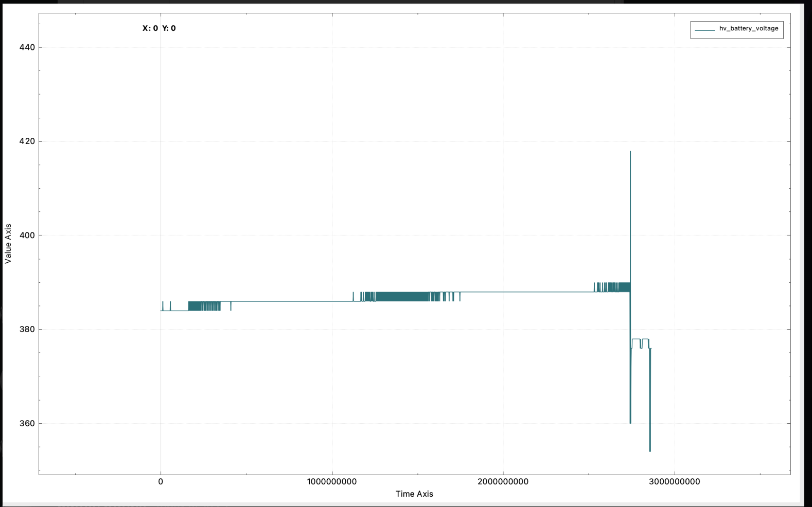

First I want to thank you guys for your help and support with this but I think the charger is OK and not the problem.
Today I started a charge and a CAN Dump with SavvyCan, around 20 minutes later I climbed into the car and tried something which caused the car to cut out a couple of days ago while driving. I turned on the headlights.
Immediately I heard what sounded like the clunk of a contactor and the charge stopped, the coolant pump briefly changed tone but then went back to normal, I didn't see the change in low voltage but if a contactor was turned off briefly then this makes sense .
I tried turning the headlights off and on again to see what would happen but nothing so this is intermittent.
I have attached the CAN Dump anyway but I think I'm looking for a stray voltage, a poor ground or a bad connection.

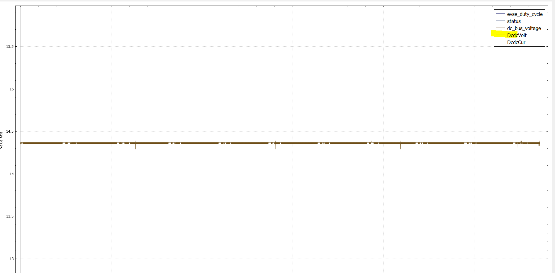

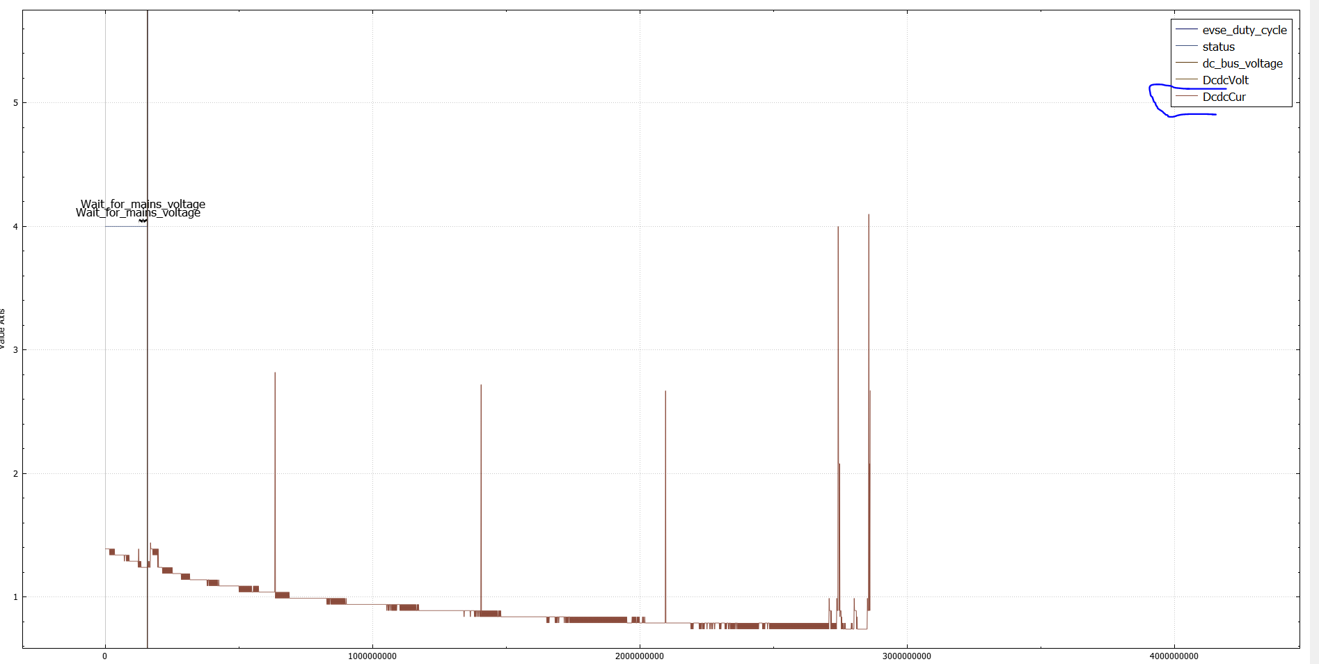

- Posts: 1771
- Has thanked: 82 times
- Been thanked: 422 times
Re: Mitsubishi outlander charger and DC:DC
Contactors are opening
You can see the voltage suddenly jumps to the max, the charger errors out.BMW E91 2006
- Posts: 2393
- Location: Bristol
- Has thanked: 207 times
- Been thanked: 563 times
Your DCDC seems to be fine, you clearly have some very dodgy wiring/12V power faults.
I don't think Johu would appreciate this thread being taken over with discussion of BMS's. For the record I agree they are important and plan to implement one soon so maybe we should get back on topic.
On the subject of Outlander chargers I called into a Tesco carpark last night and plugged in. After around 20 minutes I had added 1kW to my battery pack so it seems to be working.
The only thing I changed from the previous failed attempt was reinstating the 220R resistor between PP and ground however I was at a different model of Pod Point so I still need to try again at the charger that failed last time. I will do that some time this week to confirm if other Pod Point chargers are happy with the CAN messages my Due is sending.
