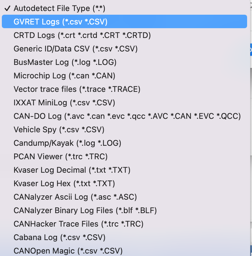

What was that logged with? doesn't open with savvycan

I bought a CanAlyst-2 a couple of years ago and as it was installed on my laptop I used it. I read the file using LibreCalc and used auto filter to focus on certain frame ID.
This is it on Ebay
https://ebay.us/Fa7Ean
Like I said I tried multiple ways to connect the inverter and charger and sometimes the inverter would not enable drive at all and other times I had to turn the ign off for ten seconds or more before turning back on or I got no drive. I think maybe one of the charger connections (not sure which) has a few volts on it when the charger is powered up with 12V and this might have been enough to turn on the inverter which is a problem if it is on too long with no input. TBH I would need to go back through all the configurations to be sure.arber333 wrote: ↑Mon Jan 15, 2024 1:31 pm Hm... can you elaborate on that "interfeering with the inverter" thing. I am still working on my mazda convertion to full Outlander system and i havent noticed any problem. I didnt go too far with RPM yet though.

Damn, Savvycan doesn't seem to support that format. I tend to like using it to decode with a DBC and plotting various values.
Can it it export into a Savvycan supported format?

The software supplied with this tool doesn't allow opening files so I'll have a go at capturing using Savvycan.
Been a while since I touched it.
