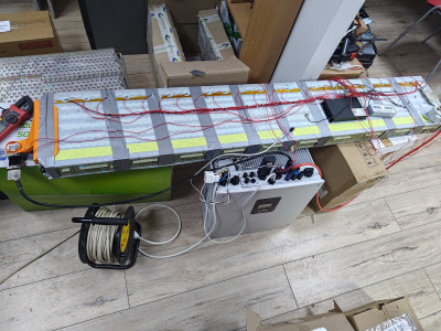

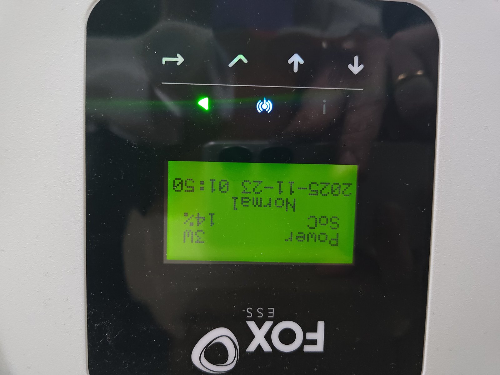

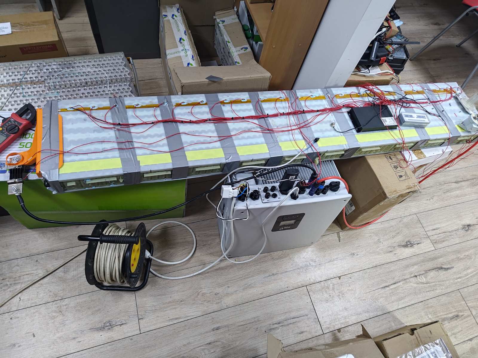

Hi! Have such inverter/ Use Lilygo t485 can to send can messages to inverter inverter show no errors see voltage but not charge the battery EPS mode working/ Try to connect Module from tesla model 3 BMS type jk-b5a25s60p used your calculator ) Inveter starting Write normal But don see soc in app (on its screen soc present) Realy need your Help! Inverter monitor screen Program file

Hi and welcome. You can now attach images to your post directly. I can't see them because of some cookie settings
Re: Fox ESS H1-5.0-E ~33KW Peugeot E208
Hi, have u tried setting the charge times in the app or on the inverter ? You Need to re send photos. We may be able to help then. Have u sent in the can bus message max and min charge current as if this zero the inverter won't charge the batteries

Files adding try to look at it Max charge is set to 45A max discharge is set to 35A min charge is absent in code in code is present only current but it nothing if i change it Some interesting things. if SOC is 0 then inverter charge battery with 4A (400w) not more
