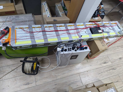

New to the forum, but have been building a V2X adapter for my Nissan Leaf (ChaDeMo).
Thank you for the great information (spreadsheet, photos, CAN logs, BYD-Battery-Emulator-For-Gen24, etc.)
I'm using the FoxESS AC1-5.0-E as the inverter and have everything hooked up and working including dynamic import and export via an emulated RS485 power meter.
However, I was concerned about inrush current and came across this comment:
I measure the capacitance of the inverter as around 10uF (6uF to be precise) when in the "Waiting..." state based on time taken to pre-charge with a high impedance source.
This would also make sense given the 40 Ohm precharge circuit (and contactors) in the FoxESS BMS.
Personally I am going to add a pre-charge resistor and contactor, as I want to prolong the life of my inverter and vehicle contactor - especially as it will be started and stopped daily when the car is in use, but would value any feedback / discussion.

Are you sure?

I have a copy of the official CHAdeMO spec and built my own library based on it. Dala’s version has quite a few errors which can be expected when reverse engineering so be careful.
https://crates.io/crates/chademo-rs
Tested on my own V2H setup using a Nissan Leaf.
As for the FoxESS inrush. Can you measure it using a scope please? I’m kinda curious.
Re: Fox ESS H1-5.0-E ~33KW Peugeot E208
Thanks for the link.
I've also implemented from the spec and written the state machine from scratch. The only bits missing were the V2X CAN message details, but the combination of various open projects allowed me to fill in the blanks to get it working reliably.
Once I'm happy with the safety side (Short Circuit, Isolation and Insulation testing) I'll upload to Github.
I'm currently waiting for a contactor and 40R 50W resistor. Once I've got them installed I'll try and get some scope measurements from the current sensor at connection time.
