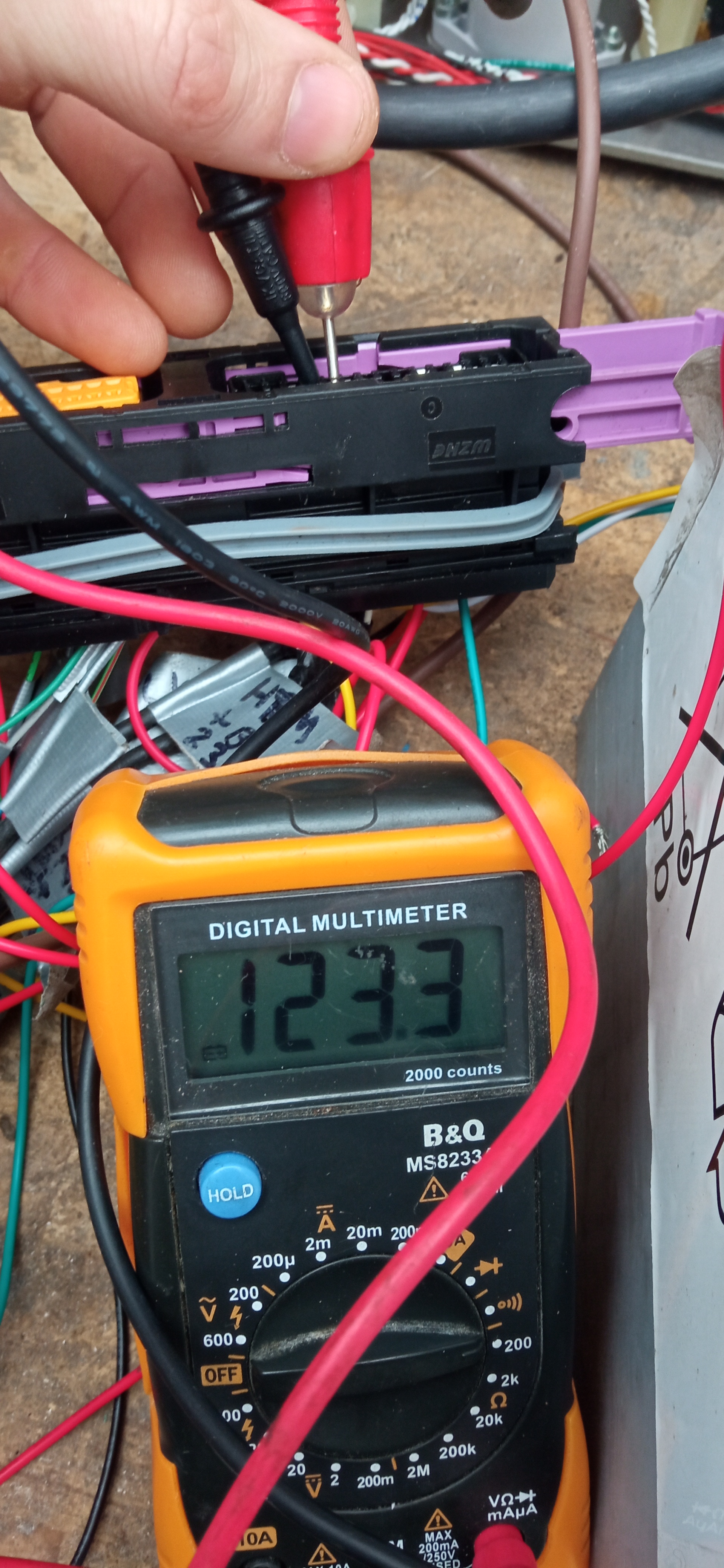

Jacobsmess wrote: Fri Dec 08, 2023 10:58 pm I've gone through and checked wiring and continuity this evening but nothing but I also checked the torque Vs pot and there is no torque request with pot change.
Did you check inter-pair resistance? Should be 60ohm across each pair?
I had problems getting the motor to spin without solid ground connections between inverter, motor, and zombie.
Jacobsmess
Posts: 871
Location: Uk
Has thanked: 545 times
Been thanked: 153 times
Re: [WIP] Mercedes 310E (310D campervan) - GS450H/GS300H
Post by Jacobsmess »
I did and got 128ohms across each pair measuring the same end of each (unplugged zombie). I thought it should be 120ohms....

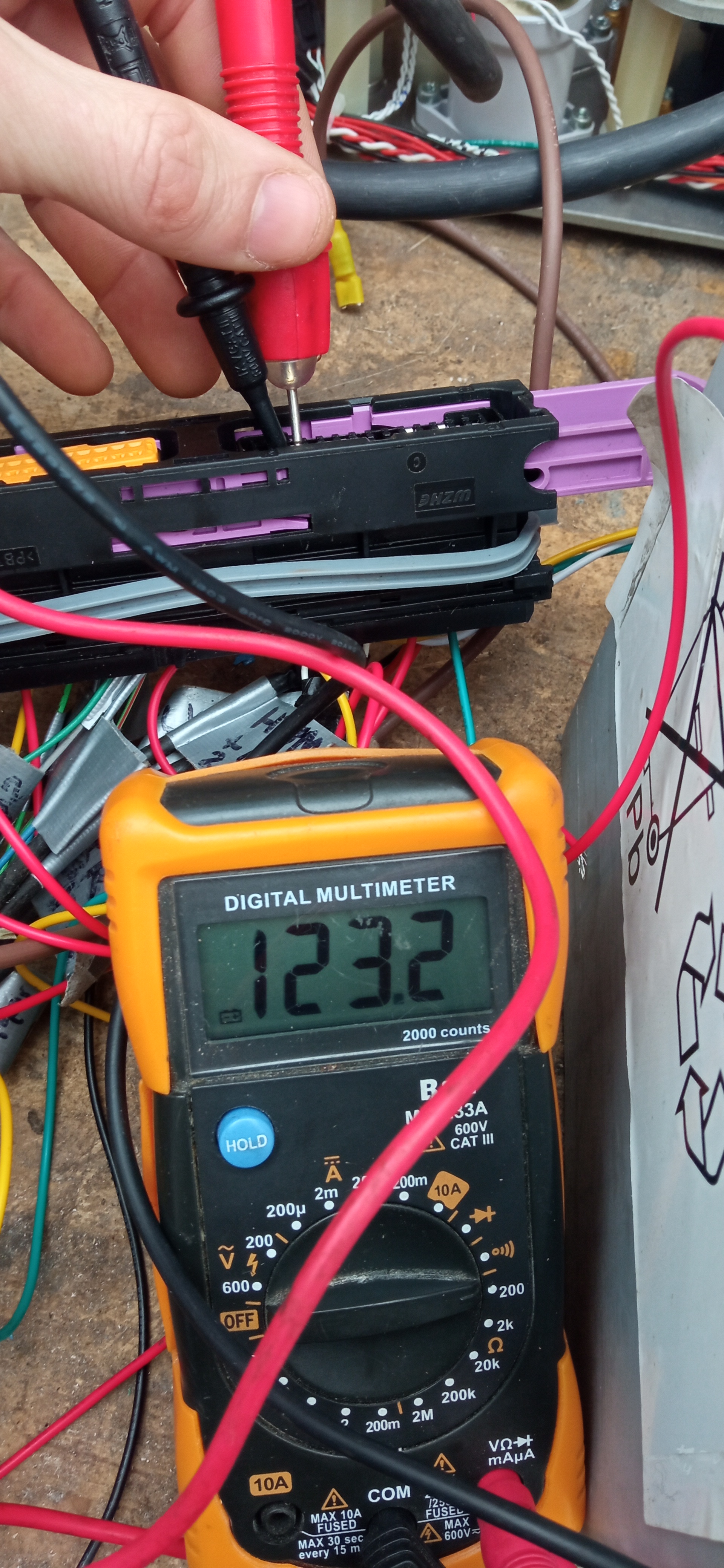

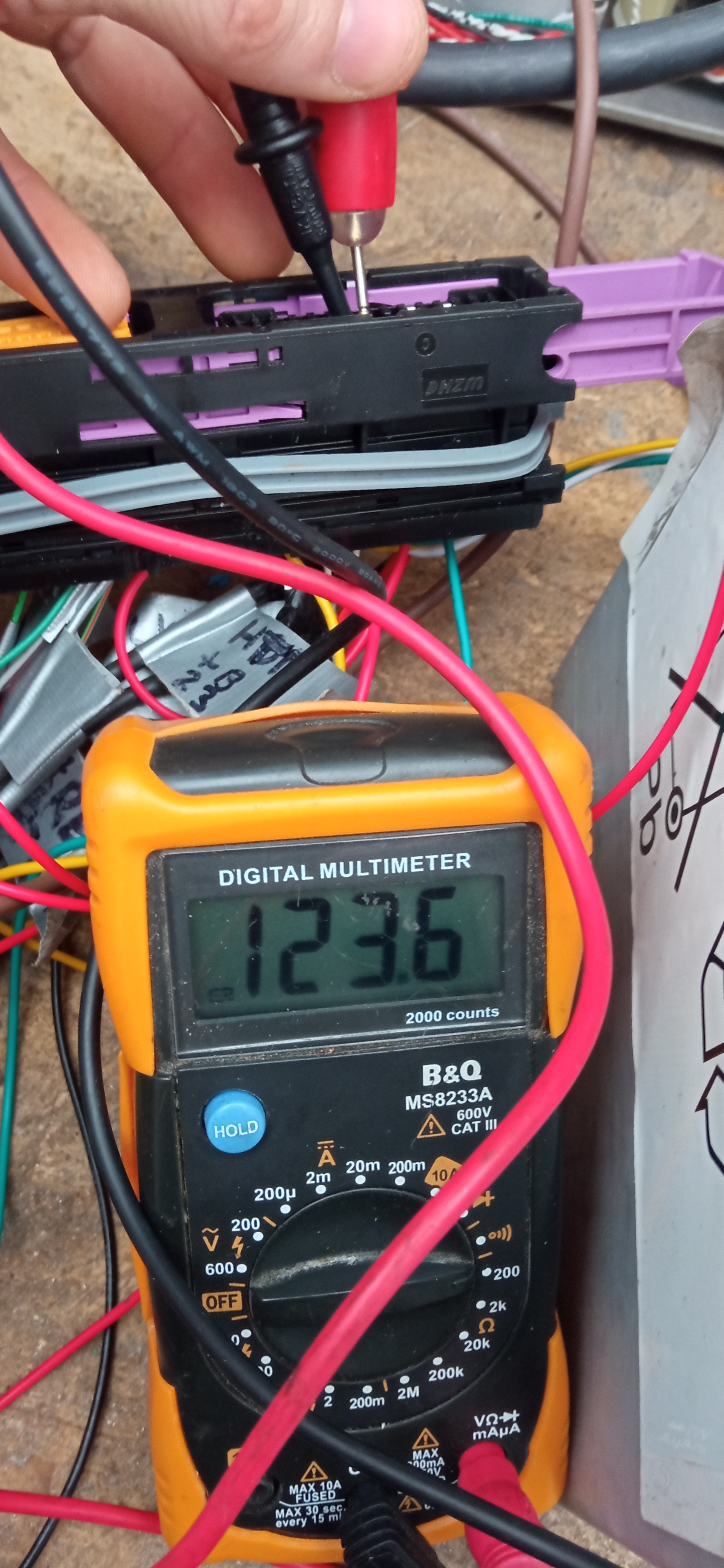

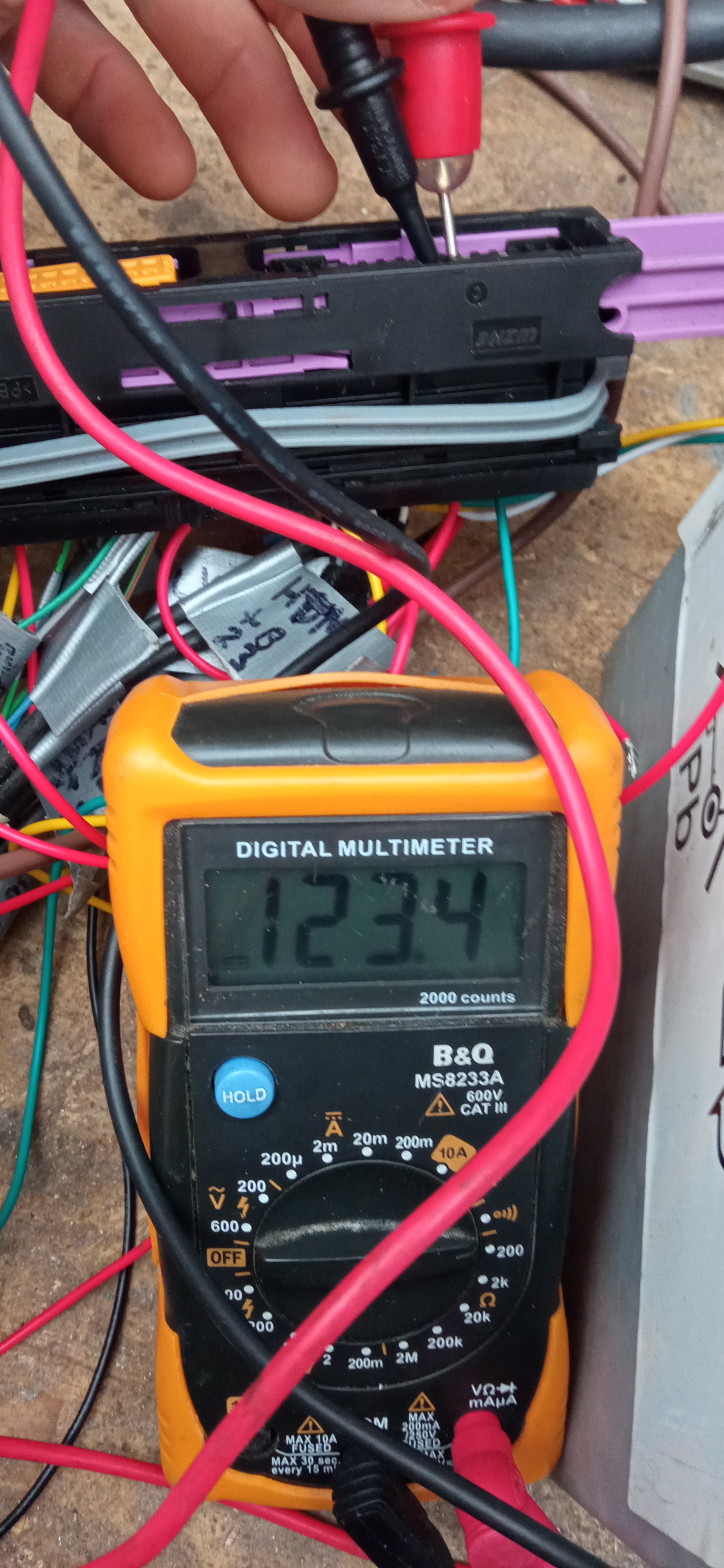

Resistances on zombie plug across signal pairs. All around 120ohms

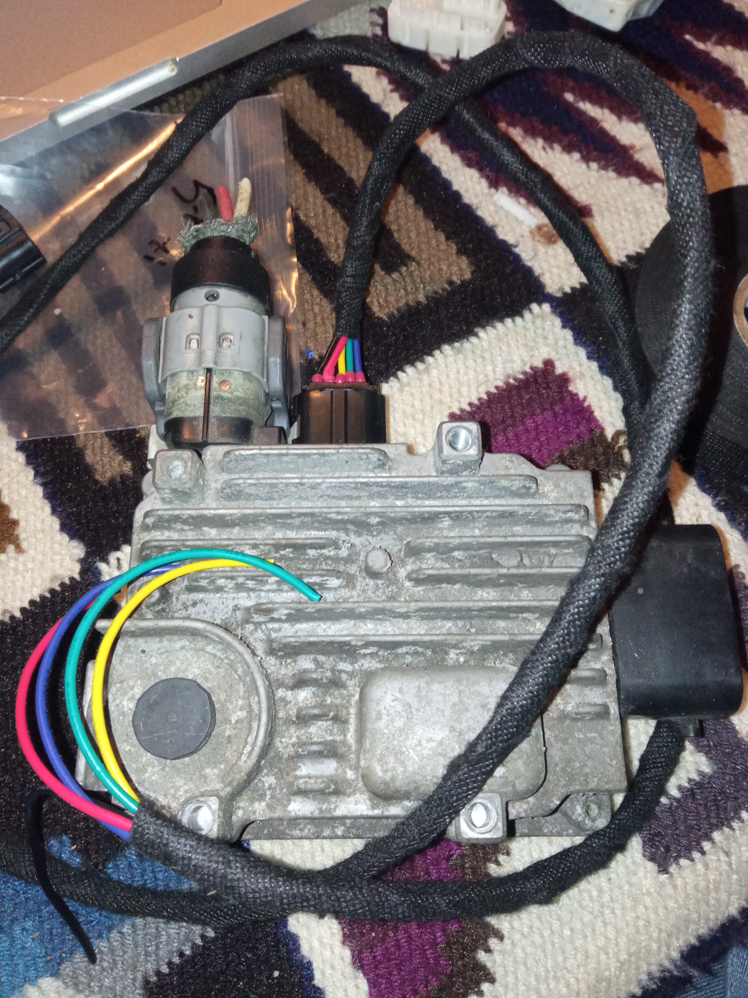

First wiring harness (half) made up for the oil pump controller....
crasbe
Posts: 330
Location: Germany
Has thanked: 58 times
Been thanked: 180 times
Post by crasbe »
The cloth tape isn't always suitable for outside applications, it might go moldy.
