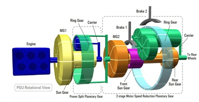

Can anyone explain to me, how and why the welded planetary gearset is different to the locked input shaft for NG1 speed ratios.
Also, why mg1 is the limiting factor with a welded gearset for gs450H but not the GS300H, as I understood the input shaft was not directly coupled to the output in either transmission. Is this correct? And as a result mg1 the s not directly coupled to mg2 nor the output (one can spin independently of the other). Can they spin at different speeds? E.g mg2 at 10000rpm and mg1 at 6500rpm?
How is the output torque shared in this case?
These things are very confusing and complex!

Picture of the 450h gear layout.
Blue is input shaft, it is the planet carrier. You lock it so it does not freely rotate the planet gears and prohibits torque transfer.
Now the reduction is the sun (MG1) to planets (which are now stationairy) to ring gear output. Welding/locking the planet gears to the ring gear means that the sun gear, which is MG1 will spin as fast as the output shaft which is connected to the ring gear.
Things are not that complex as you might think, everything is designed with torque and speed requirements. Depending on the motors physical size it will have a lower top speed.
A very good slide deck to review, which gets referenced on the wiki. https://slideplayer.com/slide/14432904/
Re: [WIP] Mercedes 310E (310D campervan) - GS450H/GS300H
I think i covered that in my last post but i'll break it down.
The planetary has three connections, MG1, input shaft (engine), output shaft(prop). The planetary gearset ratios are arranged in such a way that if you lock the engine input, then MG1 is forced to turn at (iirc) ~2.3 times the output shaft speed. If you welded the planetary instead, its now a solid lump and MG1, the input shaft and output shaft are all turning at the same speed, ie 1:1.
MG1 is the limiting factor on the GS450h, because MG2 is geared at 1.9:1, and the MG1 (with input locked) is geared at around 2.3:1 IE MG2 is turning slower than MG1 would be. On the GS300h MG2 is geared at 3.3:1, so its turning faster than MG1, and thus MG2 RPM limit is reached first.

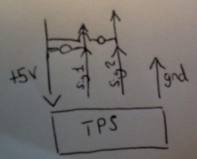

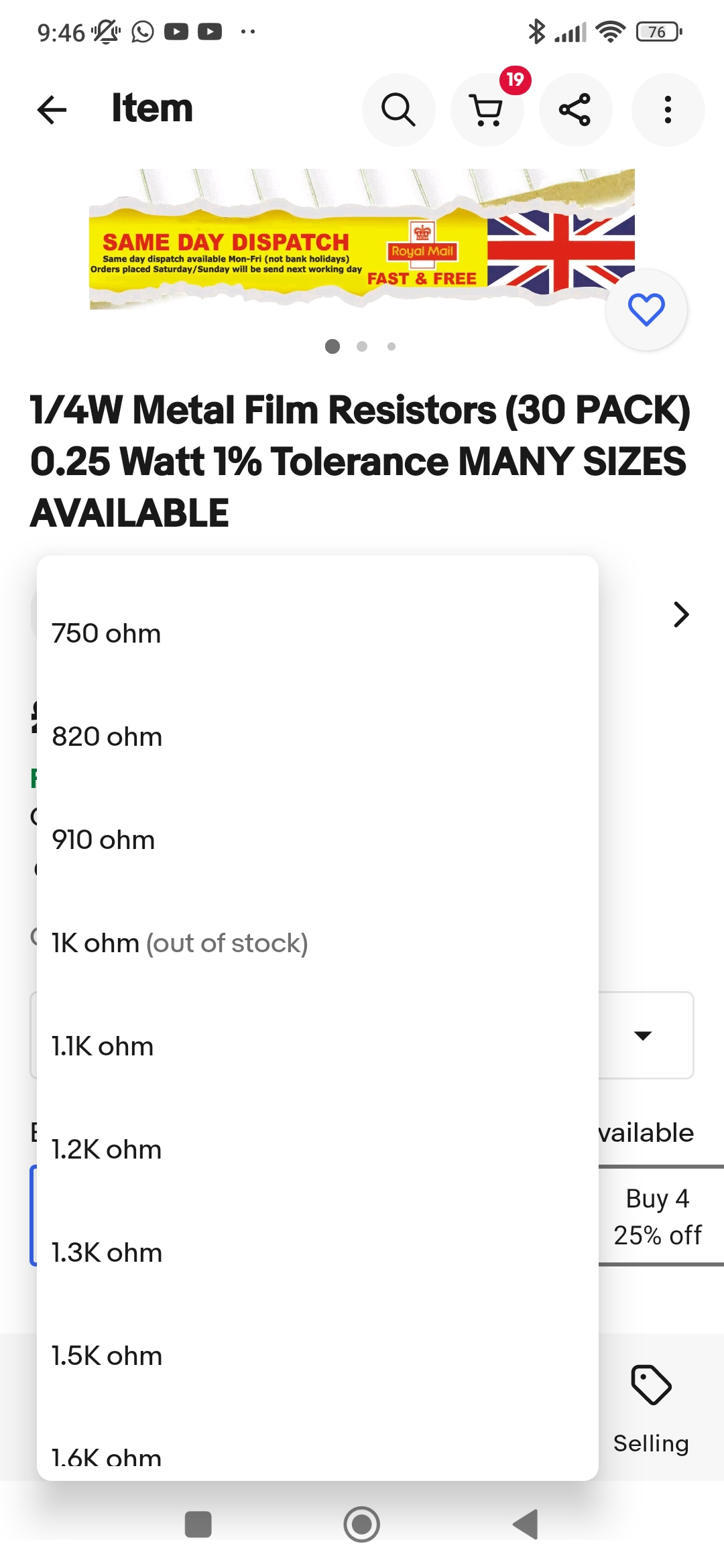

So with a lot of very generous and patient help from BigPie I've been trying to get my GS450H to spin on the bench.
I'm yet to get precharge setup so just raising the current slowly from 0 on my branch power supply.
Frustratingly it seems the TPS I bought may be faulty. I got the same one as below as I'm converting from a cable drive and figured this would be flexible but when I give it 5V and grd to the below pins I get no signal from either wire. I do need to have a little play with it but unless the cables themselves are faulty I'm not sure what it could be. These do have a little PCB inside covered in glue so it's not possible to really see what's going on inside.
clanger9 wrote: ↑Wed Mar 25, 2020 10:47 pm Been doing a bit of reverse engineering on a Peugeot throttle position sensor. These are cable operated, so ideal for a bike throttle. They're also cheap (only £16 new). Part number is 9643365680. Google for "Peugeot 306 HDi throttle position sensor"
Rather than a true potentiometer throttle, it appears these use a contactless sensor to output a pair of analogue signals.
Using a 5V supply and a 1kΩ pull-up resistor, I got the following readings:
0% throttle white: 0.419V yellow: 0.209V
100% throttle white: 3.780V yellow: 1.871V
I may use two: one on the throttle cable and one on the clutch cable (for regen control)

Did you add the 1k Pullup resistor to the signal wires as well? That is mandatory for the device to work as far as I remember.
Jacobsmess
- Posts: 871
- Location: Uk
- Has thanked: 545 times
- Been thanked: 153 times
I didn't, it was something I thought might be necessary but kind of hoped I could skirt over it. So I need a 1k pull up resistor in series with each signal wire?
- crasbe
- Posts: 330
- Location: Germany
- Has thanked: 58 times
- Been thanked: 180 times
No, if it would have to be in series, it would be called a "series resistor"Jacobsmess wrote: ↑Mon Dec 04, 2023 9:21 am I didn't, it was something I thought might be necessary but kind of hoped I could skirt over it. So I need a 1k pull up resistor in series with each signal wire?
The Pullup has to go between the signal wire and +5V, it it used to pull up the signal to the high level. Hence the name.
Since the TPS has two signal outputs, I guess it needs two Pullups. One for each signal wire.

Thanks, electronic nomenclature is not my forte! So how would the zombie read the signal? Does the resistor just bridge between the signal wires and 5V and the zombie signal wires connect to the TPS signal wires the same?
See my perfect diagram for what I'm asking, as you can see electronics diagrams are also not my forte.... And finally, as Gregski says.... You can't make this stuff up!
